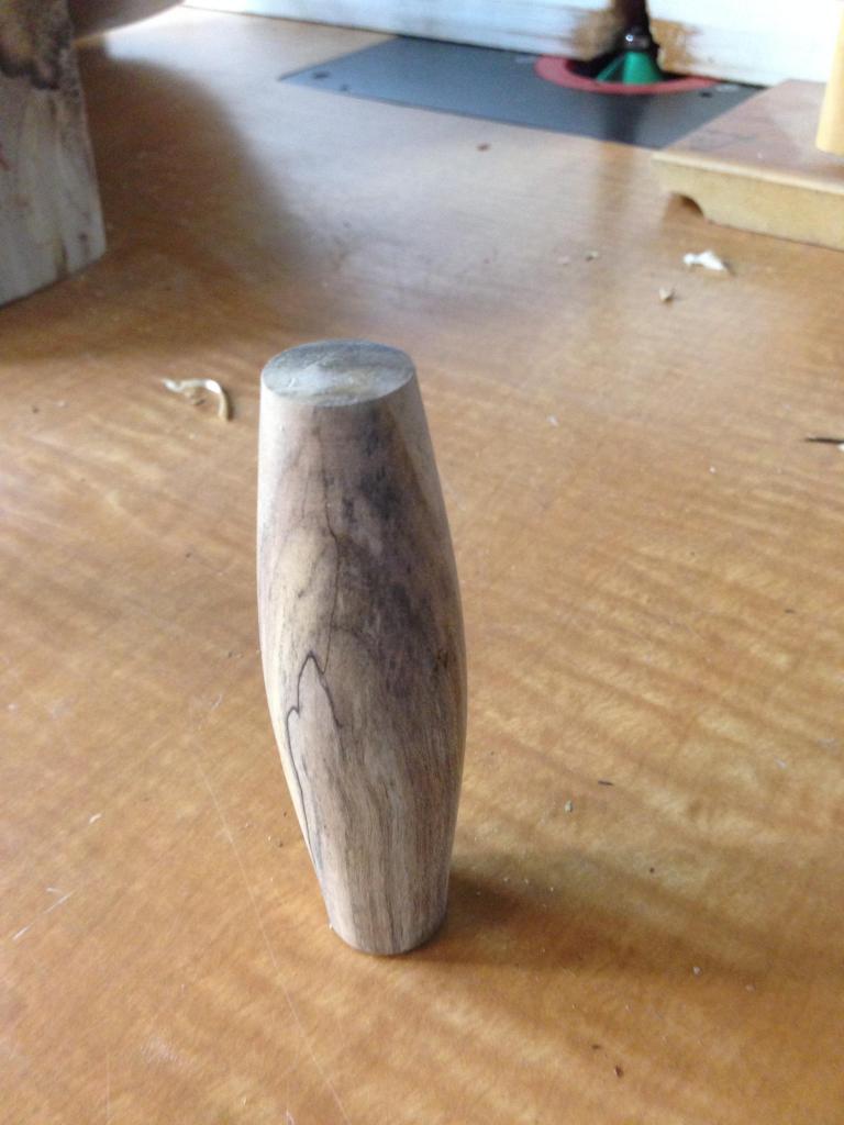

February 27, 20179 yr Author comment_100279 Here is my first and have to say I think weight might be the way to go Report

February 28, 20179 yr Author comment_100312 The printable version is in the comments at the bottom and you will have to expand comments. When printed the size is not proportional and it has to be enlarged which I had trouble doing. The one I did does not match the profile so does not flip well. The center is 27.5 mm , length 90mm and ends 20mm . One of my ends is smaller. I do believe it will do better with the weights. Only had time to do one today Report

February 28, 20179 yr comment_100412 Thanks Dan, I got my template ( eighth inch pressed board) made and glued up some Hickory. I'll let it set a few hours and give it a try. I am going to drill quarter inch holes in each end and screw in set screws. Let you know how thing worked. Still picture if it don't work.....video if it does Report
February 28, 20179 yr comment_100432 Thanks Dan, I got my template ( eighth inch pressed board) made and glued up some Hickory. I'll let it set a few hours and give it a try. I am going to drill quarter inch holes in each end and screw in set screws. Let you know how thing worked. Still picture if it don't work.....video if it does Report
February 28, 20179 yr comment_100433 Guys, my first attempt did not go well. I've never turned with a template before and I did not get the dimensions correct. It does work, but takes more force to make it move and don't go far. Oh well another try tomorrow. Report
