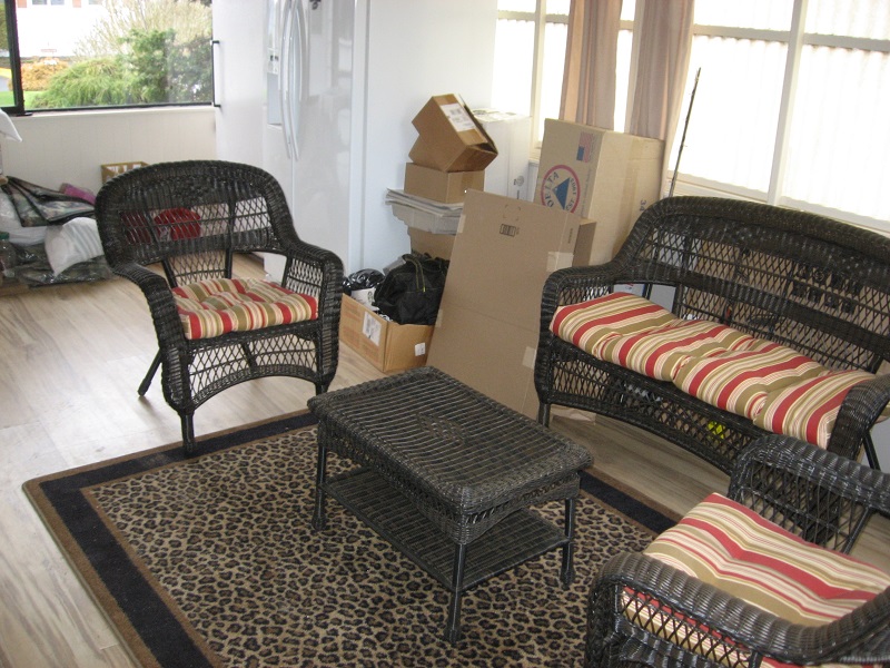

I have that on my house andI have storm doors on each end. It does have a step in front of the sliding door that takes up some space. It was already built and I sealed it insulated it and bought some cheap laminet flooring from LL to put on the concrete. If I would have built it originally I would have put a floor even with the house floor ,that way I could insulate it too.
I just use it for a sitting room.

John, like I said, it was already on the house   enclosed when I bought the place, so don't know who built it. But it is definitely a factory manufactured addition.
It is 12' X 21' X 10' hi @ the house and slopes about 1' in the 12' out (shed roof).
No not showing on my tax form I pay every year as an add to the Sq.ft. of the house. Not sure it is code to include it. Might check with your area codes.
Yes it was built on the existing patio slab. If I had it done originally I would have built a deck to match the level of the house floor and then had it built on that. Here I would have had to get a permit to build the deck, not sure about the enclosure.
