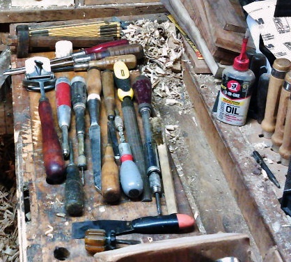

Have a dozen of those plastic handled  "butt" chisels...about half of which are Stanleys.....Have a pile of scrap sitting around, doing nothing at the moment.....Might see about a way to store them in something wood?    A friend from Columbus stopped by today.....I fix up a jack plane of hers, and we checked out her Stanley 45.    Figured out which bolt goes where on her's.   I traded one of my #3 smoothers, for one of her "Basket Cases" planes.    Took a while this evening, but...
iron was bent ( now straightened)  Bolt for the lever cap was MIA ( new bolt, in new threads)  Chipbreaker was bent a bit too much....32 oz Ball Pean hammer "adjusted" it.    Plane will now take shavings.    Sold at Sears as a Craftsman #4.
Good thing she brought along a dozen Donuts.....would never had had enough energy, otherwise.....:rolleyes:
Will see what I can do about all those wayward chisels.....

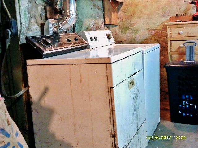

Ok, plans got changed just a bit, this morning.   The "good dryer" quit.    Motor ran, the rest of  drive train didn't.    More we worked on it, the more broken stuff inside was found,   have the weight was from it being plugged up.   We decided to salvage a few good spares, and scrap the rest.    Dragged all that out, and up to the backyard, awaiting a trip to Sims Salvage Yard tomorrow morning.
Slid the old dryer over into that spot, after a major clean up operation went down ( almost 2 trash bags full) hooked it up, turned it "ON"...it works like new!?!?...

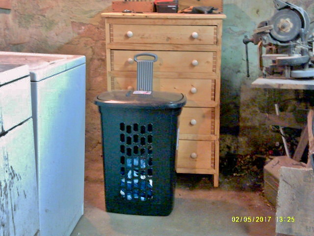

Been cleaning the sheet metal up.   The corner to the left is where the drain is located, was full of junk.   No longer blocked, now.   Took two of us to slide the dresser into it's new home..

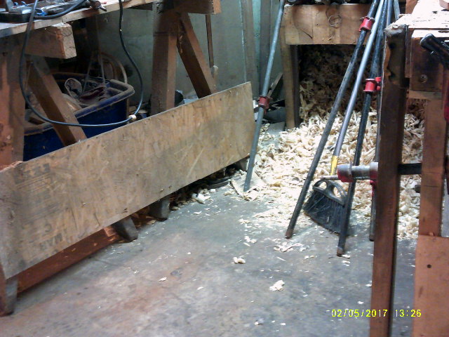

Old 5 gal. paint tubs are going outside.   Floor has been swept clean.   Ran out of trash bags before I could start on this mess, though..
Might need a LARGE one?   There is also a pile of stuff right beside the bottom of the stairs....The Boss has Dereed that it will also been removed.
Main thing right now?   At least the area I work in, is nice and clean.

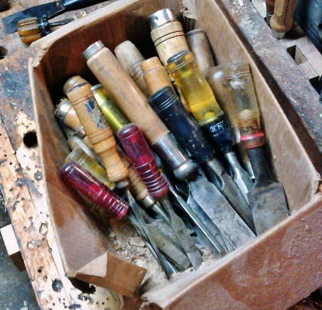

Next up?   Well, I have a pile of chisels just sitting in an old box.....maybe build a new home for them?
Ok, in regards to the dryer we scrapped out this morning....Seal at the back of the drum was shredding.   An idler pulley, and  bracket, was just laying in the bottom of the dryer , where it went?  Parts of the pulley were MIA, as well.    Vent tube from the drum to the exhaust pipe....plugged solid.   Belt was shredded.  :angry:
Motor does run nicely....not sure IF I can get it to fit the old lathe... :unsure:
We kept the cord, in case the next dryer had the "wrong"  style end.   I salvaged the heater core, and sensors, just in case. :ph34r:
Found a $1.84 in change in the linty mess in the bottom of the metal cabinet of the dryer. :).
Reused the connections to the dryer vent.....and fastened everything in place.   No leaks.    We also moved the washer towards the dryer, less strain on the washer's 120v plug.

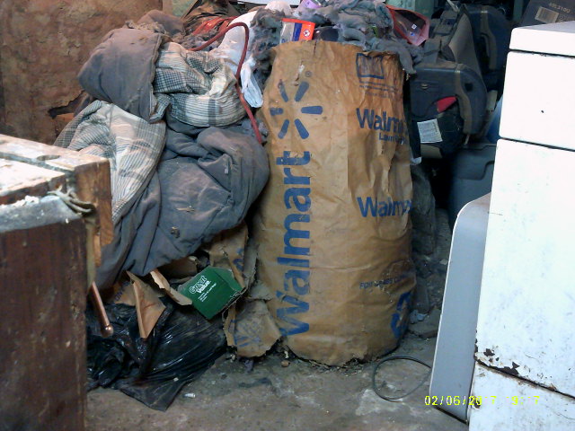

Cleaned all the mess from under the old dryer, wall behind it was coated with lint.   I even found a Corner Clamp in the mess under the dryer.    There were two 5 gal. paint buckets, one is going outside, the other will follow later.   even the Boss was down there, moving a broom around.   There is actually room for three people down there.:o
Need to go and buy a few trash bags, the ones the city will pick up on Trash Days.....IF we can find out where they are sold...and in stock.    have a bunch more to haul up the stairs.

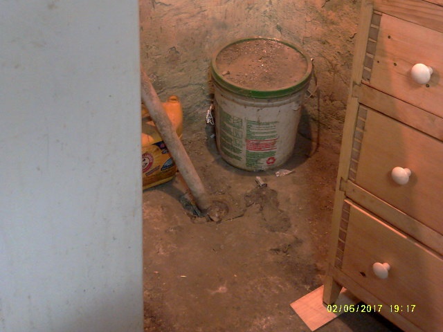

This be the floor drain for the entire basement.   You can also see the shim I had to add to one leg of the dresser.   Uneven floors...

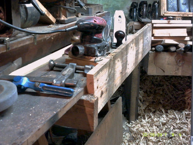

Added a Keeper to a shelf's edge, to keep things from walking off the edge...can't always count on a layer of shavings to break their fall..

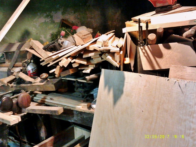

Calling these things  The orphans.   Still trying to find a home for them.   How many can you identify?
Pine scraps.....burn pit?   Or...a box for these?
Not even sure how many are in there....Maybe build a box to hide these in?

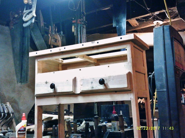

Test fit of the top/shelf for the bench.
There is a support on the end down by the vise.   Haven't attached anything else.   Just trying to see what fits, and what doesn't fit....work in progress...:rolleyes:

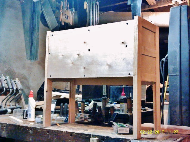

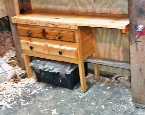

Top is attached, back is on the dresser part.    Witch's Brew is now stinking up the shop..

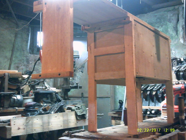

Hard to get this in one shot.    Back is done..
Cleats to attach the top, in case I ever want to expand this thing..
That way I can add on to this case, someday....
Of course, I would get one cleat on the wrong side of the support post:huh:....oh well..:rolleyes:..will let the smelly Witch's Brew dry for a day ...or three....while I figure out what the next project will be...
That is slick! Great job
Looks like it was just made to go there...:rolleyes: Thanks for taking us on yet another journey and series of the Dungeon Chronicles. Enjoyed this one too.
