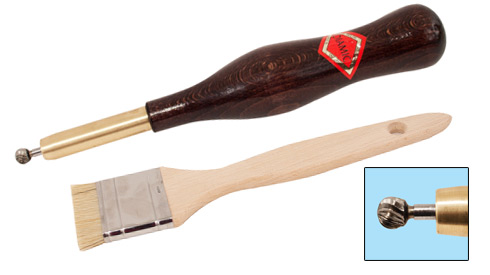

Actually there are several types of tool and here are two more.
The Decorating Elf.
and the wagner texturing tool.
Wagner Texturing Tool
