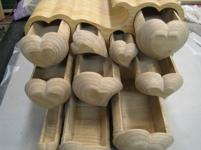

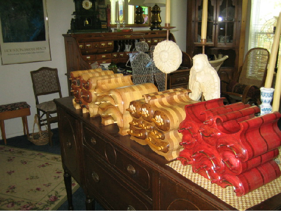

Smallpatch Posted January 14, 2017 Report Posted January 14, 2017 Dave this was one of the 4 I cut out by the side of the motor home in Colo. in about 04. I always prepare all the wood at home so all I had to do camping was attach the pattern and saw. Then load a basement full of equipment and while up there, we wood work every other day then sight see in the car the other days. Get up real early and take off one direction for half a day, turn around and go back the rest of the day. Never the same roads. Wife took her stained glass stuff. Not bandsaw boxes!!!!!!!!!!!! This was my welding rod group, three of the four. I use welding rod and brass braising rod for handles or parts of handles. It bends to shape and holds its shine with clear lacquer and I already have this stuff. All were sawed out with the scrollsaw meaning no cuts between drawers. I can make a band saw box in a day. One of these 3 or 4 weeks. Thats why you don't see boxes built like these. Other guys ain't that stupid!! You can't make a bandsaw box with this close tolerance. DerBengel, Chips N Dust and HARO50 3 Quote
Grandpadave52 Posted January 15, 2017 Report Posted January 15, 2017 53 minutes ago, Smallpatch said: Not bandsaw boxes!!!!!!!!!!!! Ooops...my bad... Sorry I think I knew this but obviously forgot...probably all the raps to my head on the frame of my truck when I replace the starter this week... 53 minutes ago, Smallpatch said: I can make a band saw box in a day. One of these 3 or 4 weeks. Thats why you don't see boxes built like these. Other guys ain't that stupid!! You can't make a bandsaw box with this close tolerance. You've just got the gift of patience to be this creative...I exchanged that gift for good looks... turns out I got scammed on that deal too Thanks Patch for posting the close-ups...these boxes are awesome. p_toad, HARO50 and DuckSoup 3 Quote

Smallpatch Posted January 15, 2017 Report Posted January 15, 2017 Grandpaw Dave the good looks would be more important any day over determination. Thats what I call it for I have to be doing something so I plan my days with what lumber I have plus what tools I have in the shop to complete my projects. Those 4 jewelry boxes were pushing the limits of a 14" Sears band saw for resawing, a Dewalt scrollsaw and a oscillating spindle sander which I had just bought a model that had 9" long spindles. I had built one other jewelry box before the 4 while camping of the same dimentions without hardly any assist of power tools and the amount of hand sanding on just the outside took one week of sanding.. I learned my lessons as I got into more and more woodworking. One machine no one hardly ever mentions is the 1x42" belt sander. which comes with a 10" sanding disk. I use one all the time. Especially for sharpening things. The model 1x42 is way better than the 1x30. A wore out fine grit belt is perfect for lathe tools down to my pocket knives and everything in between. Thats the machine most guys use to sharpen tools at big first monday sales . Cheers for I smell food cooking. HARO50 and Grandpadave52 2 Quote
Dadio Posted January 15, 2017 Report Posted January 15, 2017 You scroll saw guys just blow my mind especially you, Patch. Those boxes are simply stunningly creative and I too thought they were band saw boxes. I don't have any words to describe how beautiful they turned out. Your the best, Ive seen Herb HARO50 and Grandpadave52 2 Quote
Gene Howe Posted January 15, 2017 Report Posted January 15, 2017 Jesse, you have enviable talent and a supremely creative mind. Grandpadave52 and HARO50 2 Quote
