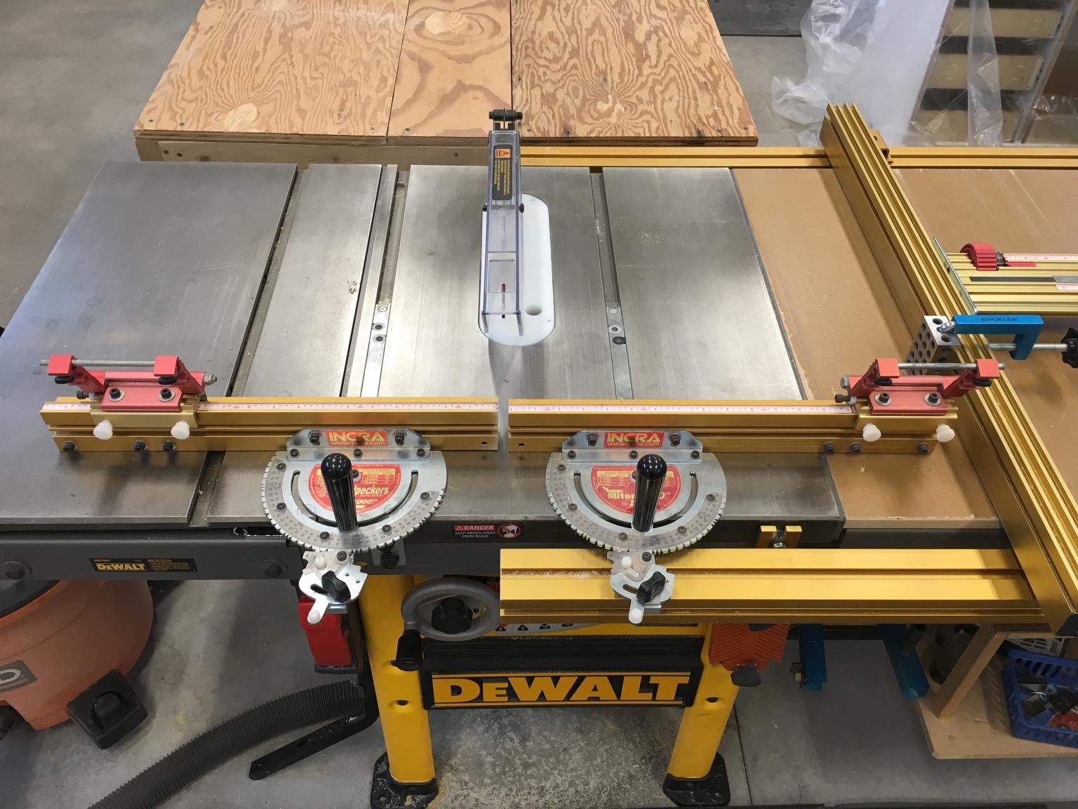

January 5, 20179 yr comment_91258 i'll grab some pics later when i wander down to the shop. squaring them up to the blade isn't that hard. you do have a good square, don't you? and you do have your TS properly tuned up and the rip fence set up correctly? give me a bit. i'll set them up on the TS and grab a pic. i have two so i can square up the ragged end with the Left one, then slide the stock over to the Right one, use a stop block on the fence, and make multiple cuts. they also have internal stops that i use for cutting shorter pieces. i rarely cut anything other than 90 degrees, but it will handle other common miter settings. BRB... Report
January 5, 20179 yr comment_91260 some pics: Incra sells all sorts of measuring tapes, so i got one that goes L-R, and another that goes R-L. just remove the screws, flop things over, and you have one of each. they normally come set up for the R side i believe. of course you have a little cart for all your TS accessories, don't you? i have several 1-2-3 blocks, and i use one for a stop block on the fence. also use these to set up the stop on the miter gauge itself as well as setting up the fence. Report

January 5, 20179 yr comment_91272 in theory, you can adjust to 0.01 degree with the vernier, but i've never had a need to use that. almost always 90 degrees, sometimes 45 (be aware that you have to slide the fence over so you don't cut the end off, which will change the stop location relative to the blade. i mostly use my miter saw for miter cuts other than 90 degrees. Report

January 12, 20179 yr comment_92513 this set up wasn't bought all at once, i've added to it and improved on it over the last 14 or so years. is it the very best saw available? probably not, but it's a good sound TS (about 400 pounds as it currently sits) that can benefit from upgrades over time. just last fall i swapped out the factory out-feed table as it was too small, i had built this table for other reasons, trimmed the height so that it's about 1/2 shorter than the TS, works very nicely now. the rip fence set up is the Incra 72" rail system, but i've cheated it all the way to the right, and by doing do, i can rip things up to 58" wide. very handy. if you look closely, i have a plastic fence i can quickly attach to the metal fence for when i'm using the dado blade, so i don't chew up the metal fence. Report
