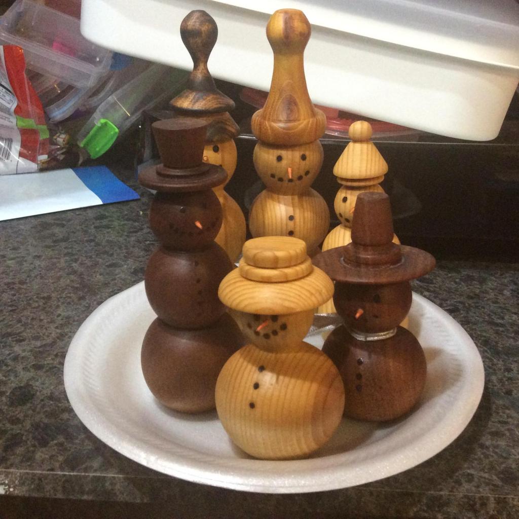

Last week's "Wednesday's" had a post from Patriot member Bondoman and his Christmas turnings. If you missed it, check out these neat snowmen he made

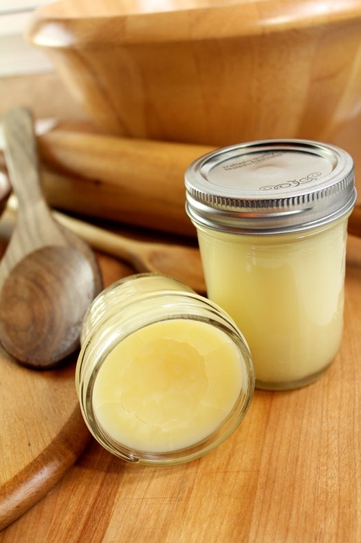

 We often discuss what makes a good food safe finish for our turnings (and other projects).
I went back through the "Wednesday's" archives and found this link-
http://www.creative-culinary.com/wood-butter-helps-renew-wood-utensils-and-bowls/
There's a recipe for bee's wax and mineral oil to create a "Wood Butter". I've found this combination to make an excellent finish for any article that is used in food contact. The consistency can be adjusted by the ration of bee's wax to mineral oil. It doesn't take much bee's wax!

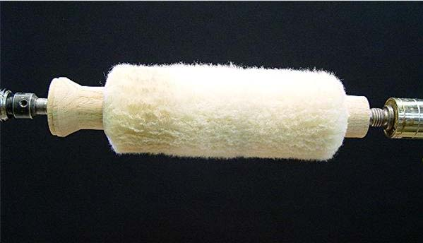

While I was browsing the archives, I also found this neat idea for buffing pieces. Who needs the Beall system when you have this-
"Here is a tip from the IAP forum on making quick and
cheap buffing wheels for the lathe. The photo shows a paint-roller buffer. You can't beat
the price - about $9 for a long nap lambs wool roller at
Home Depot. It works, and it neither as aggressive nor as
hard as the commercial buffers and it is really difficult to
get it overloaded with buffing compounds or wax.
You can put down 4 bands - Tripoli, White Diamond, wax, and
leave the tailstock end bare for just polishing.
Turned the end pieces, and make the drive end so it
would work in either a chuck or between centers. Ends made from wood can be glued into the roller with a
silicone adhesive so they can't get lost."

A lot of items to view again this week.  Thanks Lew.  I did take a liking to Bundoman's snowmen.  Very whimsical.
