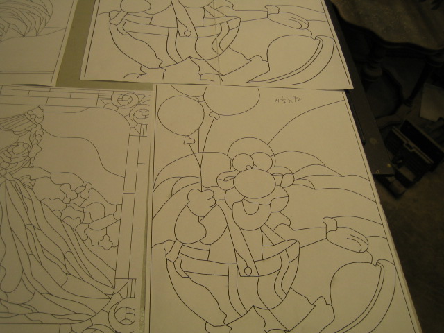

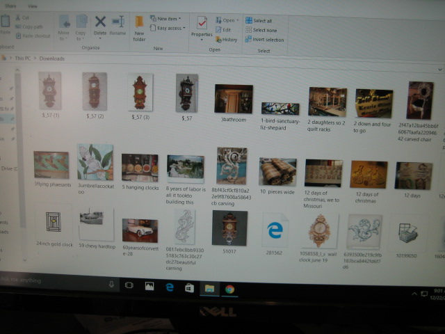

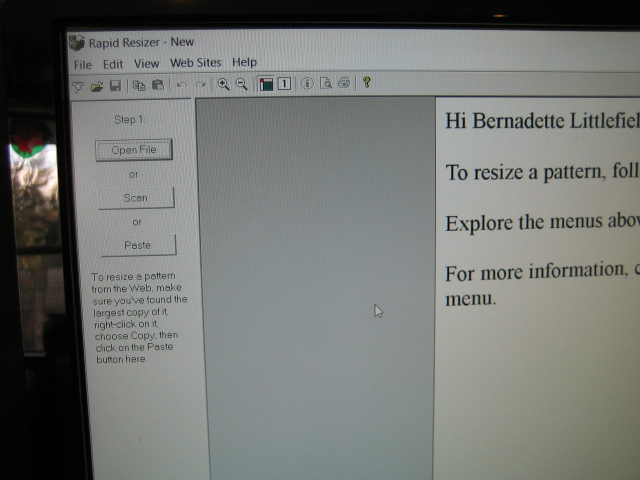

December 22, 20169 yr comment_88903 Lots of ways to go about it. A printer is a must to go with the computer. Also we installed Rapid resizer This will let you size the pattern larger or smaller which most of the ones I enlarge. Taking and storing a picture off of google or anywhere else it is always way too small to glue on wood to cut out with the scrollsaw. Right now I use a HP Photosmart c4640 printer. Around 40-60 dollar. The way I affix a pattern on to wood is with clear packing tape and spray adhesive, wife quilts so I steal her cans of stickum.The ten dollar can is no better than the cheap yellow top can in the picture. Quicker and easier and less messy. Apply two inch wide packing tape onto the wood, take it and a can of spray glue out side and spray a good coat onto the packing tape. take it back in a apply the pattern . Some one said reverse the pattern????? why. The pattern will be cut like you see it so?? Start sawing. When through cutting out the pattern. Pull all the tape off and there is no sticky to have to worry about, its gone in the trash. But first, so you won't pull your hair out, if you got any, figure out a system of numbering the pieces cause with the pattern off the wood it is just a bunch of small pieces. The reason I use clear packing tape is it is wider and faster than blue painters tape and not as many overlaps to make hills on the flat wood. Get the spray glue at wallmart or hobby lobby and wallmart is cheaper. I scan a picture to rapid sizer on the computer then enlarge it as needed. Then tell the printer to make copies. If I want to make some larger, no problem. Look on google for stained glass patterns, lots of free and I can get them in color or just the lines which is better and more accurate for the saw. And if you buy a pattern never use that pattern, make copies and store the original for later use. After I cut out all the pieces I start at one end and down on the bottom edge of the wood I number the pieces, all on the same bottom left side and make sure the markings will be hid when the pieces are back together. Like of the horse picture, I always make a box out of the outside of the picture for the pieces to be reconstructed into.. I do use a very small toothed blade so the line cut out is very small, making for more broken blades but notice the two strips of wood inserted on the left and top sides to remove the extra gap. The extra strips will be made smaller so not to show. The reason I started using glass patterns, mostly they contain larger pieces and easier to make but some are not a good rendition of the subjects. The large copies will contain lots of type writer pages which will have to be clear taped together, no problem. This indian is a good picture to make with the saw. Got to go get a new water heater for the motor home, will discuss this later if anyone wants.. Report
