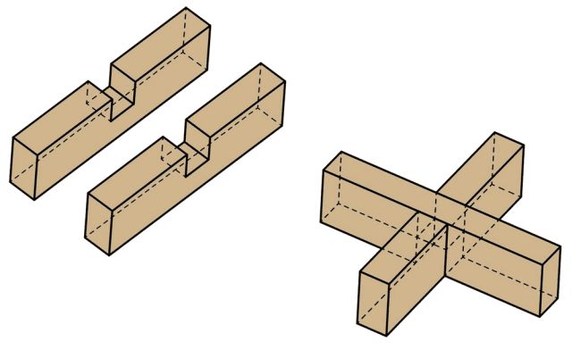

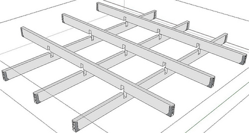

December 20, 20169 yr comment_88593 Have a desire to try building a torsion box assembly table for my shop. I watched the FWW video above and had a couple questions...... First, instead of cutting the inner blocks individually, can one cut the inner framing strips to the full length and then cut a dado/slot half way thru the boards where they intersect so they "saddle" one another to form the grid? Sure seems like if these board are all the same width and put together this way, the overall assembly would be much easier (and stronger). Second, if you have to take a block plane to knock down any high spots, are you really sure the surface is going to be dead flat? Maybe it's not enough to worry about. Anyway, all those individual pieces seems like an opportunity for error. Appreciate any words of wisdom to set me straight. Thx. Report
December 20, 20169 yr comment_88596 2 minutes ago, Wil said: an one cut the inner framing strips to the full length and then cut a dado/slot half way thru the boards where they intersect so they "saddle" one another to form the grid yes... way stronger... it called a half lap joint... and see the link I gave Keith.. Report
December 20, 20169 yr comment_88619 The one I have now is 52" by 52", and I did the webbing with the lap joints. Not for strength (don't know if it makes a difference or not) but for ease of assembly...you aren't working with 50 blocks trying to toe nail or whatever to get them in place. Report
December 20, 20169 yr comment_88624 Thanks Stick and Fred. Certainly reassuring to see my thoughts validated by others. This sure seems like a no-brainer approach to building this. Report
