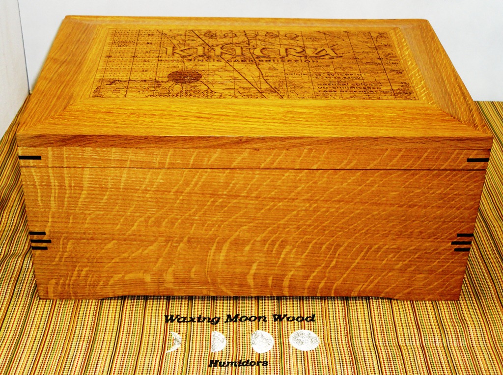

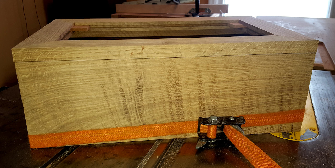

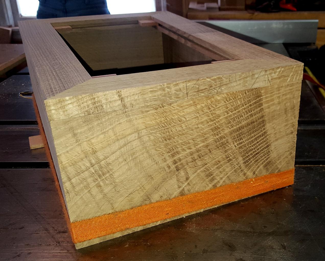

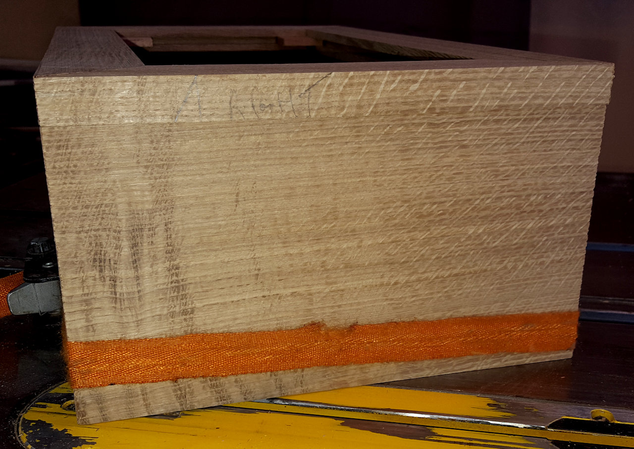

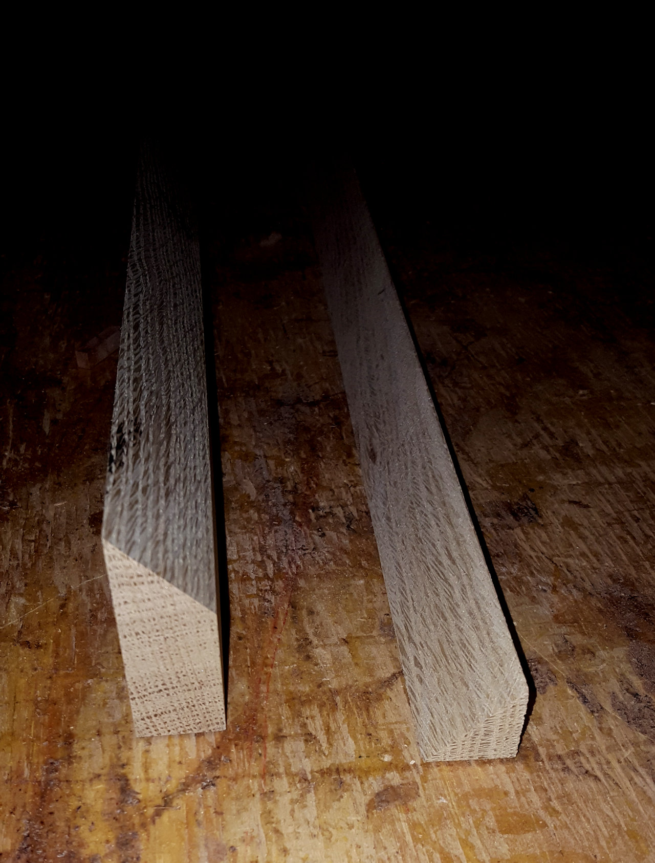

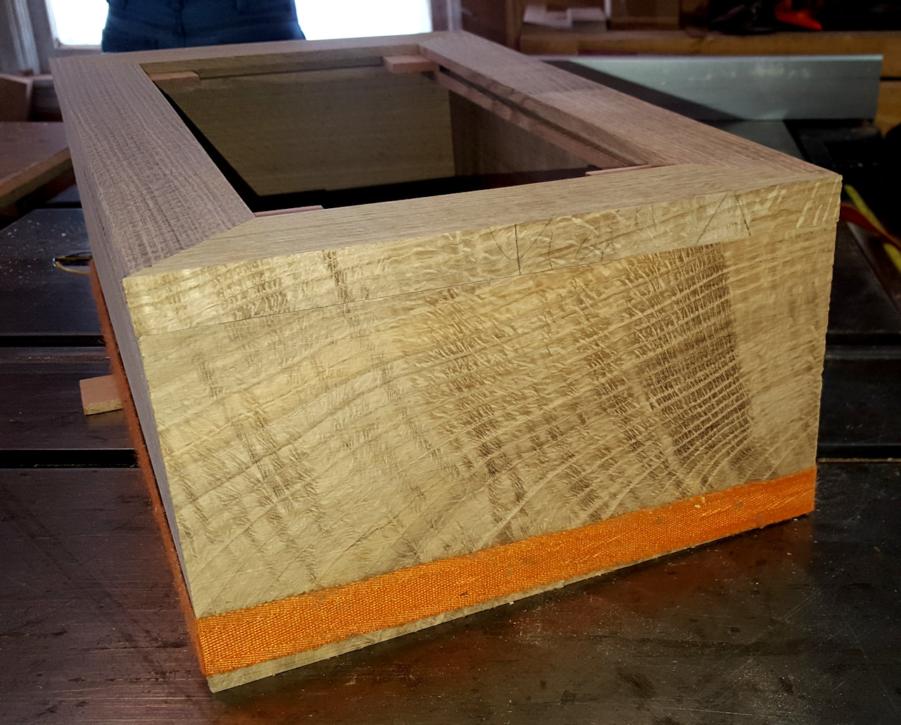

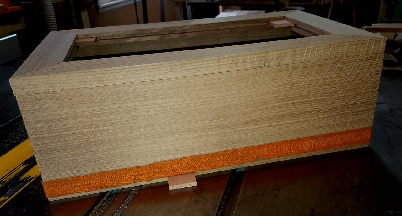

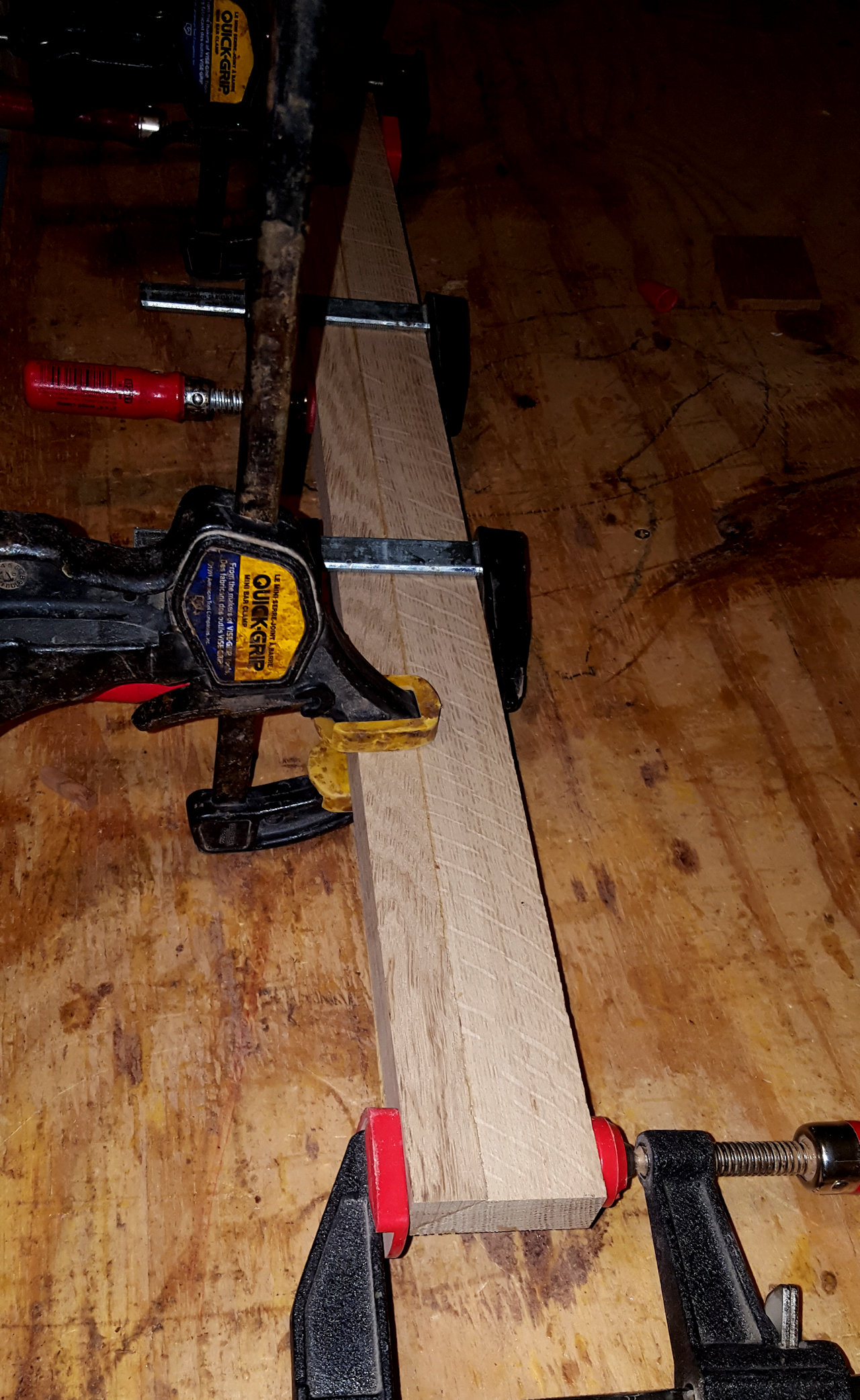

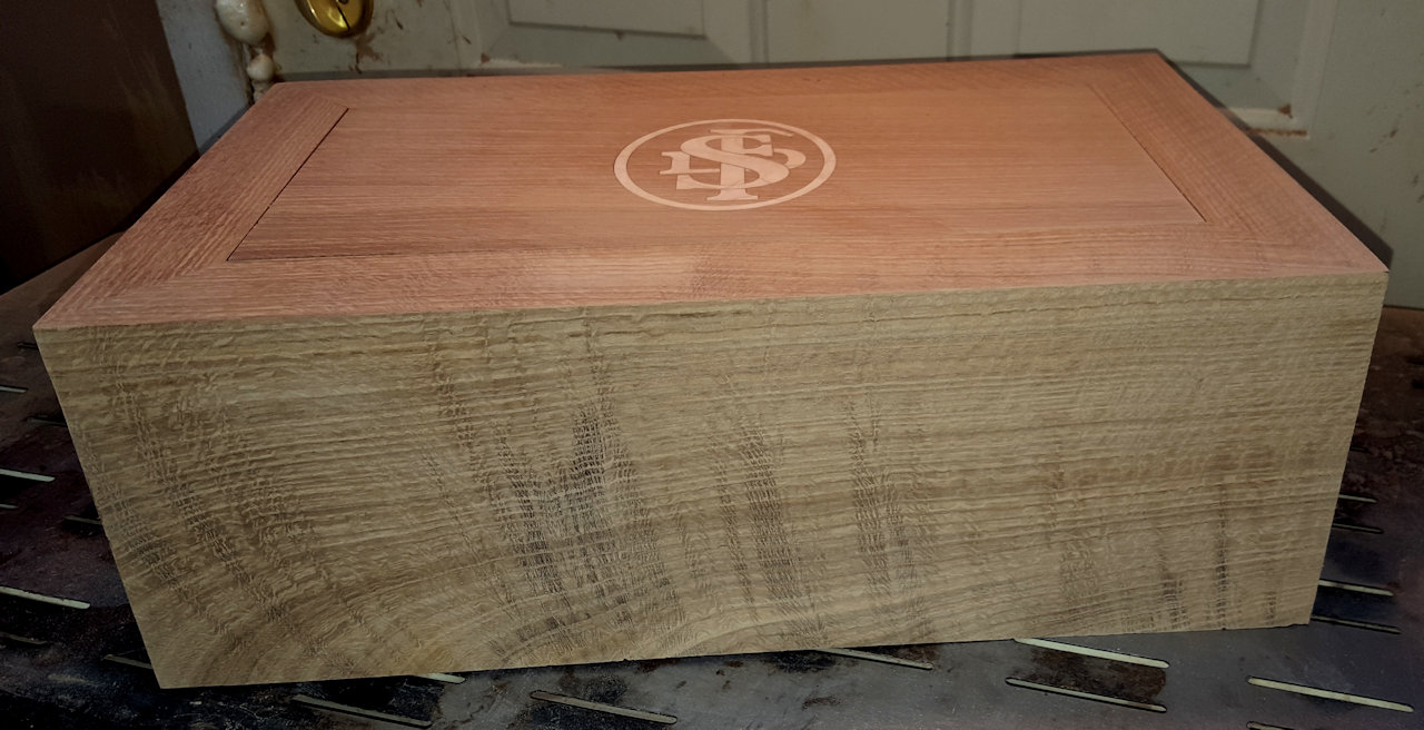

December 16, 20169 yr Popular Post comment_88041 In the past, when making boxes with Quarter Sawn White Oak (or any other wood, for that matter), I didn't like the way the lid frame edge would be flat sawn...... unless I used a piece of flat sawn wood for the frame, then the edge would be quarter sawn, but the frame would be flat sawn.... I solved that problem by cutting a bevel down the length and flipping it, then gluing.... keeping it marked so I can line up to match the grain on the front, sides and back (the frame pieces are lighter because I ran them through the drum sander once, but they do match up..... The completed box picture is an example of what I didn't like... the rest of the pics show "the fix"..... Now it'll be quarter sawn all around.... Should turn out nice! Edited December 16, 20169 yr by Waxing Moon added a couple lines Report
December 16, 20169 yr comment_88045 Cool! I like the temporary "spline" trick to keep things aligned at the corners Report

December 18, 20169 yr Author comment_88350 No, the glue seam won't show as it will be hidden by the mitered corners.... Report

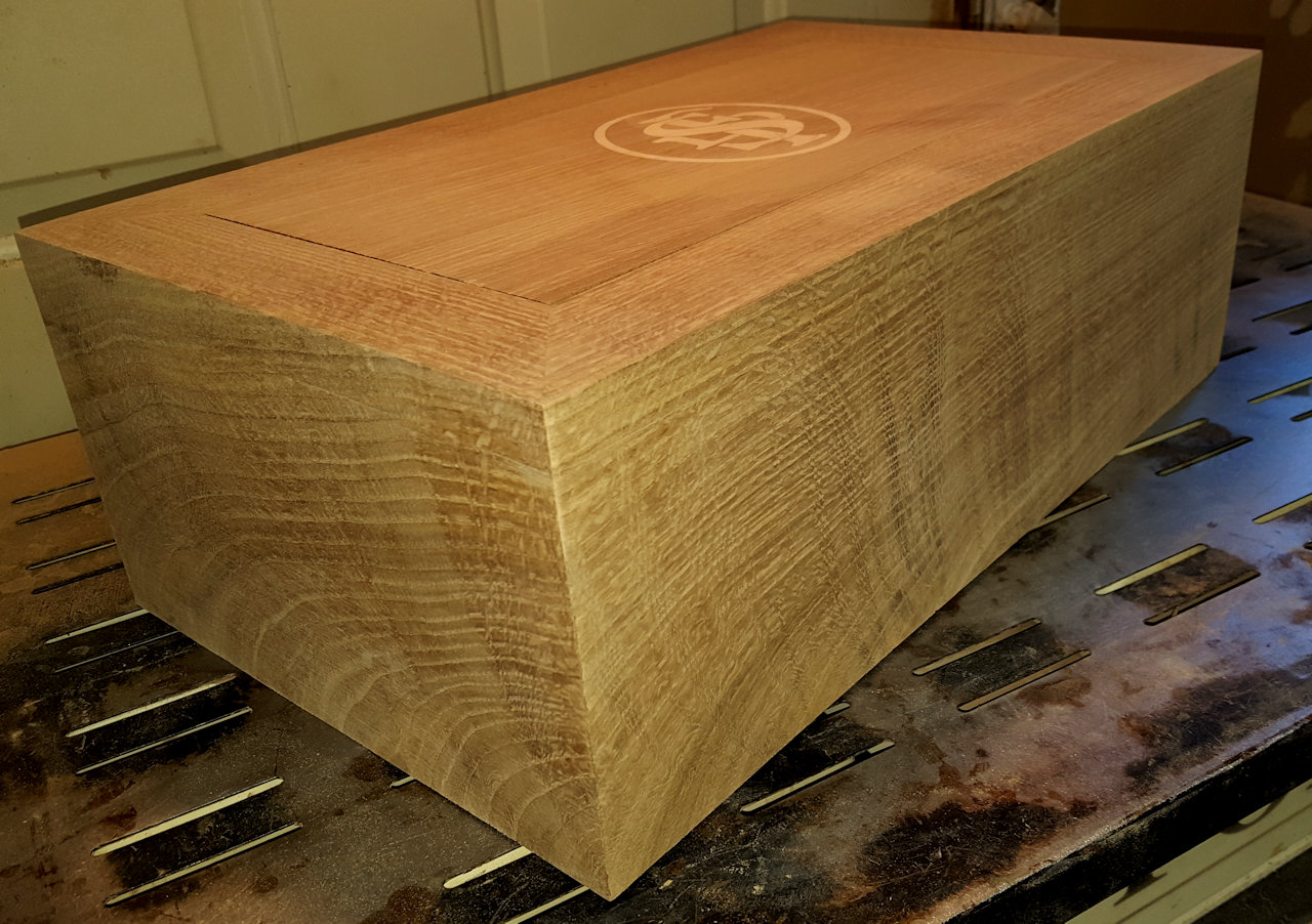

December 29, 20169 yr Author Popular Post comment_89970 So far, so good.... grain matched up perfectly.... I'm happy. I'm working on a few boxes at the same time, it'll be a while before finished,but I'll post a pic or 3 when it is... Report
December 29, 20169 yr Author comment_89971 Another pic Edited December 29, 20169 yr by Waxing Moon Report
December 29, 20169 yr comment_89972 15 minutes ago, Waxing Moon said: So far, so good.... grain matched up perfectly.... I'm happy. As you or anyone else should be! Report
December 29, 20169 yr comment_89975 Really does look good, the grain matches in all directions. Report
