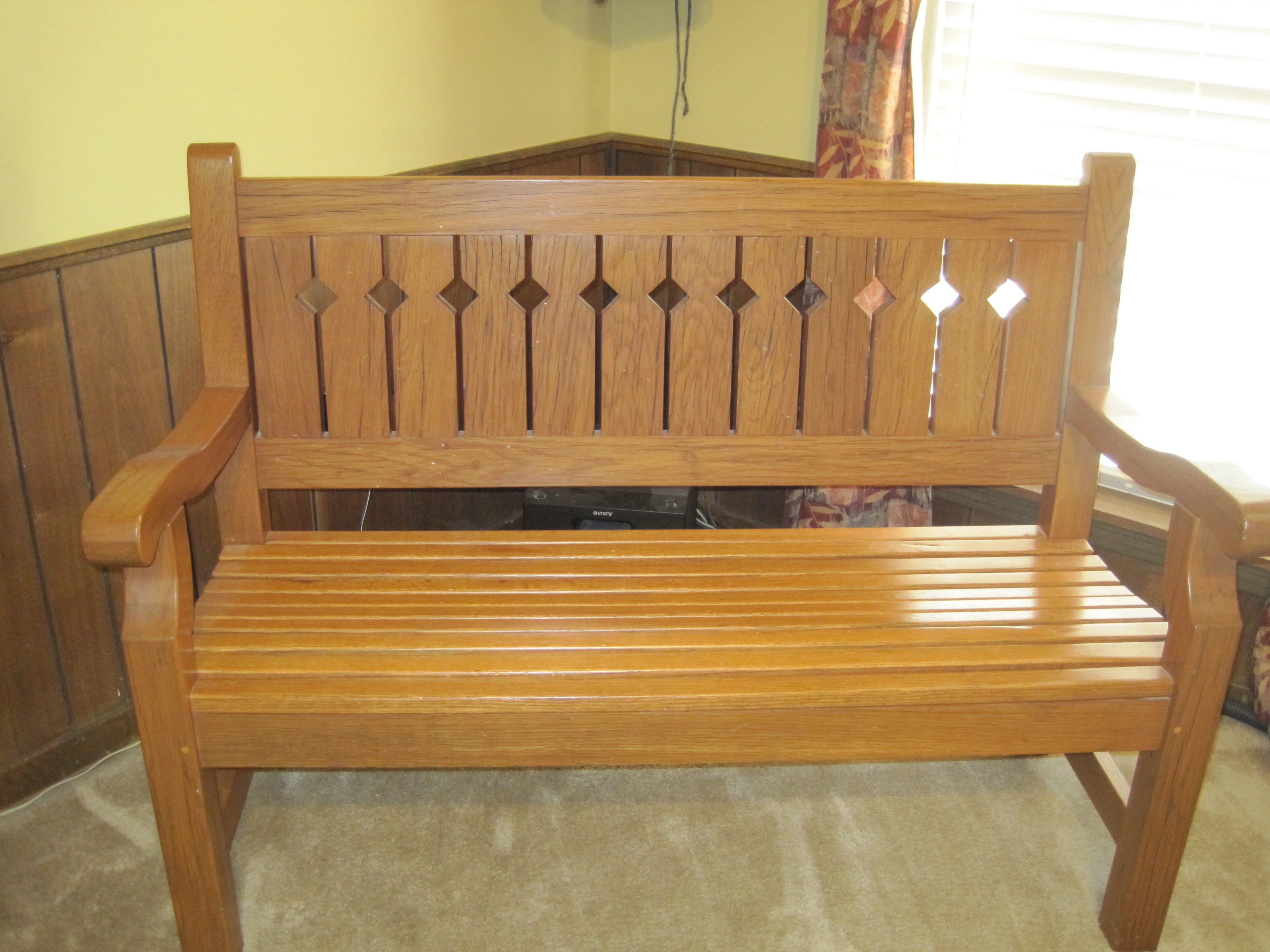

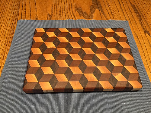

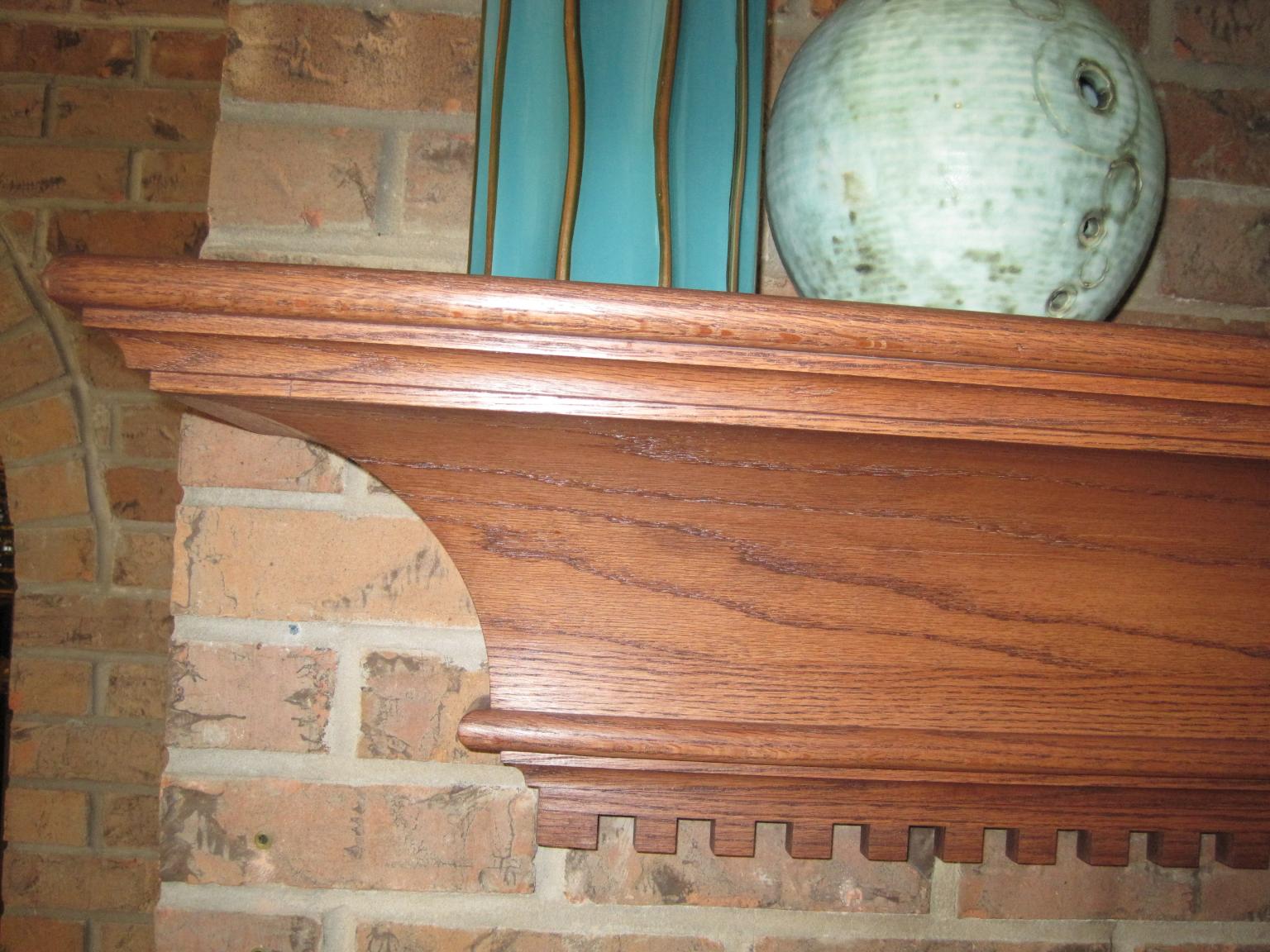

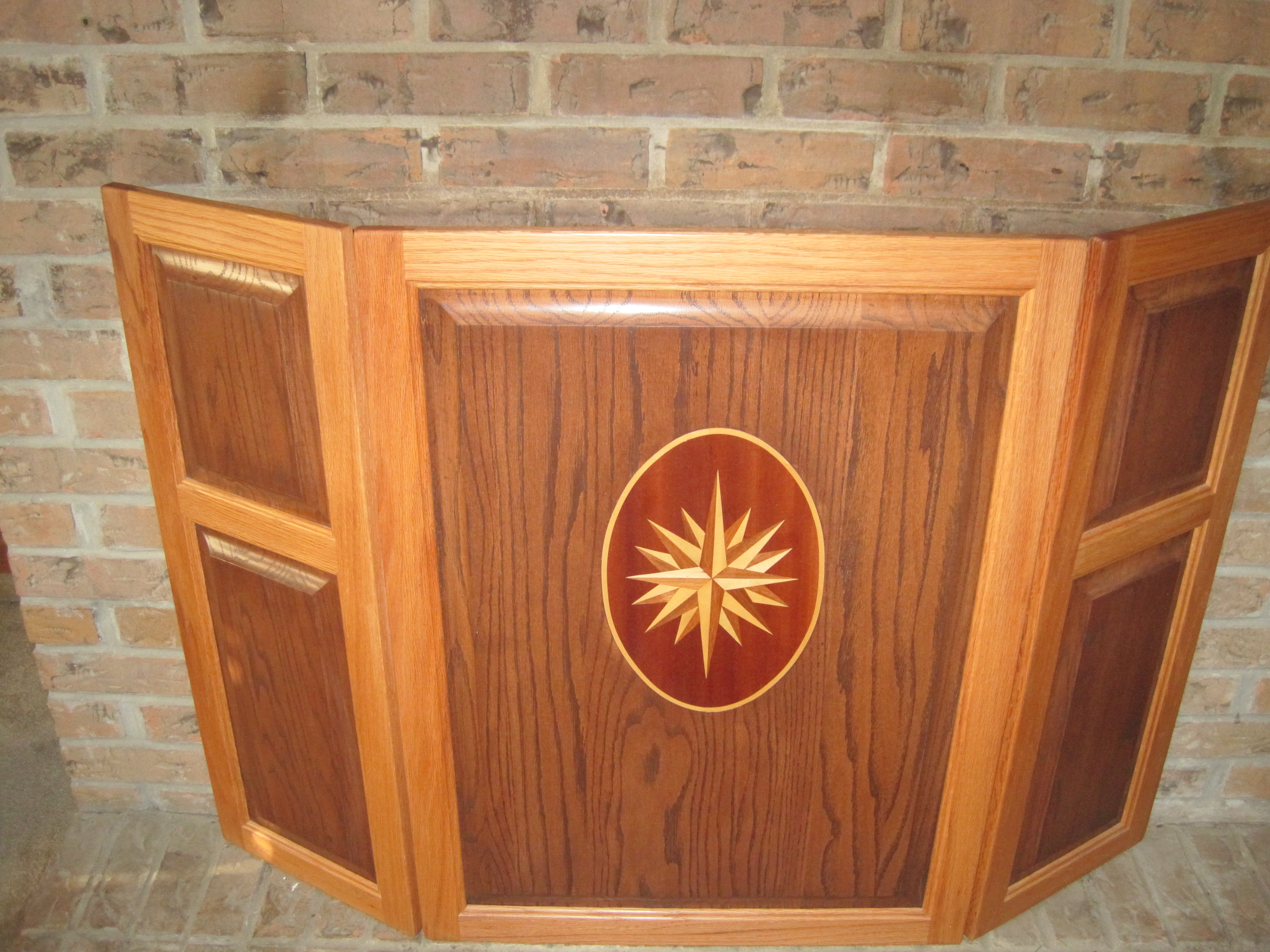

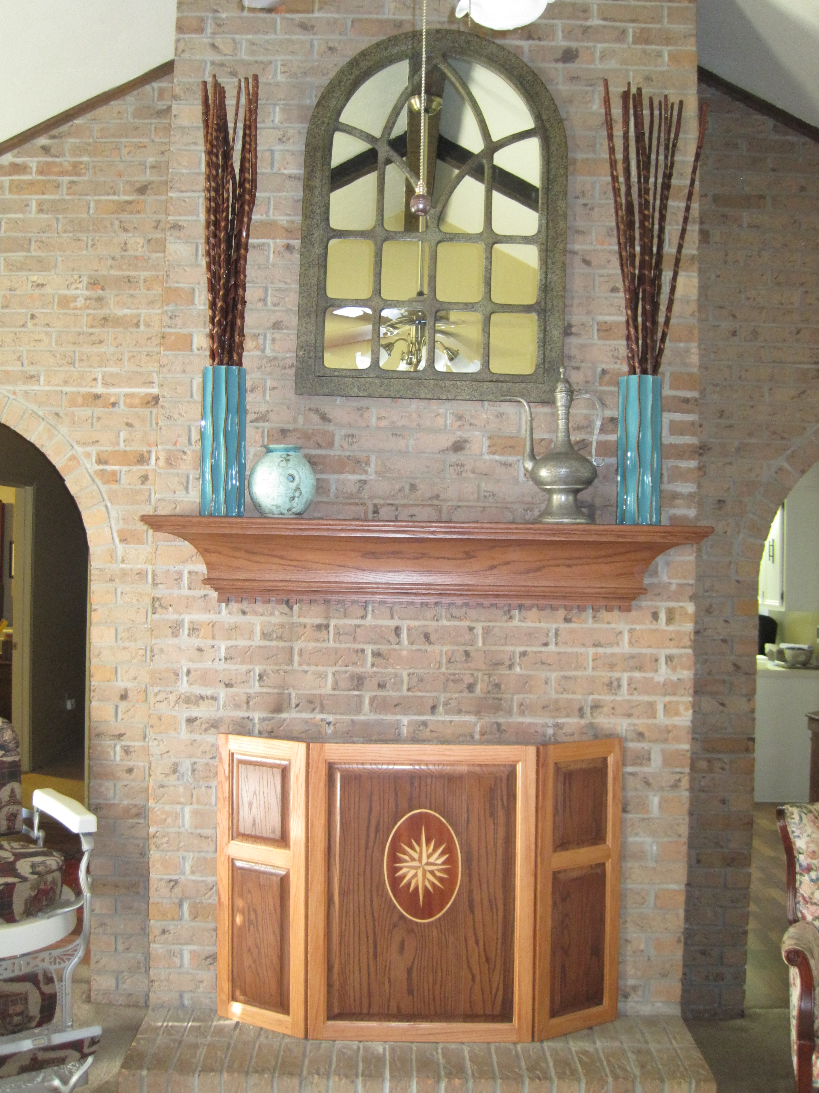

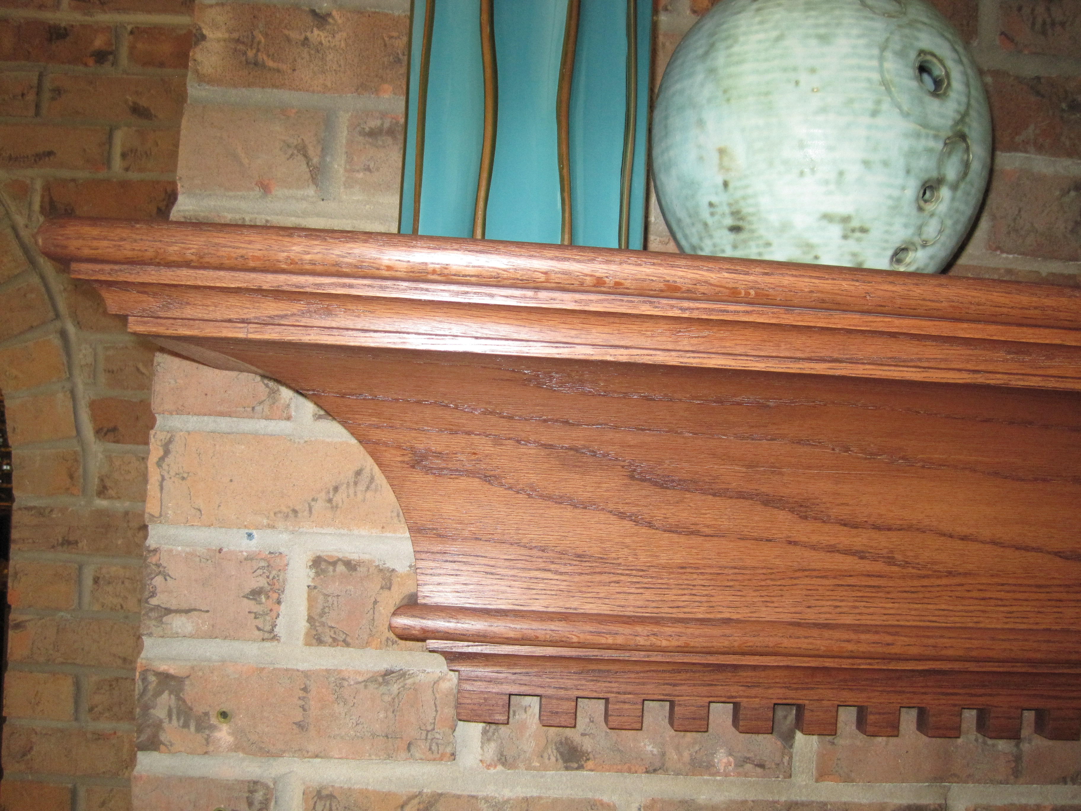

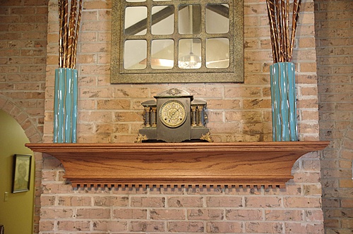

How did you cut that big radius on the mantle...?  (do I remember table saw...?)
22 minutes ago, Nickp said:
Great work, Andy...glad to see ya here...
I'm glad you asked!  Yes, that's a 5 inch radius 90 degree cove.  I stacked and glued the boards in the rough shape of a "U", then passed it sideways over the tablesaw blade many times, raising the blade about 1/32 each pass, to hog off the corners and finish out the 90 degree cove shape.  Tablesaw blades weren't really meant to cut this way, so the blade chattered some, leaving a pretty rough surface.  I dammed up a section of the cove, lined it with plastic wrap and poured it full of plaster of paris.  When the plug of plaster hardened, I wrapped it in sandpaper and sanded the cove with it, starting with 60 grit and ending with 220.  The rest was easy . . .
3 hours ago, DonkeyHody said:
Ingenious...thanks...
The rest was easy, huh... :)
Don't ya just love it, Nick..."the rest was easy"...! Yah, right!

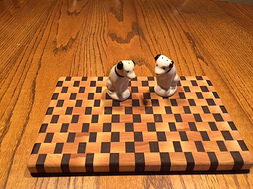

Beautiful work Andy. I have always been a huge fan of anything with the Qbert pattern like in your first cutting board.
