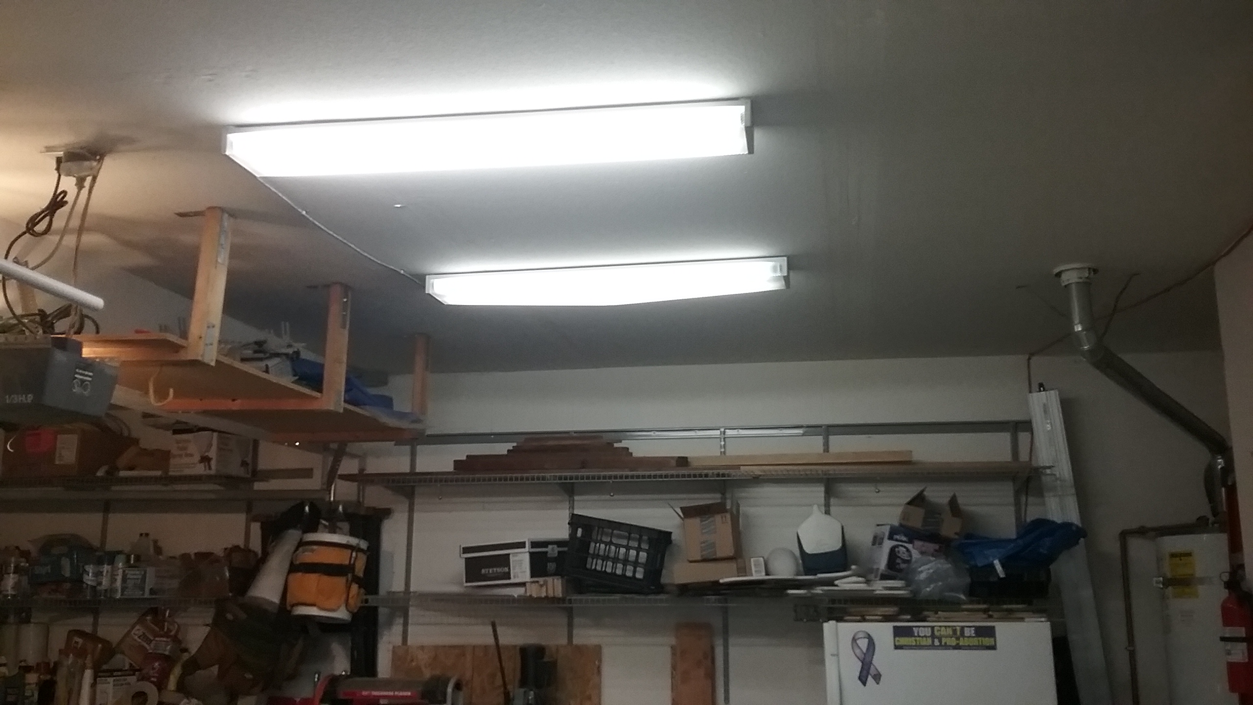

In my 3 car garage/shop I have 5 fluorescent 2-tube lights. Since I have been working  at replacing most of our interior light bulbs with LED bulbs to save electricity and keep the house cooler, I decided to try out a new LED  shop light in my shop. So I picked up a LED shop light that has 2 LED light bars that put out 5000k cool light. The cost was $32 from Sam's Club. I put the light over my primary workbench the new light really blew me away. The LED light is so much brighter than my 2 tube fluorescent lights. So I plan on replacing the other 4 fluorescent lights over the next month. In the picture you can see how much brighter the LED light is than the other fluorescent light.

I have a 3-car garage which is my shop and for parking my wife's car. All of my  large tools are on rollers/mobile bases so that once I pull out my wife's car I have full use of the 3-car garage. I added in a 2nd LED light in my work bench area. I originally had 3 fluorescent 2-tube lights in that area, but now I only have 2 LED lights as they are sooooo much brighter. On the opposite side of the garage where my wife parks her car I have 2 fluorescent 2-tube lights. From the photos below you can see how white the drywall is on the LED side and how grey the drywall is on the standard fluorescent side. I love the brightness over on the work bench area, but they may be a bit too bright where my wife parks her car. Since the LED lights do not have any defuser there is more glare when she is out there doing things. So I will chew on this a bit and see what the next step will be.

There appears to be a noticeable difference in the brightness of the lights. There also seems to be a difference in the color of the light.  I'm wondering whether the brighter produce any glare from overhead. I have been considering LED's. My flourescents  really flicker in the cold weather.
 Being that I live in So. Calif. and don't have colder temps I have never had any cold issues with my garage/shop lights.I really like having the cool temperature LED lights as opposed to the warm temperature lights as the cool lights show colors more true in my eyes.

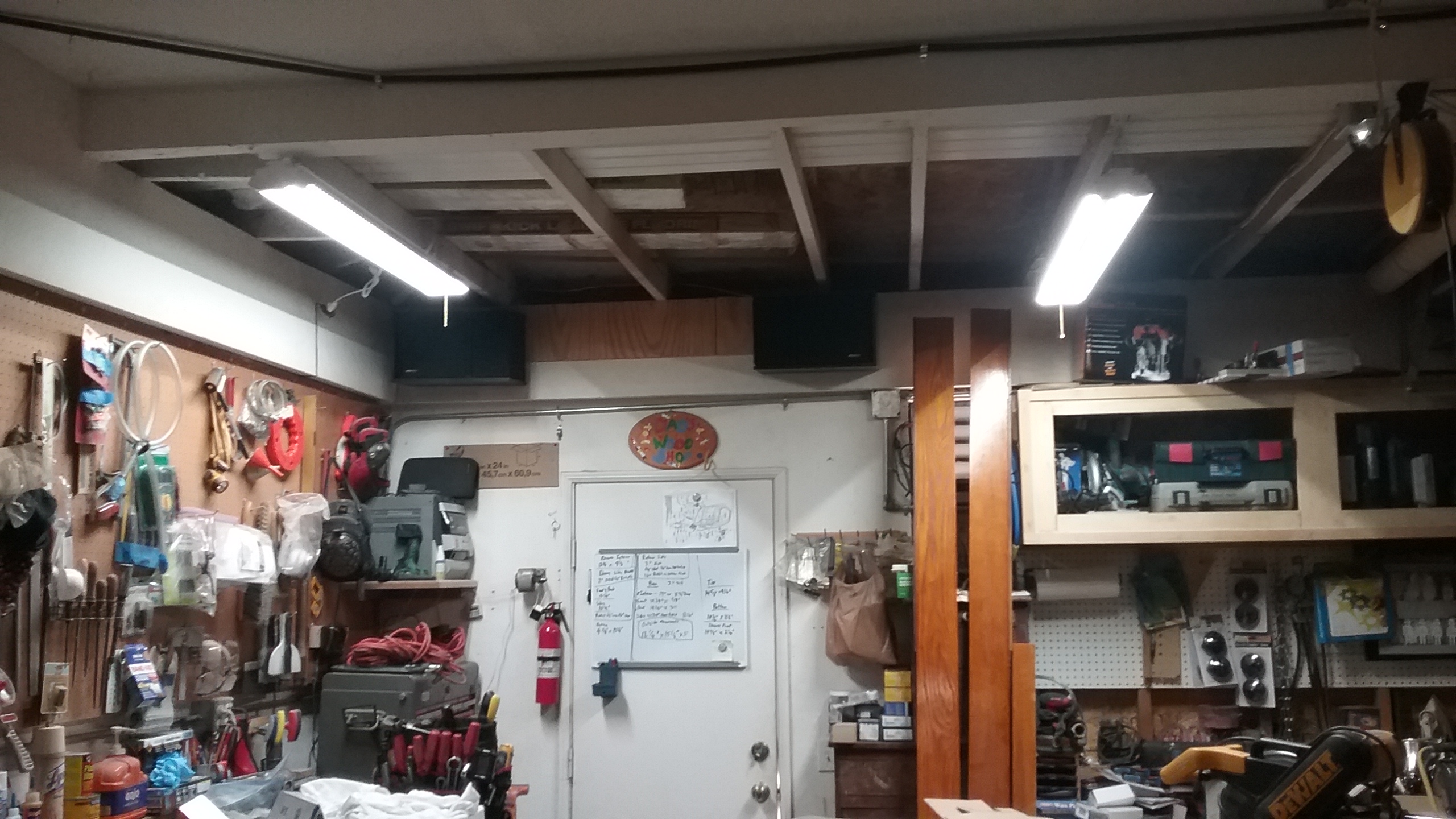

I had 5 fluorescent 2-tube lights in my basement shop and was always changing out burned out bulbs. Plus dust eventually built up on top of the tubes and had to be vacuumed occasionally. I replaced a couple to give them a try and eventually replaced all of them. I found that I only needed 4 LED's to replace the 5 fluorescents. What a difference in brightness. As I age, I find that more and brighter light is very helpful. Only drawback I find is trying to look up to get items I have stored in the floor joists above...jigs, patterns, etc. But one adapts to that easily. For my money (and I haven't even given consideration to electricity usage) the LED far outweighs the fluorescent.
