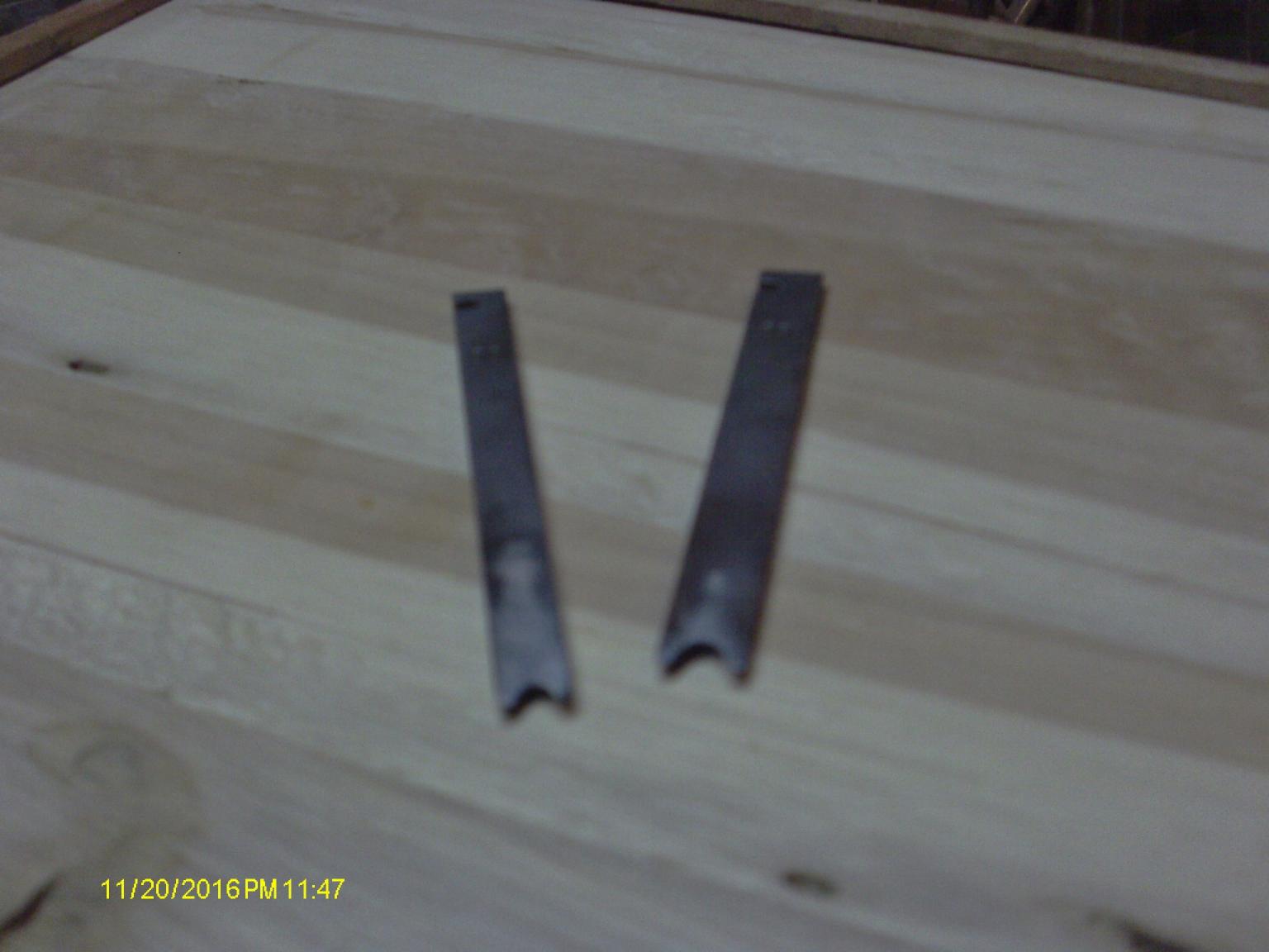

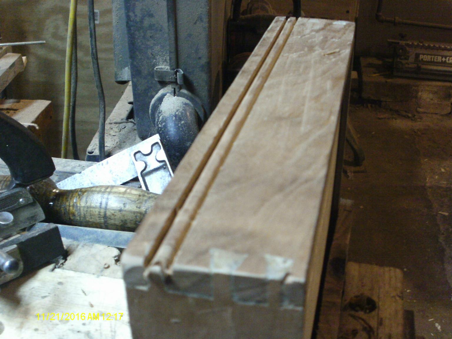

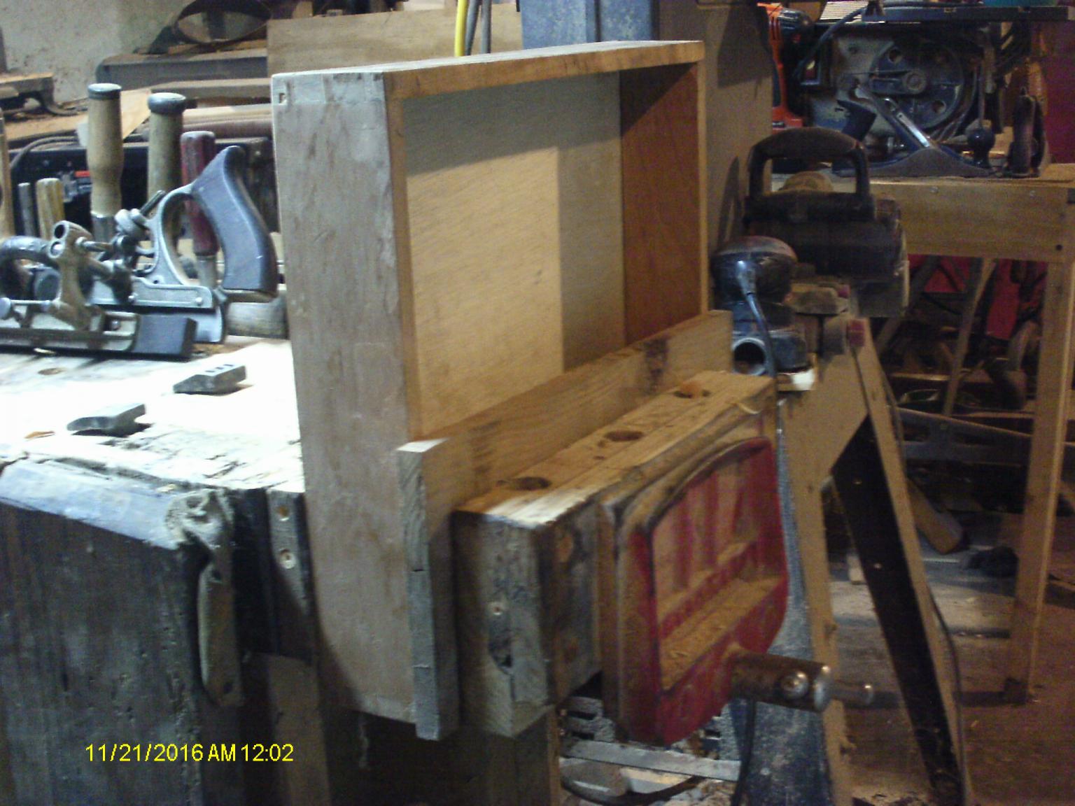

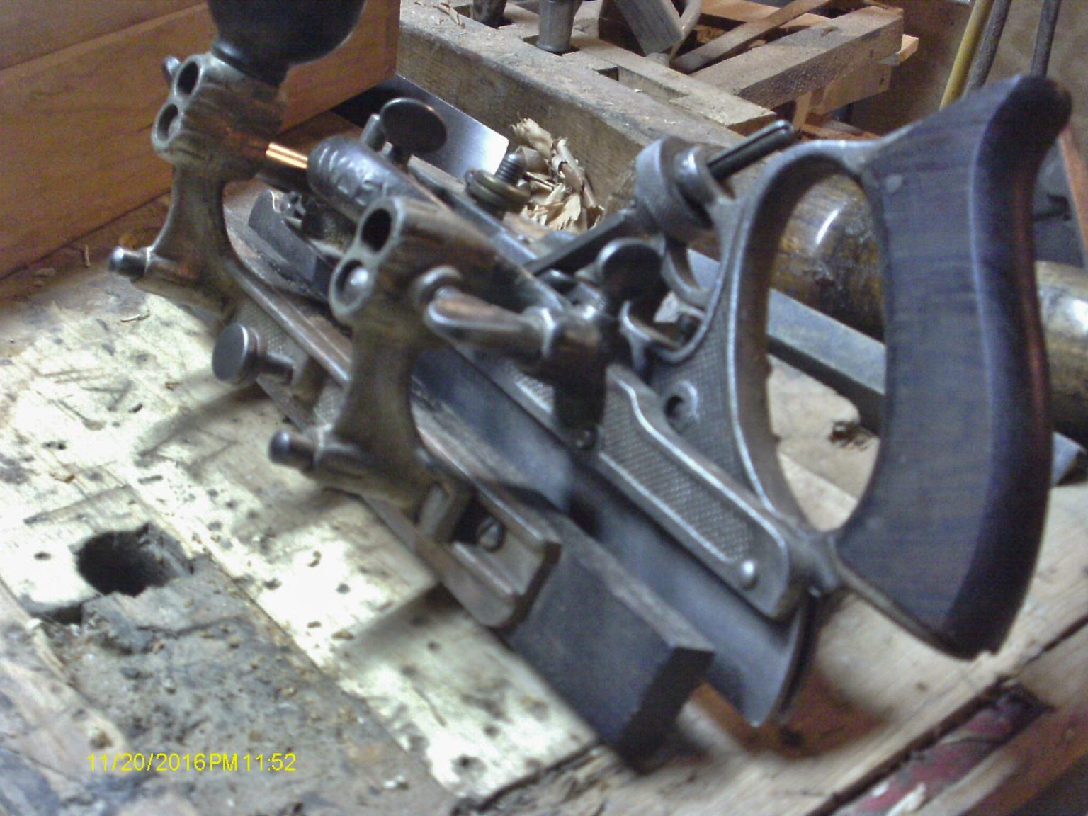

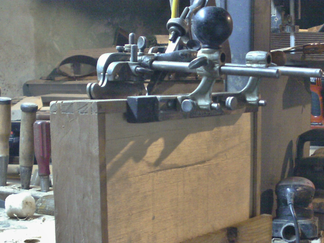

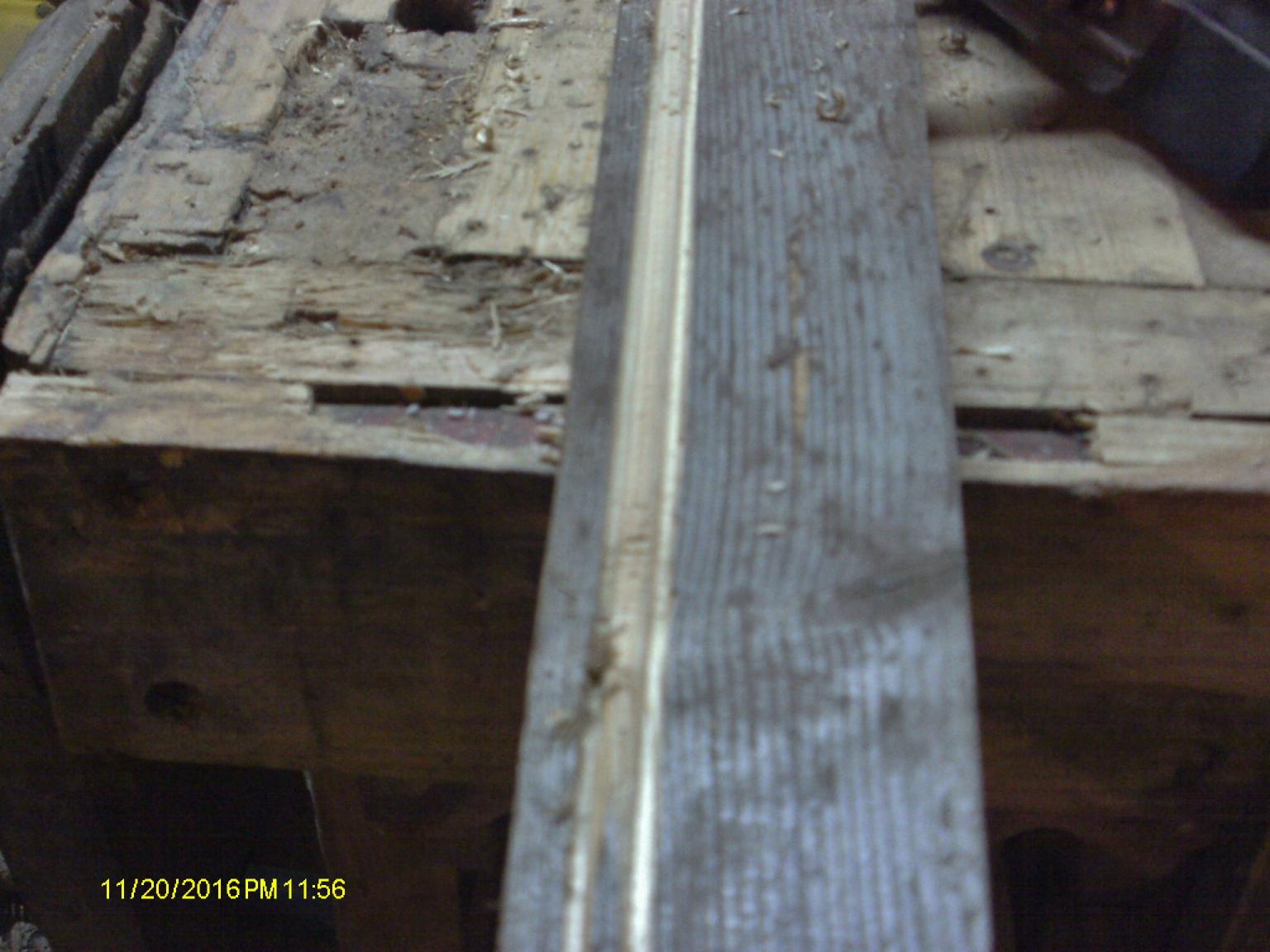

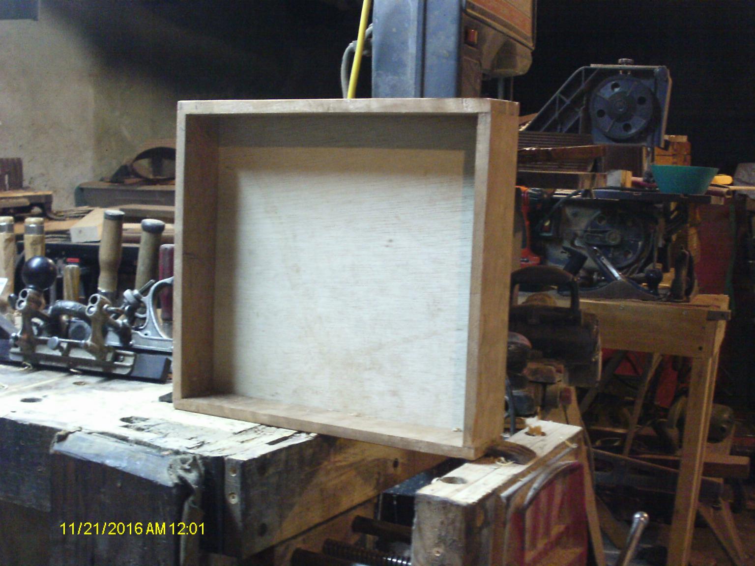

November 21, 201610 yr Author Popular Post comment_84840 Well, got the lid set aside, and went back to work on the box. Switched out the #12 straight cutter for one of these.. A #22 and a #23. Chose the 23 because it was a hair wider. Skates would have their own grooves to slide in. Set up the 45 with short rods at first. And did a test piece... Just some pine scrap. Next was the problem of how to clamp the box... Nope, this won't work, box would just flip right over....tried something else... This seemed to work better. Wide scrap to help clamp across the openings. Then it became a matter of following the grain......short rods weren't getting it done, as I had to span across to reach the other side... Dug out the long rods, and tried them out.. I can always slide them in, or out as needed... Hitting them dovetails was a bit rough. Do one bead, rotate, check grain, and repeat. Kept going until all four sides had a bead. Had to rotate the box to allow grain directions. Useda handsaw to "start" thing around the corners. Will take a bit of sanding to clean up......will wait and see IF I will bead the lid as well. May stick to just one. Dust had fouled the lens on the camera, running the battery down. Guess that means I have to stop...for now? We be getting there.....might be another day or two... Report
