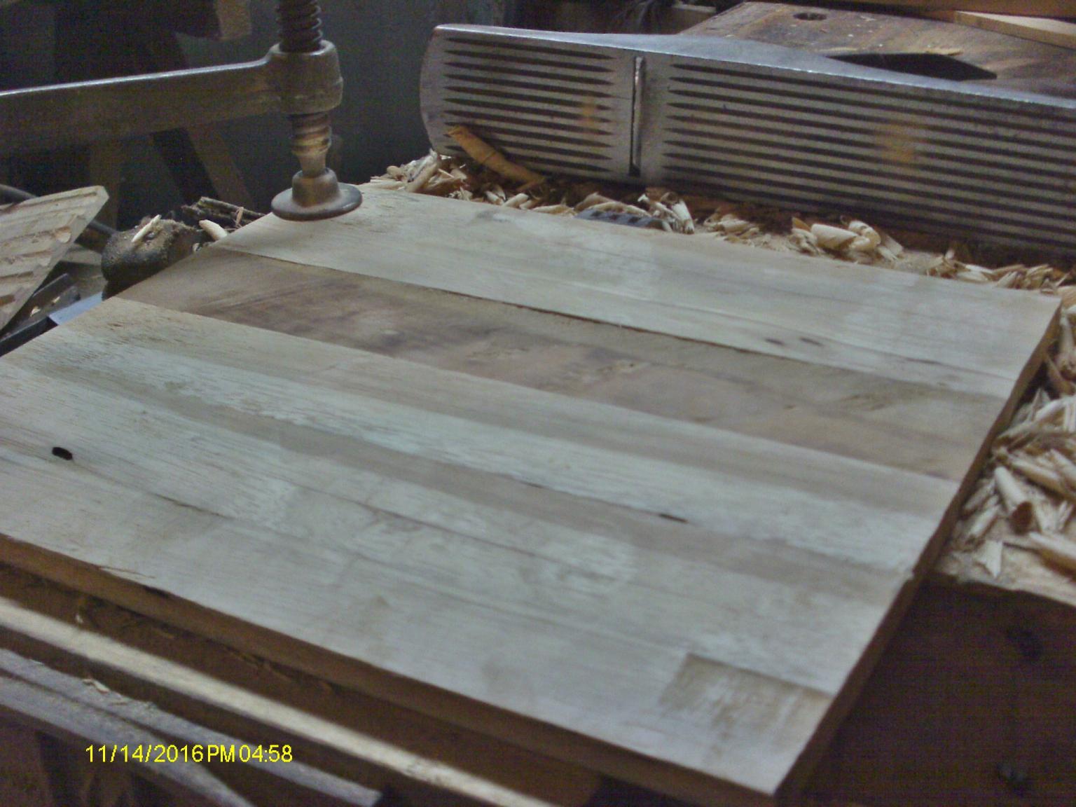

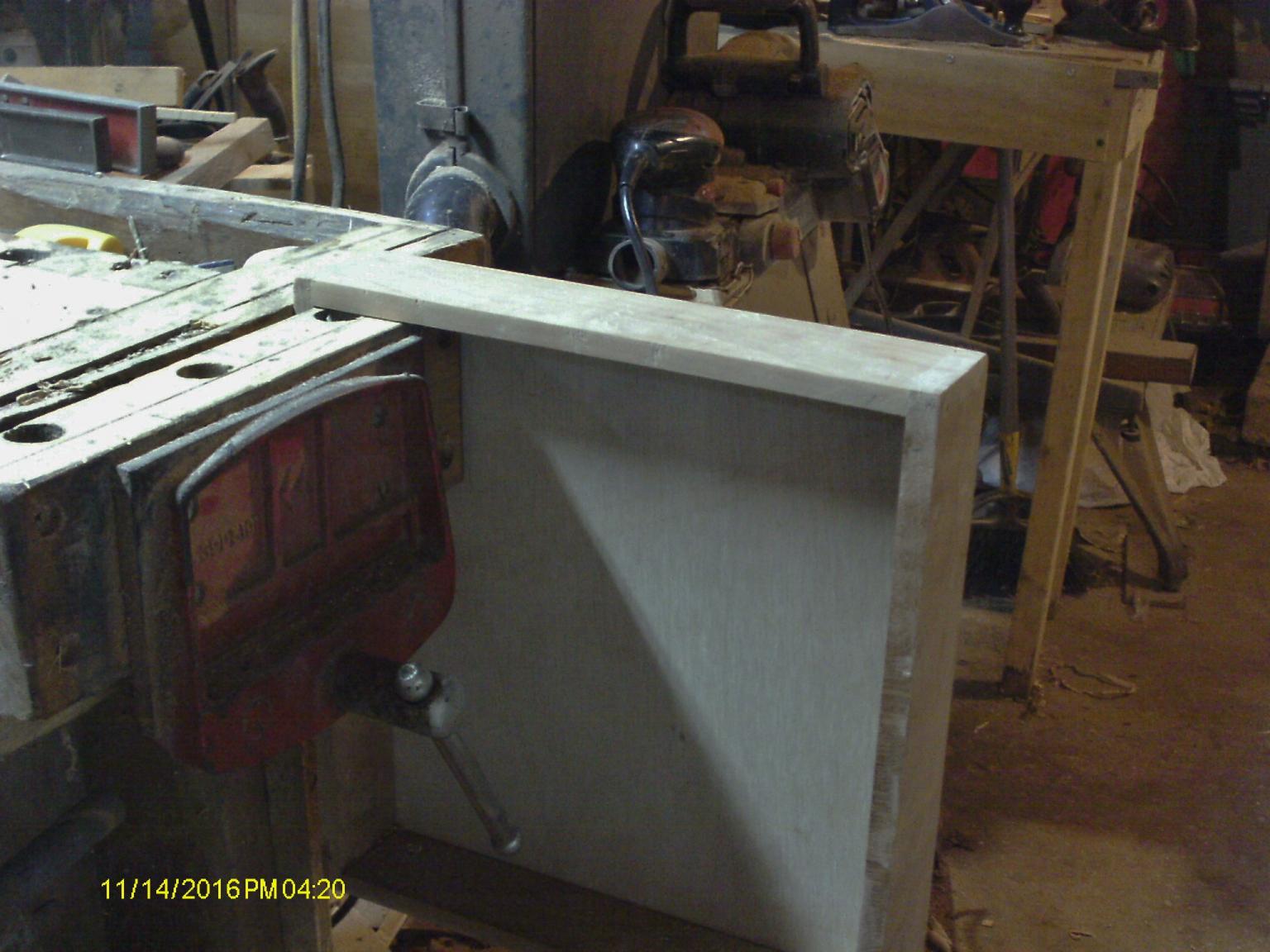

November 14, 201610 yr Author comment_84191 Well, it IS out of the clamps right now.......somehow one side is shorter than the other? Have to work around that , I guess. Set things up to clean the mess up a bit... Seems to hold things still. Glue was dribble into any holes, add a oinch of bandsaw dust, and sand smooth. Then a smooth plane was drug out to the bench... I have to watch how much candle wax I rub onto the sole...speeds things up, but I pulled back too far, and then ran a few knuckles up against a corner....Clean jeans now have a "Blood Stripe" Not too bad, though. Worked all four sides like this, then plopped the box on it's bottom.. And worked on these edges a bit. Couple were high on a corner, or two...I think this will do, for now. Started work on a panel... Not the prettiest girl at the dance, but, we have ways... The ironon this old Stanley #5c has been ground to a 8" radius, just for this sort of work....then followed up with the smoother Also going at the diagonal. Some places were a bit stubborn...100 grit beltsander took care of that. Trimmed the long ends to a bit closer to what I need. Rotated the panel, and smoothed some more. Doing both faces. Whichever one looks the best, will be the "show" side... Might be this one? hand was getting sore, back was getting stiff, I WAS going to do a bit on the parts for the lids frame.... All I got done was cutting these to length. That bead will be planed off, when I make the panel into a raised panel. I think I can take a break for awhile...stay tuned... Report
