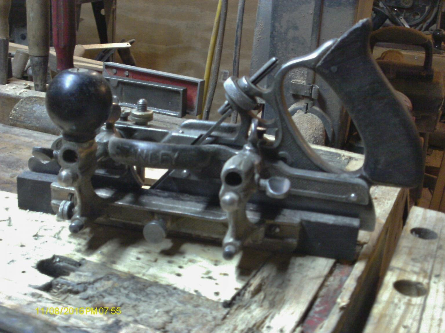

November 9, 201610 yr Popular Post comment_83368 Ok, kind of a "part 2" to that long thread. Camera still has issues, but I think Santa might get one for me...someday. Dovetails? Well, we did a few today Once I got the pins done, I could use them to lay out the tails Pencil to make the marks, then bandsaw to saw on the waste side. Quicker and I can see what side of a line I'm on. Test fitting as I went. BTW, waste was usually just chopped out with a chisel. Will fine tune all four corners..Tomorrow. Checked things with a square, too, Doesn't take all that long to do these things, either....finally got all four done.. I'd got this far earlier today, when the camera went dead. Came back down after the camera had charged back up. Time to clear the deck....set the frame over on the lid panel.... Both will need a bit more work. Rigged up a jig.. That big old "B" tells me that is the bottom of the side. I went through and labeled all four this way, while they were assembled. Joint numbers were marked at the top, too. Why the jig? Well, I had a Stanley #45 to use. It was still set up from the last job. Long rods, cam rest, wider cutter..all went back into the case. Short rods, and a 1/4" cutter was installed.. They are a PITA to set up, but once they are, they work very nicely..IF you don't set it too deep. Candle wax was rubbed onto the skates and the fence,,,and away we go.. Could have not used the second skate, but it balances better with it. I start at the far end and work backwards until the depth stop rides the full length. And this is what usually happens Screw is there to lock things into the jig. I wasn't always going with the grain on this.. But I can make curlies. I checked to make sure this grooves lined up as I went around the box.. Not too bad. Better than what I used to get with the router table.. So, all four sides are grooved and things match up, bench is still cleared off... And...this is as clean as it gets. Maybe tomorrow, I can fine tune the dovetails? Need to go and buy a 1/4" plywood bottom piece. All out of the thin stuff. Once I get the sides tuned up, I can cut the bottom panel to size, and maybe do a glue up? Right now, just a bit tuckered out... Report
November 9, 201610 yr comment_83370 Cool beans...I'm amazed at what you can do with that 45. Do you have the full compliment of cutters for it. Love seeing the projects you use that on. I'll stay tuned. Report
November 9, 201610 yr comment_83374 Be my luck I'd forget to drive that "dog screw" in far enough and take a hunk out of the plane iron. Nice dovetails! Report
November 9, 201610 yr Author comment_83375 Have the full "basic" set of cutters......about 24 of them, counting the slitter. Have both "match' cutters, and the sash cutter. This is most of them....have since added a few others. Report
November 9, 201610 yr comment_83378 5 minutes ago, steven newman said: Have the full "basic" set of cutters......about 24 of them, counting the slitter. Have both "match' cutters, and the sash cutter. Sweet...I've seen a few of the planes here & there, but most are pretty rusty, maybe one or two cutters...usually with none of the fence parts and always with a hefty price. You've got a nice set and very nice plane. Report

November 9, 201610 yr comment_83471 I gave up on using my 45, but reading your post I will have to try again. I have a box of hollows and a box with straights varying sizes and some moulding cutters . I think one box was missing a cutter. Love these pip's you do.- Report

November 9, 201610 yr comment_83480 1 hour ago, Gerald said: I gave up on using my 45, but reading your post I will have to try again. I have a box of hollows and a box with straights varying sizes and some moulding cutters . I think one box was missing a cutter. Love these pip's you do. Nice looking 45 Gerald...love looking at these type of tools you guys have...some people like looking at golf clubs and such...I can't get enough looking at old tools...must be a vitamin deficiency. Report
