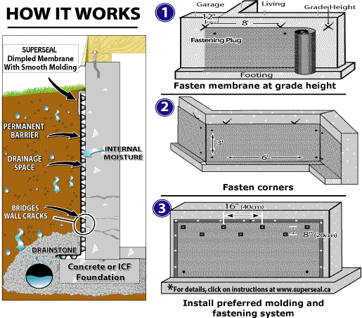

October 7, 201610 yr comment_77769 3 hours ago, Fred W. Hargis, Jr said: I wouldn't call a plumber for such a task neither would I.. 1 hour ago, Gene Howe said: As I understand, permanent basement water proofing is done from the outside of the wall. Today, it's done through injection of a sealing substance around the perimeter. In addition, hydraulic cement is injected into any cracks visible in the interior walls. Then it's plastered with waterproof masonry cement. Finally, insure guttering and downspouts direct rainwater well away from the structure. As Fred said, it ain't cheap. definitely on the exterior method of waterproofing... VOE says that the injection system misses and leaves voids in the waterproofing... nothing beats a quality membrane... interior waterproofing masks problems that will propagate and matters will only get worse.. more VOE... A boat load of waterproofing details.... the fix details.... Report

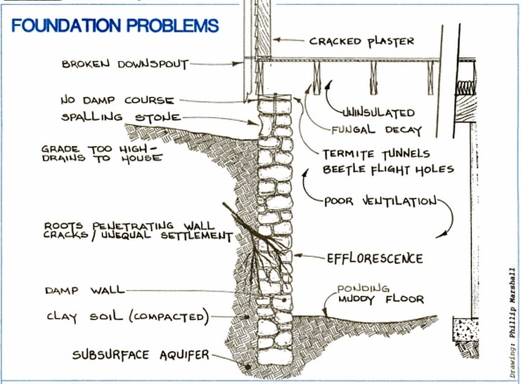

January 10, 20179 yr comment_92172 Welcome to the forums. Is the basement block, stacked stone, stone set in cement, ??? Is it mostly dry now, dry all the time but feels damp-ish?, wet, flowing water? I have to agree than an exterior seal with probably the the best long term unless... you have a generally dry block basement with no running/standing water problems...in which case i would paint the inside walls of the basement with something like UGL Drylok and get a dehumidifier. Do you know if there is currently any footer drain on the outside (like in Stick's picture?), and sump pits if needed? In any event, i would NOT store or exhibit my art work in the basement space even when dry and definitely use "conditioned" air in the upper level(s). Report
