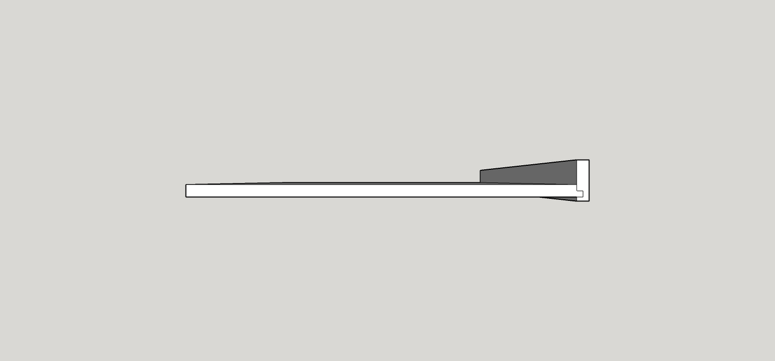

lew Posted October 5, 2016 Report Posted October 5, 2016 I usually do this Makes for a really strong cabinet HARO50 and FlGatorwood 2 Quote

Gerald Posted October 6, 2016 Report Posted October 6, 2016 Another option is a rabbit in the face frame to add more glue surface and reduce racking. This would make the face frame set 3/8 to 1/2 deeper into the cabinet depending on how deep the rabbit is. HARO50 1 Quote
Stick486 Posted October 6, 2016 Report Posted October 6, 2016 (edited) 2 hours ago, lew said: I usually do this Makes for a really strong cabinet me too and yes it does... sometimes full dado and not a rebated one... 23GA pins are placed sideways and not through the face... Edited October 6, 2016 by Stick486 HARO50 1 Quote

Gene Howe Posted October 6, 2016 Report Posted October 6, 2016 Lew's method is the way I've always done it. However, a full dado in the FF would be an alternative since the carcass is built already. For "sizing" on the plywood edges, watering down the glue isn't really necessary. Just an ultra thin coat, spread and pressed in with a finger or credit card will do the trick. FlGatorwood 1 Quote

Stick486 Posted October 7, 2016 Report Posted October 7, 2016 full ¼'' deep dado face frame.. makes for a major rigid box and seriously straight panels.. glides fitted for drawer face and doors dust lipped... drawer faces are not add ons and are integral to the drawer construction... Nickp 1 Quote
