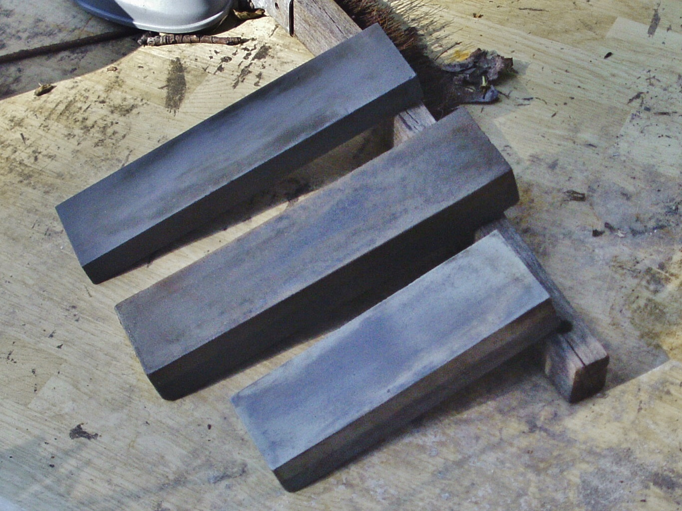

October 5, 201610 yr comment_77485 Have three (that I can find at the moment) dried out and crusty oil stones. I tend to use oil stones when I sharpen things up. There was a discussion about sitting the stones in Vaseline, in a pan. Sitting the pan in a 200 degre oven for an hour. This is supposed to repack the stones so any honing oil won't just disappear into the stones. Hmm, mine are well dried out. But, IF I go "baking " Vaseline in the Boss' oven.......I might get shot. Besides, the Pumpkin Bread would taste a bit.....funny. Found a plastic tub, and some Quaker State 10W40. Dropped the three stones into a layer of the oil. And just let them soak awhile.. Bubbles came right up. Had to go out every hour or so, and flip them over. Have to keep sloshing the oil around, to keep an even coat. Plan is to give them a nice long soak, them towel them off. Them see how they work. All three are coarse grit stones. 3in1 oil would just soak right out of sight, before I could get a bevel on the stone. Goal is to slow THAT down, to where the 3in1 will stay on the surface, long enough to be of use. Will update as things go along. Stay tuned..... Report

October 5, 201610 yr Author comment_77492 Stones are now out of the bathtub......paper towel to wipe them off. Now sitting in the sun.. Have since taken a clean paper towel out and placed it under the stones. Later, I may need to build a few boxes for these.... Report

October 5, 201610 yr Author comment_77496 Actually, I want the stones to Gunk up inside. Maybe when I put the 3in1 oil on the outside to hone a blade, the 3in1 oil will stay out on top of the stones. Before, that lightweight oil would just soak right in, and UNDER the surface. leaving a dry stone. hard on the ears, all that screeching of steel on dry stone.... MRI next Tuesday, wait another week to see what the Doc says is wrong. Then schedule a day in the hospital to fix things up. SLOWLY get there... Report

October 6, 201610 yr Author comment_77554 The "Theory" is to bake the vaseline into the insides of the stones, to "seal" them up. That way, the light weight honing oils won't just get sucked down into the stone, never to be seen again. Seems when the stones were made at the factory......a "petroleum-based" product was baked into the stones. Mainly to seal them up. That way, the honing oil would stay on the top of the stone, where it would do the most good...... I doubt IF I would ever be allowed to use the oven.....and there isn't a heat gun in the house. I used that heavier oil to soak into the stones, as the honing oil would be lighter. So far, very little oil has seeped back out, stones even look better. Letting them sit awhile, then next Sharpening Day, they will get a thorough try out. All I could do was just try this out, cheap stones so I wasn't out much. The oil was for the mower. So, very little outlay. I can save the Vaseline for...other uses..... Report

October 7, 201610 yr Author comment_77695 Ok, stones have set for a day. No oil leaks spotted, stones look good. Have a friend, who contacted the people that make these stones. He got a return call today from them. Was told that they do NOT use petroleum Jelly/ Vaseline in their process. They use an oil fill process. They also recommend against using the Petroleum Jelly/ Vaseline in their stones. Also note: Heated Vaseline in an oven can create a FIRE HAZARD. Even in an electric oven, let alone in a GAS oven. Report
