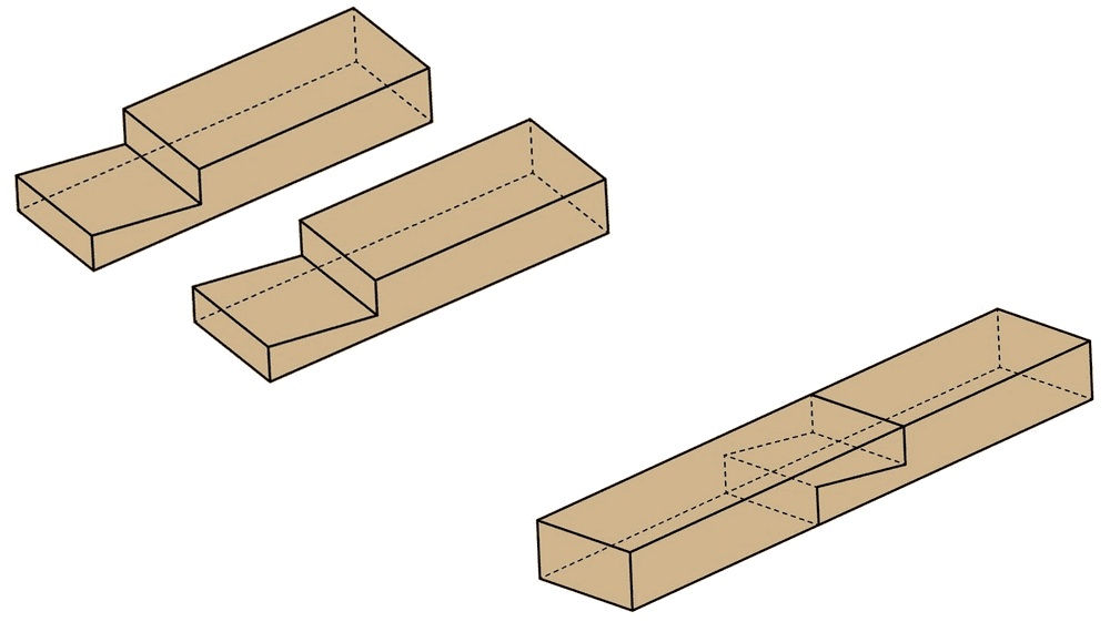

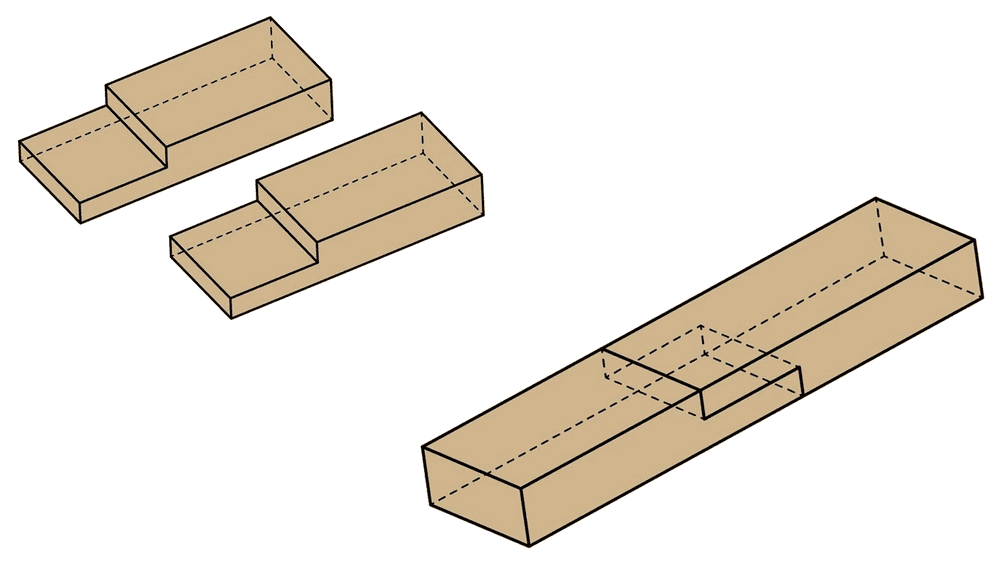

October 3, 201610 yr comment_77202 Good Evening Friends, How many remember the following? A scarf joint? A saddle joint? A blind joint? A bridge joint? 5 points for each correct answer and a description of each. Report
October 3, 201610 yr comment_77208 A scarf joints... dove tail... stepped... standard... half lap... and there are many many more... A saddle joint... A blind joint... A bridge joint... know it as a control joint... a FJ w/o glue/fasteners to allow movement in materials... Report

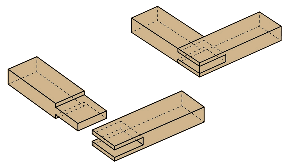

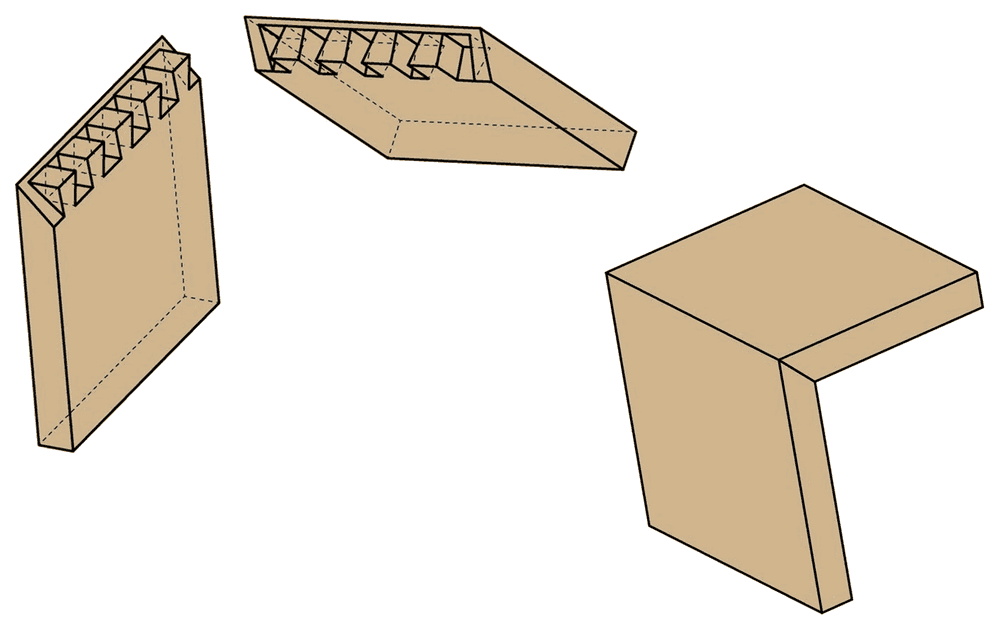

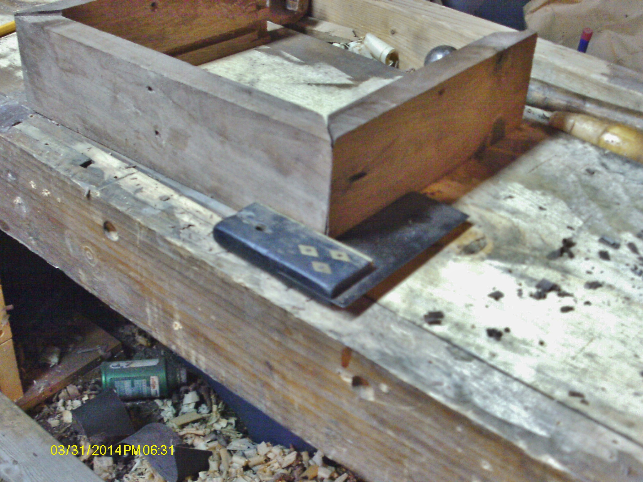

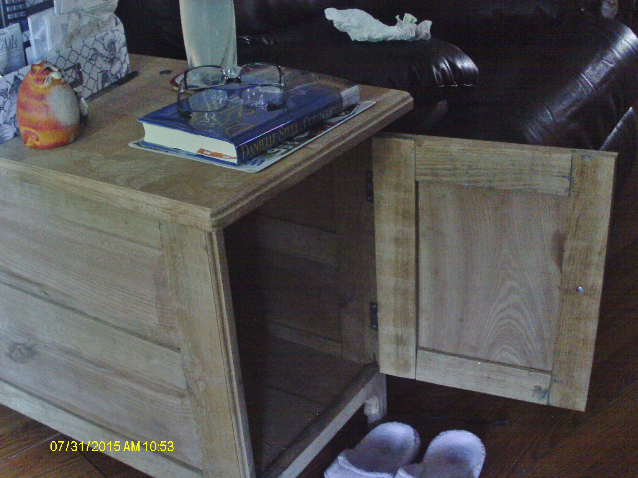

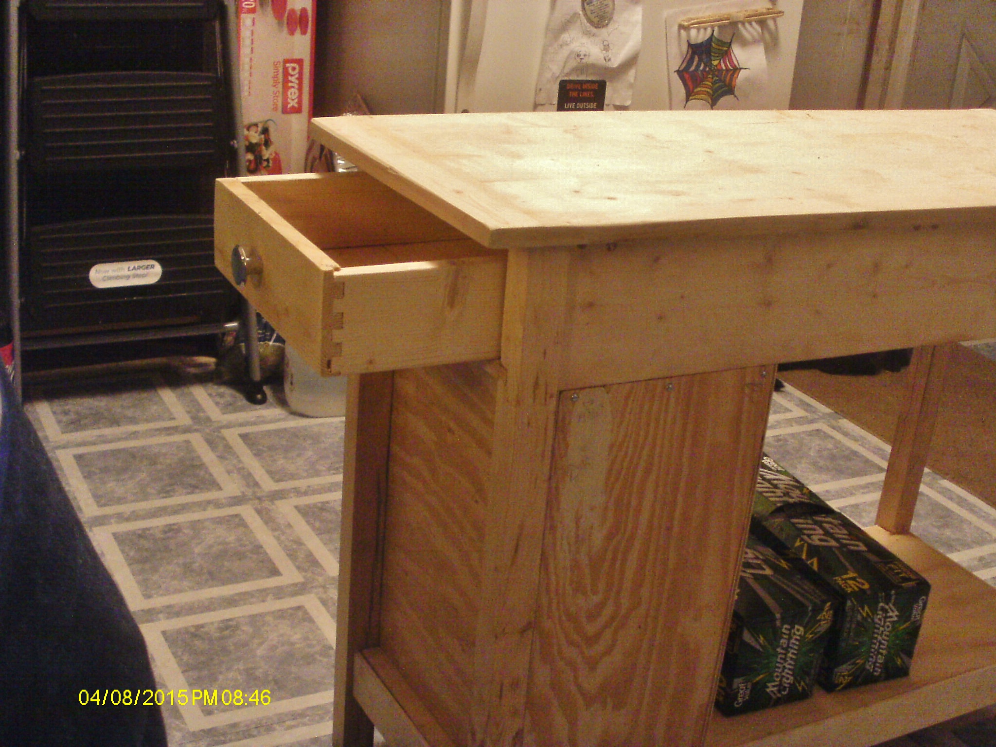

October 4, 201610 yr comment_77225 Saddle joint......sometimes called a bridle( as in horse) joint.. Joints for this door. Open ended mortise, tenon goes all the way through. PITA to get them to fit just right Scarf joints, use them on baseboard trim, to hide where two "sticks" are joined. Angled so when you walk into a room, the joint stays hidden Blind joints......either half blind for dovetails, like for a drawer.. Or, full blind dovetails, aka secret mitre joint. Not too sure about "Bridge Joint". Unless it is for hanging crossbeams in a pergola. Secret mitre never was my strong suit.. Hard to do for the tools I use. Report

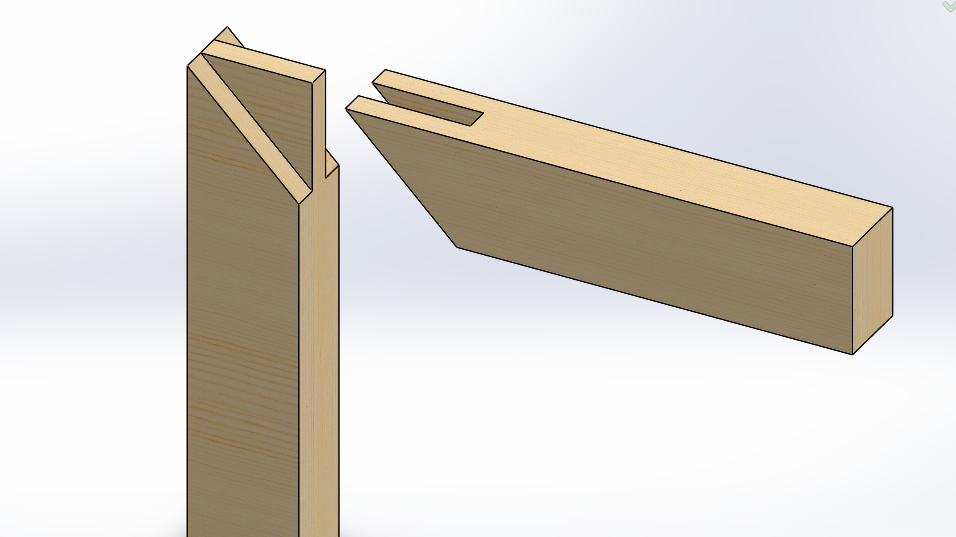

October 4, 201610 yr comment_77233 stopped bridle... full.. mitered.. regular... which is also called and open through M&T... Report

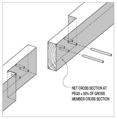

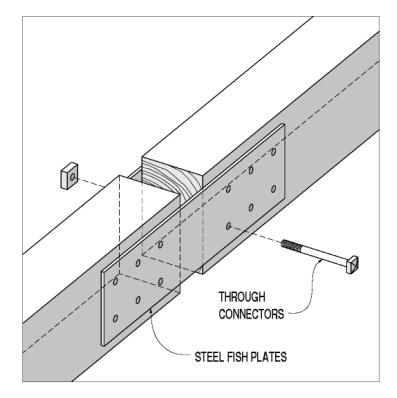

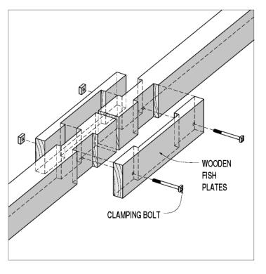

October 6, 201610 yr comment_77671 another joint that is called/considered a bridge joint but I know it as a pegged lap/scarf joint.. another.. but I see it as a plated butt joint... yet another... just for the Hades of it.. Report
