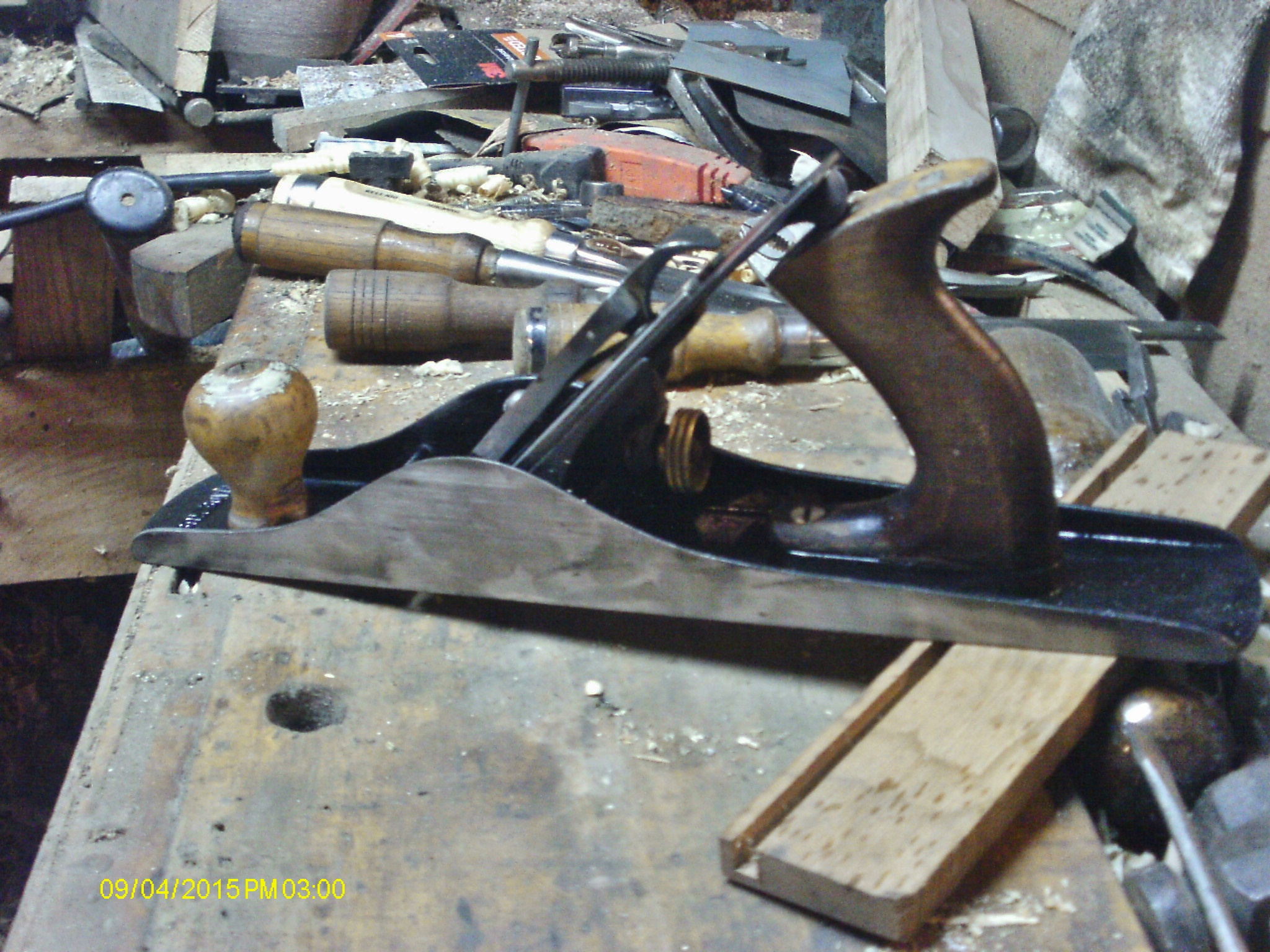

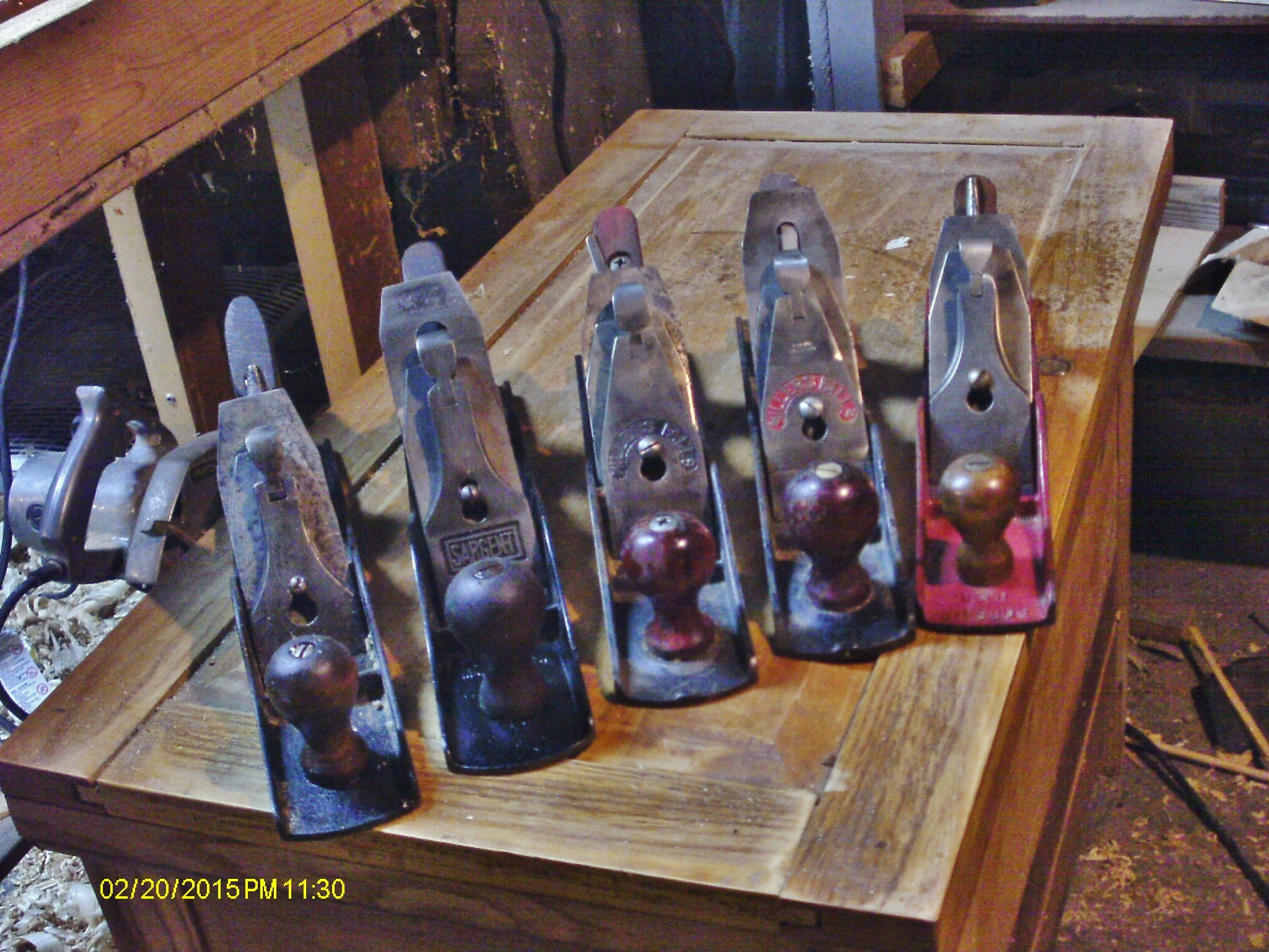

September 30, 201610 yr comment_76623 Well, on THAT note.....I guess I can keep the jack plane I WAS going to send him. Was going to give him a choice, too. Oh, well, easy to spend other people's money for them... Older shot. Red one is the scrub jack. Sold the left Millers Falls, and the Sargent. So, nowI have 1 Millers Falls jack, that Red Jack, and two older Stanley #5 jack planes. The far left? ParPlus No.5......also sold. For some reason, Sargent planes don't seem to stick around the shop very long. This is the #5c stanley. The other is a bit newer, and has a smooth sole. The c model has the schwarz camber, the smooth sole just the corners, Report
