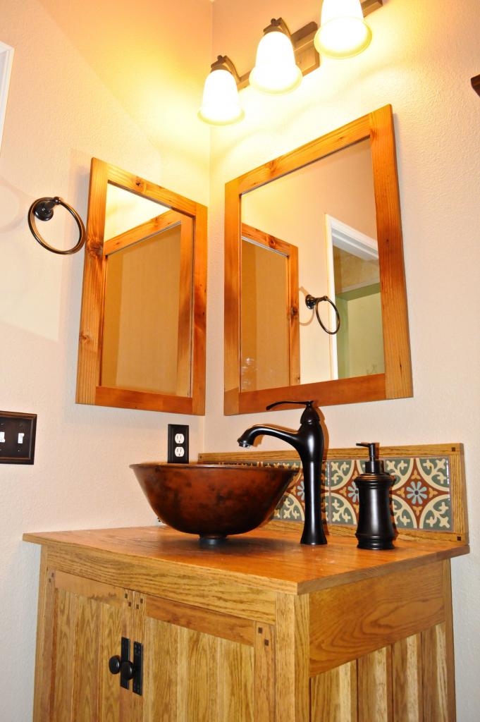

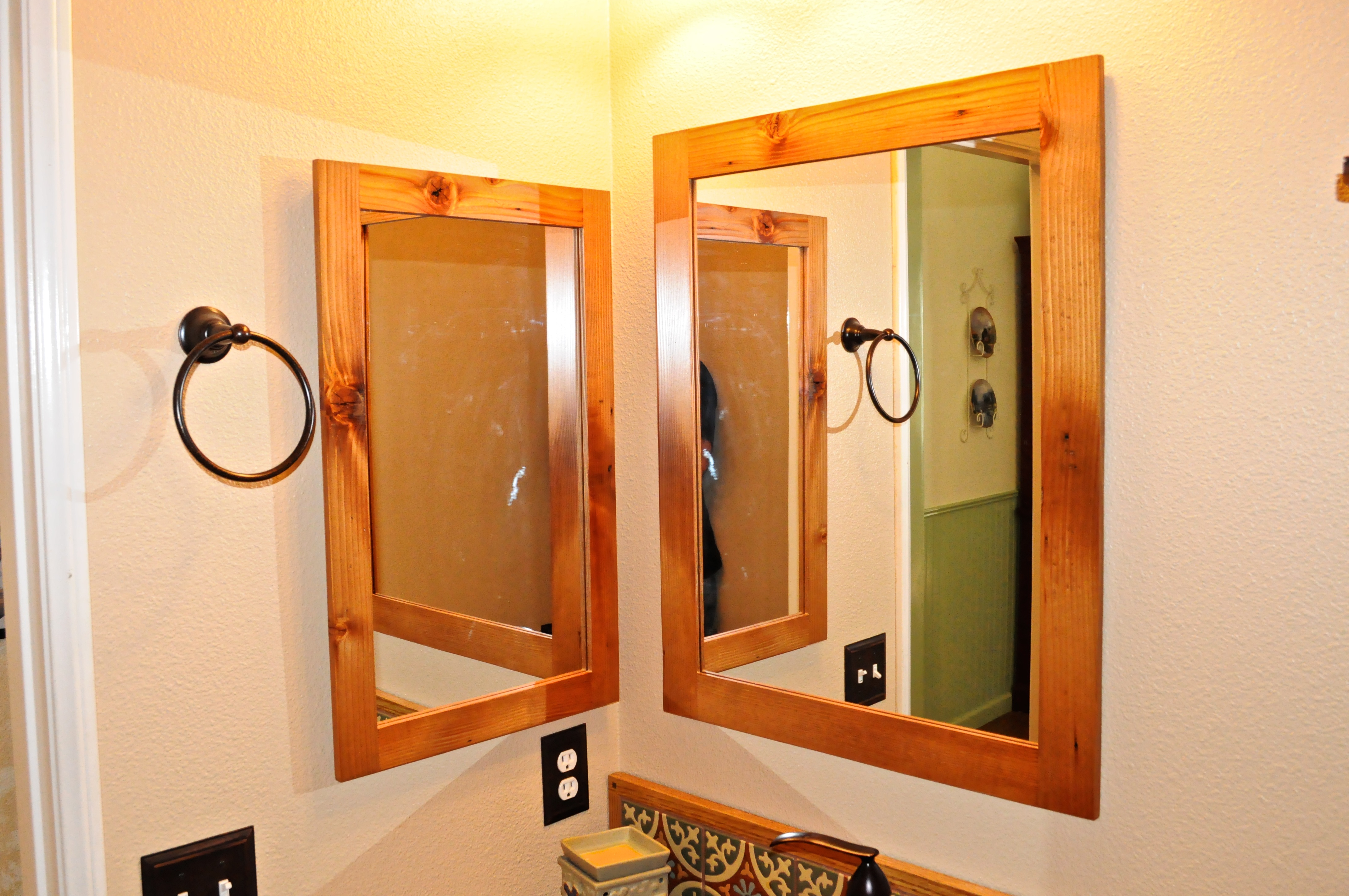

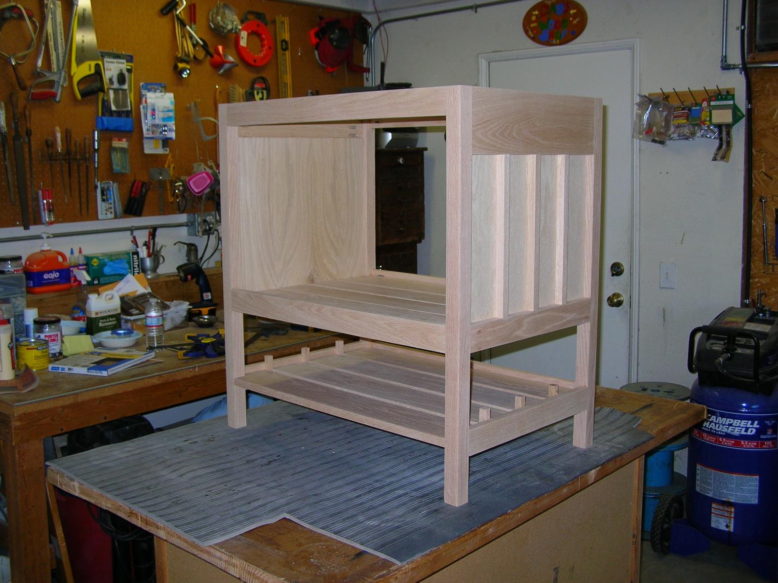

Allen Worsham Posted September 26, 2016 Report Posted September 26, 2016 5 years ago I did a renovation of our downstairs 1/2 bath. It was basic "Builder Standard" with the oak vanity and white solid-surface top/sink as well as a glued on sheet mirror on the wall and the plain metal medicine cabinet. Since we have more of an "Arts & Crafts" theme going on downstairs in the Family Room, I wanted to do something to tie it in better than the original stuff. So I went online and found some vanity designs that I liked and then ran them by my wife for her approval. Once I got my wife on the same page, I went to work building it. The vanity is all red oak with a top mount copper vessel sink and a copper faucet. The mirrors and shelf were made from some reclaimed Douglas Fir that were leftover from another project and the wood was originally from a barn that was built in the later 1800's. Prior to installing the new vanity and mirrors, I patched the walls and sprayed new texture on the walls and painted as well as adding in a new light fixture. John Morris, Nickp, Chips N Dust and 1 other 4 Quote

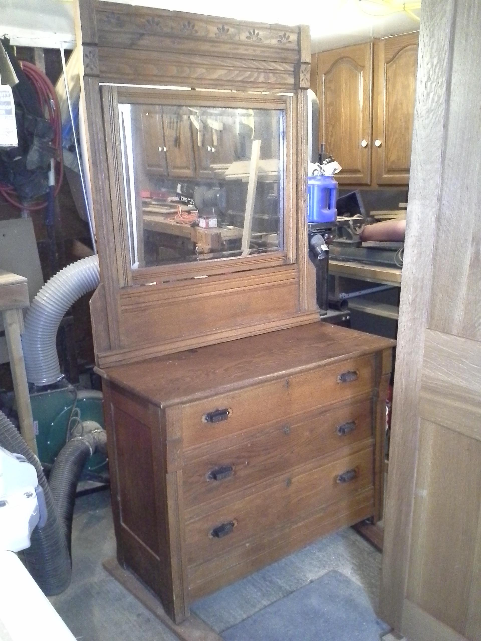

Snailman Posted October 4, 2016 Report Posted October 4, 2016 First, Allen, WOW! I really like your design. I'm planning a bathroom remodel at some point and want to do a vessel sink, but I bought and Eastlake style vanity and mirror I plan on reviving to use as the base. Second, Fred, WOW! I remodeled my kitchen a few years back and built my own cabinets, but didn't follow Norm's plan. I basically followed the dimensions of the existing cabinets, and where I had to build them where none existed, I just took measurements and went from there. As you can tell from the photos, I'm a huge fan of inset door and drawers. I've since added baseboard molding to the bottom of the drawer units to match the rest of the room. (I'm not the best photographer) Third, when I redid my half bath, I didn't have enough wall space to 'comfortably' hang a paper dispenser, so I took on my 1st (and only to date) lathe project. I made it out of some scrap 2X douglas fir I had on hand. I glued up a 3x3 blank for the center post, cut the feet out of 2X stock. Turned the uprights out of 2x2 material, and used a mahogany plug to hide the screw hole. Gets the job done. Stick486 and Nickp 2 Quote
