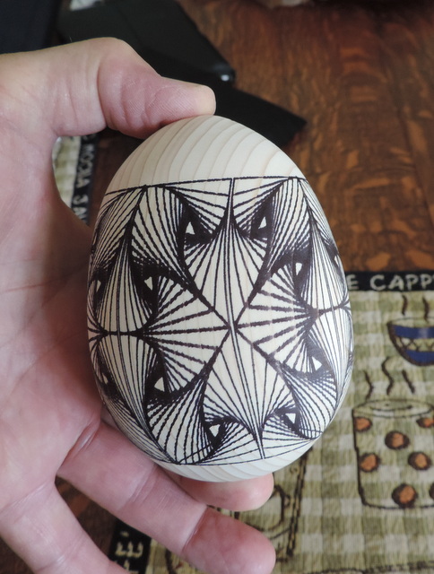

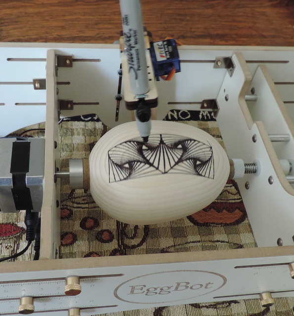

September 15, 201610 yr Popular Post comment_74224 That, and I haven't had a lot of time to play with this thing. Decided this morning to make time and turned an egg. The pattern is one that is included with the eggbot software. Took about five minutes to set up and probably about that long to draw the pattern. Steve Report

September 15, 201610 yr comment_74253 Wow is that something. I am surprised the ink didn't bleed more. Report
September 15, 201610 yr Author comment_74280 2 hours ago, lew said: Really Neat! Does the EggBot attach thru a USB cable? Windows or Mac? Lew, it does attach with a usb cable. I am using a windows machine but I'm pretty sure there is a mac version. The software is an add on for inkscape Steve Edited September 15, 201610 yr by Steve Krumanaker happy fingers Report
September 15, 201610 yr Author comment_74281 2 hours ago, HandyDan said: Wow is that something. I am surprised the ink didn't bleed more. Yea me too, especially considering the wood I used. It's from a 4x4 fence post Menards sells. It's called "whitewood". I suppose it's some kind of pine but it's very light and not dense at all. I'm sure the results would be even better with hard maple. Steve Report

September 16, 201610 yr comment_74385 Spectacular Steve! I'm amazed you get that kind of performance from a thin line Sharpie felt tip. You probably have already thought or tried but how artist ink drawing pens (and maybe pencils) as the stylus? Hobby Lobby and Michael's seem to have large selections. That ink might be "burnable" or offer an interesting color or shadow line. But, I'm no artist so just guessing. Report

September 16, 201610 yr Author comment_74399 7 hours ago, Grandpadave52 said: Spectacular Steve! I'm amazed you get that kind of performance from a thin line Sharpie felt tip. You probably have already thought or tried but how artist ink drawing pens (and maybe pencils) as the stylus? Hobby Lobby and Michael's seem to have large selections. That ink might be "burnable" or offer an interesting color or shadow line. But, I'm no artist so just guessing. Thanks Dave. I have tried artist's pencils but it was still hard to see, I'm hoping to find some with softer lead than the ones I already have. The reason I want to use pencil is because, even when I draw the pattern by hand my burn lines seldom line up exactly. That makes it important that I can erase what doesn't match. For the record, I really appreciate your ideas and suggestions, please keep them coming. Steve Report

September 16, 201610 yr comment_74473 Steve I had an idea when you said there was no finish. How about if you shellac the egg then use the sharpie on it , burn it. When removing the shellac which is easy to do will that remove the sharpie marks? Report
September 16, 201610 yr Author comment_74525 2 hours ago, Gerald said: Steve I had an idea when you said there was no finish. How about if you shellac the egg then use the sharpie on it , burn it. When removing the shellac which is easy to do will that remove the sharpie marks? Gerald. Thanks for the idea, at the very least it's worth a try. Ideally, I'll figure out how to make a pencil work well enough to see. If I can't do that your idea at least gives an alternative to try. Steve Report
