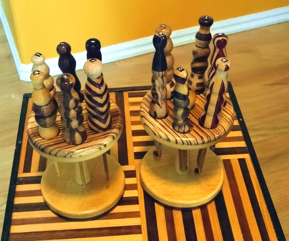

Ron Altier Posted September 10, 2016 Report Posted September 10, 2016 My wife is a very active in Crochet, knitting, quilting, etc. She came to me with a plastic ergonomic hook. It is made to relieve stress from gripping the crochet hook. She asked if I could turn one, but she wanted to be more friendly to her hand and fingers. She wanted it to be shorter here thinner here and so on. I turned a prototype without a hook and keep adjusting, then I added a hook to be able to adjust hook to handle ratio for her hand. I came up with data that should work, finalized the prototype and she tried it. She loved it. One last request was to make it pretty. I had a LOT of exotic wood scrap and I came up one that she loved. Then she wanted one with a different size shaft. That led to another. So I ended out making a complete set of 12 and racks to hold them. They are measured in mm and go in letter sizes. The first 3 or 4, I sawed in the hook with my small band saw. One false move and It was a OVER. I did good. Then discovered I could buy straight hooks made of bamboo. I ordered them and drilled holes in my handles, inserted them to the proper length and glued. I've seen them on the web for about 80 to 100 bucks. However they aren't as exotic as hers. She keeps them on that table I made for her, it was her design Chips N Dust, Gerald and Grandpadave52 3 Quote
HandyDan Posted September 10, 2016 Report Posted September 10, 2016 Those look pretty just like she asked. Now maybe we can see some of her work? Quote
Chips N Dust Posted September 10, 2016 Report Posted September 10, 2016 Wonderful Work! Those are really cool! Quote
Steve Krumanaker Posted September 10, 2016 Report Posted September 10, 2016 Really neat project, those are great looking and as an added bonus they're functional and useful. It's a smart wood worker who's wife reaps benefits from the shop. Steve Quote
Stick486 Posted September 10, 2016 Report Posted September 10, 2016 those are unique..... I can see why she would love them... Quote

Gerald Posted September 10, 2016 Report Posted September 10, 2016 Some kinda inventive turning. Did you turn the rod part separately or as part of the whole glue up? Quote
Ron Altier Posted September 10, 2016 Author Report Posted September 10, 2016 Gerald, I did it both ways. My first ones were one piece and was very lucky to be able to make the hook. The hook has to be exact or the yarn will stick or slide off. I would make the cut, file and sand, let her try and repeat. Then I made the handle and inserted the shaft separately Quote
