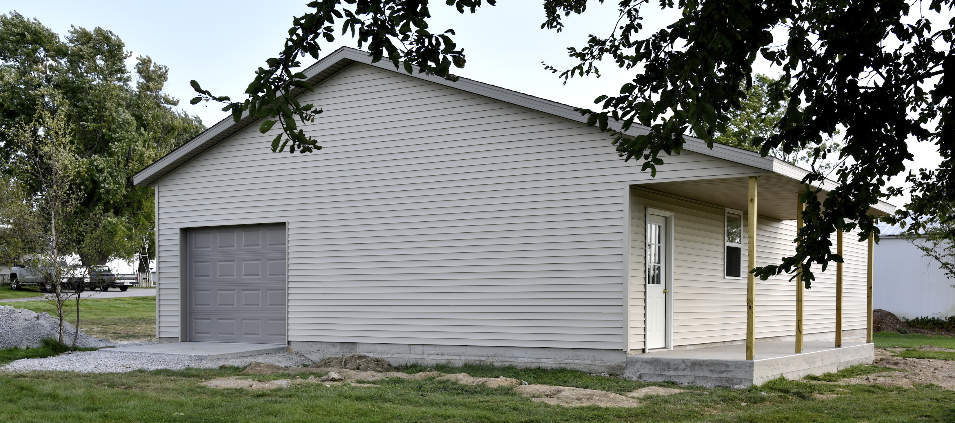

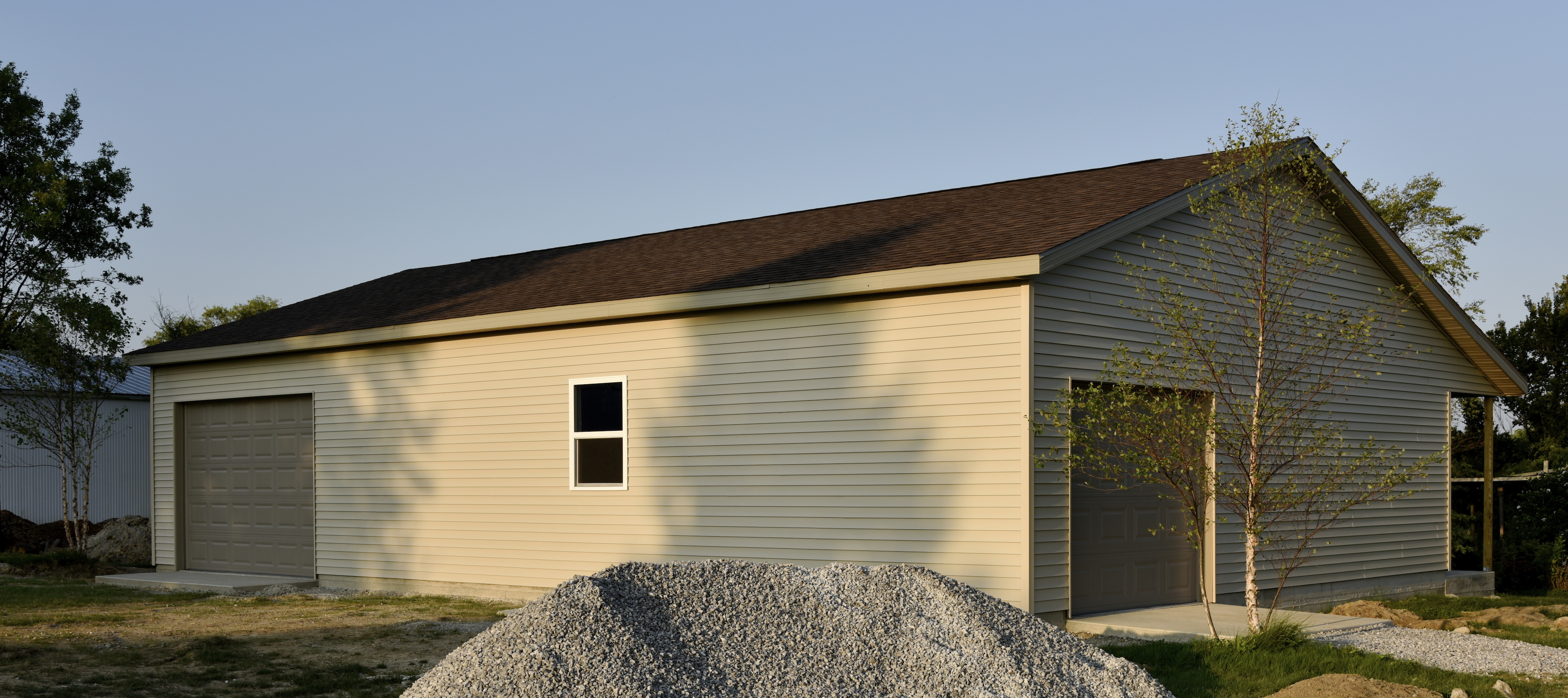

September 7, 201610 yr comment_72525 at least on the outside. My Amish crew worked 1/2 day last Saturday, then returned for a short day on Labor day (worked until 1:30), then yesterday for another short day to finish the building. Can't express how impressed I am with the skills of this crew. The youngest (whom I'm told was 18) did the entire roof himself, carrying the shingles up one bundle at a time. He also installed the OH doors, and they are spot on perfect. While that was going on the father and the oldest boy (I had picked up somewhere this was a family with no outside help other than the driver) finished the sheathing, siding, fascia, etc. Anyway, as it looks ready for me to do the inside. I need to do an interior partition to divide it into 2 spaces, and then start the wiring, insulating, and walls. That may have to wait a while, though the power should be installed in the next few weeks. I've having the panel installed (100 amps), then I'll do the balance. The small OH door is simply for me to get things into and out of the shop area, the larger one is 8' tall because 7' isn't quite high enough for my tractor when the ROPS is straight up position. The color differences you see in the 2 shots is lighting. . Report

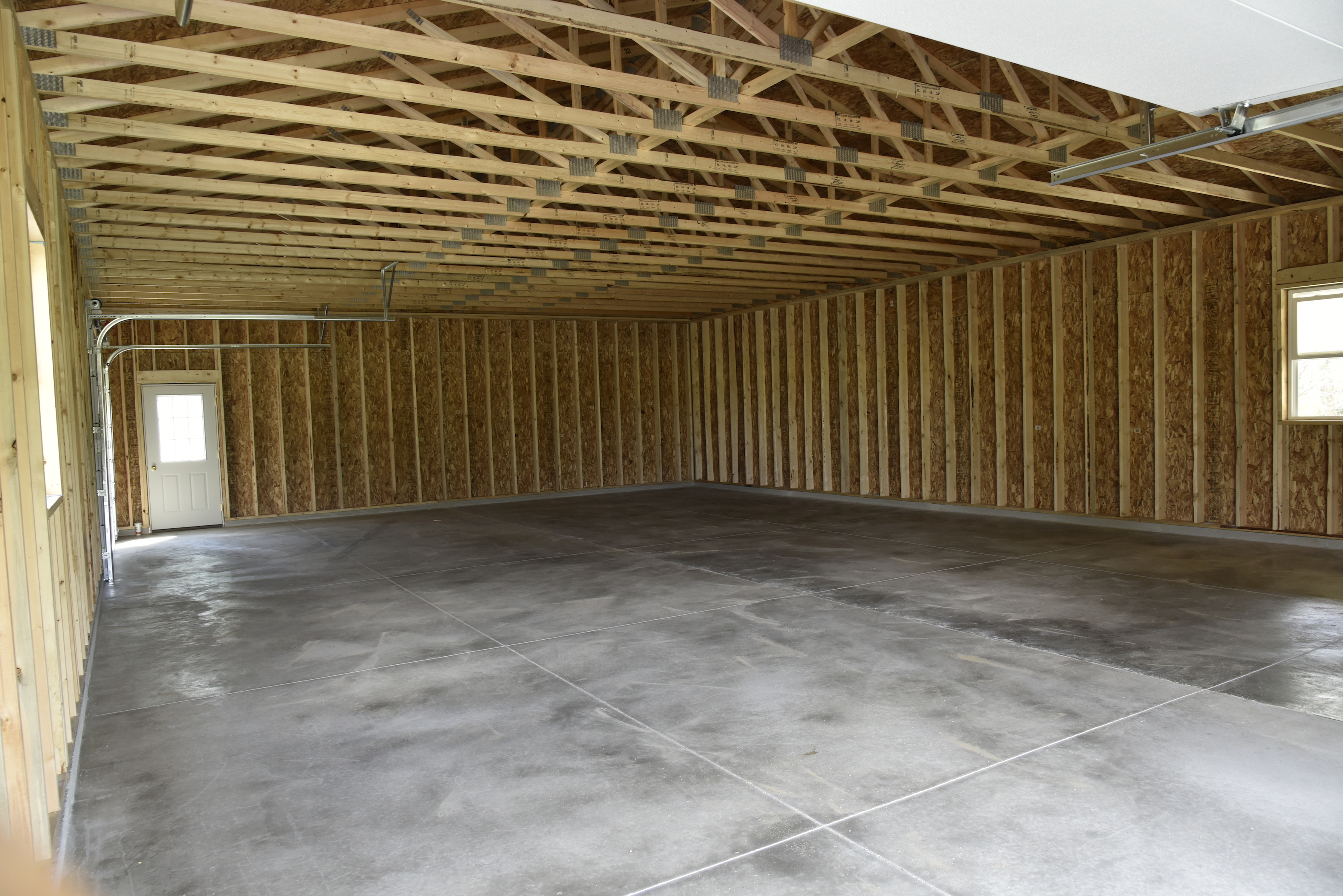

September 8, 201610 yr comment_72730 WOW Fred, That is awesome. Wide open with no support columns. Can't wait to see it up and running. Report
