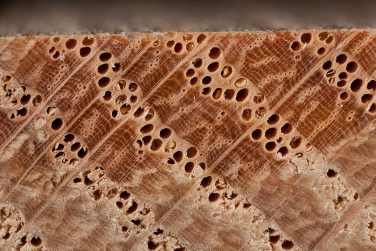

September 5, 201610 yr comment_72251 When I asked about woods to use, some Oak was not recommended because because of more open grain could hold bad contaminants/bacteria. Wouldn't that hold true with end grain cutting boards too? Report
September 6, 201610 yr comment_72262 Ron, I think you should avoid oak in cutting boards. If you do a crosscut on a piece of oak and look at the end grain with a magnifier you will see the openings or pores that will absorb liquids. I would stick with dense grained woods such as maple, cherry or walnut. Just my opinion. Report
September 6, 201610 yr comment_72268 I think it would be more problematic if you used red oak for an end grain board, as compared to tighter grained woods. Granted, an end grain board exposes the open pores of any wood. Just that red oak, in particular, has such a porous character. Even white oak has an open pore but not as much as red oak. They have even used white oak in ship building. The size of the pores in maple, for example, is very small and would not retain much material for bacteria to feed upon. A good cleaning, after use, will scrub away the particles. I have read that studies have shown that wood has an antibacterial quality that is supposed to keep it safe from contamination. I'm not sure if that is entirely accurate. Here in Pennsylvania, restaurants are not permitted to use wooden cutting surfaces for food preparation. Report
September 6, 201610 yr comment_72275 Red oak is open grained, not suitable for cutting boards. White oak is closed grain and is suitable. Its why they use white oak for whiskey barrels. Report
September 6, 201610 yr comment_72276 You can actually blow bubbles through a short piece of Red Oak. It has open pores likened to straws. Report
September 6, 201610 yr comment_72281 I read that old timers would test the difference between red and white oak by blowing cigarette smoke thru the pores of red oak. Report

September 6, 201610 yr comment_72419 I'm always telling the kids that they have to think of wood as a big bundle of straws, and those straws are going to suck in glue, poly, water or mineral oil. Just today I had one of them putting oil on a cutting board and wondering why he had the drier looking spots on it right after he put the oil on. I went and sliced off a piece of red oak real thin and had him hold it up to the light. I usually get a lot of responses from them when they see all those holes in there. Then I tell them that the cherry, walnut, jarrah and maple we use have holes (straws) in them just like that, but they are a lot smaller. Actually seeing it in the red oak makes an impression. Report

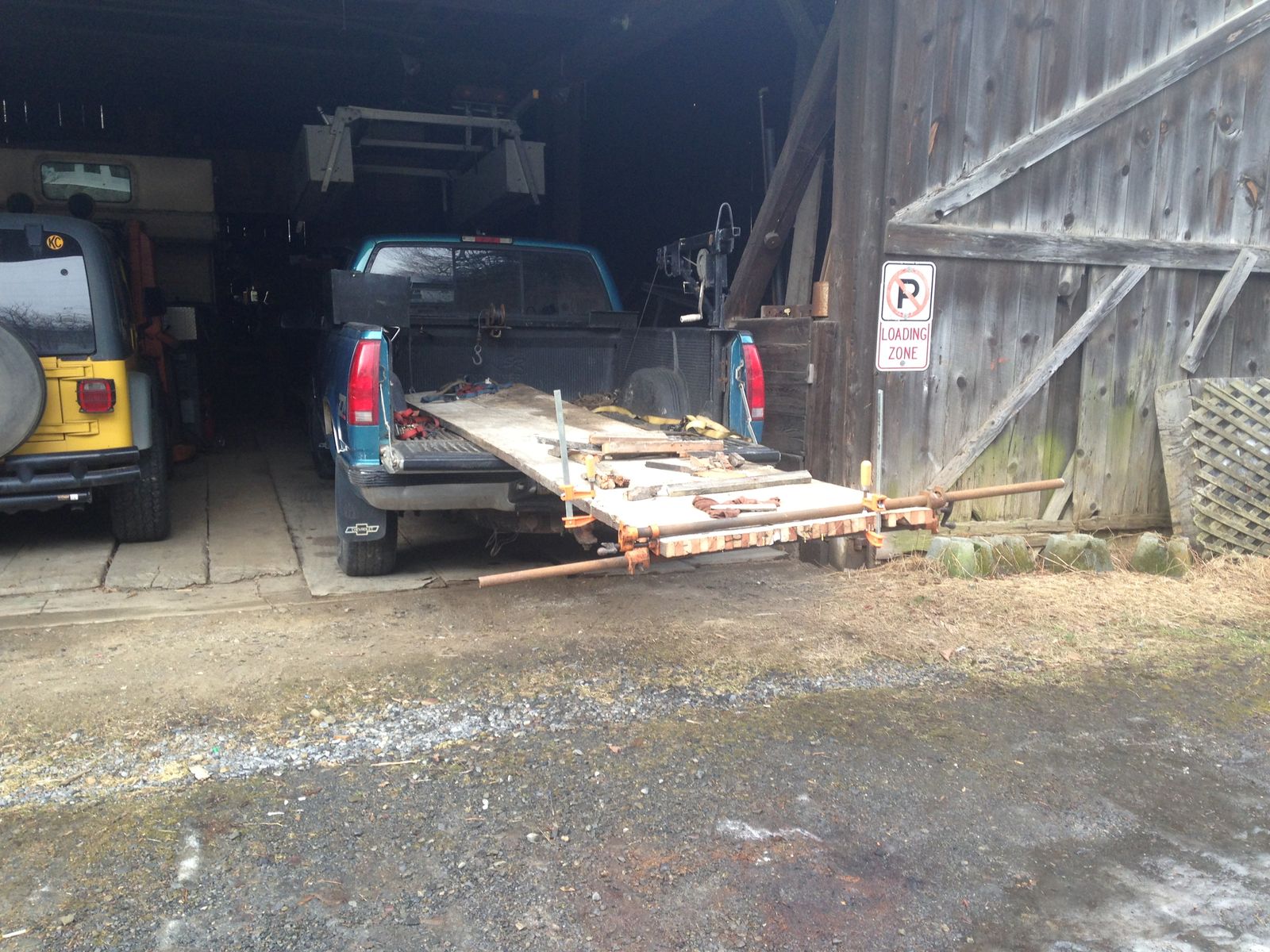

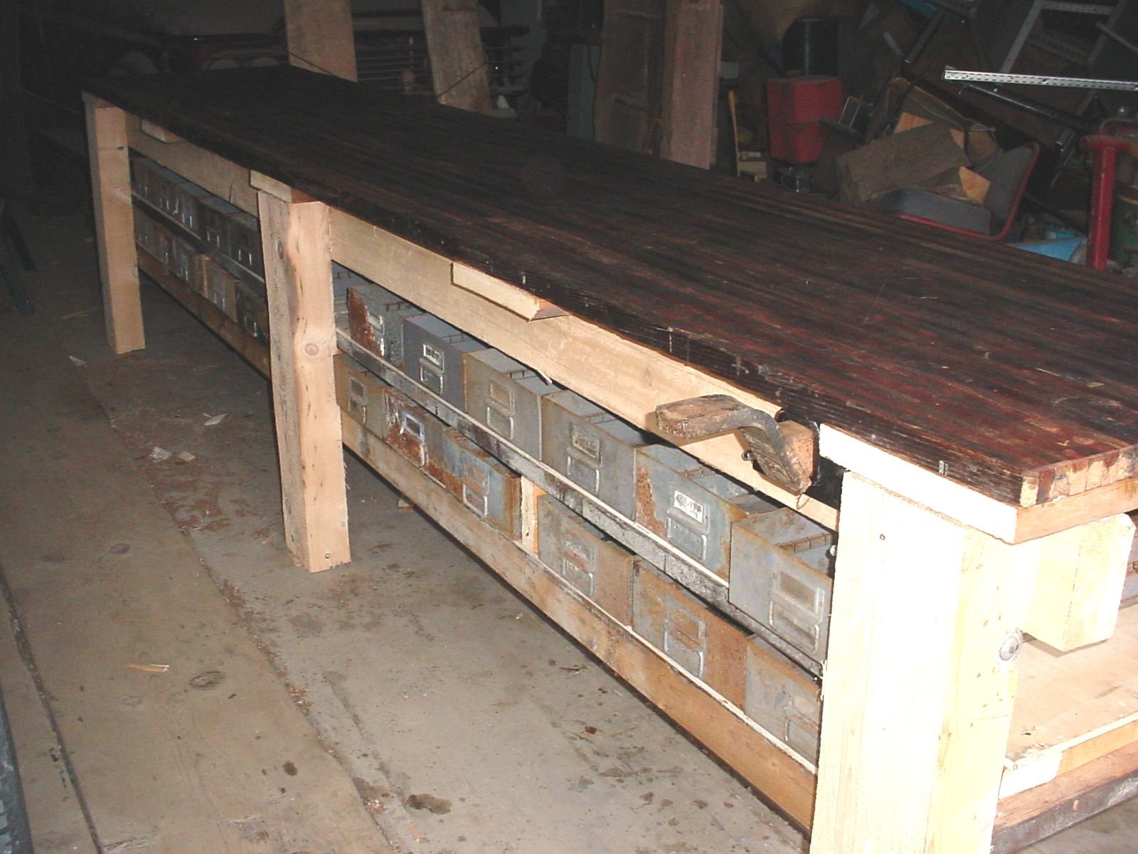

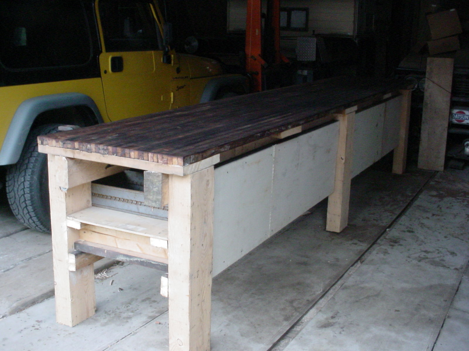

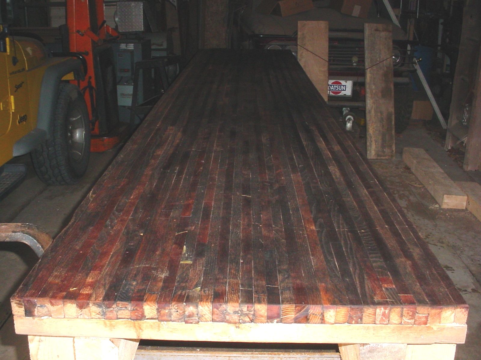

November 24, 20197 yr comment_209992 This old table top was the main cutting board for over 100 years in out local town of Millville Pa. When the meat plant burned down 2 years ago I got the top out of the fire and made a work shop table out of it. It's put together with square nails and had no glue. It would bow in a curve when I tried to pick it up. It bowed not the long way but from front to back. Sure made a heavy table. I had to cut off about 3 feet of burnt table. Report
