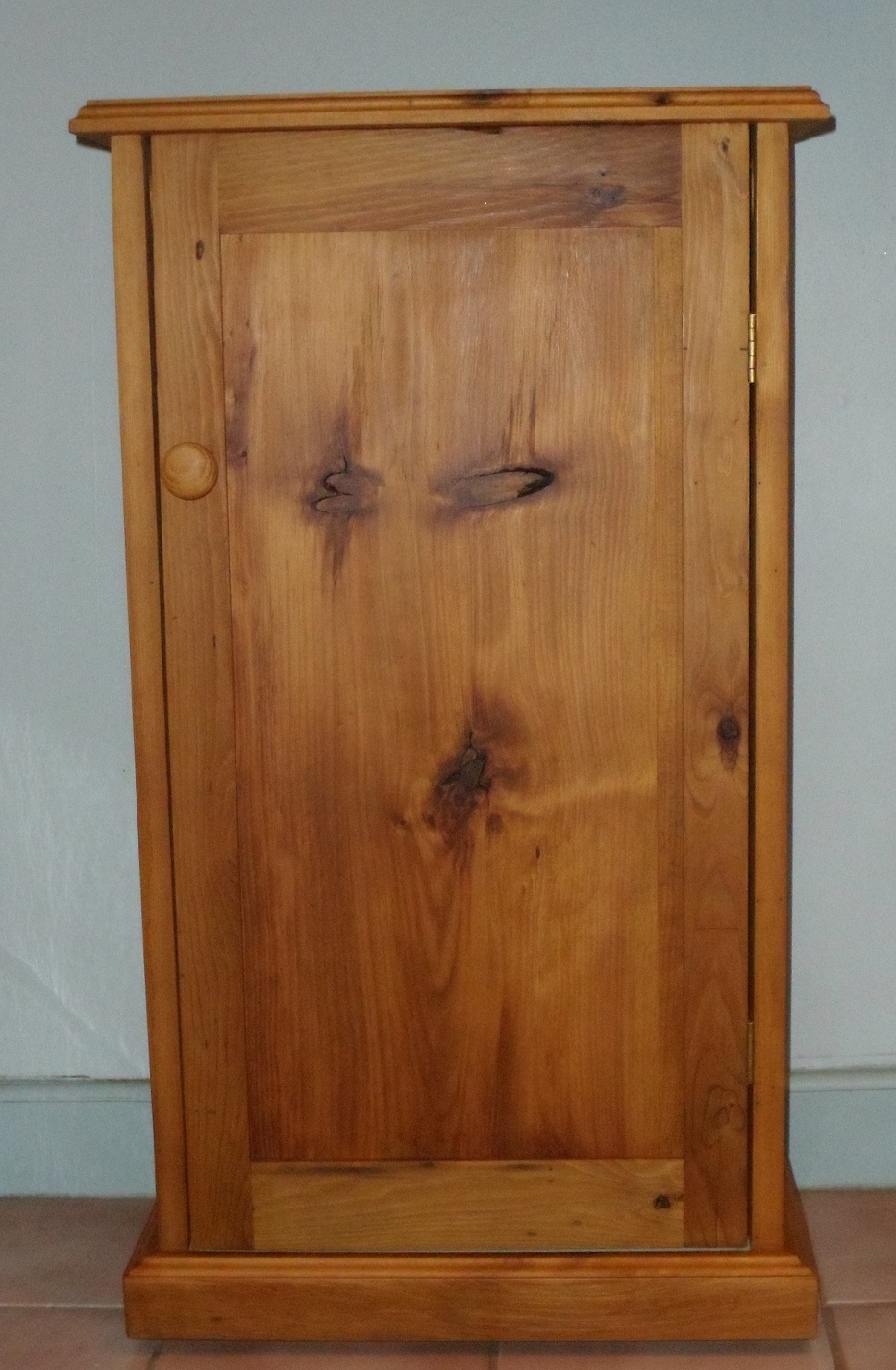

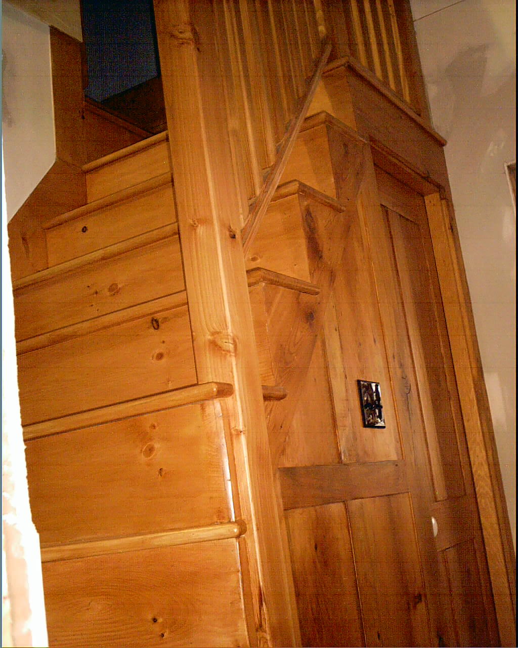

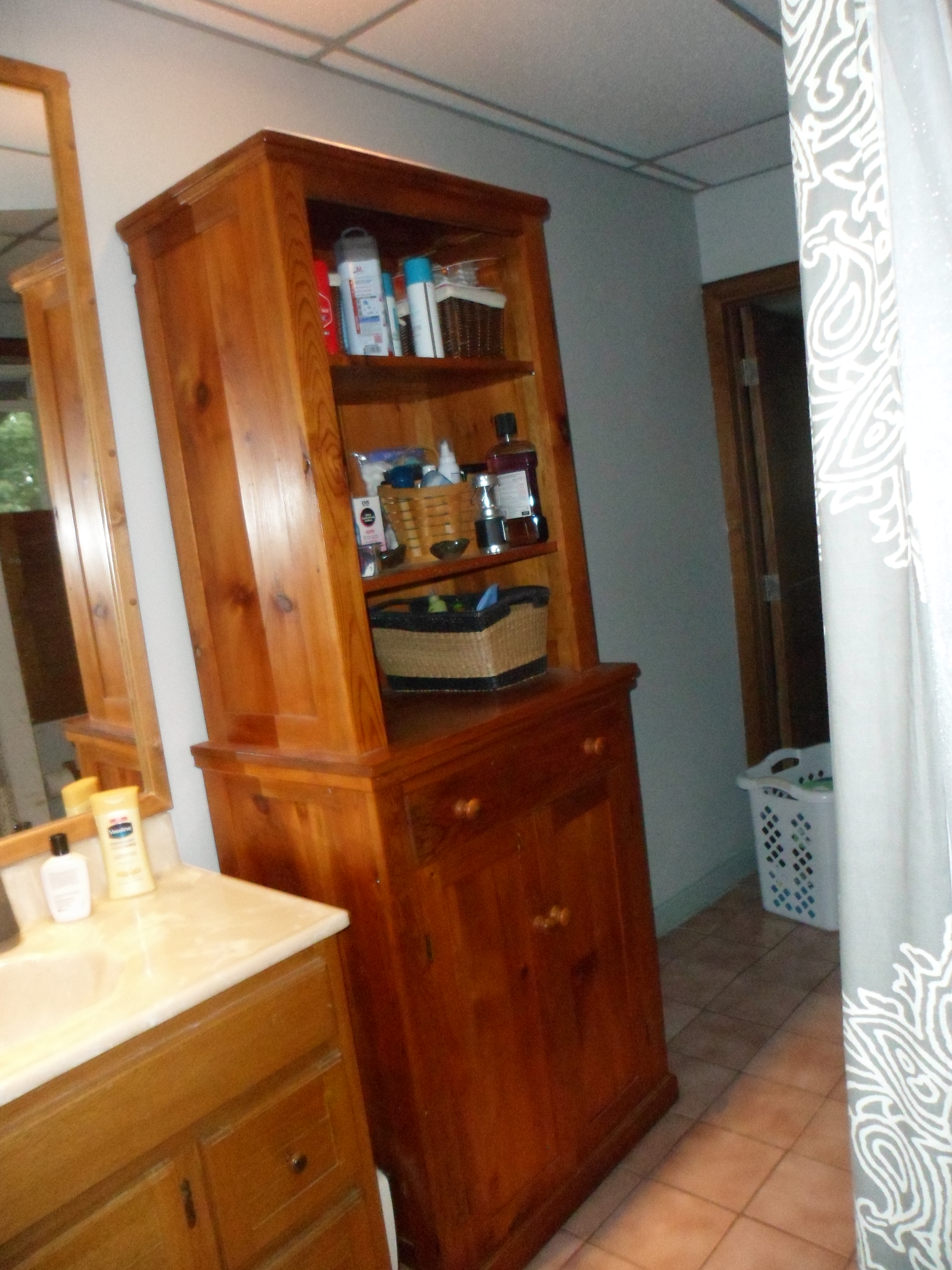

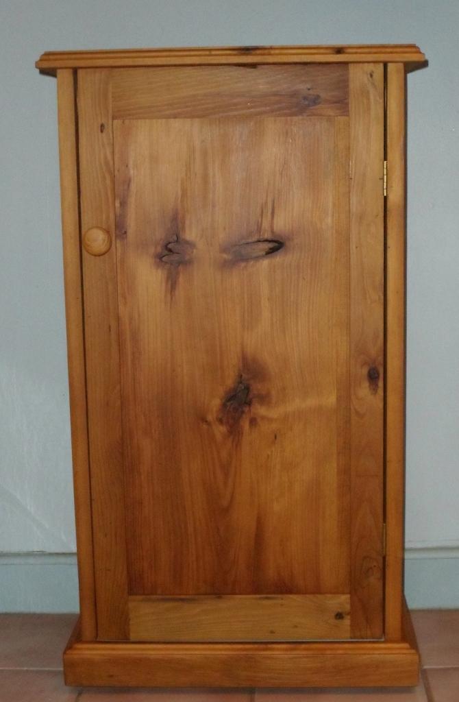

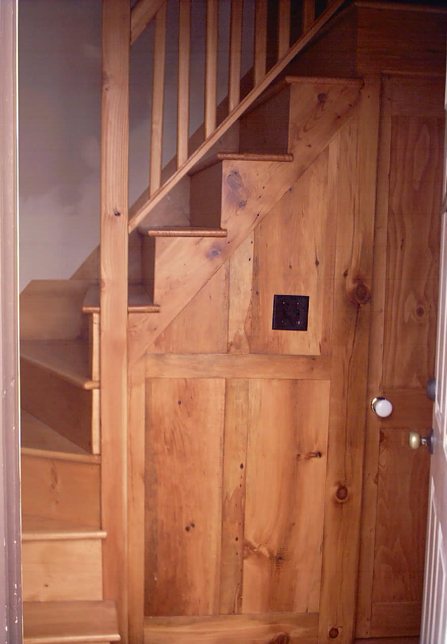

September 23, 201610 yr comment_75543 I thought I'd chime in here. I've used Polyshades a couple of times, and I admit, there are better options, but I think I had good results in my two uses. In one instance, I finished a cabinet out of reclaimed pine, and the second was when I rebuilt my stairs in my house. In both instances, I thinned it slightly, and used it as a wipe on application. After I reached the desired color, I top coated with a couple of coats of satin polyurethane. I was pleased with the results. I'm not the best photographer, so the color on the stairs looks a lot different in the two photos. I think possibly because on the front on photo, I was standing outside shooting the photo thru my open front door. My point is, if you treat it right, Polyshades will work well. Granted, I built a small cabinet a few years later to match up with the bath cabinet, and I used garnet shellac with 2 coats of P&L38 as a topcoat, and got a real close color match. The only difference was the polyshades even in satin finish, finished with more luster than the P&L38. And I did the stairs about 9 years ago. The finish is wearing like polyurethane! Report
