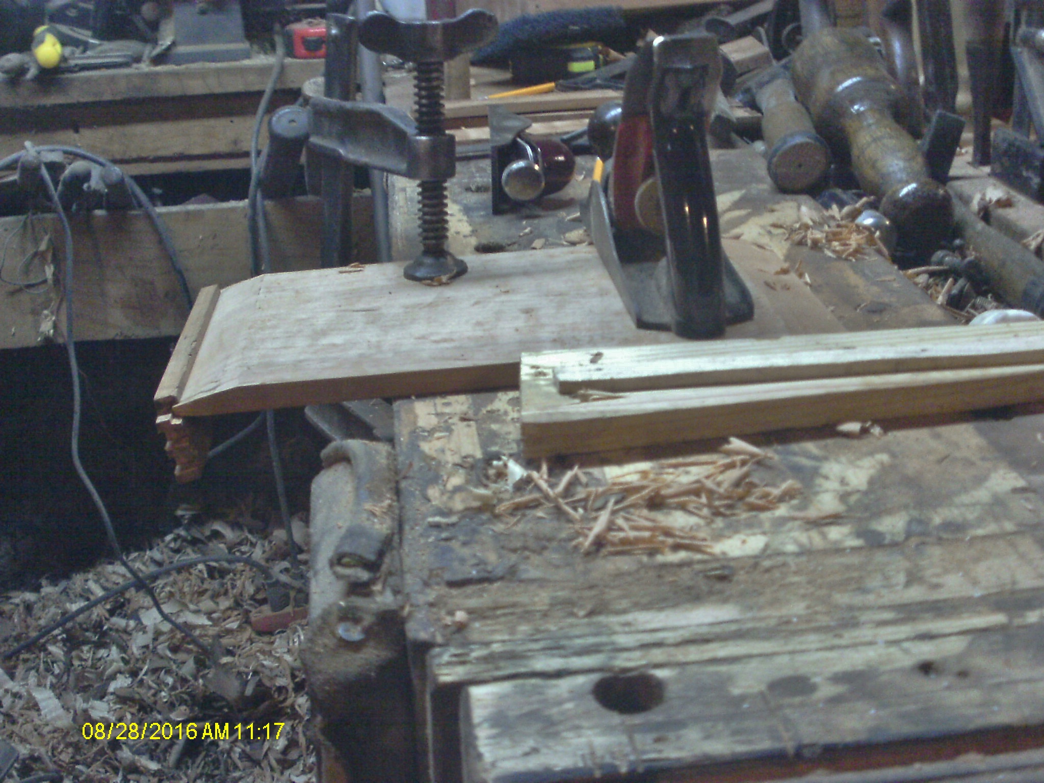

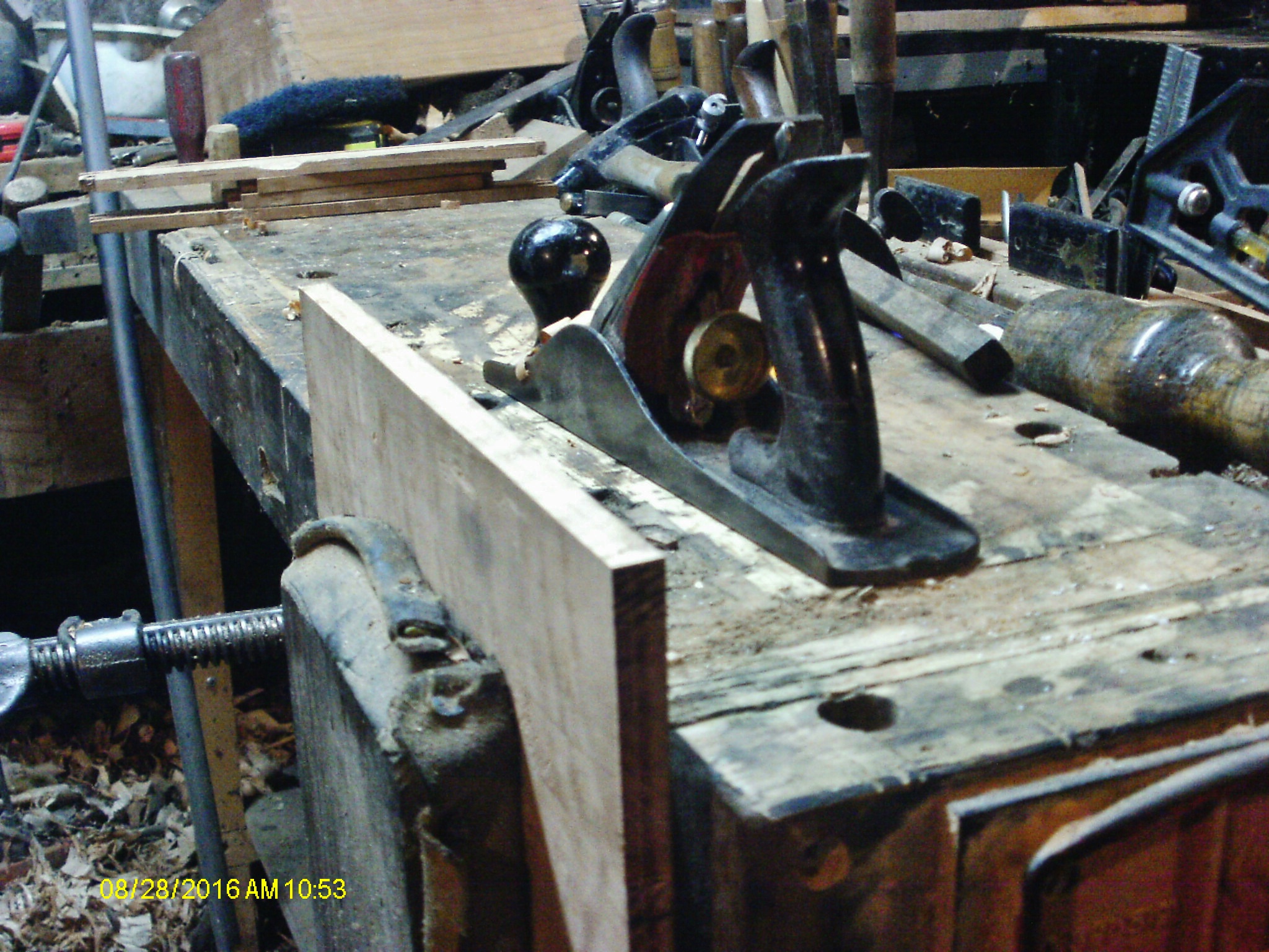

Well, I got the panel close to the right size this morning,  needed to joint the sawn edges
Plane is a Millers Falls No.11    Got all the edges done.    Laid out a stop line 1" in from the edges, all the way around.   Put the #11 away, got out a #3 plane.

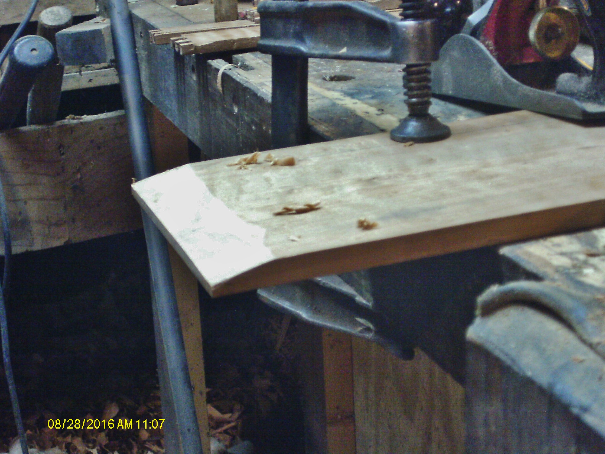

I go at a diagonal to the grain, working towards the edge from the line.   After a while, I can check for fit..

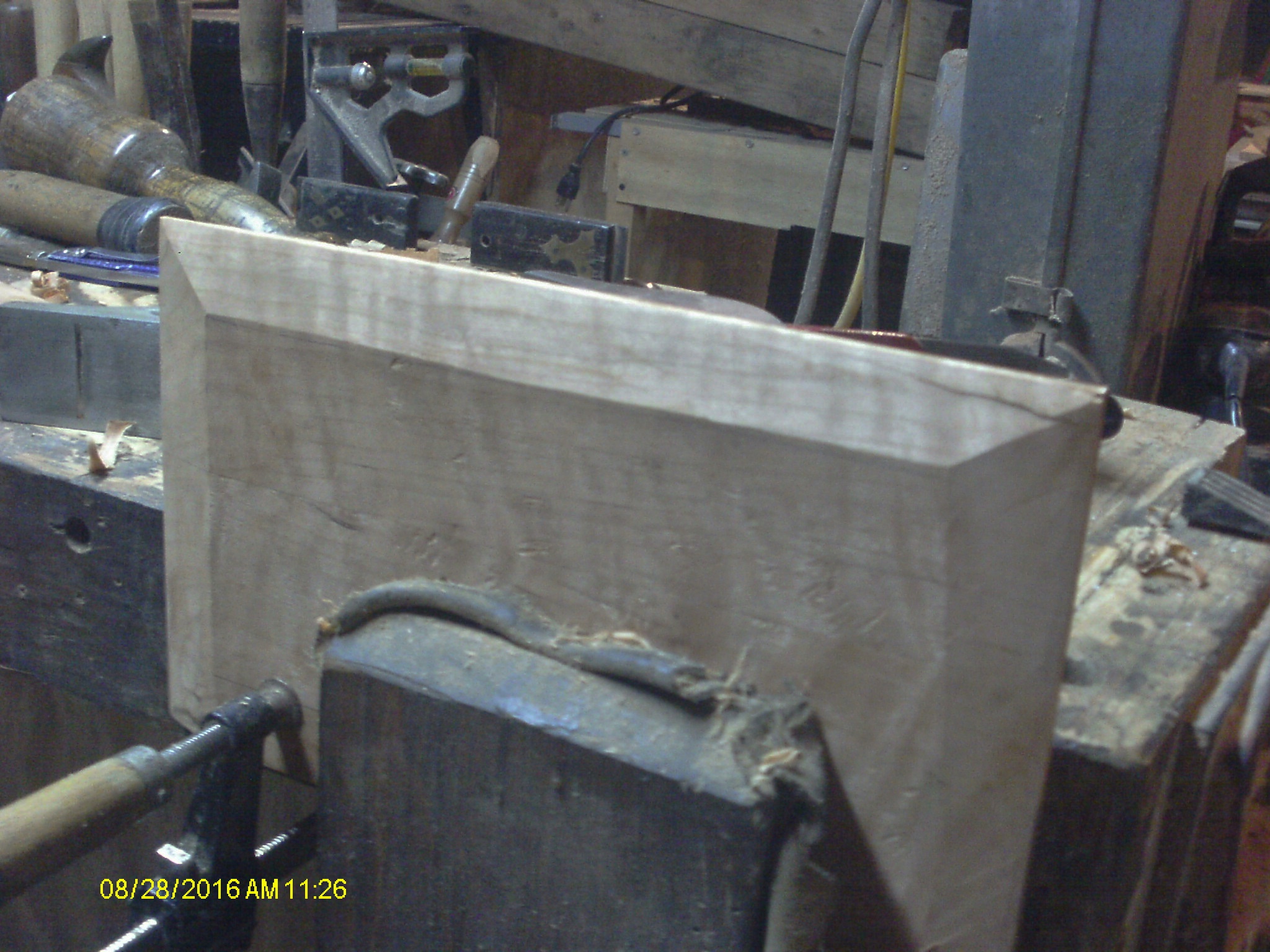

I have both ends done here.  No rebate was done on the back of the panel.   Next, came the long edges..

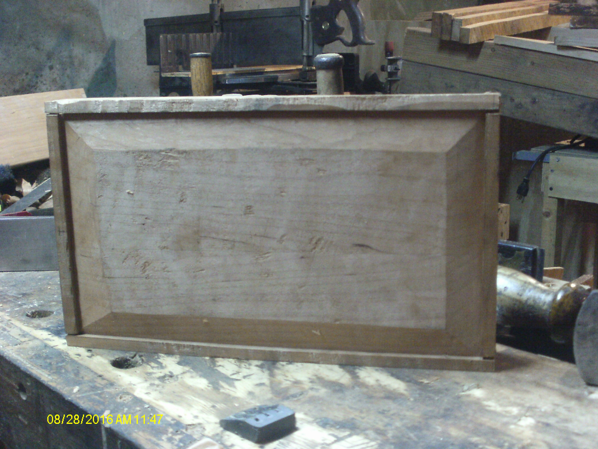

Not quite, as usual.   This is where I found out about the panel being a little too wide.   Corrected and try again.

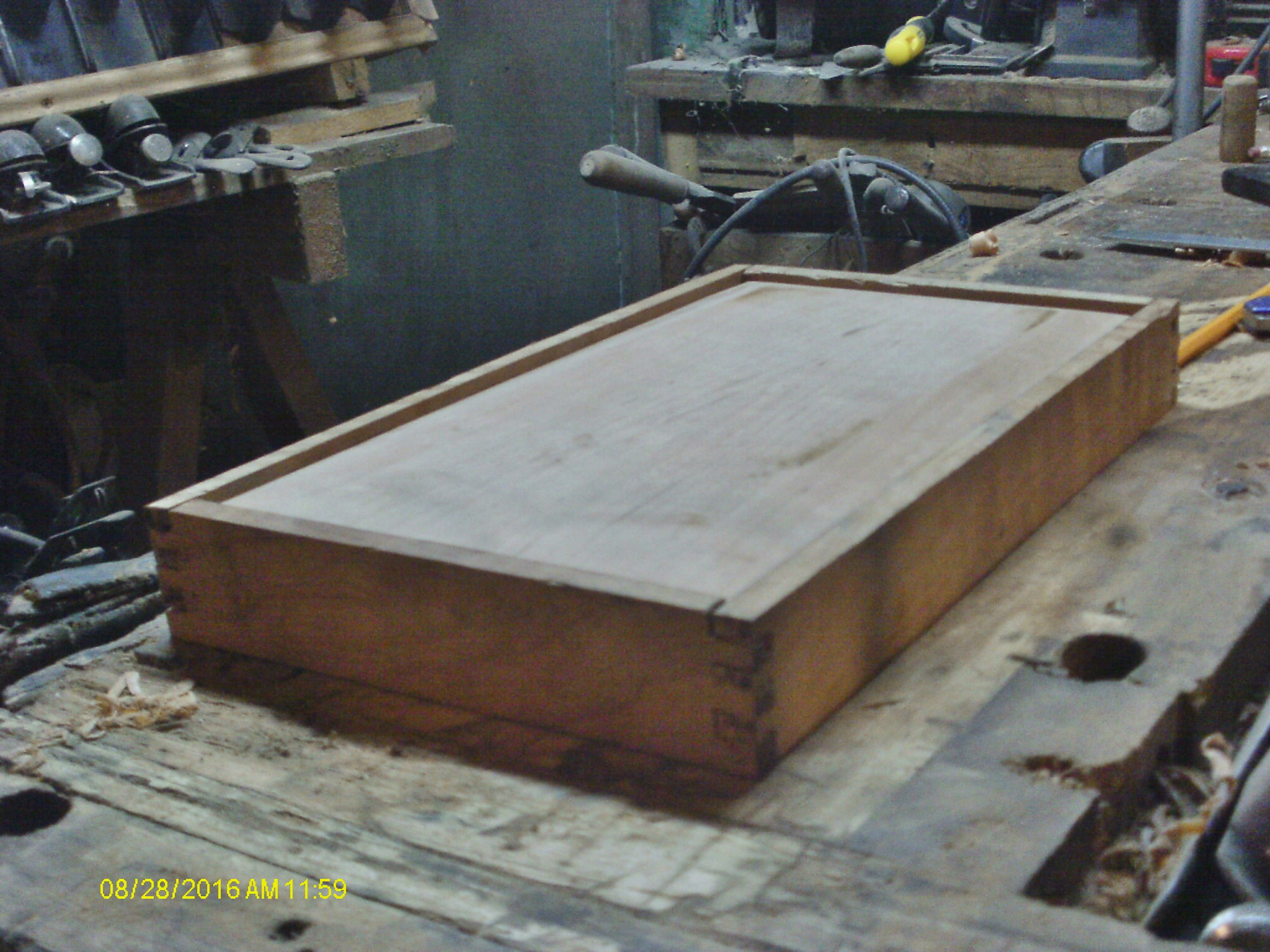

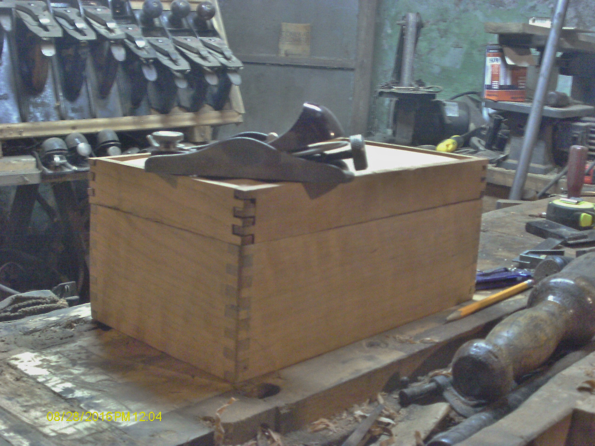

Third time is a charm.   There is no glue...yet.  Had a finger or two that needed adjustment.   may go back and round over the top edges.   Tried the lid on the box....cross your fingers...
Plane is there for scale.    Maybe by next weekend, I might be ready for a finish?

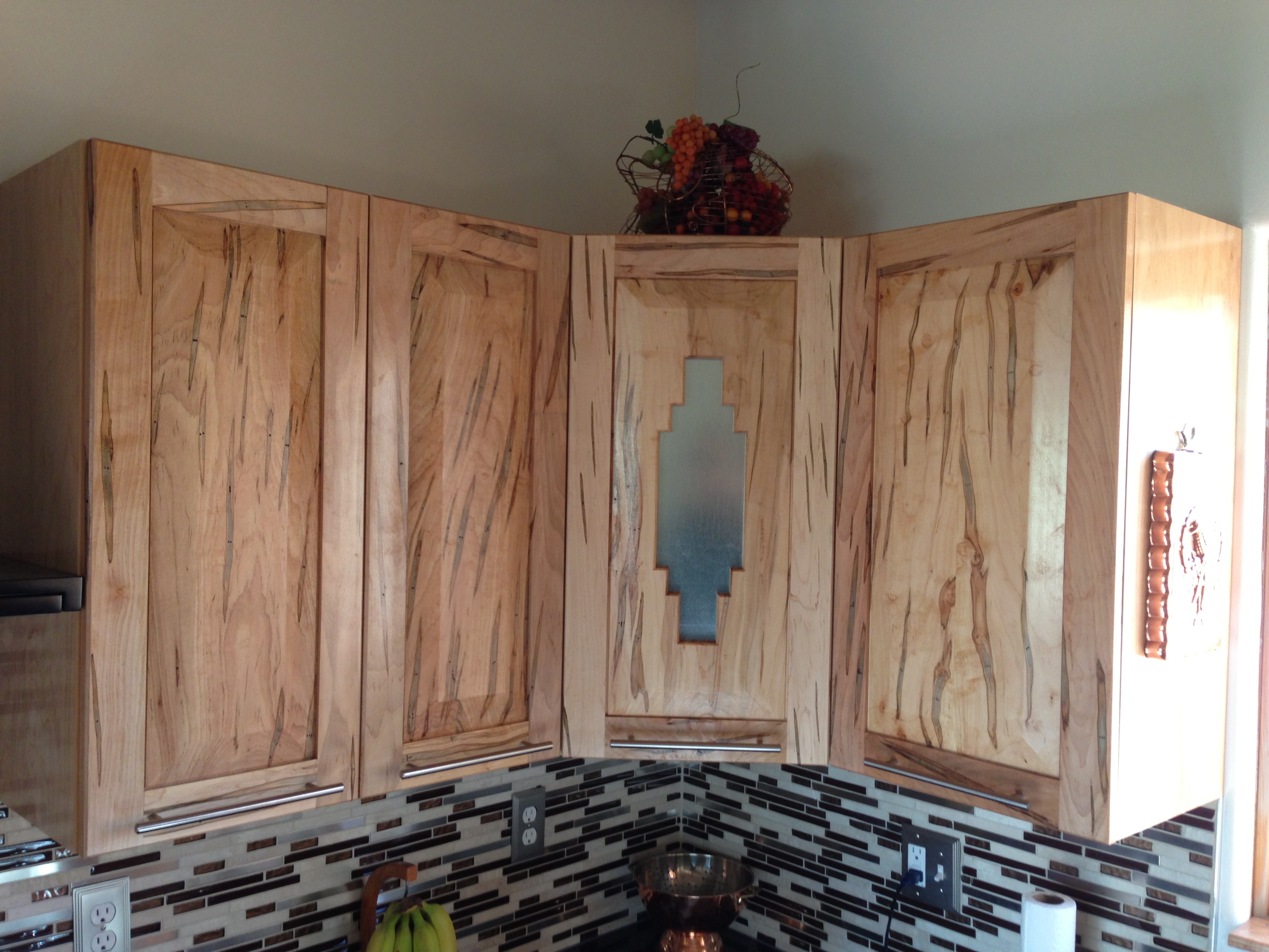

used the same basic design for our kitchen cabinets, but with lots of doors to make, i used my table saw.  way faster and more consistent.

By the way DAB, those are some beautiful cabinets, very nice sir. I do love that tile work too, wife has been wanting to do something like that too.
Love the inset glass on the corner cabinet...top notch.
Thats galvanized sheet metal.
Oooops, looks like frosted glass in the photo. I must be seeing your reflection as you took the photo. Still really like the effect.
