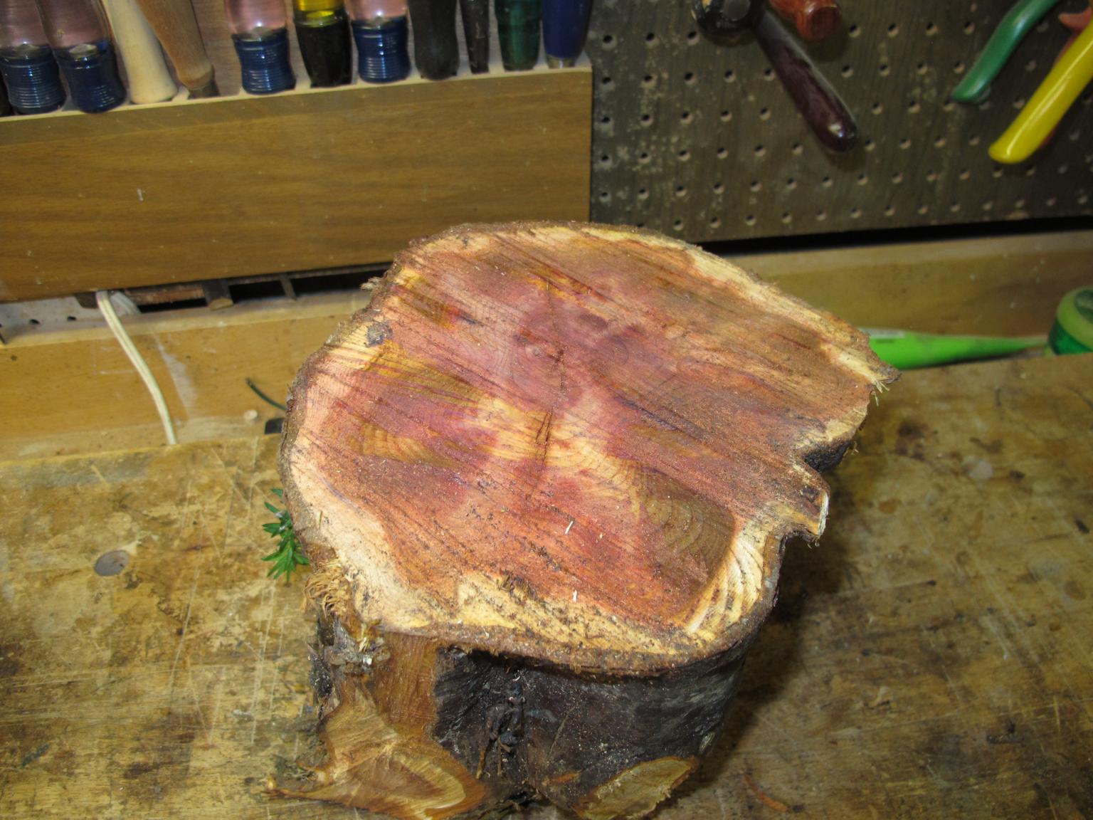

After trimming it up, I had -

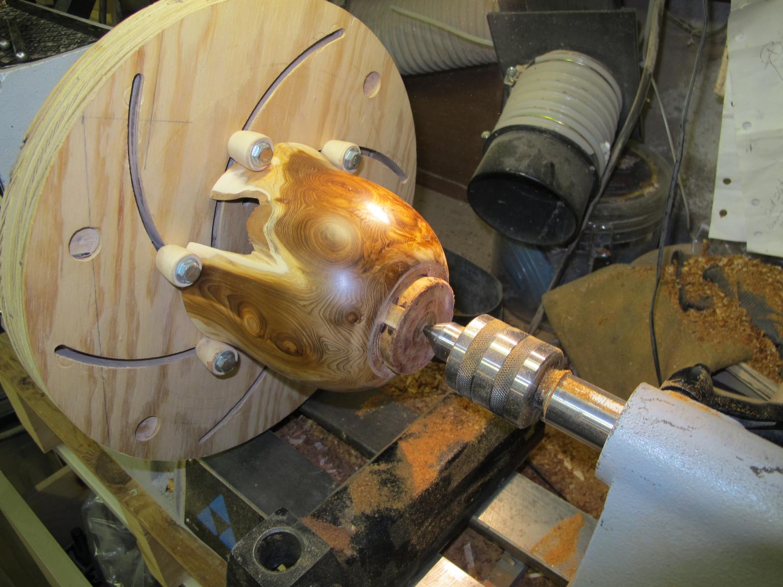

Mounting it on a face plate for initial turning-
Then on to the lathe-
Next, shape it-

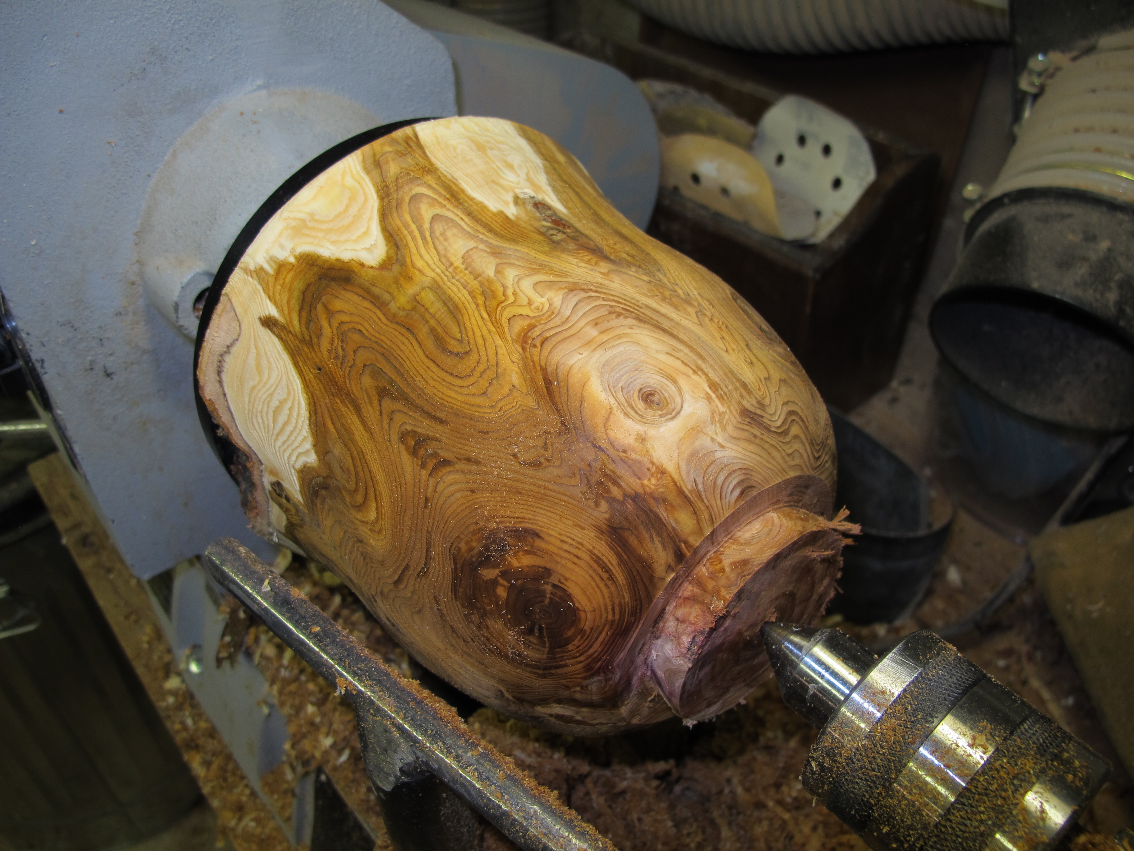

Once I was satisfied with the outside shape, I removed the face plate and mounted the chuck and added the blank.
I always wanted to experiment with a turning that was not "whole". The dark area was definitely deep enough that it was going to open up as I hollowed the piece.

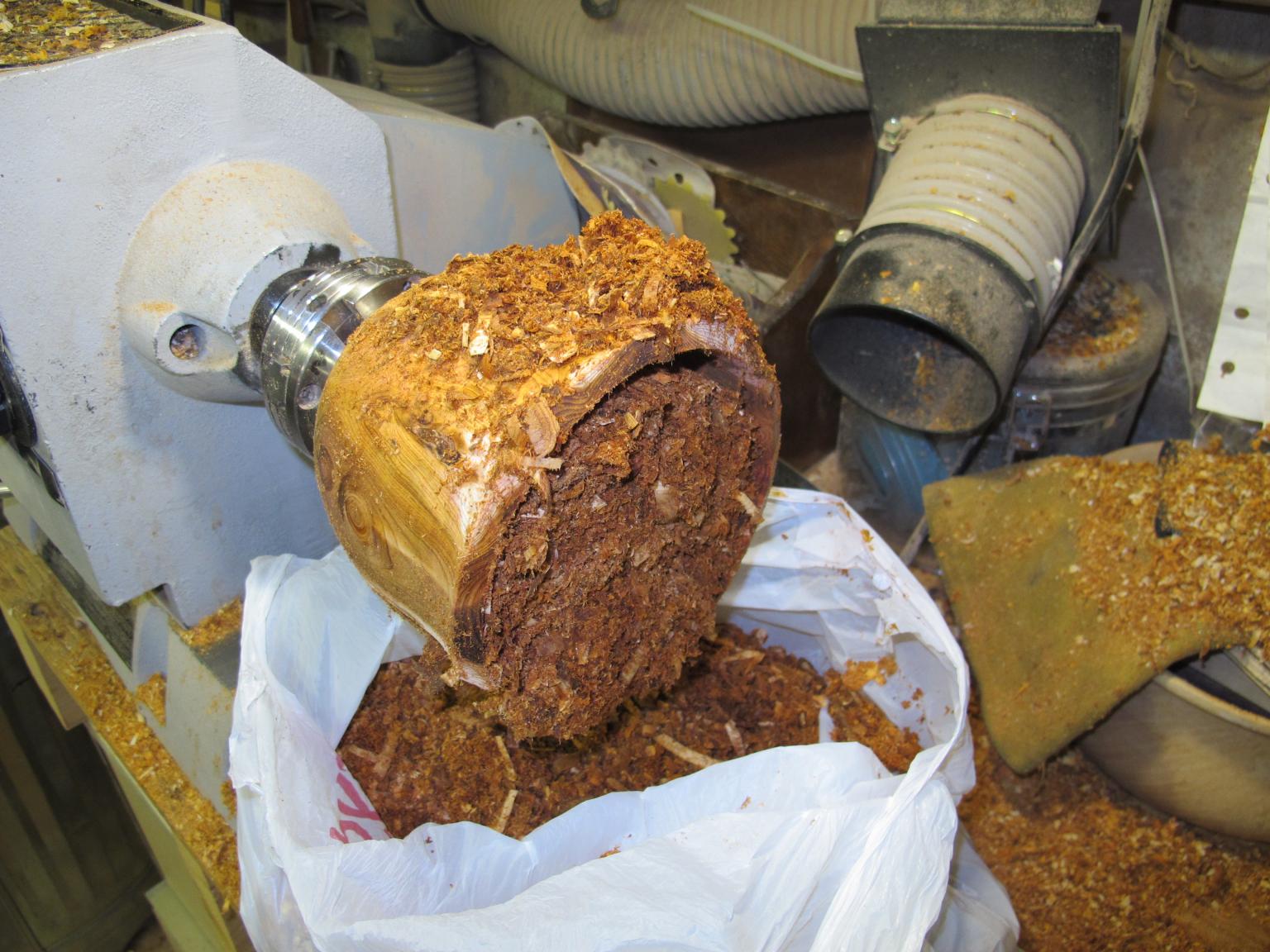

As we all know, the best laid plans of mice etc. etc.- an emergency! (Well not really but when the Mrs. calls). It was obvious I wasn't going to get back to this turning today. Because the blank was fresh cut and quite wet, I was afraid it would split/warp before I could get back to it. I packed the turning in shavings and encapsulated the entire thing in a plastic bag.

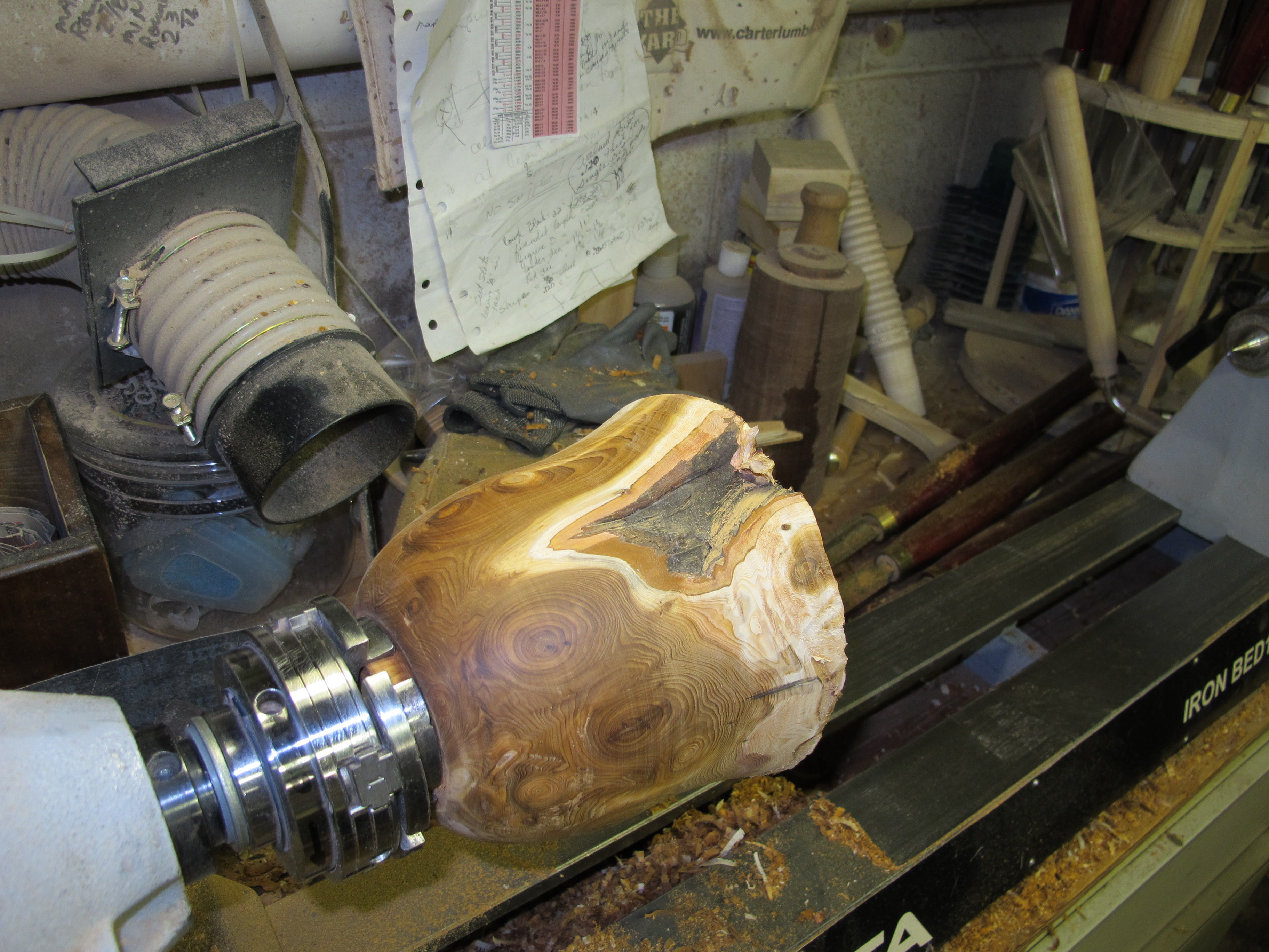

Three days later.

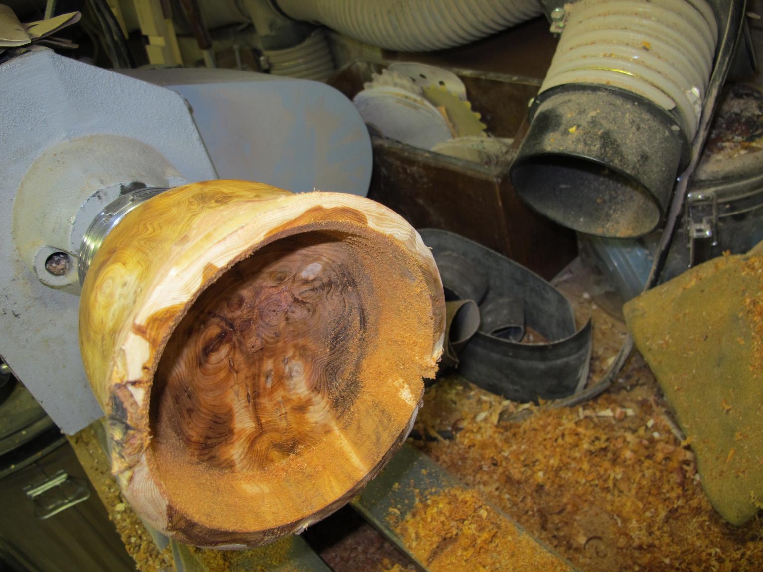

Opened the bag and removed the shavings-

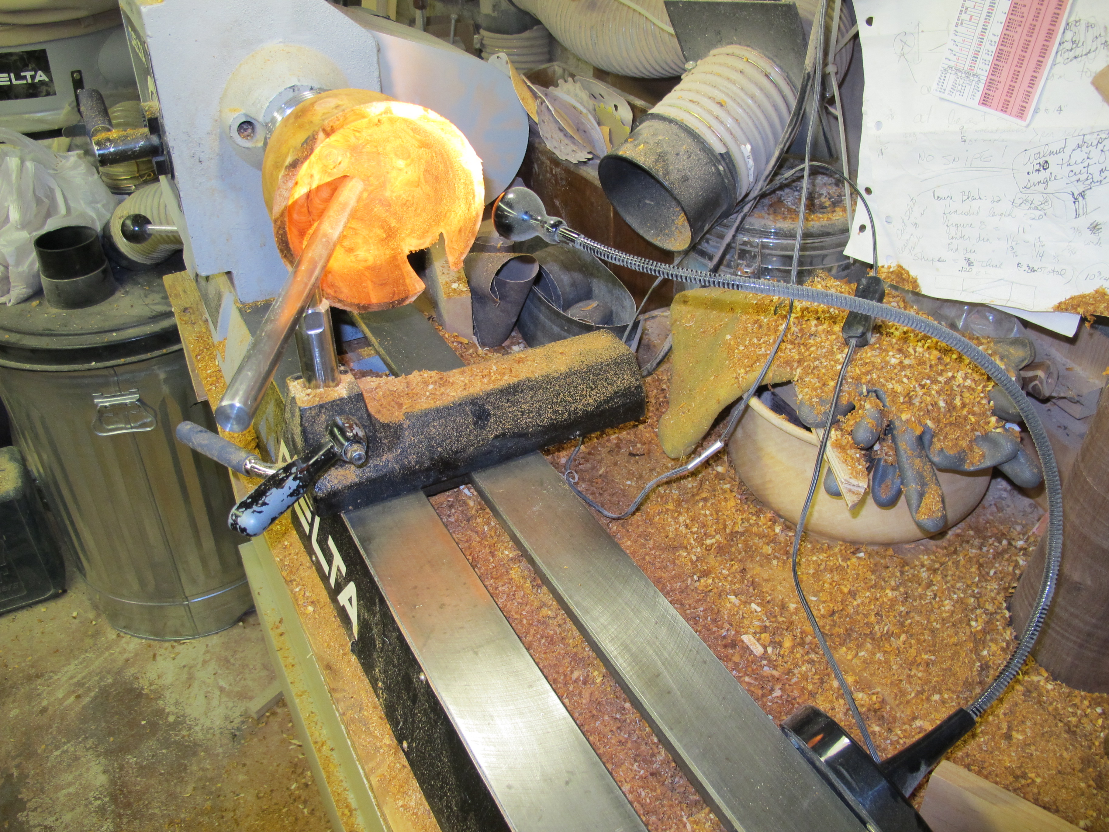

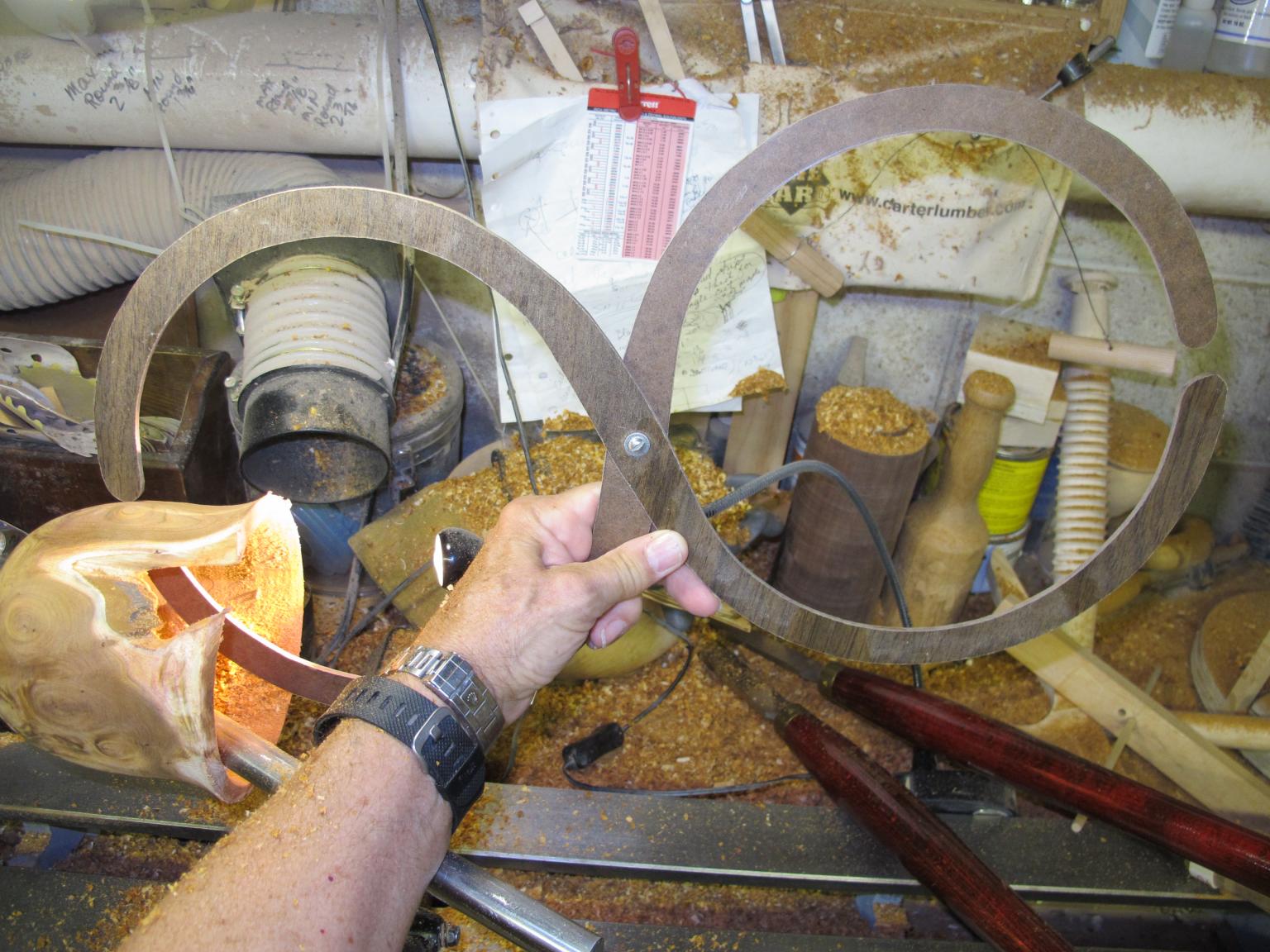

I felt pretty good as the blank had not warped or split. Finished the inside. Checking the wall thickness as I went.

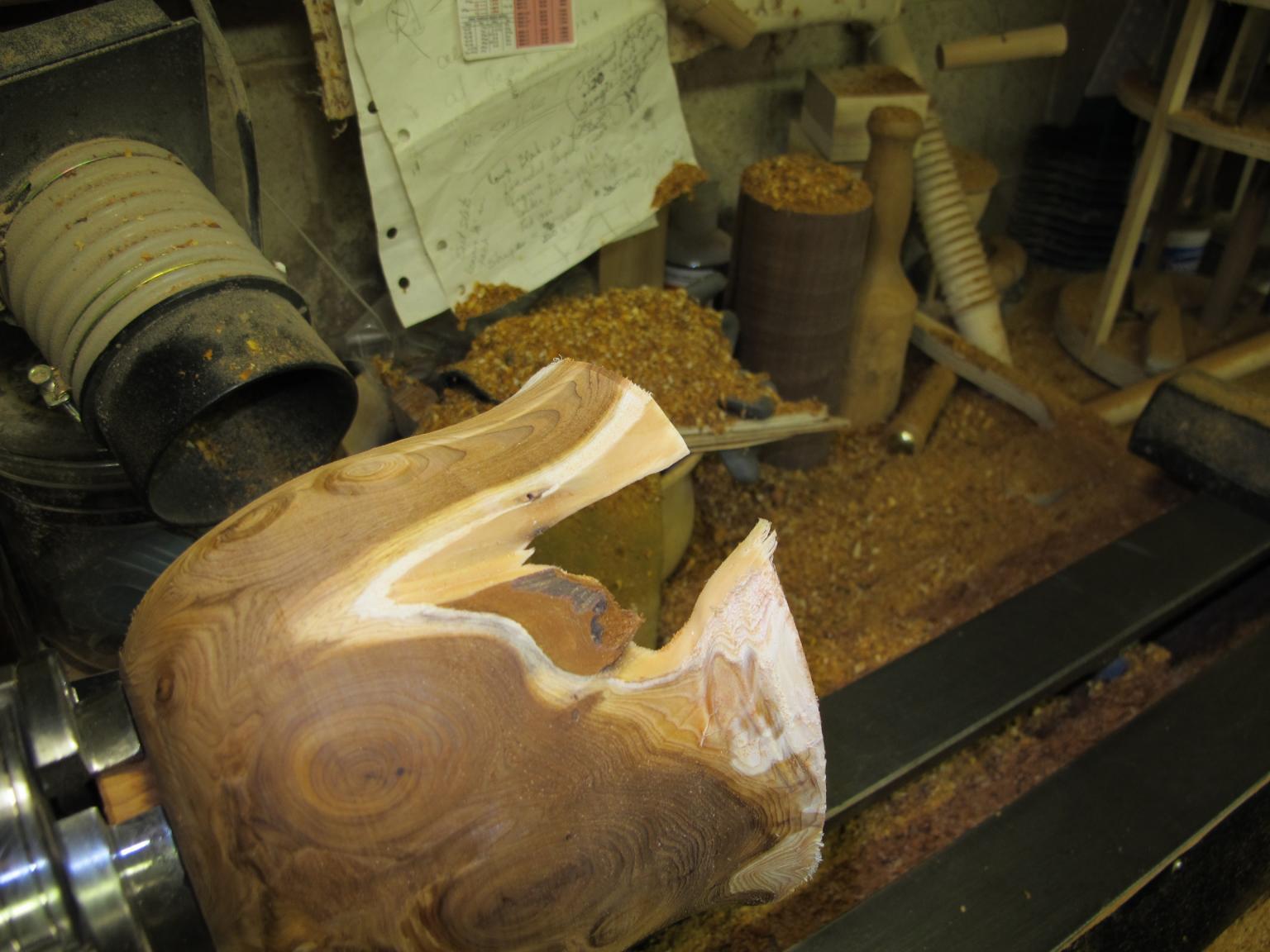

As expected, the side of the turning opened up. However, light touches and sharp tools allowed for turning without incident.

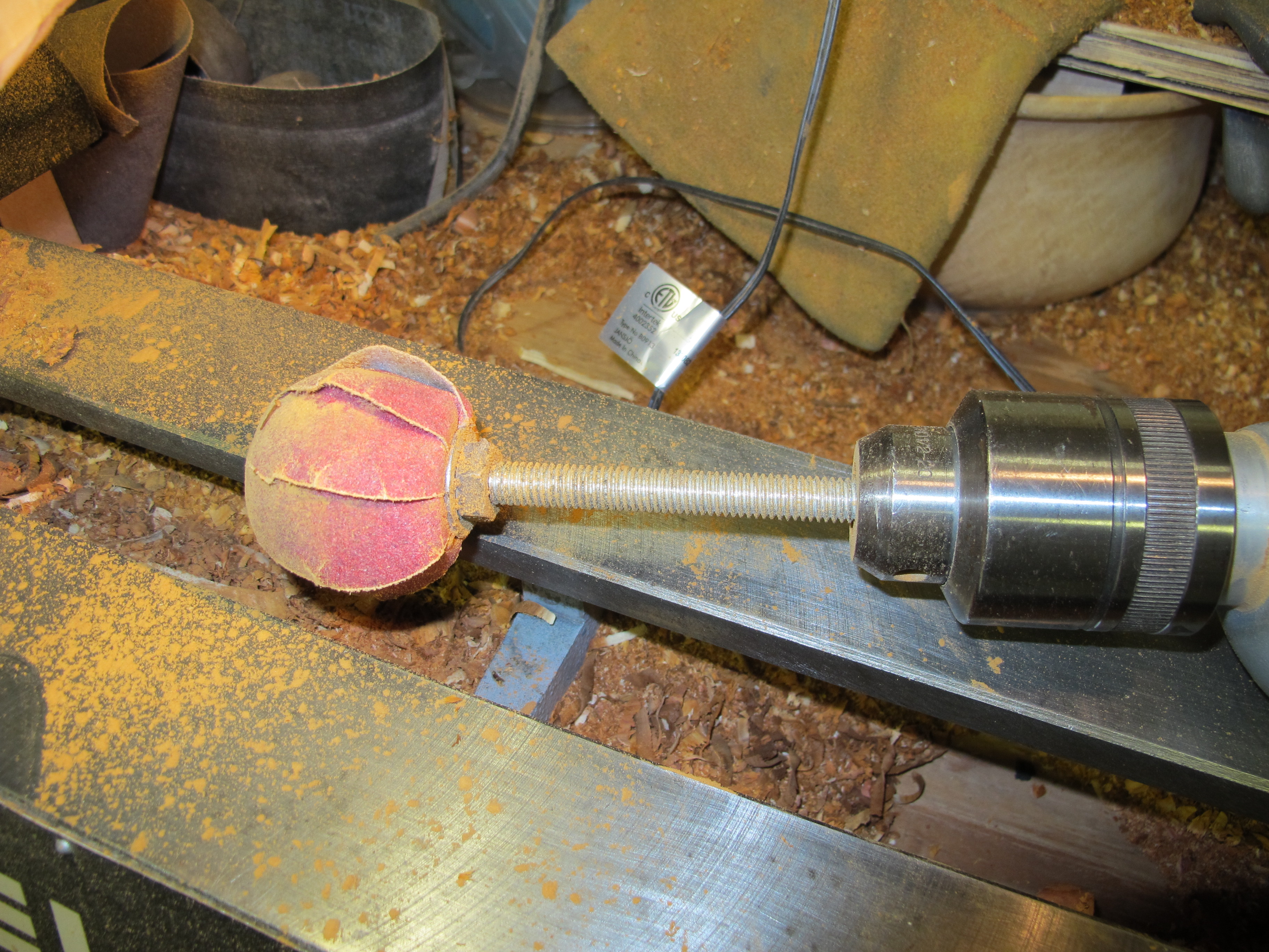

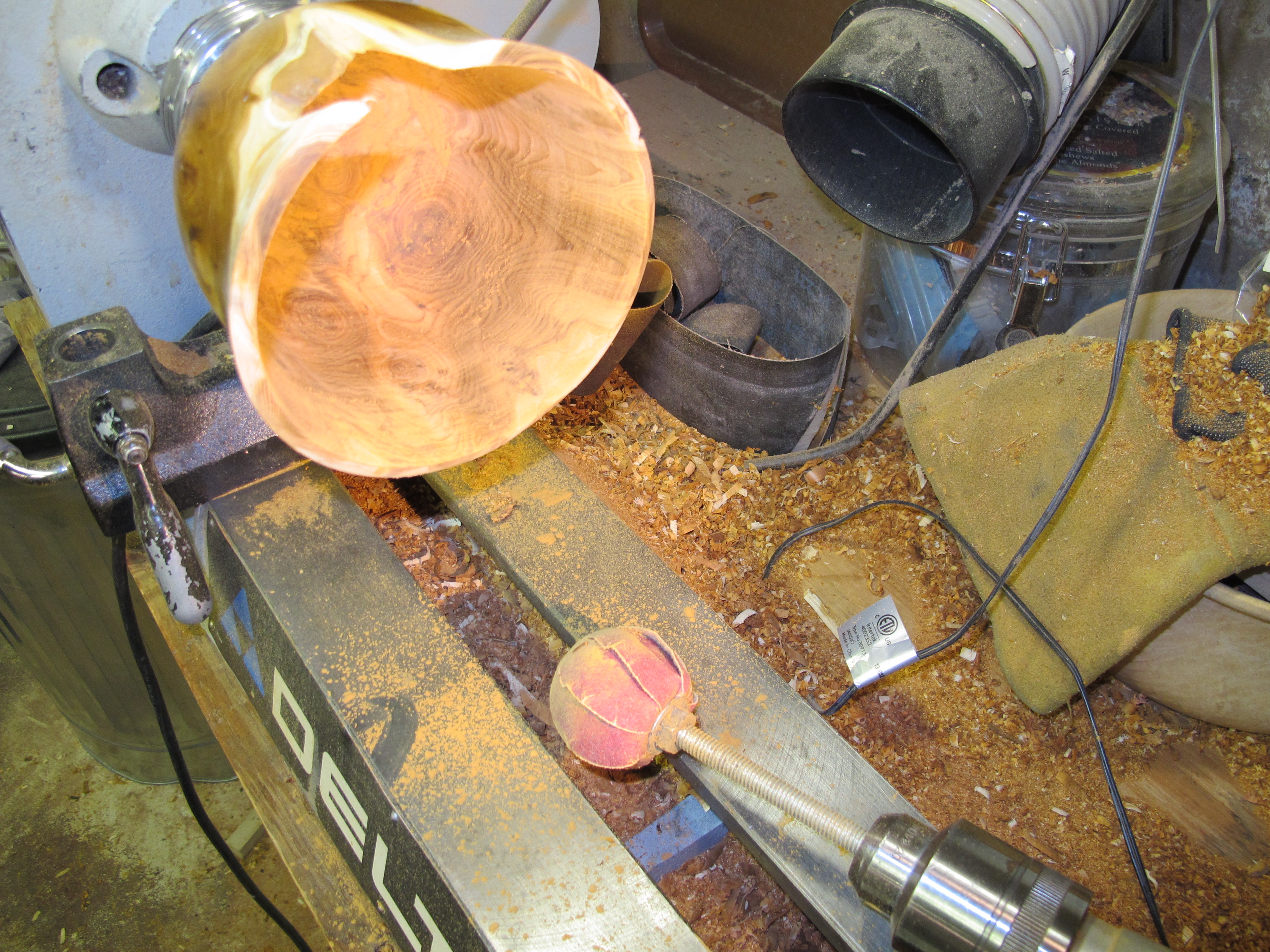

The inside sanding started with a sanding ball made using instructions from Mr. David Reed Smith's site

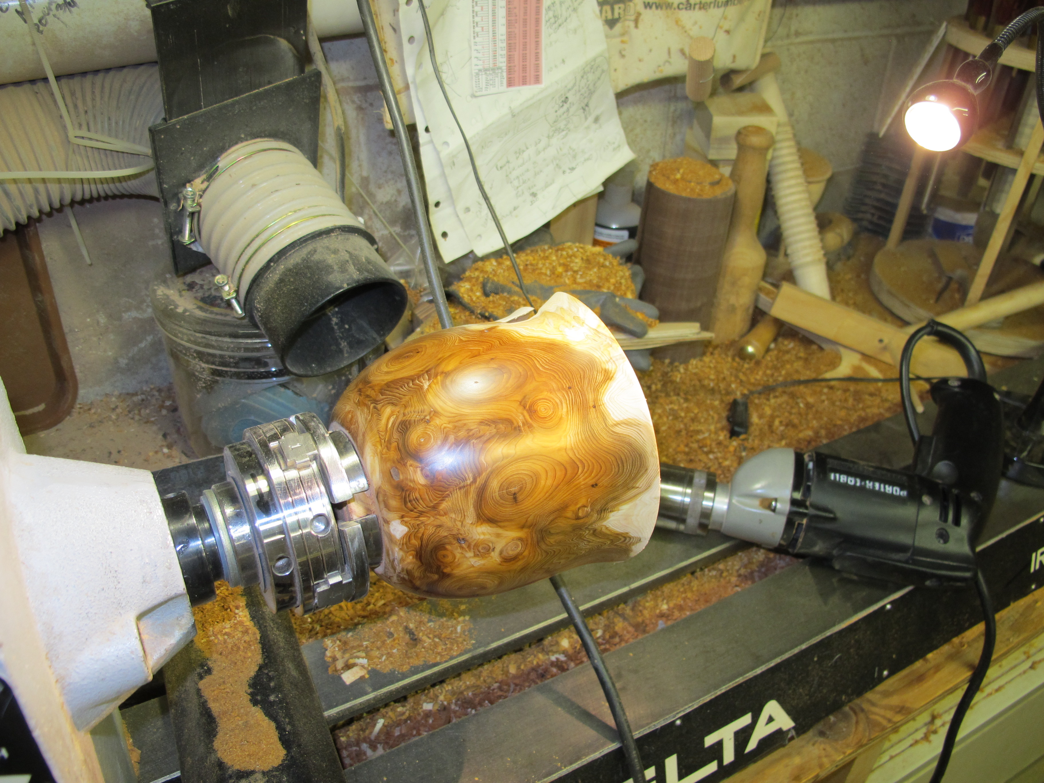

Then finished up thru the grits by hand.

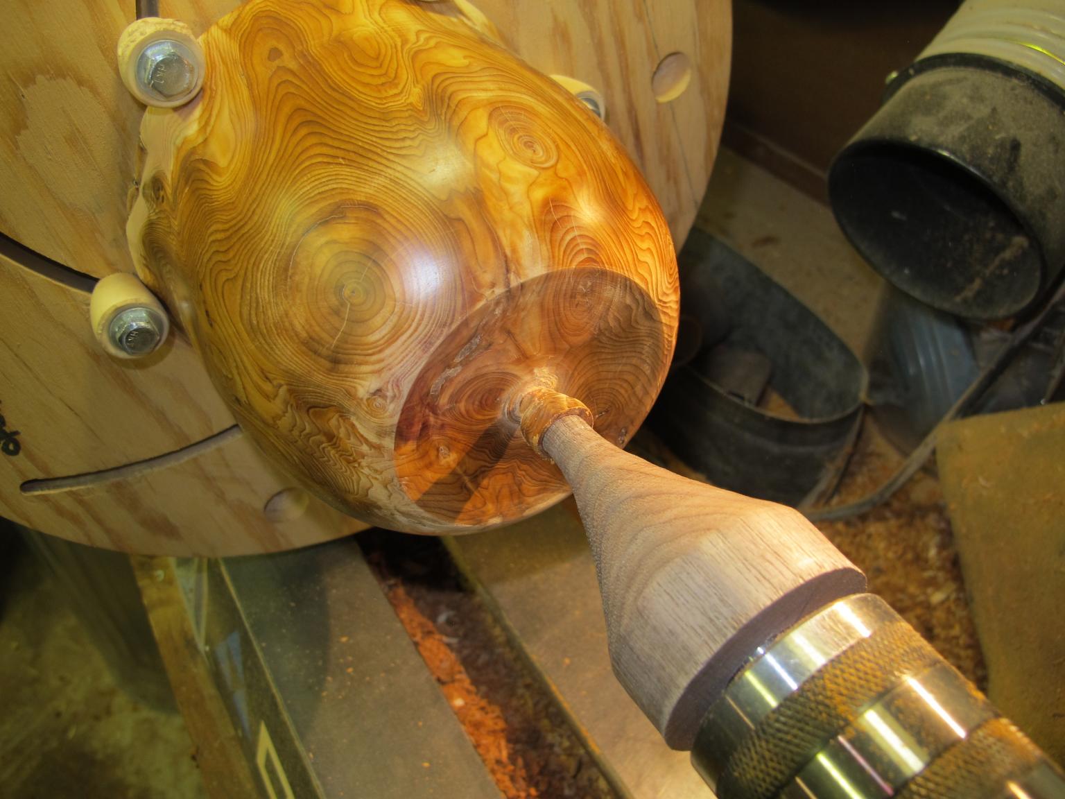

The final step was to remove the chuck tenon.
I used my shop made Longworth chuck to hold the turning-
Then turned away the majority of the tenon leaving only a small nub
The "extension" on the tail stock live center provides more working room and reduces the likelihood of the tools hitting the metal center point.

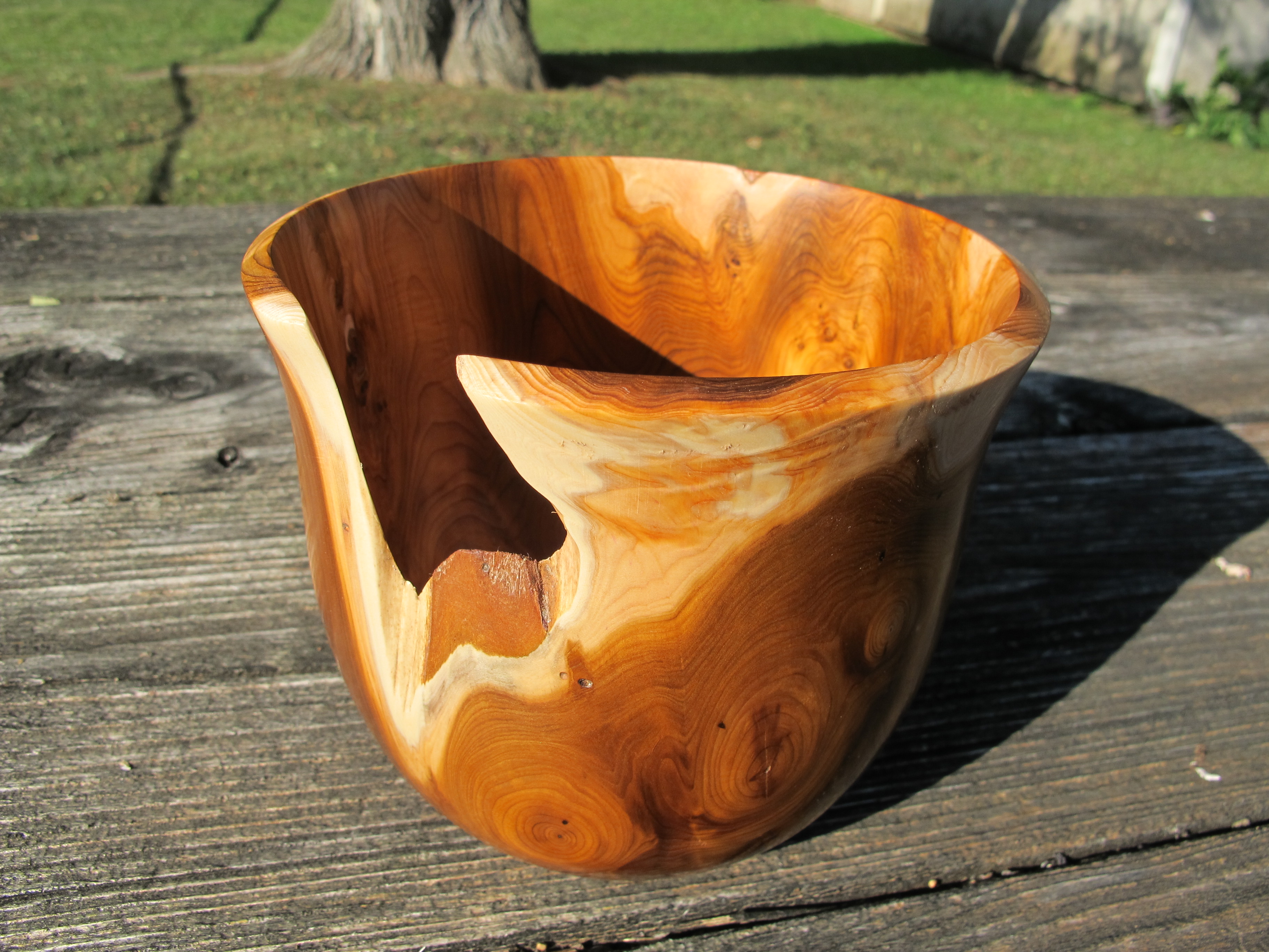

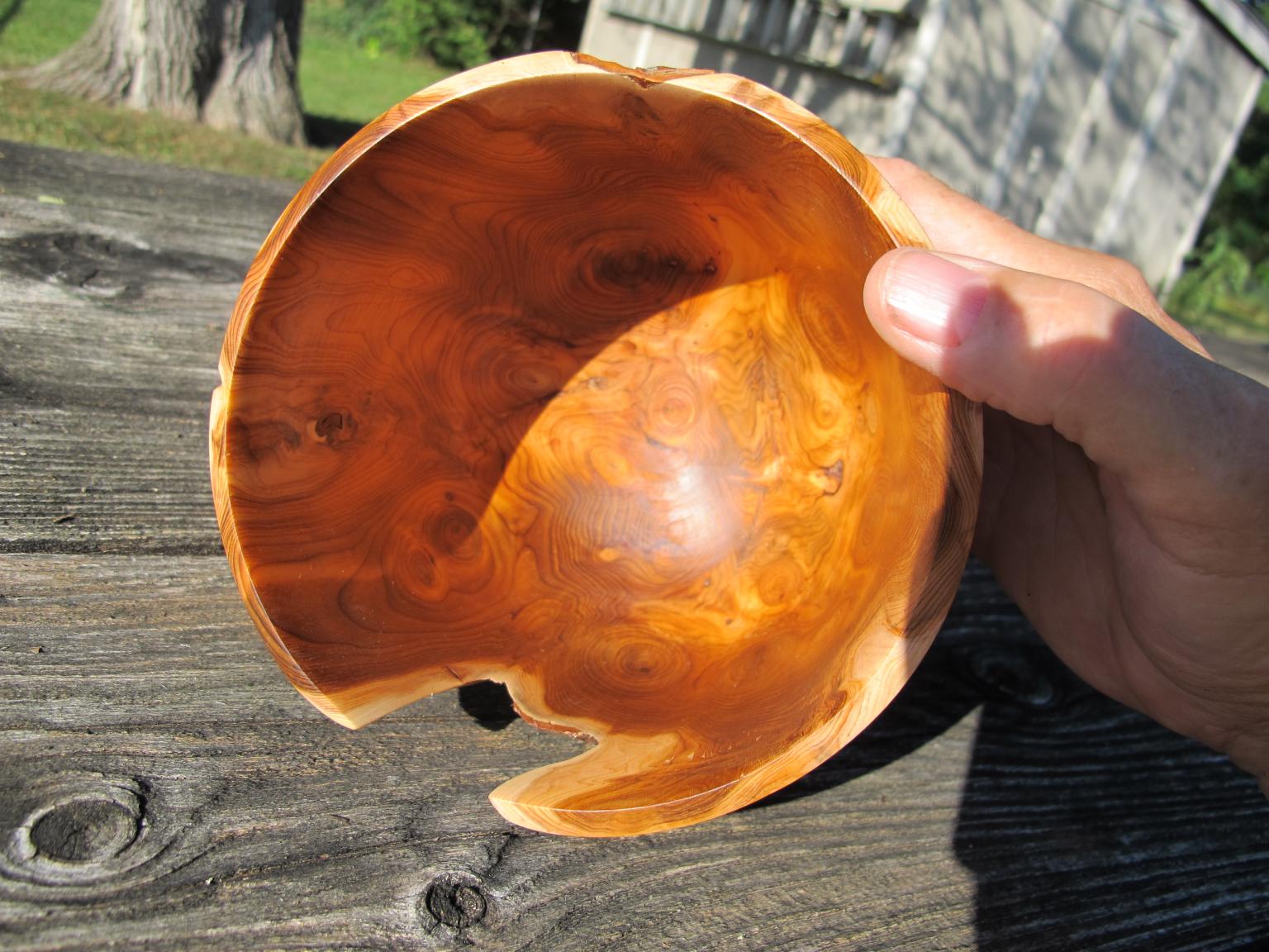

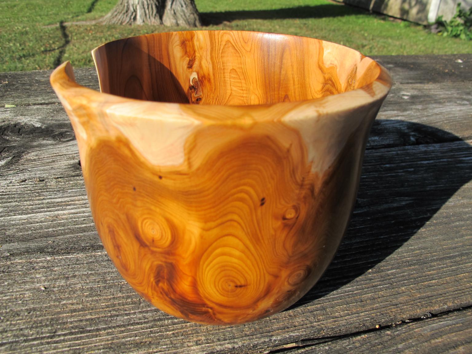

This is what I found hiding inside the piece of shrub

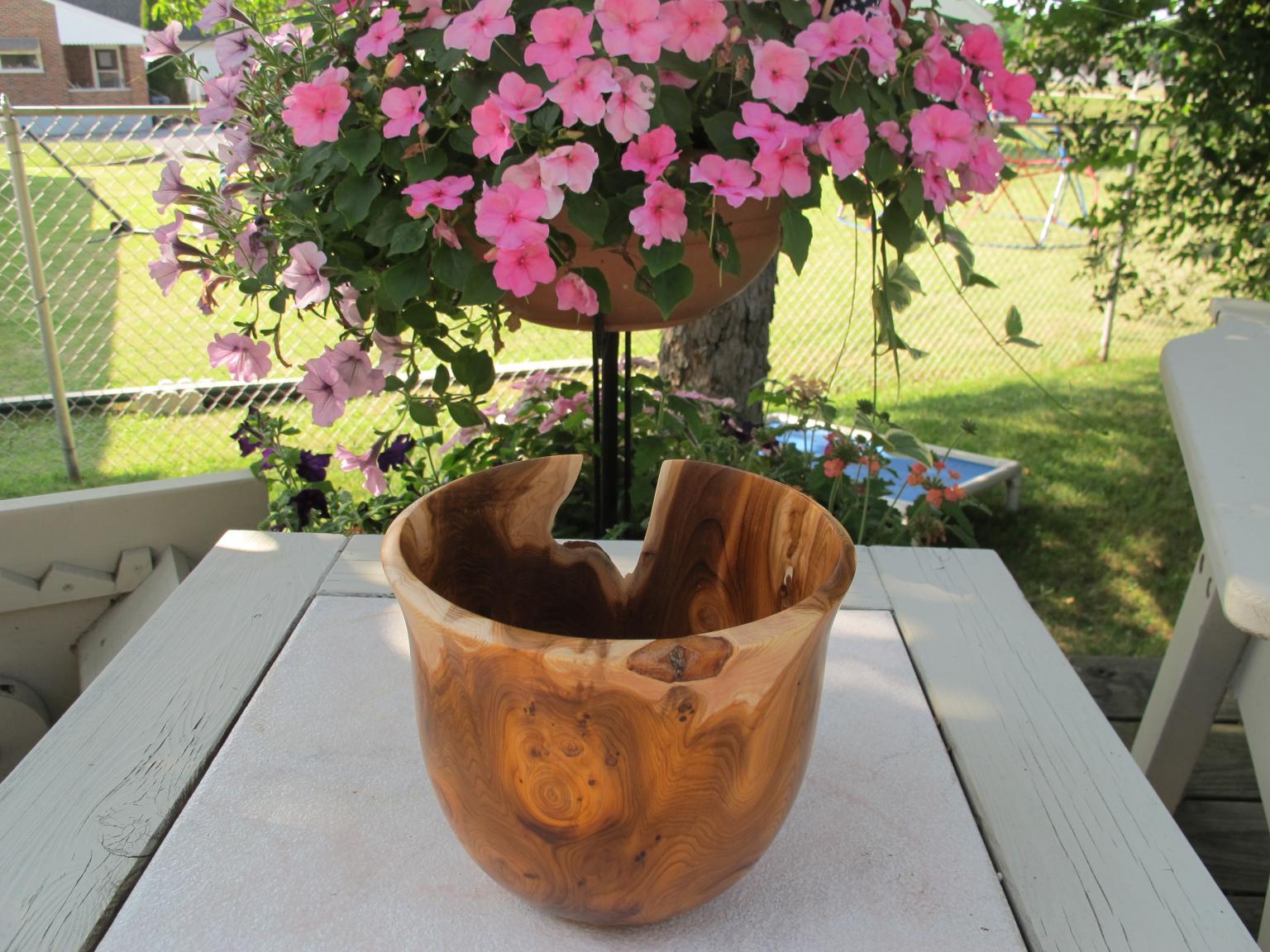

The turning is about 5" tall and 6" in diameter at the top. The wall thickness is a little more than I usually make it- slightly less than 1/4" but i wasn't too sure how thin I could go with the side being partially open. Thought about several different possible finishes. Ended up using a couple of layers of Johnson's paste wax.
Thanks for looking!

In all those beautiful images, one of the most fascinating ones I loved was those big calipers. That is really cool how you can see the thickness on the other side of the calipers. I will be making me some of those bad boys!

John- Those shop made calipers make quick checks easy. I'd really like to have a digital device- maybe when the old money ship comes in!
Gene- I need to perfect my photo skills. The actual colors are much more vivid and have a wider range of hues.
