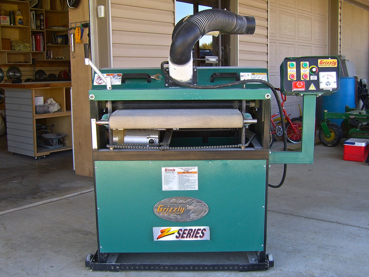

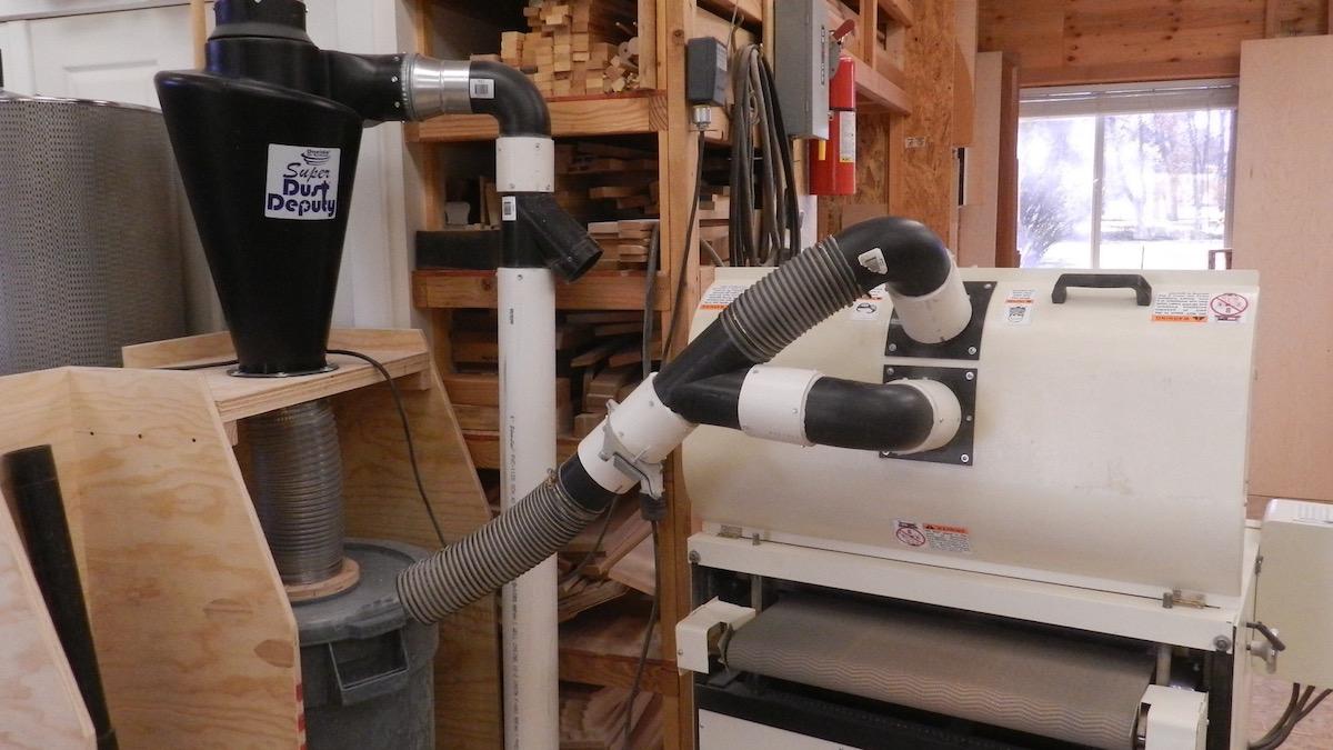

June 15, 201610 yr comment_66854 Here is a shot of the dust collection off the top of my sander. I included shots from both the Grizzly (which is still used at my brothers shop as seen in image) and the ShopFox which is currently in my shop. This setup allows for easy opening of the top. Edited June 15, 201610 yr by Todd Clippinger Report
June 15, 201610 yr comment_66862 1 minute ago, lew said: Awesome "plumbing"! Yep, 4" plumbing mates perfectly to ShopFox dust collection fittings! Although the fit does vary somewhat between brands of PVC pipe. Report
June 15, 201610 yr Author comment_66870 I like it. I have mine going to a Y and then to the ceiling and over to the DC. I just purchased all new gates to put in the shop that are the metal ones. All of the plastic ones leak and cost you lots of suction. Since mine is overhead, the top raises okay. Report
