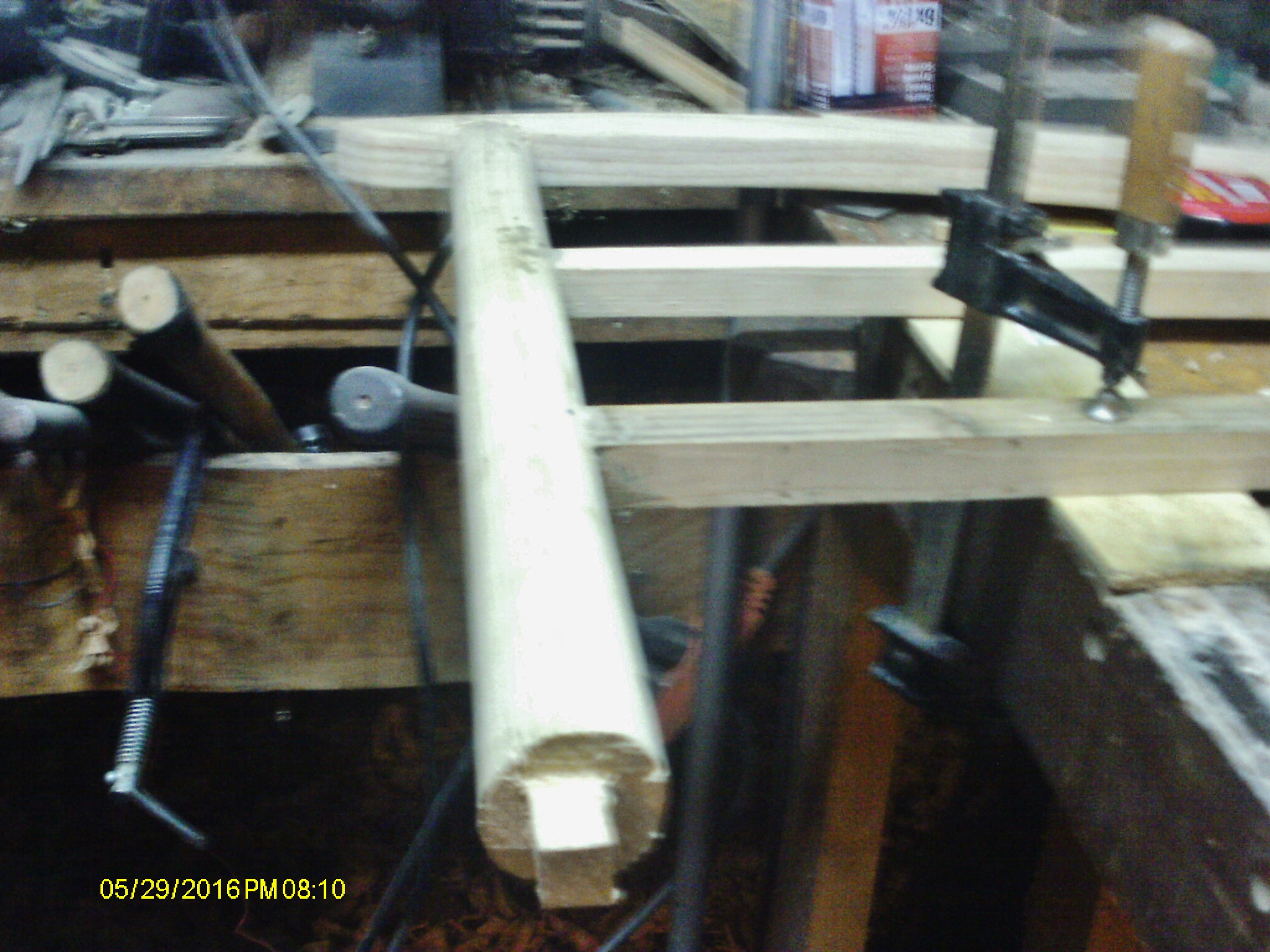

Managed to find a wee bit of time, to go and hide in the shop today.   Needed to cut a tenon on the end of the front post, so I could stash the side out of my way
And, yes I did use that big,old rip saw.   Keystone by Disston.  More on that later...stashed the completed side frame over with the other one..
1" tenon, designed to go throughthe arm rest, and be wedged in place......need to cut armrests...sometime...

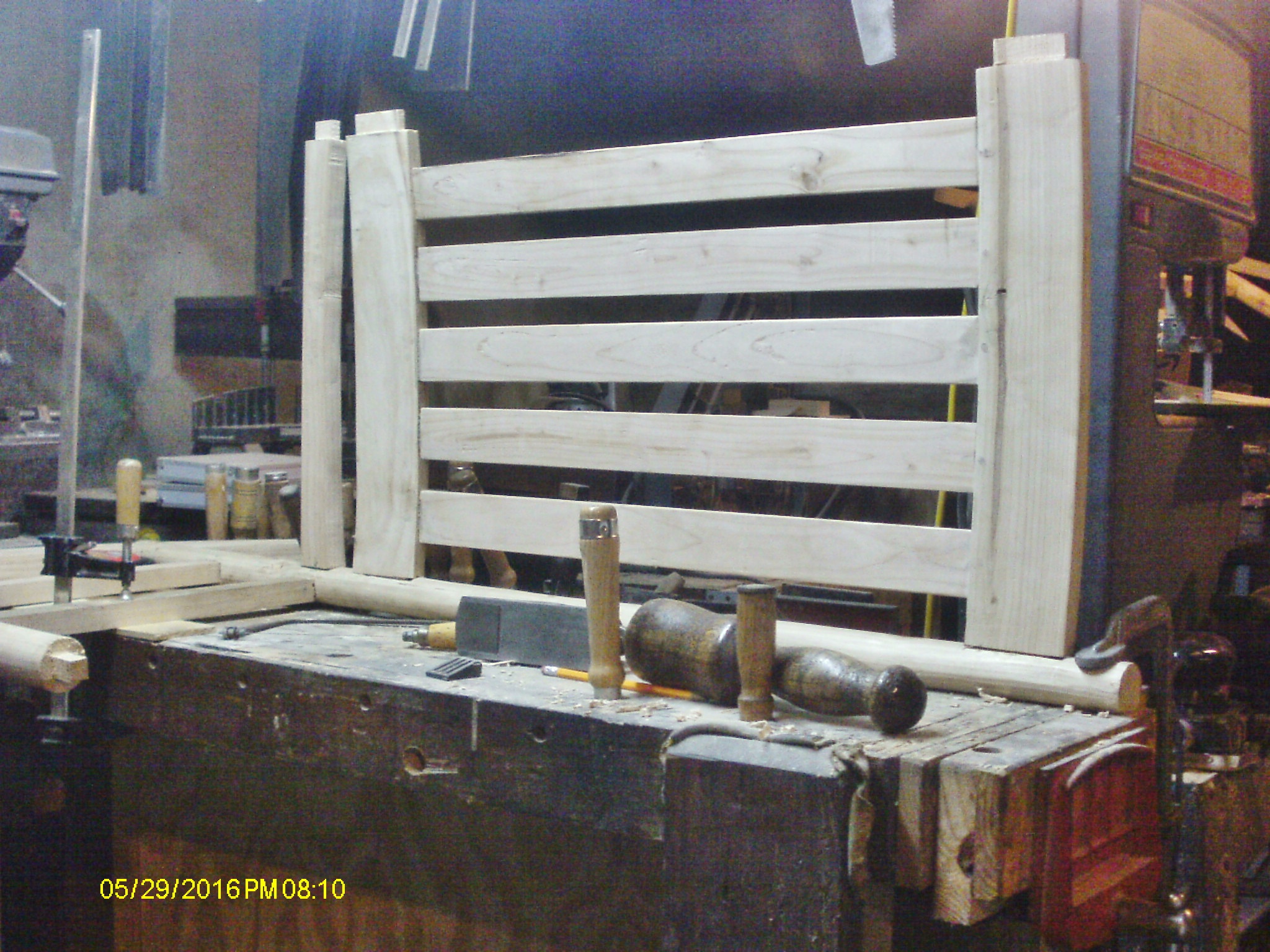

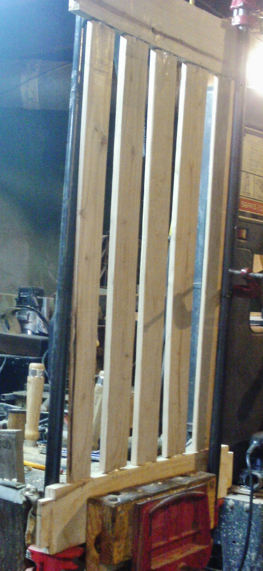

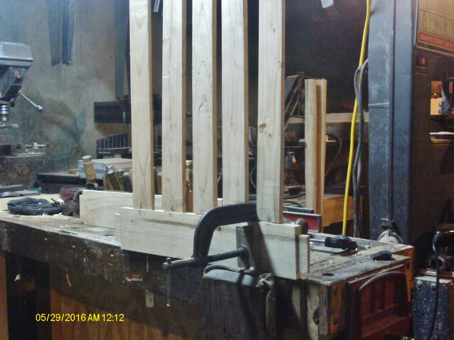

Fitted one rail to the five slats tonight....lots of chopping going on..

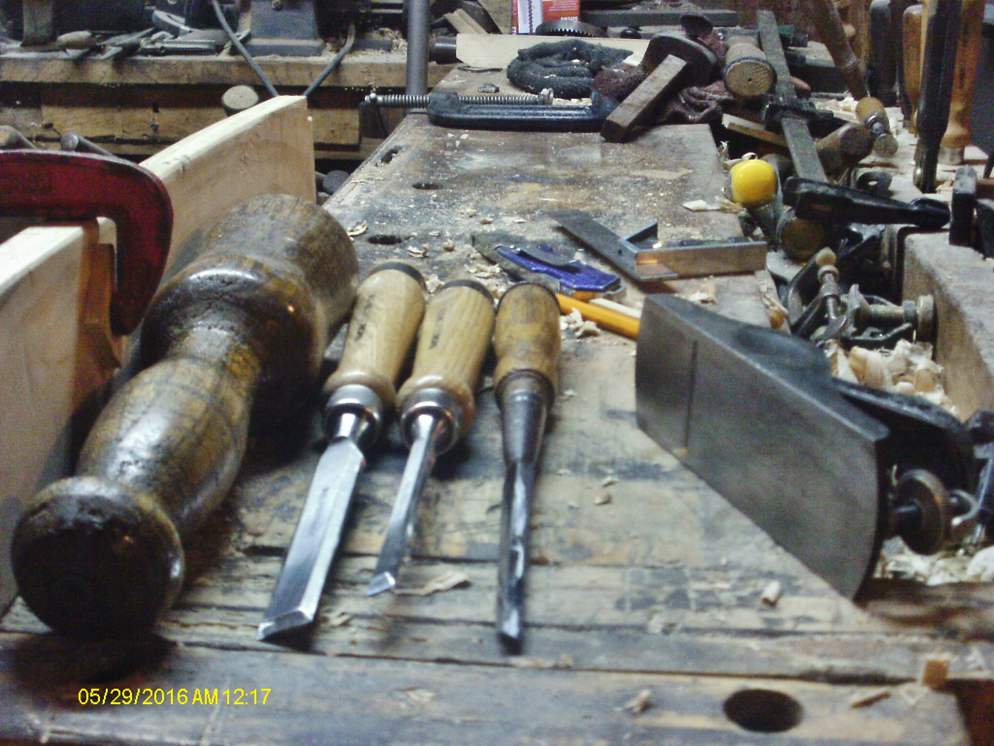

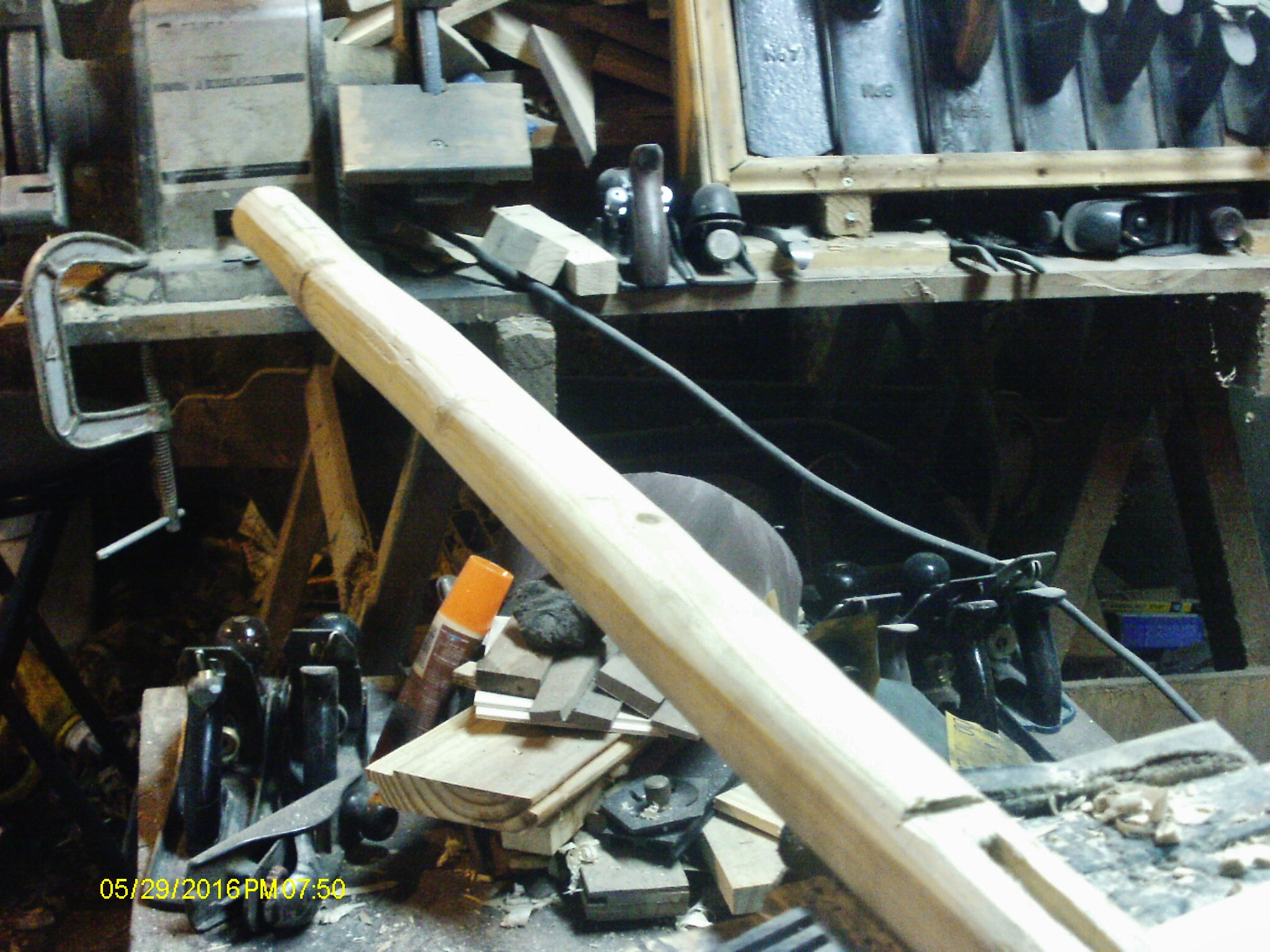

This is actually the top rail.   Will try to do the bottom one later, IF I can get a bit of shop time.   Usual cast of tools to do this little job
That big old c clamp in the background?  Seems it is bent, and works loose....may take it back to sears.   Plane is to "adjust" the tenons a bit..

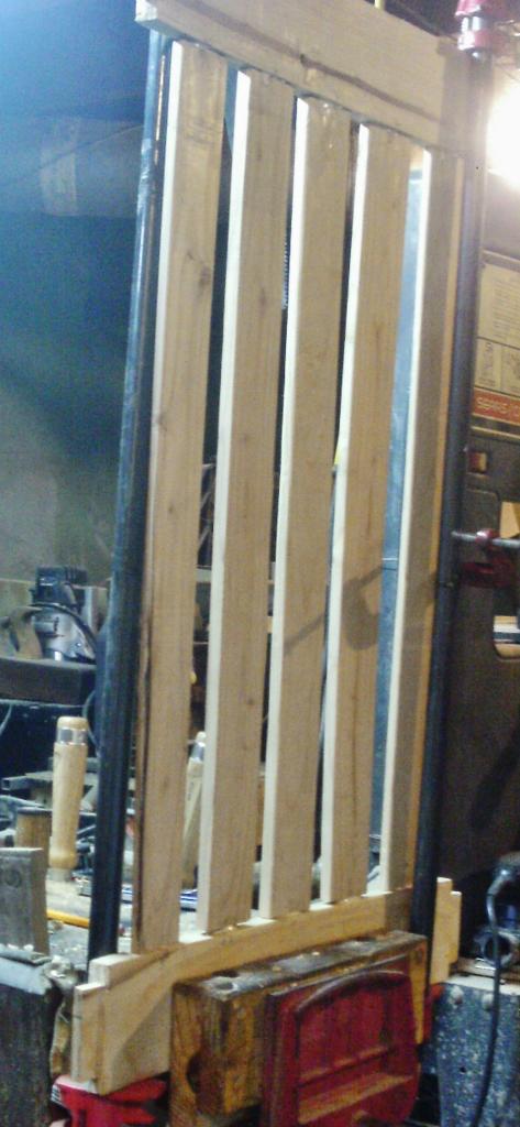

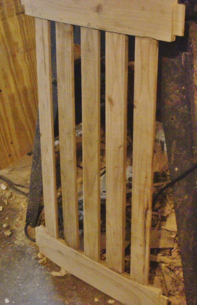

Back is now in the clamps, glued up, and pinned..

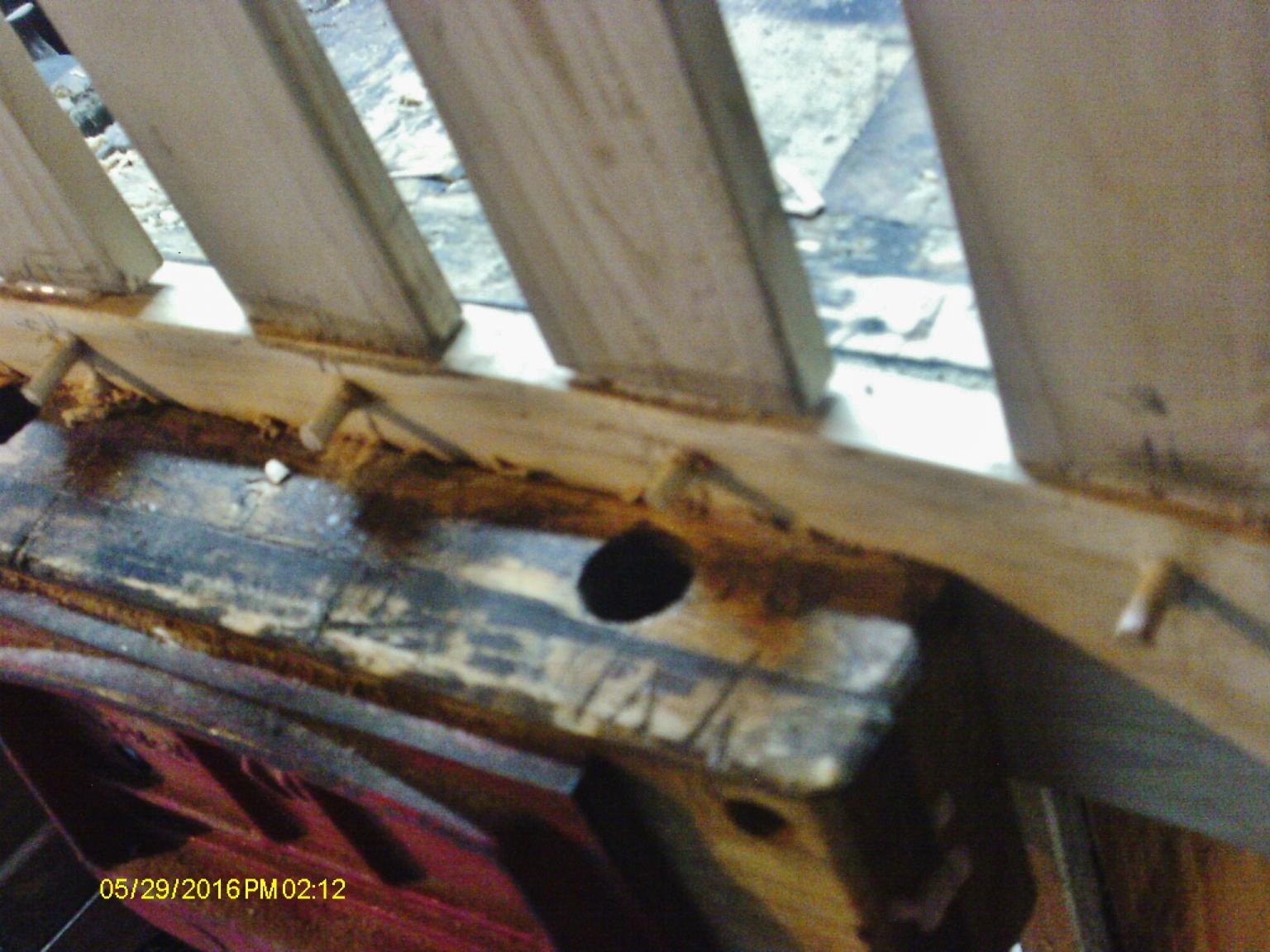

Then a dowel pin into each joint..
Not waiting on the glue to dry.....
Let the glue cure awhile, then went back down and got back to work.
Out of the clamps, coping saw to trim the pins, then sanded flush.....kind of hard to plane them.   Set the assembly aside

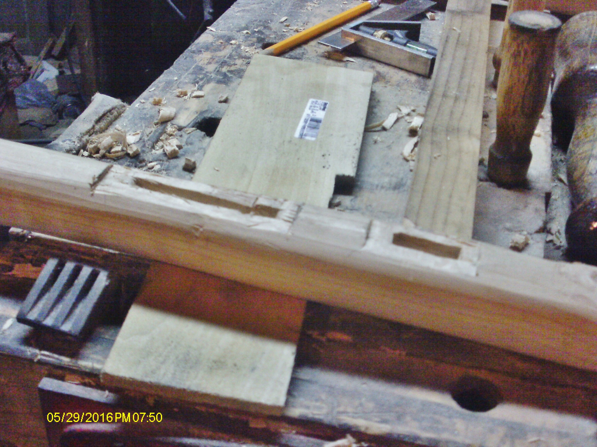

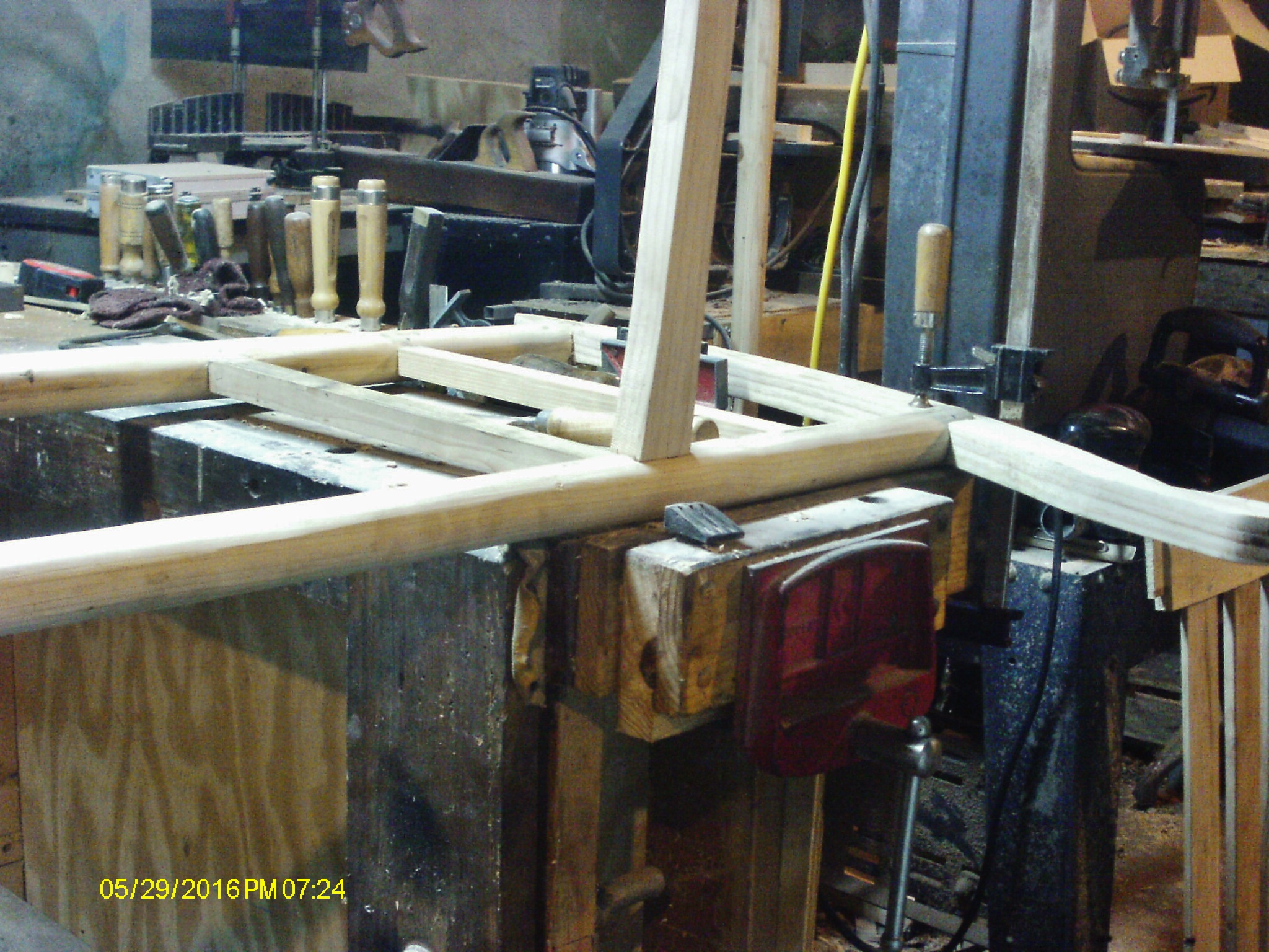

Not too bad?   Cleared the deck, had a side frame to chop into....
Getting to be a challenge to clamp this thing to the bench.   That be the back support for the seat..   Cut a "flat" to get it to sit all the way down.   Slid the frame a bit, and chopped another mortise
Note the flats?   The longer mortise is for that back assembly.   At least for the bottom rail.  Top mortise might have been a challenge..
Looks like I have to move things around...again.  Got the top mortise chopped, and a flat formed.   Test fits?
Needs a bit of fine tuning....will do, for now.   Laid out for one more mortise, but...

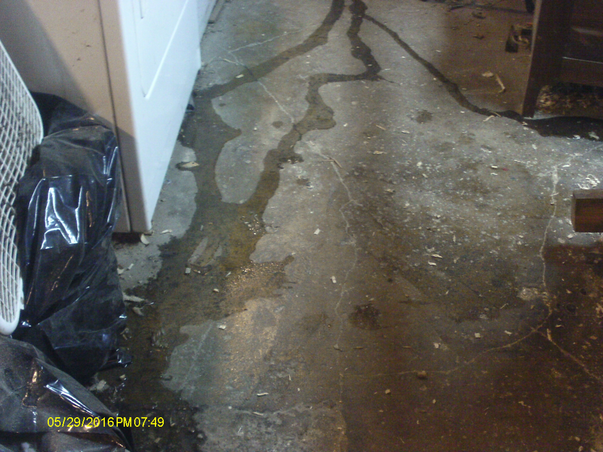

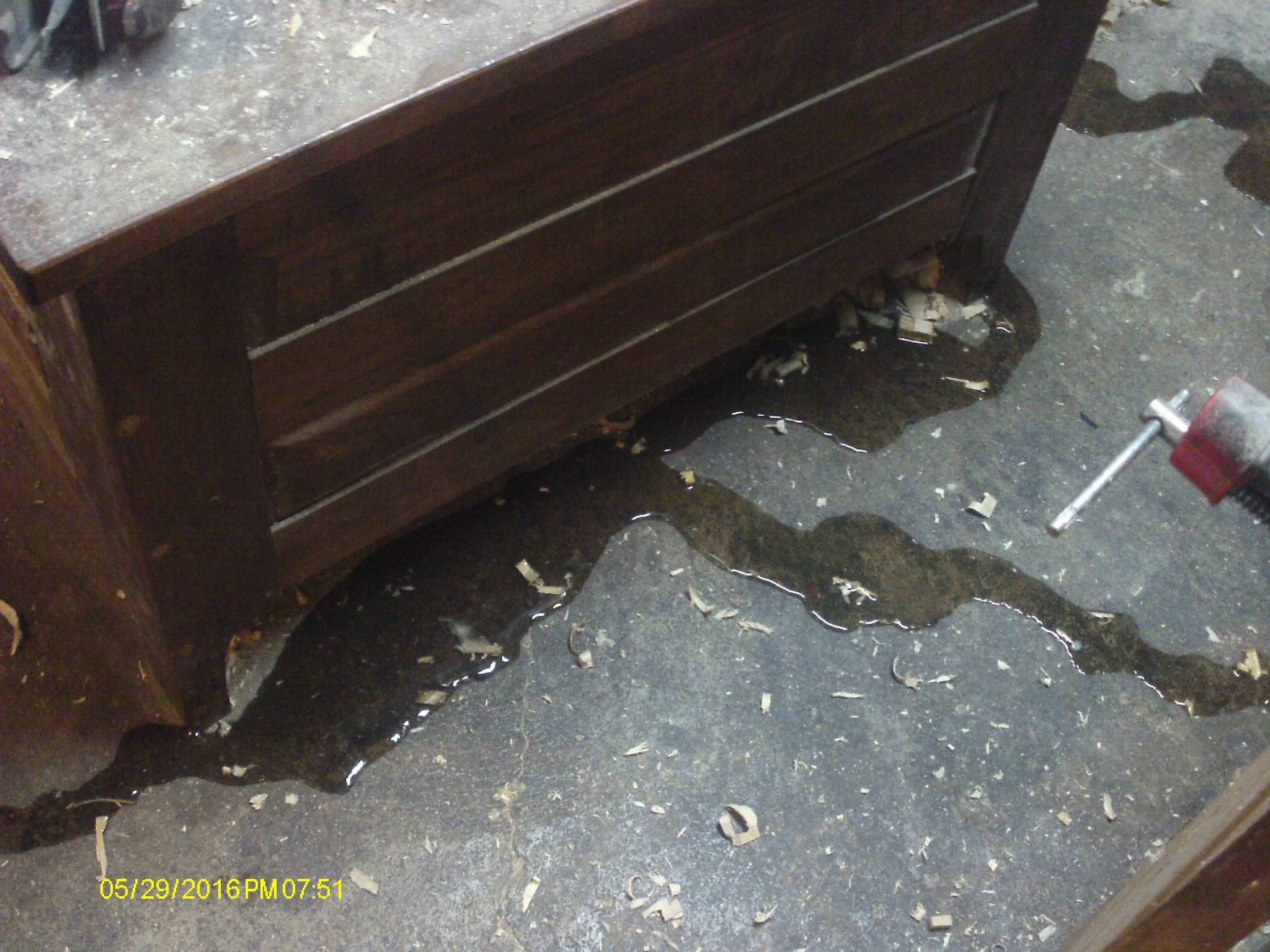

Will have to wait awhile, Gulley-Washer came through tonight....
We have a creek in the shop....
yep, right about where I have to stand.....quitting time.
