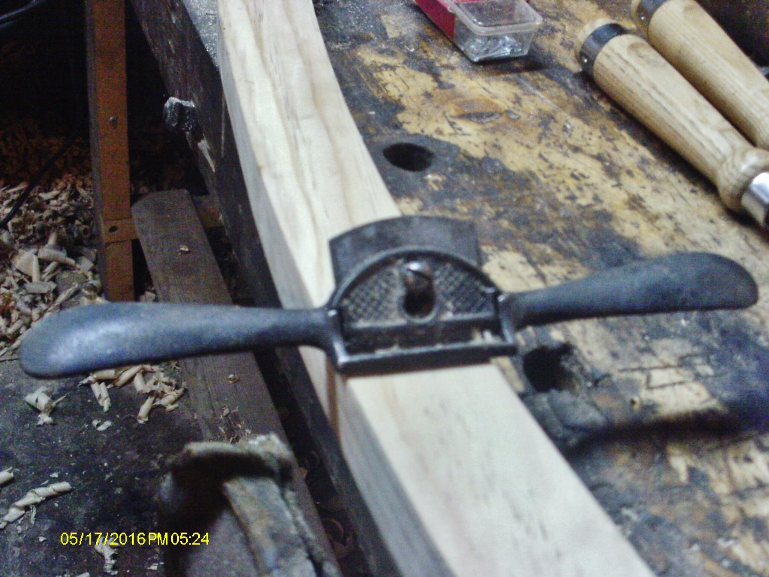

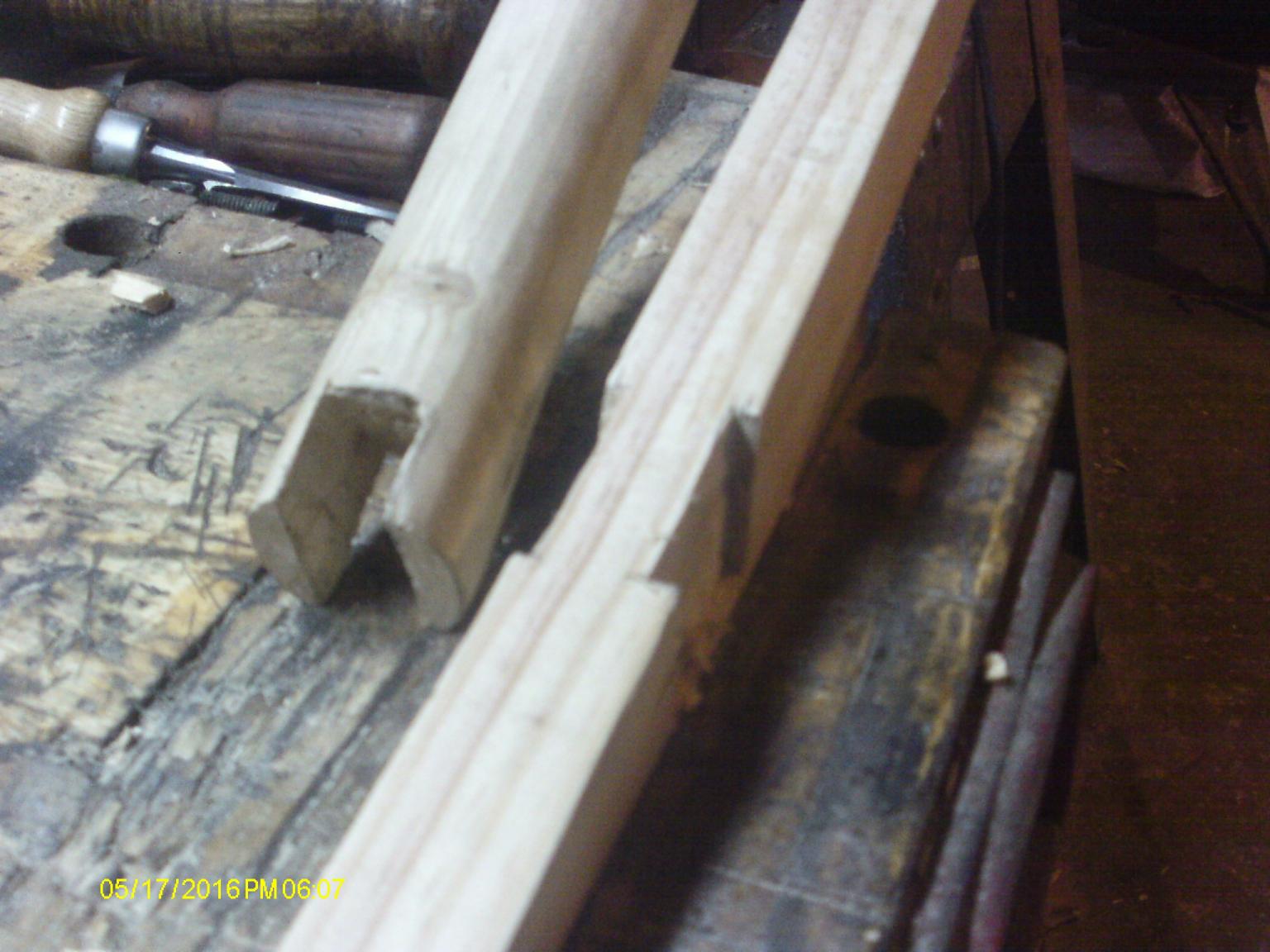

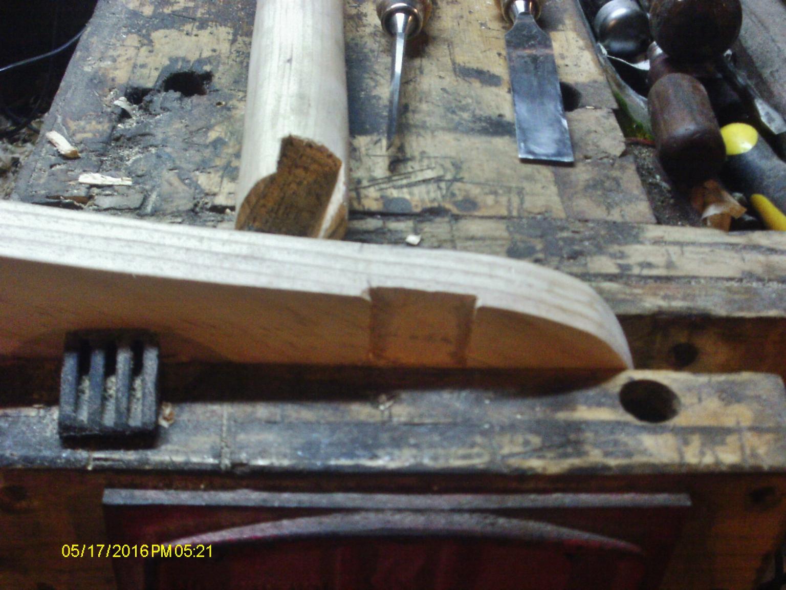

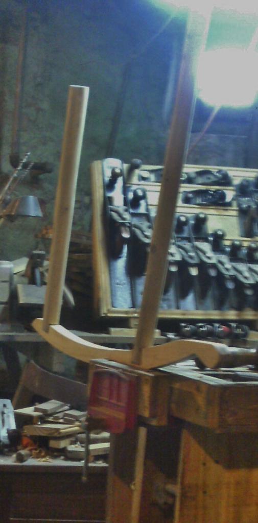

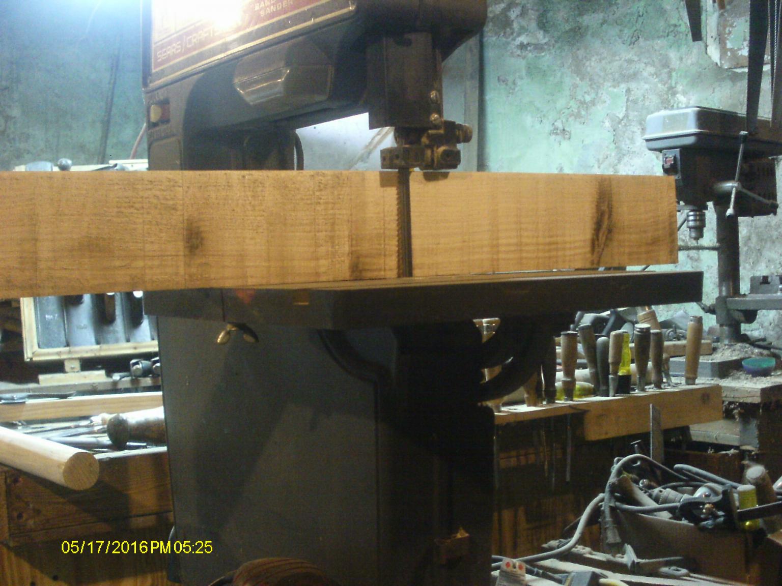

May 17, 201610 yr Author comment_66410 well, cleared the bench. rehabbed a spokeshave, first. $3 one from last weekend.. With THAT out of the way, tried to resaw some stock for the rocker.. But it was making a lot of noise, and throwing sparks...tore it down, reset the guides ( lower thrust bearing was rubbing the frame) reset the table, stoned the back edge of the blade....lot quieter, now. Ok, NOW can I work on at least one side of this rocker? Front post about fitted. Made the slot a bit too wide in the bottom of the leg, will do better on the next one.. A little better. Will pin and glue both at a later date. need to find some sizes, lay out some mortise and tenon stuff.....August completion date?? have to measure for the seat parts, as well. Busy day. Even redid the blinds on the house's backdoor window. And, got "drilled" in a finger by the tip of the driver's phillips head tip. Yep, back on track, now Report
