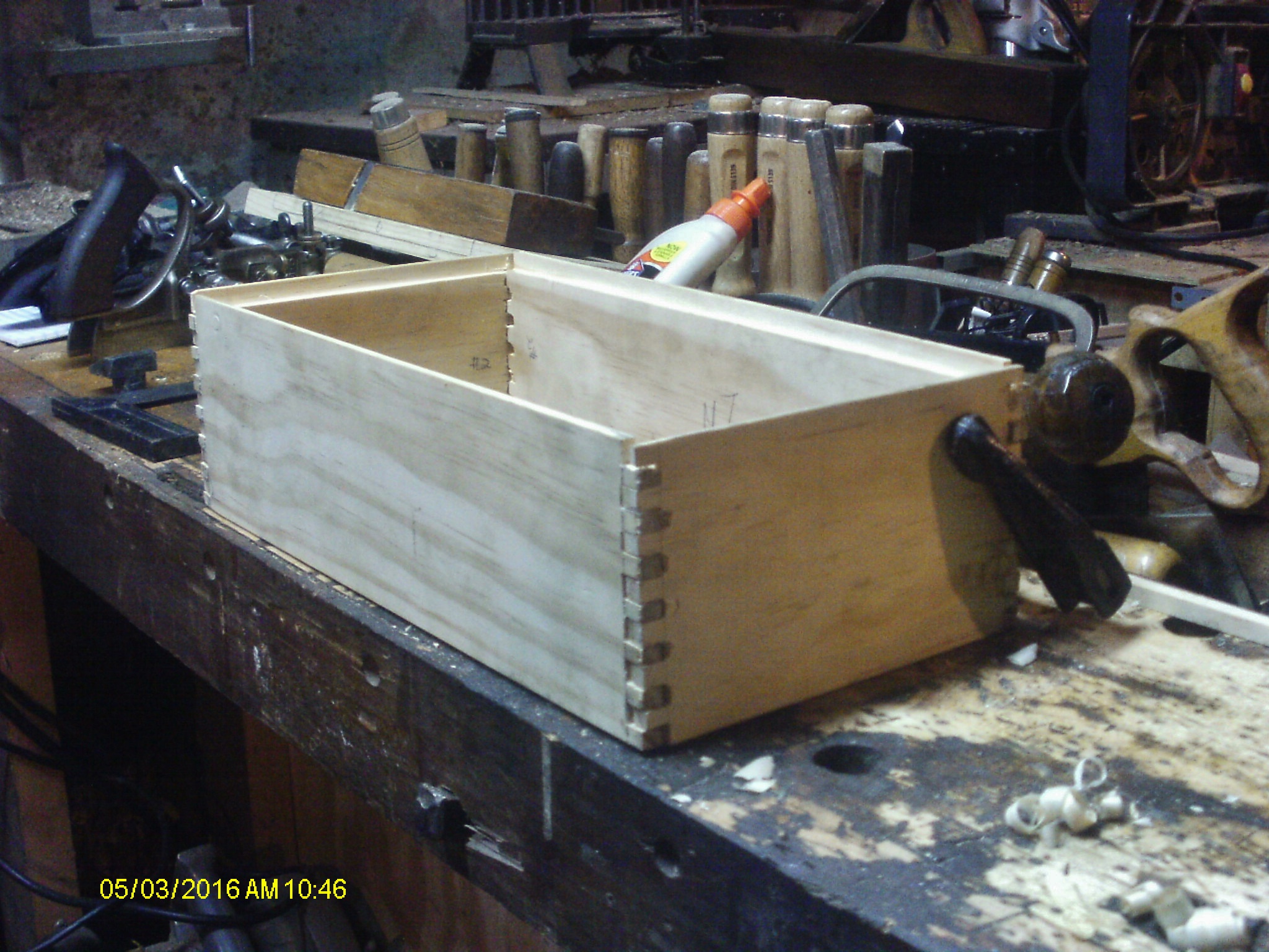

Almost. Look at that corner?   Decided to just go ahead and glue the sides up.
Took just about all of these style clamps.  Might need to be on the lookout for more this season.   Once it was clamped up, and squared up, I could fine tune the panel better.   Problem was..This thing was sitting just about on top of my vises.   Hmmm, time to Crochet..
That is what that hook is called.   Took a few tries, but finally got the panel to actually fit in the rebates made for it..
No glue for it, though.  I did used a few 3/4" long nails to secure the bottom to the sides.. let this mess sit awhile, Lunchtime!!
