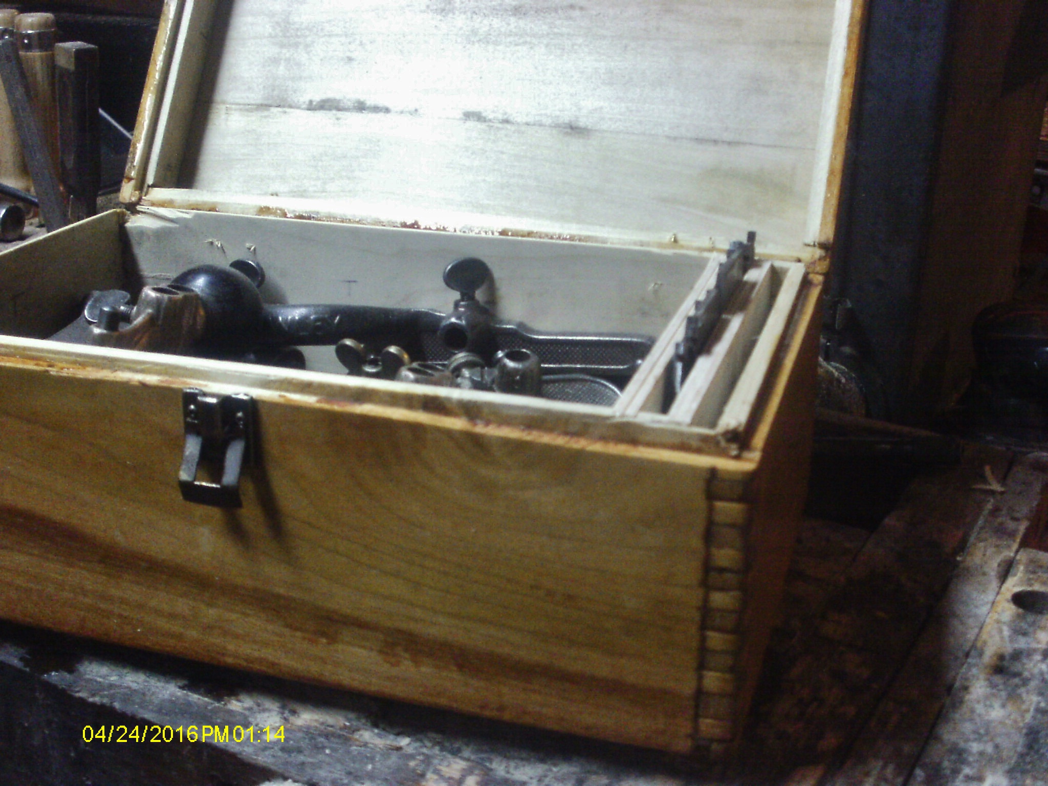

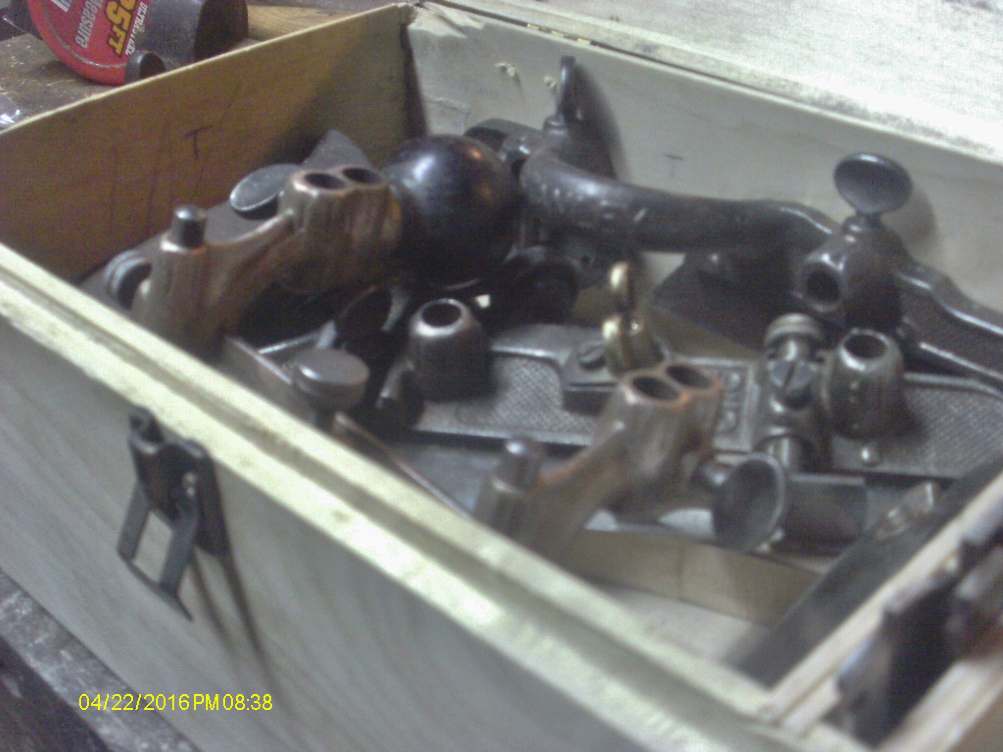

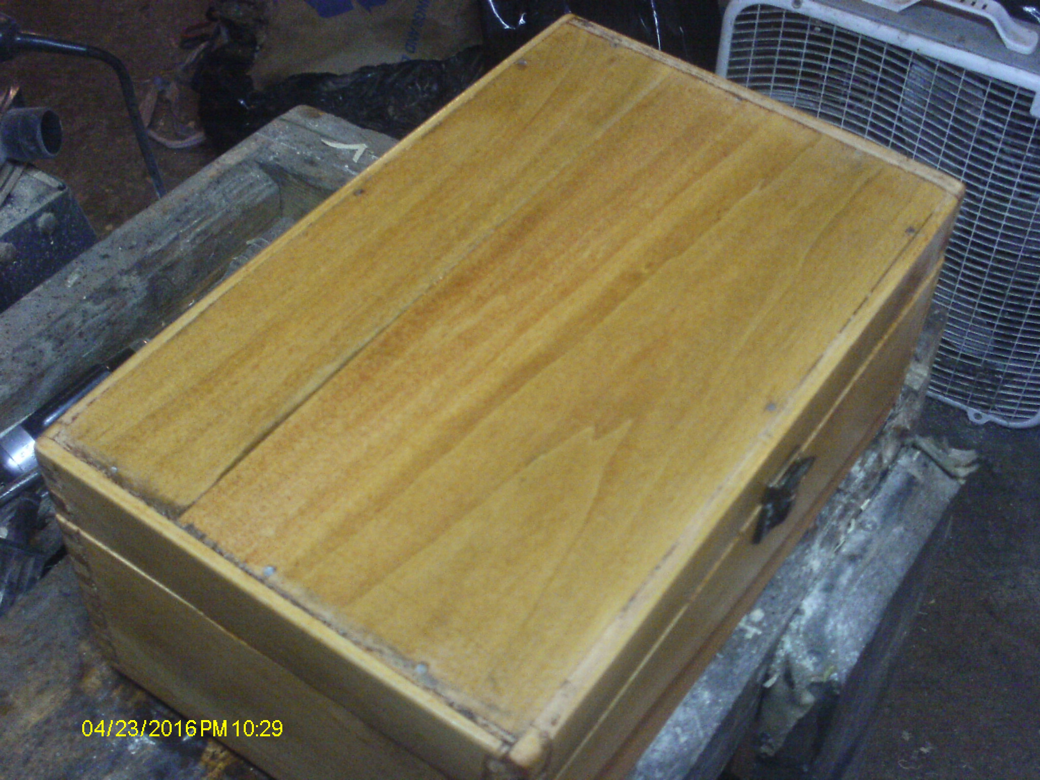

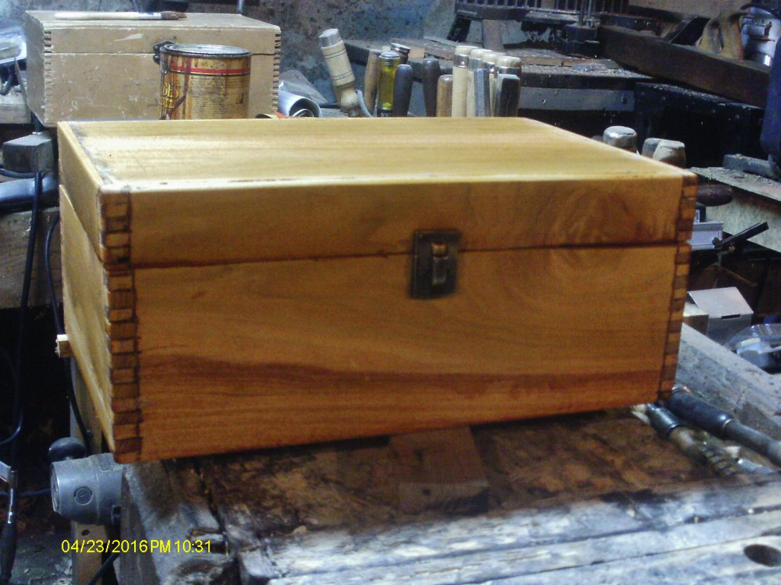

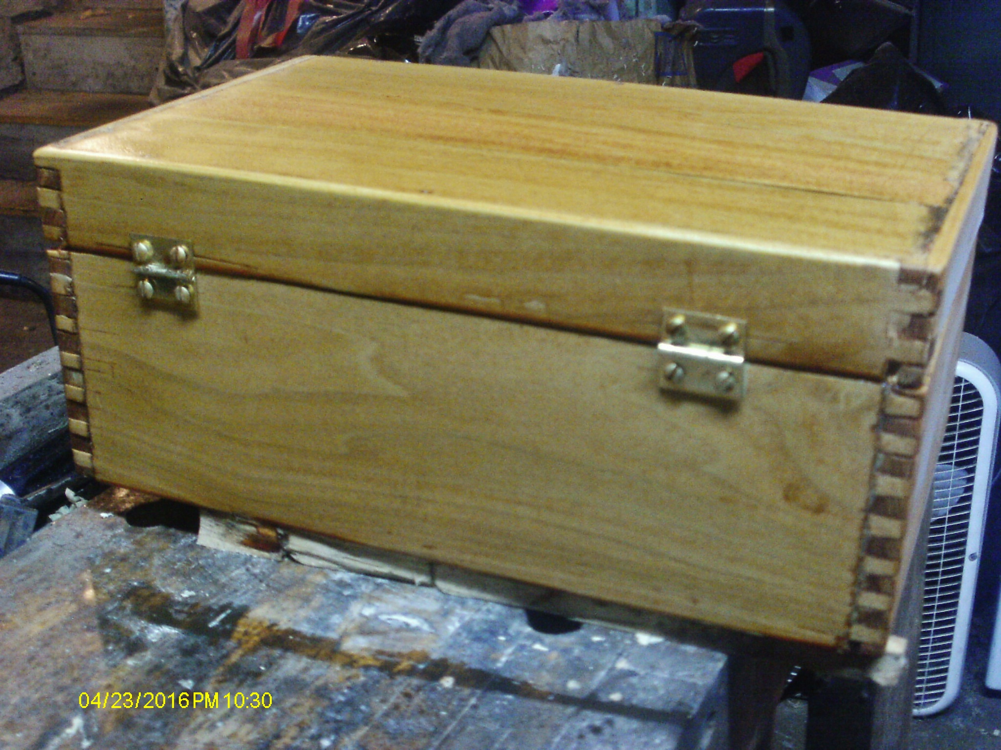

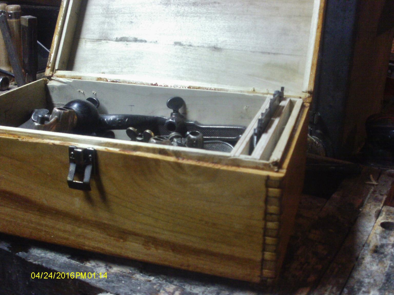

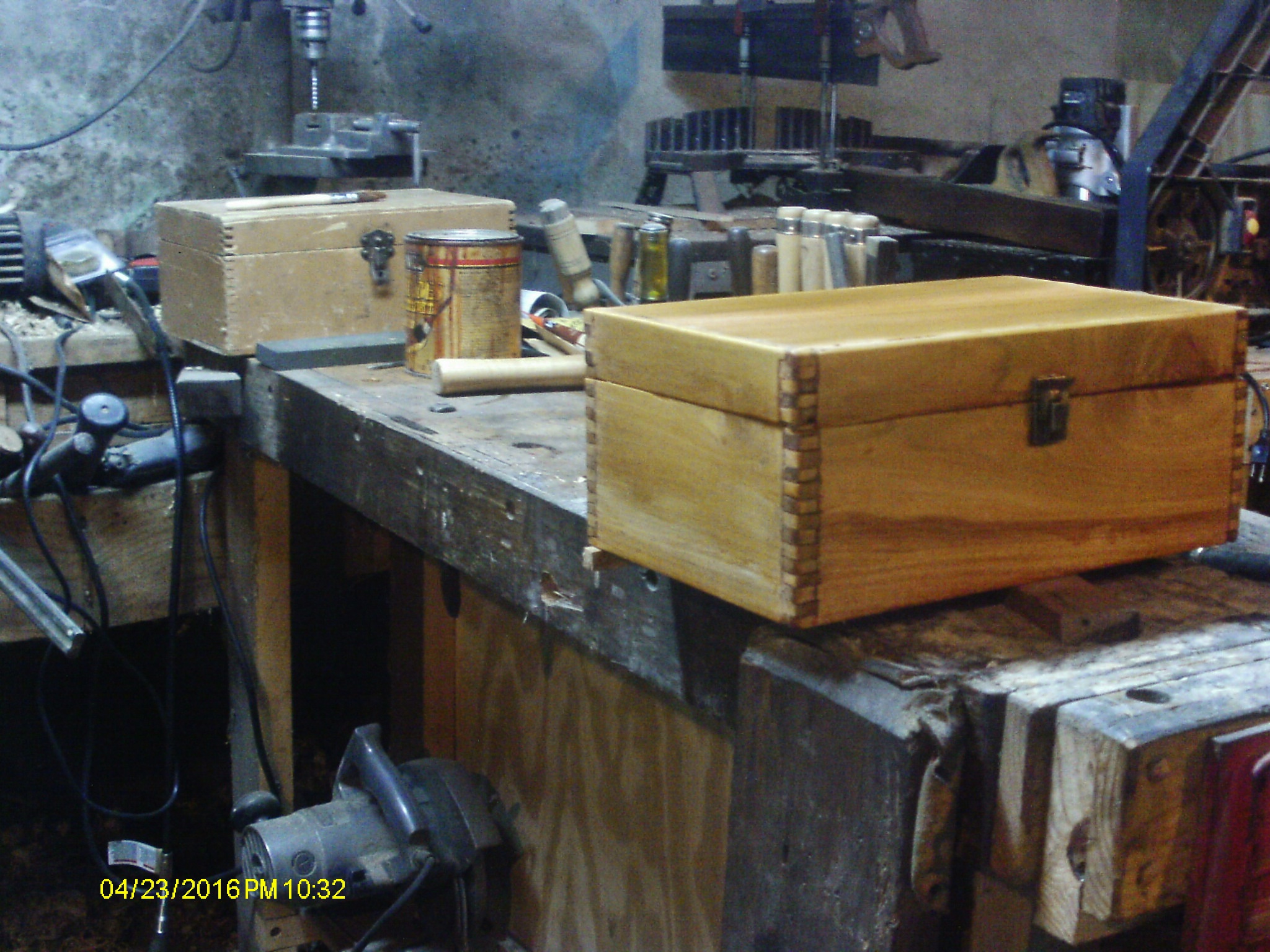

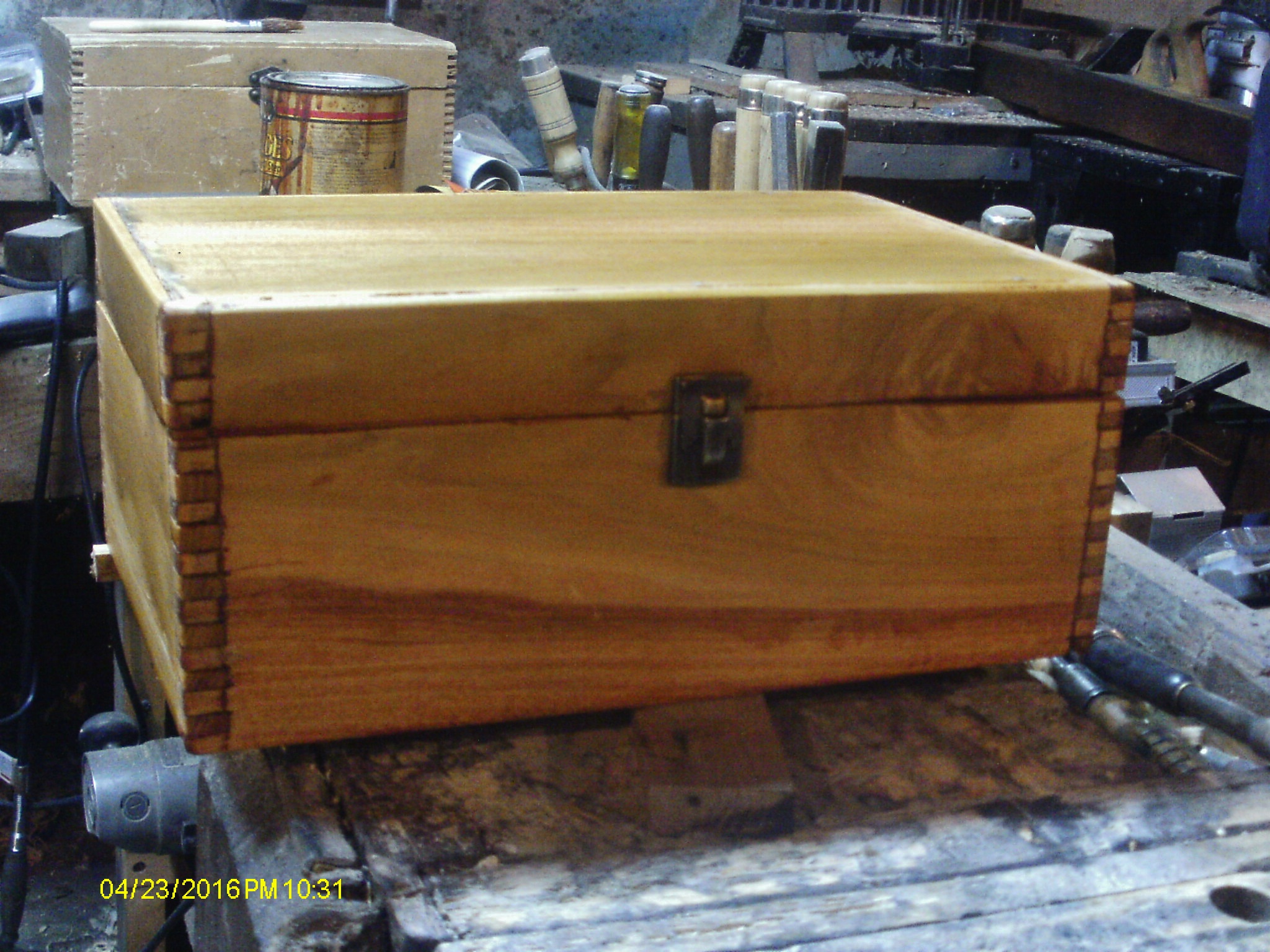

April 24, 201610 yr comment_66008 Gaps filled and sanded, Witch's Brew brushed on Racing stripe showed up AFTER the finish went on...figures Back is a bit plain looking... Top was a glue upof two boards. Tried to match the grain... Been trying to match the old box, I think I might be close? Needs a rub out tomorrow, then a top coat. All this work, just to store a Stanley No.45.... All there, even the 22 cutters I got with it. Missing the two match cutters, and a depth stop for the slitter, is about all. Report
April 24, 201610 yr comment_66009 That's one nice plane box, Steve. Did you have to ease the lid retainer? I ask, because I saw the initial dado before the cut and was wondering how it was to fit. Report
April 24, 201610 yr comment_66010 Pretty danged cool Steve, you just keep plugging along and building, building, and building. Thanks for the inspiration Steve. Report
April 24, 201610 yr comment_66014 At first, I thought you had a mirror set up to show the back side of the box! I'd say the two match pretty dang well!! Report
April 24, 201610 yr Author comment_66015 2 hours ago, Gene Howe said: That's one nice plane box, Steve. Did you have to ease the lid retainer? I ask, because I saw the initial dado before the cut and was wondering how it was to fit. Had to take the shoulder plane all around the top edge, test fitting all the way....still not quite perfect, but it is usable. You think Doe would approve? Report

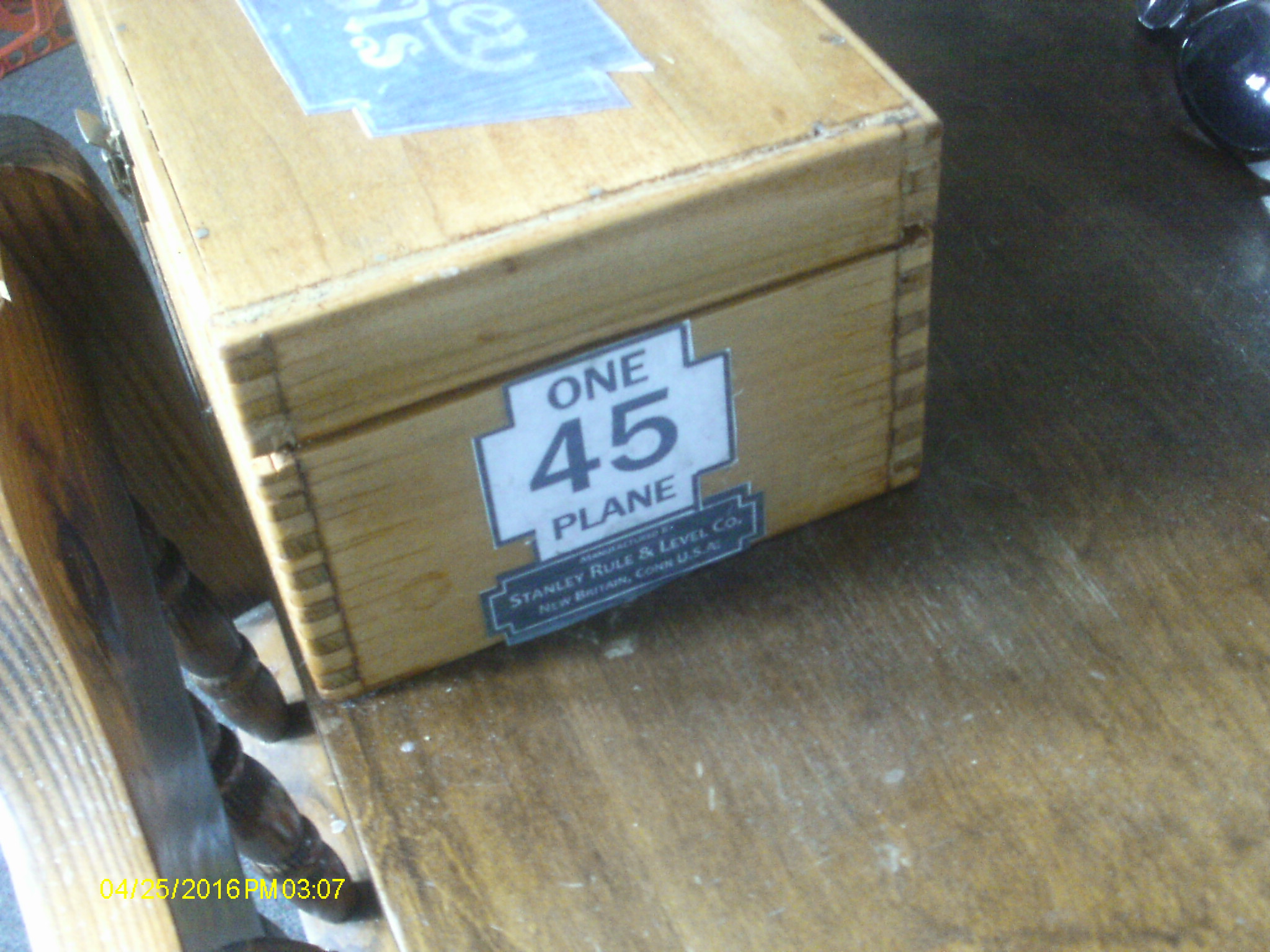

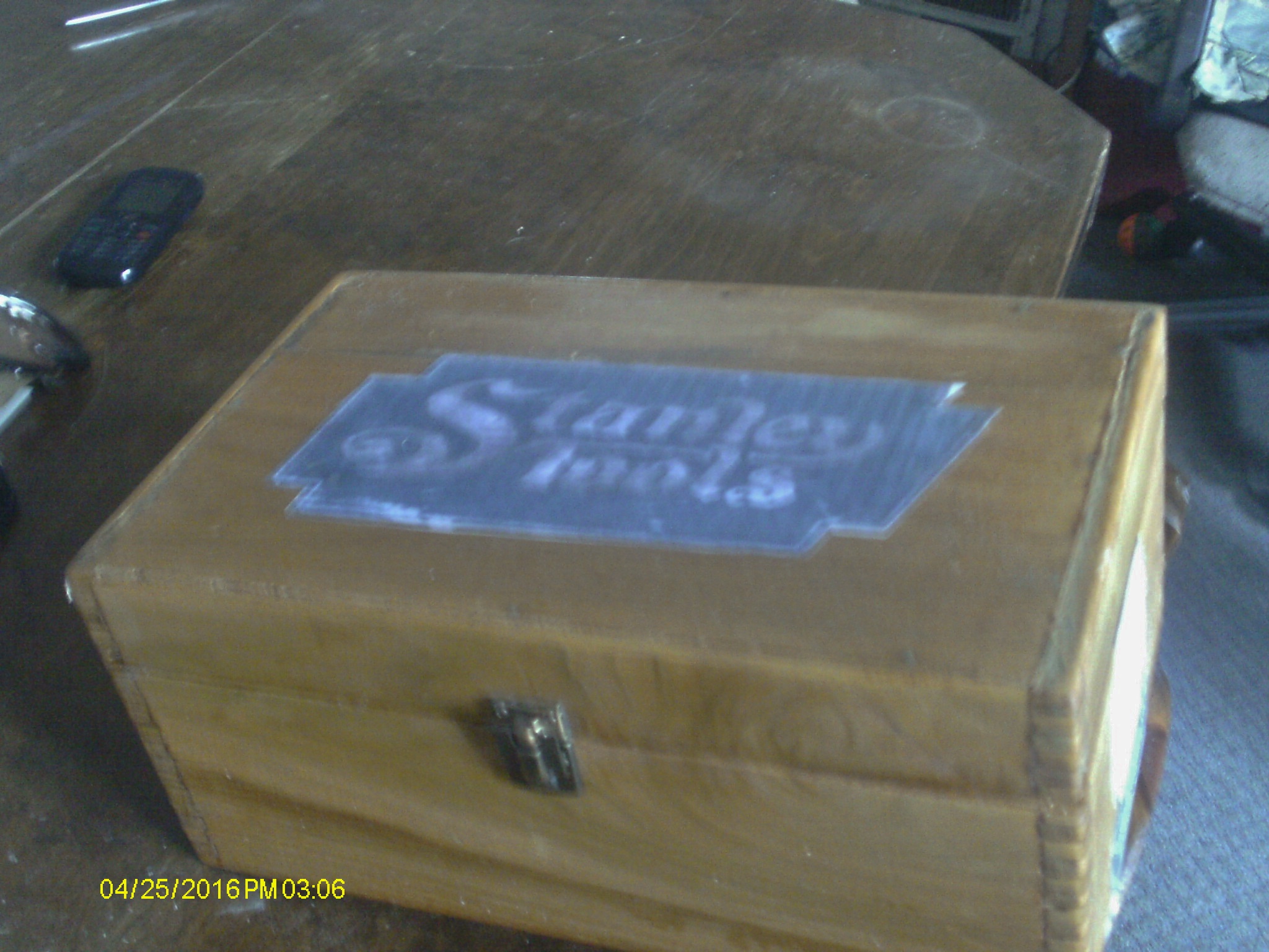

April 26, 201610 yr Author comment_66056 Found some labels to print out At least so I can tell what is in the box Bottom label will get corrected, when I find the right one. This is a Canadian made Stanley, after all..... Report

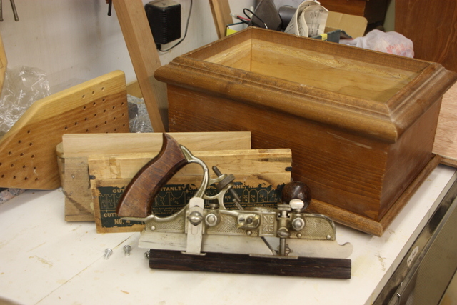

August 22, 201610 yr comment_68848 It looks like you take it apart to store ....or am I just not seeing right. Now I have to make a new box for mine . I used some MDF panels and trim from a drug store (I am a Pharmacist so shop is full of pharmacy paraphernalia) and it is HEAVY. Report
August 22, 201610 yr Author comment_68851 Yep, Everything has to store flat in the box. I took the measurements right from the OEM box. Rather than try to fix the broken box up, I built a new one out of Poplar. Other than the wood used, it is an exact replica, right down the the cutter stowage. Report
