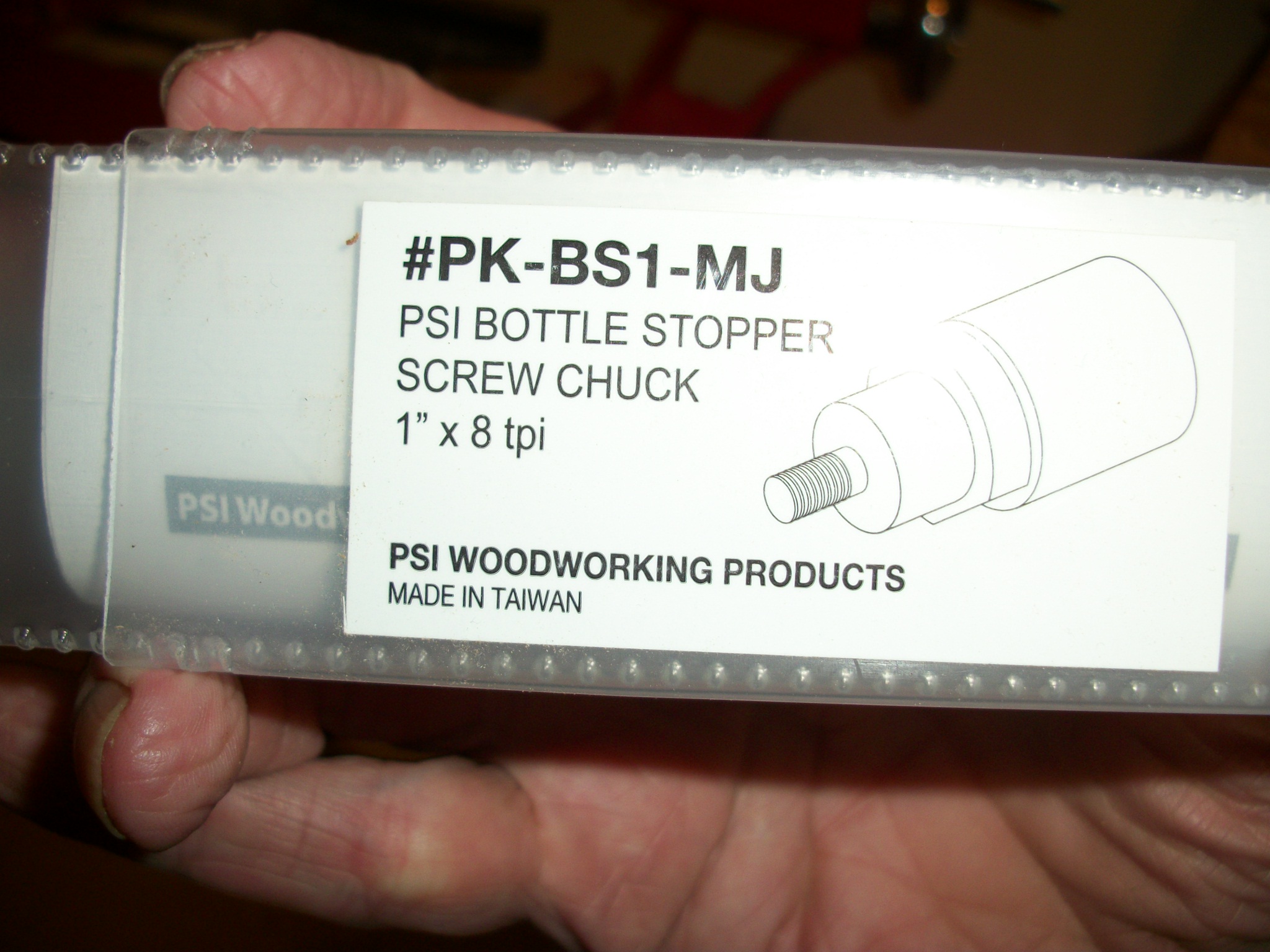

April 21, 201610 yr comment_65931 Looks great Charles. I've never turned one. What are you using to hold it when turning. The picture don't show how you do it Report
April 21, 201610 yr Author comment_65933 24 minutes ago, Ron Altier said: Looks great Charles. I've never turned one. What are you using to hold it when turning. The picture don't show how you do it Hi Ron and thanks. The first image shows the bottle stopper piece mounted to my lathe by way of a bottle stopper chuck, this basically is a 11/32 by approximately 20 tpi chuck that screwsinto the wood then onto my 1"x8tpi headstock. For those that use Ruth Niles stopper hardware, this chuck is going to leave the wood a bit proud, so you'll have to probably trim the blank down a bit more for hers, or get her chuck. Here it is in the box. Edited April 21, 201610 yr by Charles Nicholls Report

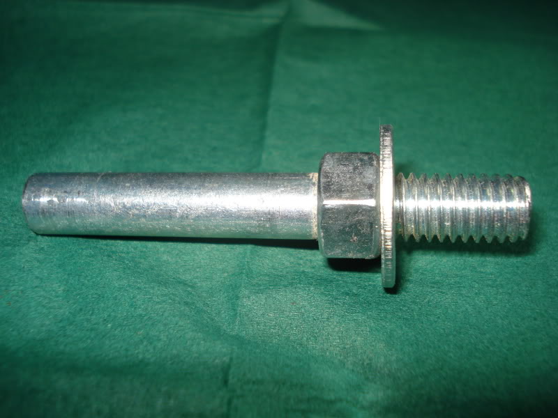

April 21, 201610 yr comment_65934 I made a mandrel by cutting the head off of a machine bolt. The diameter/threads matches the diameter/threads of Ruth Niles' bottle stopper's threaded portion. I use a Jacobs Chuck with a Morris Taper that matches my head stock to hold the bolt/stopper blank while turning/sanding/finishing. I'm a cheapskate! Report
April 21, 201610 yr Author comment_65935 22 minutes ago, lew said: I made a mandrel by cutting the head off of a machine bolt. The diameter/threads matches the diameter/threads of Ruth Niles' bottle stopper's threaded portion. I use a Jacobs Chuck with a Morris Taper that matches my head stock to hold the bolt/stopper blank while turning/sanding/finishing. I'm a cheapskate! HA that is a great way to do it Lew, I wish I had done that, but didn't have the ability. That said, mine was only about $20 including shipping. Edited April 21, 201610 yr by Charles Nicholls Report
