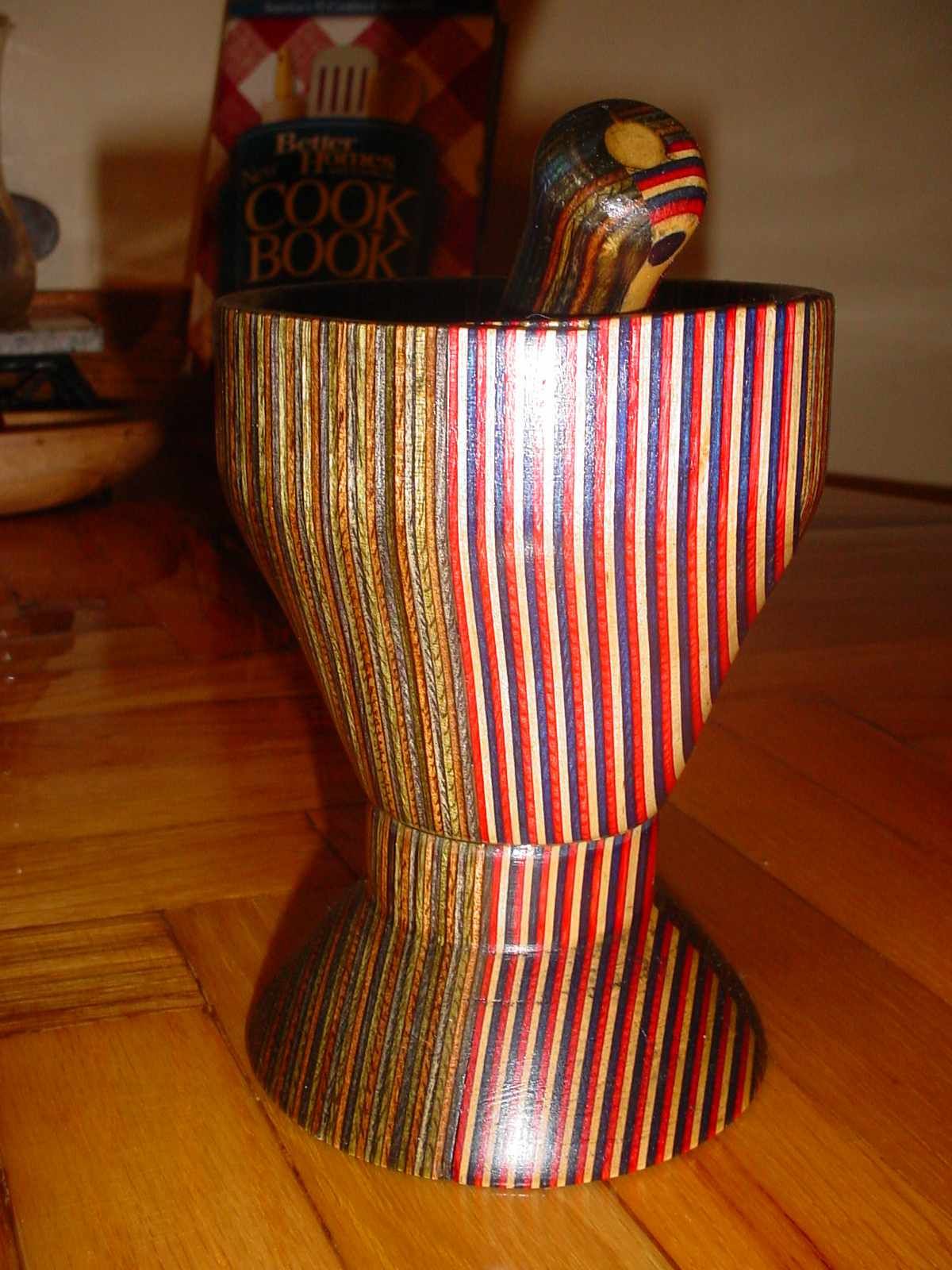

March 1, 201610 yr comment_65305 My wife bought a wooden spoon that has layers of different colors. I've worked with many exotic woods and I don't believe that all of those colors exist. If they are real, they would be too expensive to use. However I can't figure out how they got the stained color layers put together. Ideas? Report
March 1, 201610 yr comment_65306 Got a dollar says that it is dyed and turned. Colors are too bright to be natural wood. Report
March 1, 201610 yr Author comment_65310 How would you get the color thru the wood so it could be turned? Maybe under pressure? Report
March 1, 201610 yr comment_65311 I think it is a special plywood with each of the plys dyed. My sister bought me a turned scoop with the same type of coloring. Report
March 1, 201610 yr Author comment_65315 You are right Lew, I found a website that sells it. However the site is down for maintenance. I'll keep an eye on ti and when it becomes available again I'll post it. I also found a site in China...................NO and not. Report
March 1, 201610 yr comment_65336 http://www.cwp-usa.com/collections/spectraply-blanks it's a fun and interesting wood to work with. They are made from individual dyed and laminated birch veneers. Report
March 2, 201610 yr Author comment_65341 Thanks John, I ordered some pieces and am anxious to make some things. Report
March 2, 201610 yr comment_65342 the wood is dyed and laminated. There are gun stocks made this way https://www.google.com/search?q=dyed+and+laminated+wood&safe=off&tbm=isch&tbo=u&source=univ&sa=X&ved=0ahUKEwjU89W5i6HLAhUCmh4KHSPCD1IQsAQILQ&biw=960&bih=423 http://singletrackworld.com/forum/topic/woodwork-dye-gun-question The material is a factory product where they can get the dye to penetrate probably using vacuum Report
