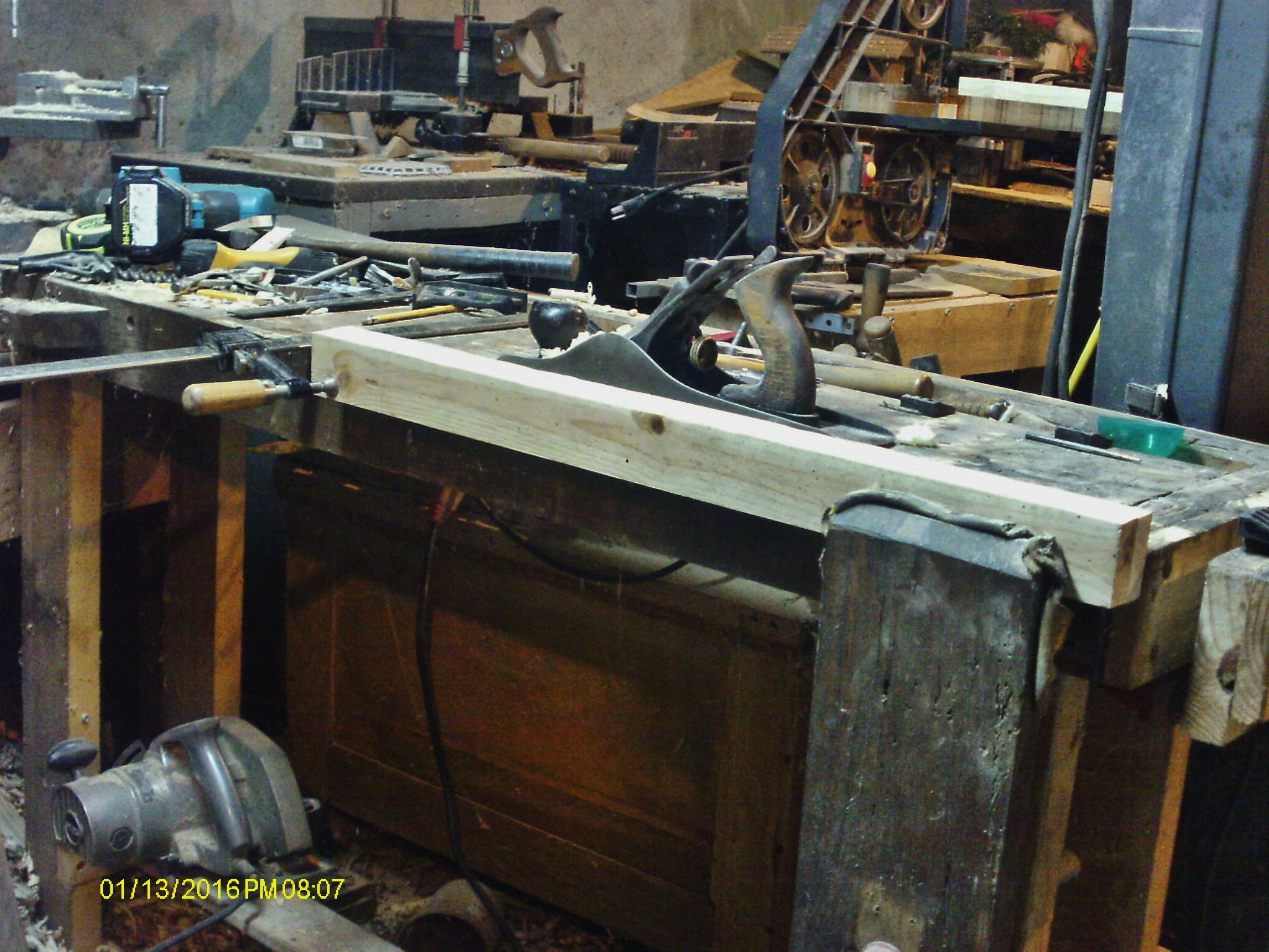

Well, I did get the top all nice and spiffy
56970ececc8cf_cleaneduptop.thumb.JPG.c87
I had forgotened how knotty this thing was....Anyway, time to work on these things..

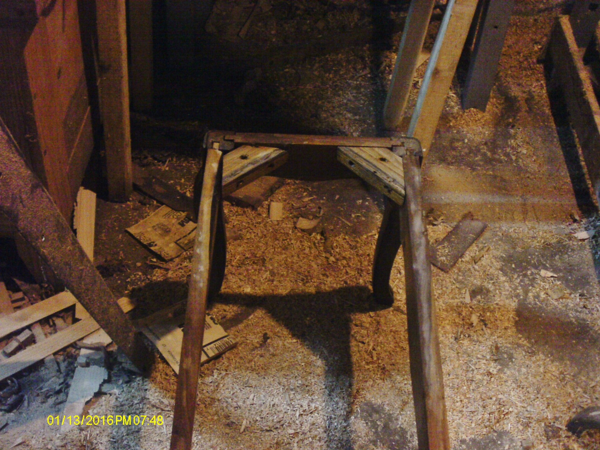

56970f2cb8c0a_oldbrackets.thumb.JPG.f7e6
These brackets will be trashed out.   marked a couple lines, bandsaw to cut a 1x6 down into three strips.   Jointed the two wider ones..

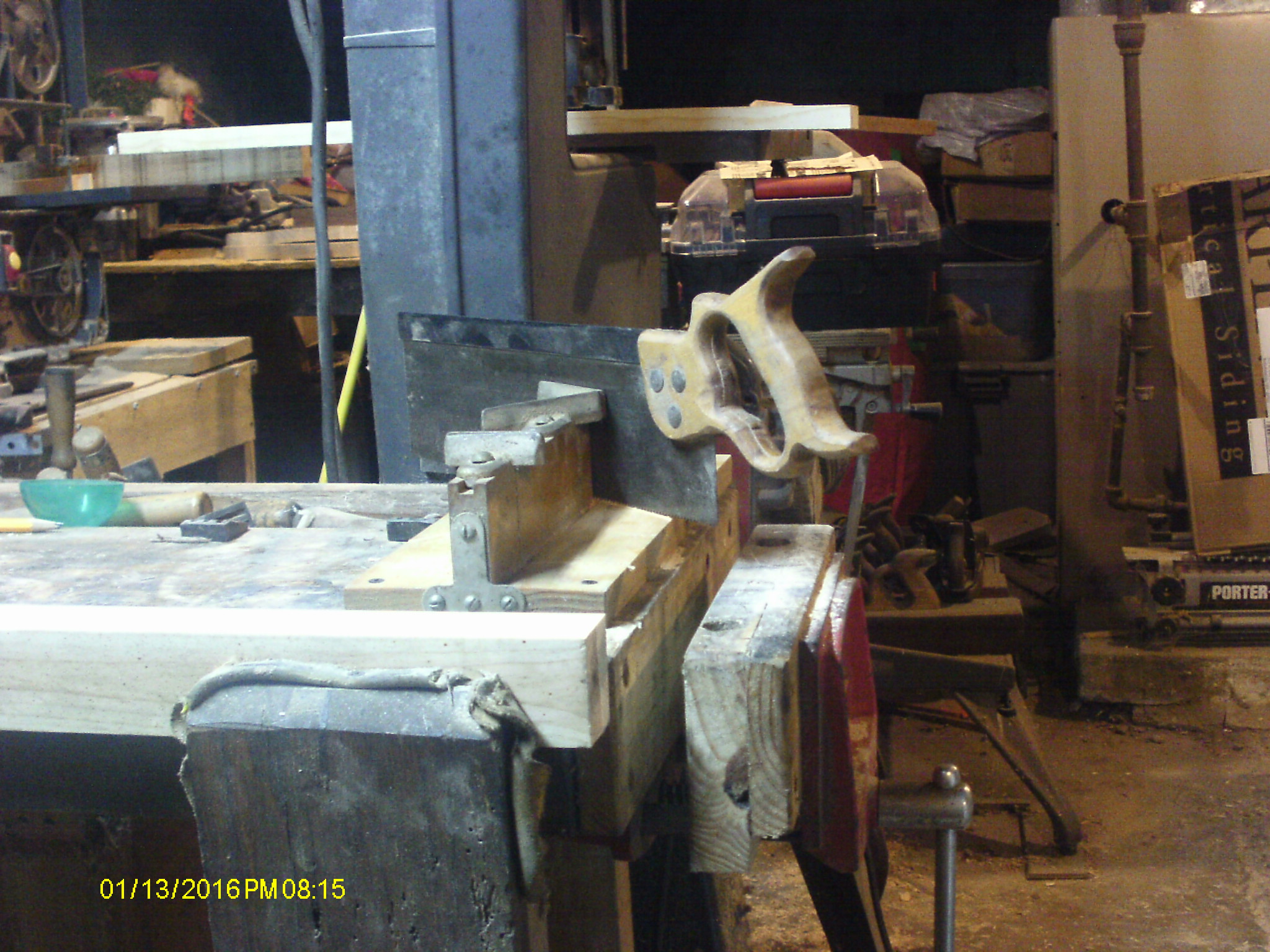

Went upstairs, and got a couple toys.   One was a "Hammerhead"  Cordless drill/driver, the other?

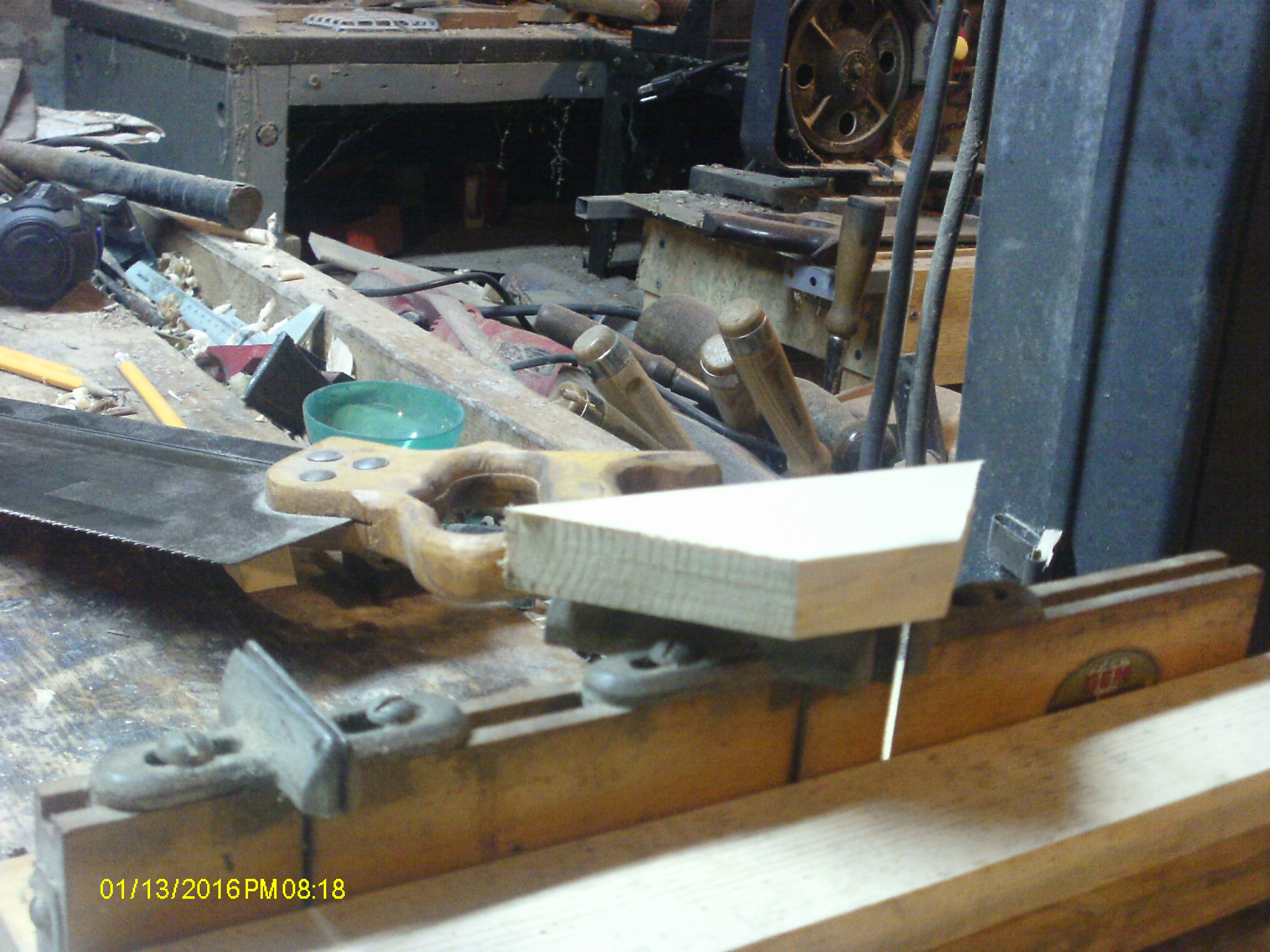

569710021e360_GEMMitrebox.thumb.JPG.54ac
Called a GEM Mitrebox.   The saw worked,..
bracket.thumb.JPG.cca972fded5bbd72e8c657

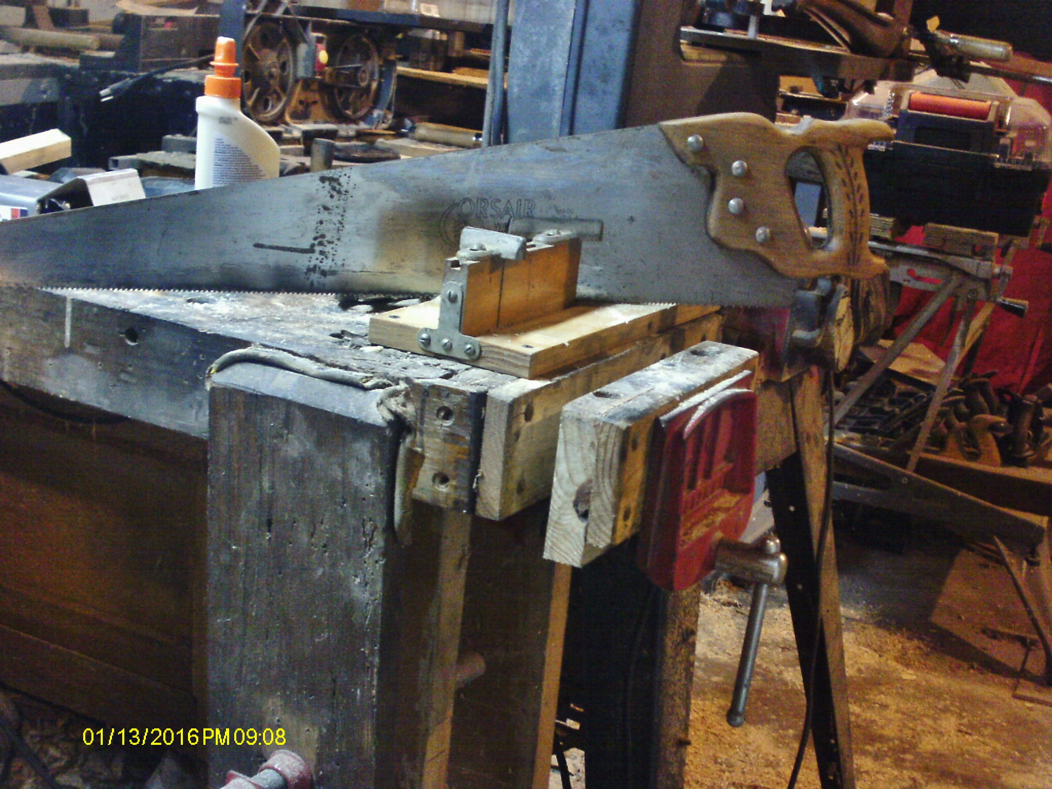

But was a bit too slow,  changed out to a longer saw...
5697108dc5e9c_Corsairsaw.thumb.JPG.968cb

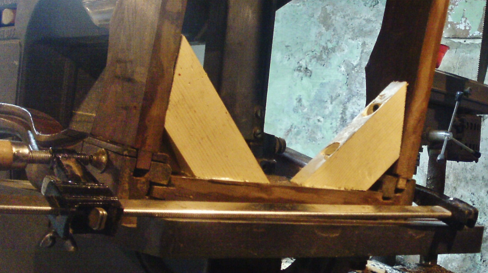

8 ppi crosscut, 26" long.  Flat brackets weren't the problem, it was when I sat the board on edge.   It take forever with the little saw.  Drill press for a few holes, hammerhead to drive a few screws
569711342d7aa_bracketsinstall.thumb.JPG.

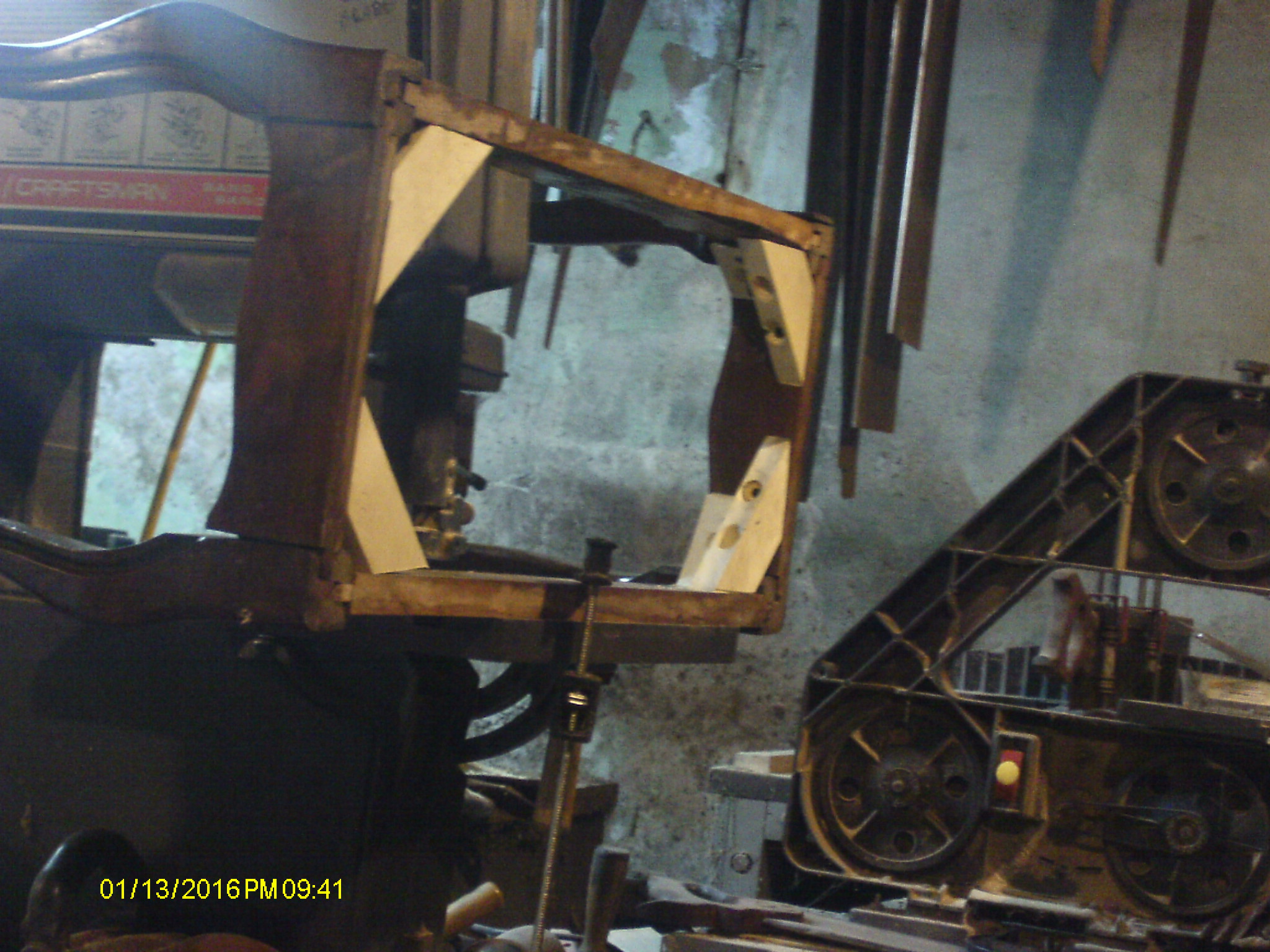

This thing was well beat up....Under neath these are to be the boards cut on edge.   They get a screw through and into the leg itself.
569711b74dad4_fourbrackets.thumb.JPG.de4
I think you can see a couple hiding there.  had to shorten a few screws.   Didn't have short enough ones for either type of bracket.  Longer ones were for the leg bracket....couple were too long.  Grinder to shorten the long screws.  Glue is now cureing up at the joints.   Will cut slots to attach the top with, maybe tomorrow?    Hoping I have the correct length screws....

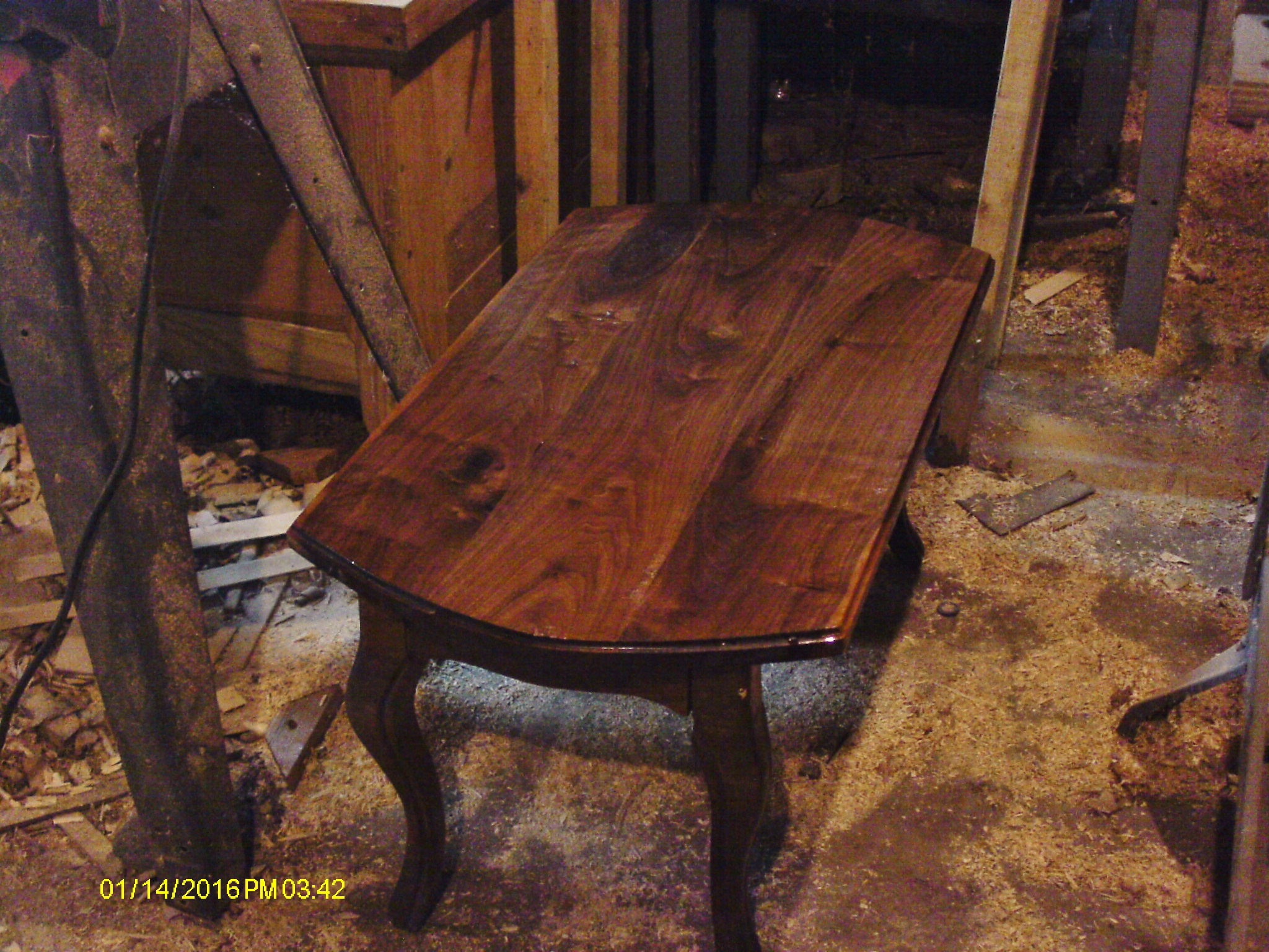

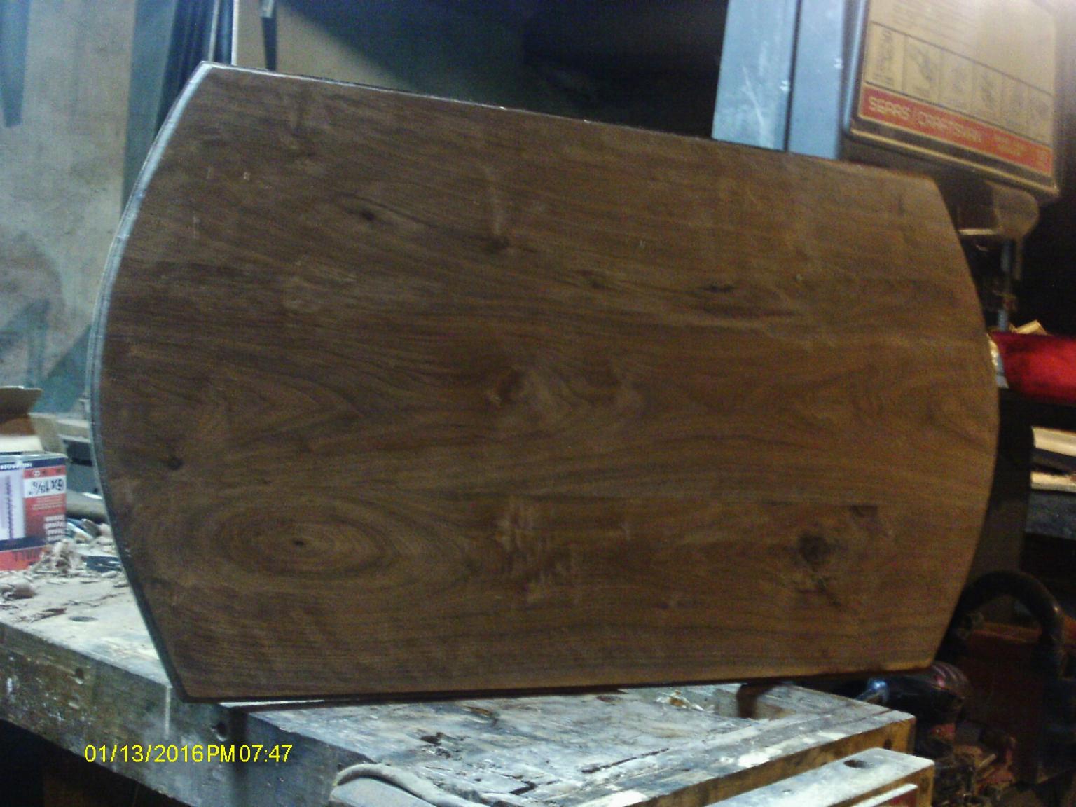

Well, got the top installed onto the base....had to plane the underside of the top, though.   It got a wipe down of that SMELLY BLO.   Then added the base to the top, using four screws, one into each bracket.  Then gave the top a wipe on coat..
56981be37be68_rehabbedtop.thumb.JPG.141a
It will need a second coat, later....look any better?
