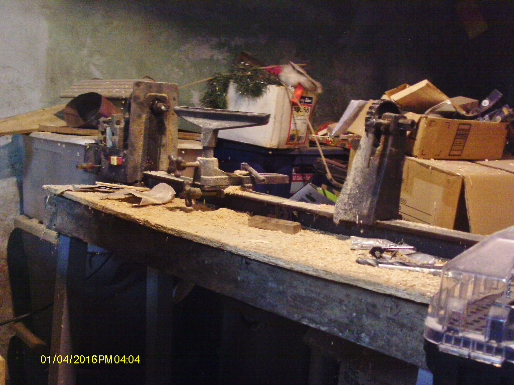

Got all four legs turned today!   Including one that went back onto the lathe....It was a bit too fat.   Someday, I'll find a set of calipers....
Anyway..
568af7685cbe2_messylathe.thumb.JPG.deb8d

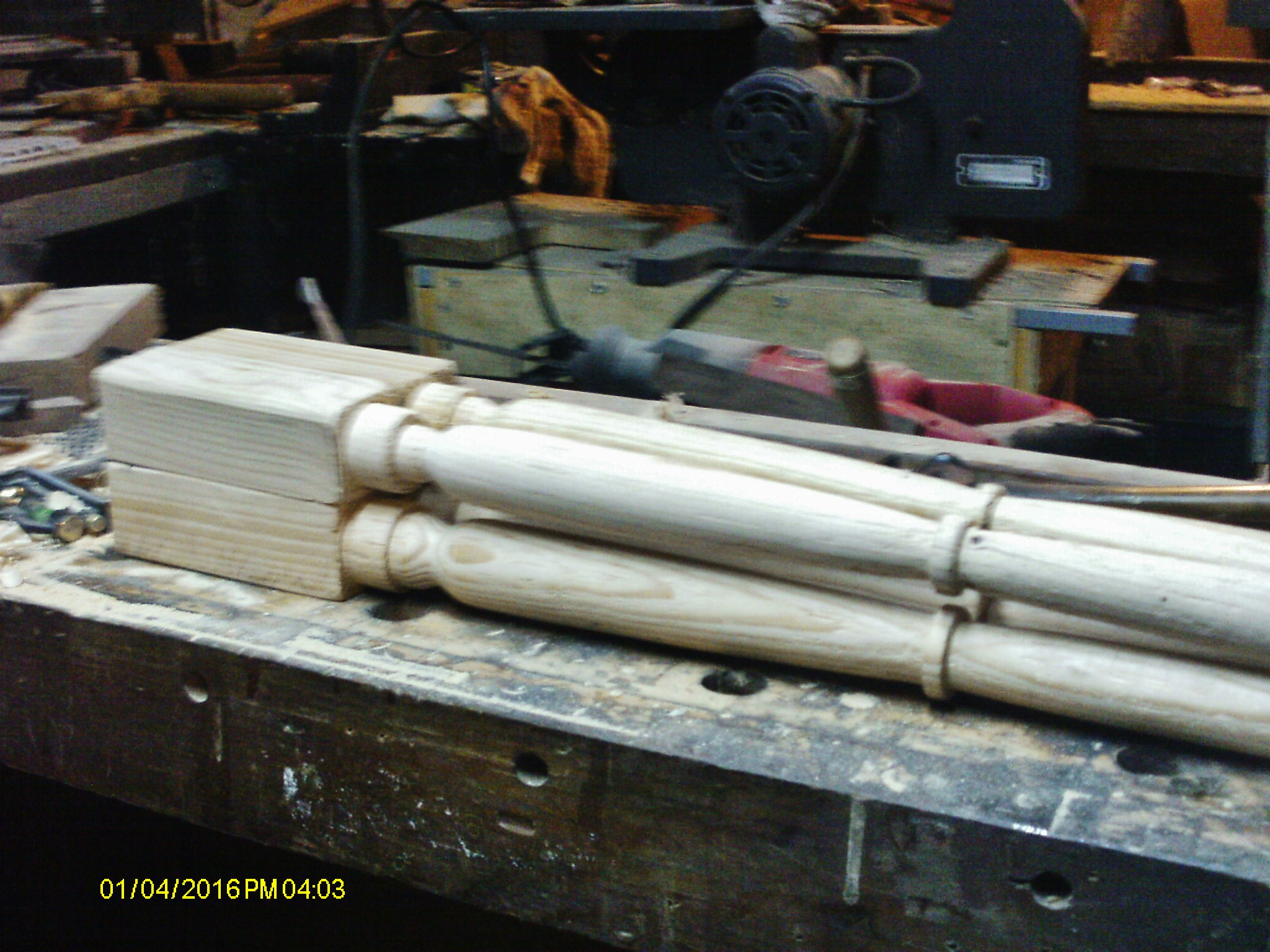

Made a royal mess today....but had four legs finally done..
568af7c125ce2_stackedlegs.thumb.JPG.d686

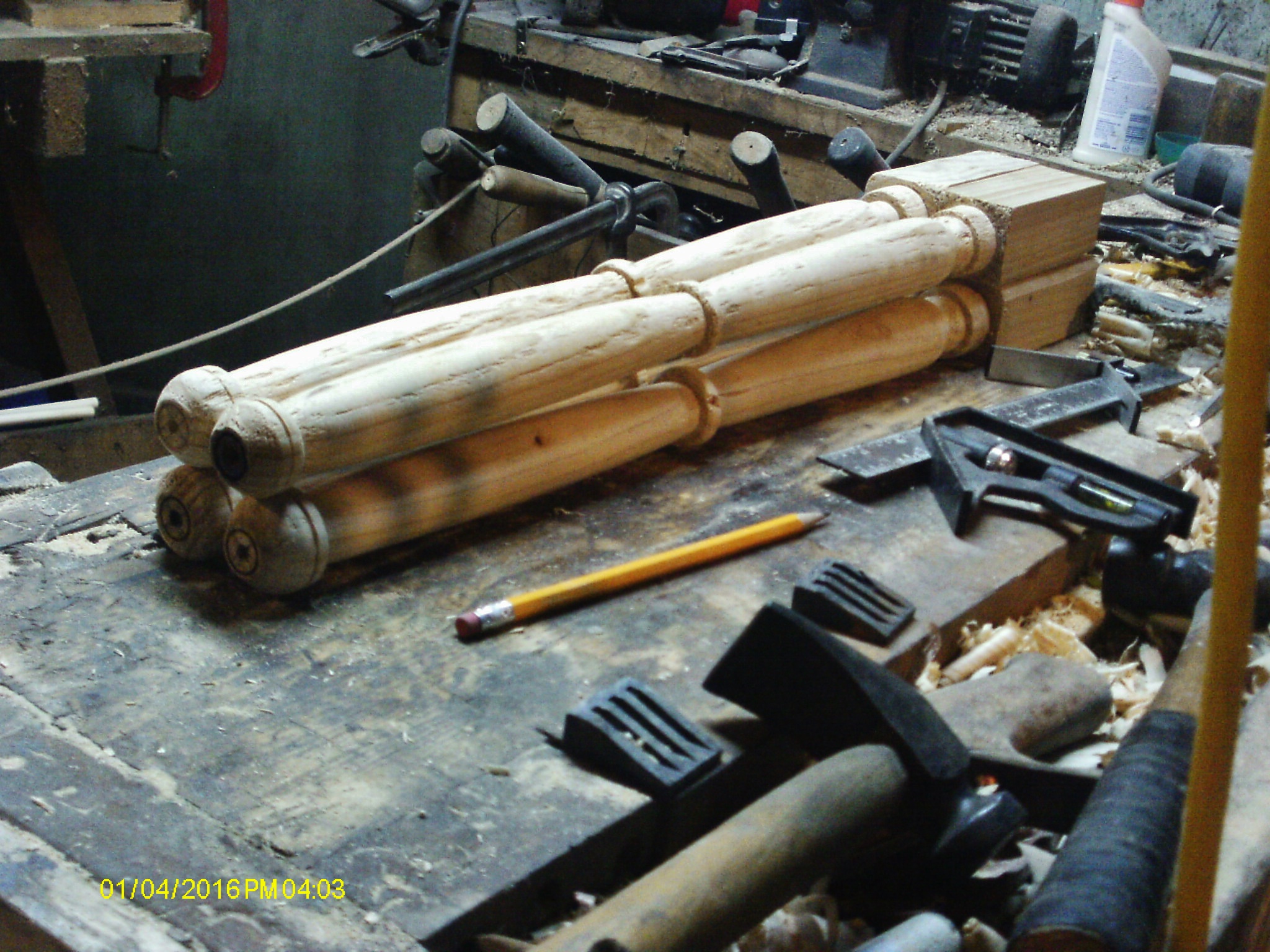

That pencil was sharpened for the first time today.  Pine just isn't the besy turning stock.   Black lines are shadows from power cords.   Maybe a better look?
568af8605896b_legstack.thumb.JPG.66fce61
Knots were fun to work around, too....May start up on aprons later, back allowing...
