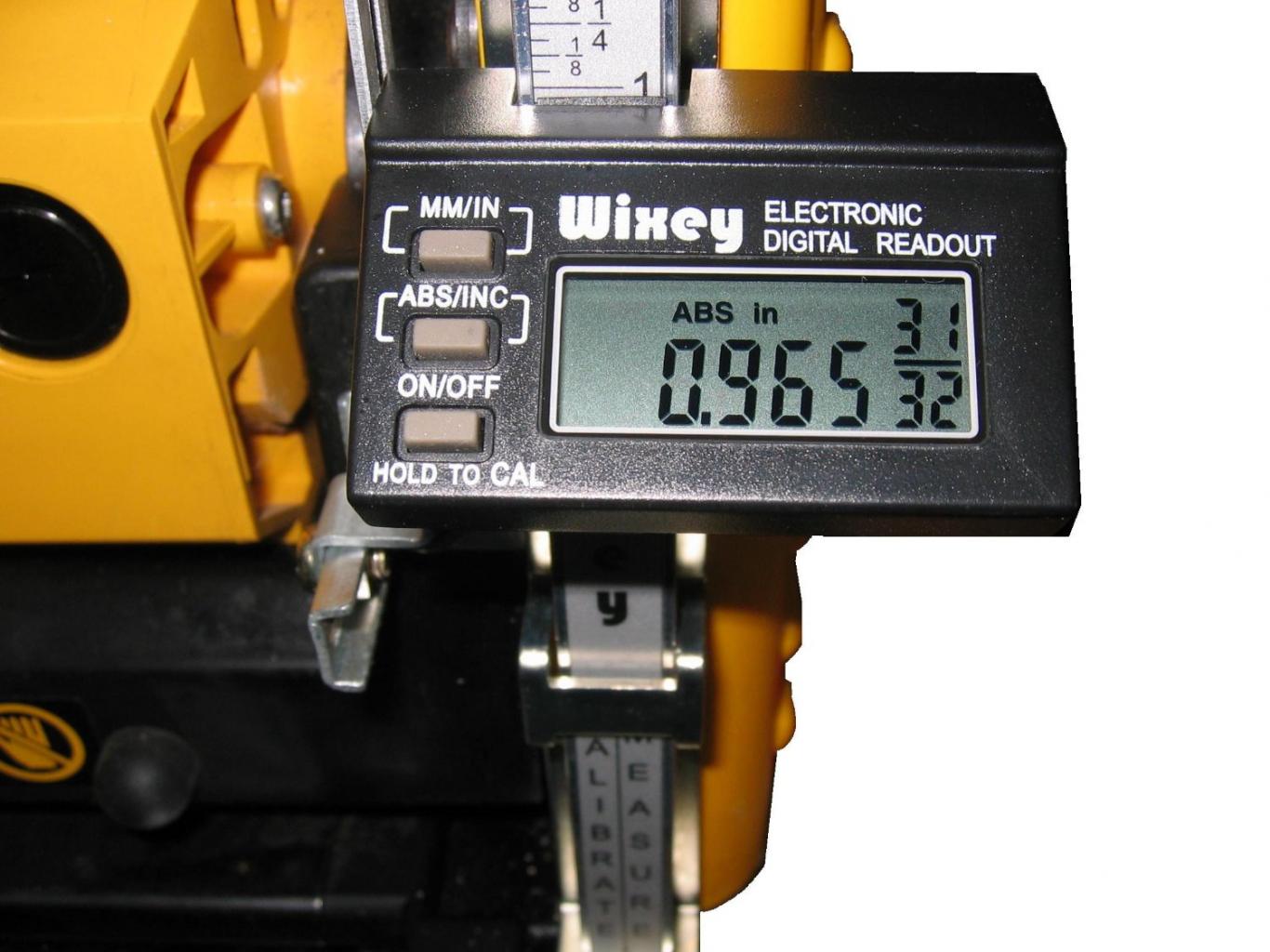

I agree, with Gene, about the depth of cut. My rule is 1/2 turn of the handle and no more. I forgot to mention that I added the Wixey depth gauge -
567448e2be500_81Er9w7EeL._SL1500_.thumb.
http://wixey.com/planer/index.html
A very worthwhile addition. Now they use AAA batteries which last even longer.
Lew - love that depth guage - sure takes the guesswork out
Mine has the Wixey gauge, also and it is handy. But I still keep a set of open end wrenches handy to use as thickness gauges.
