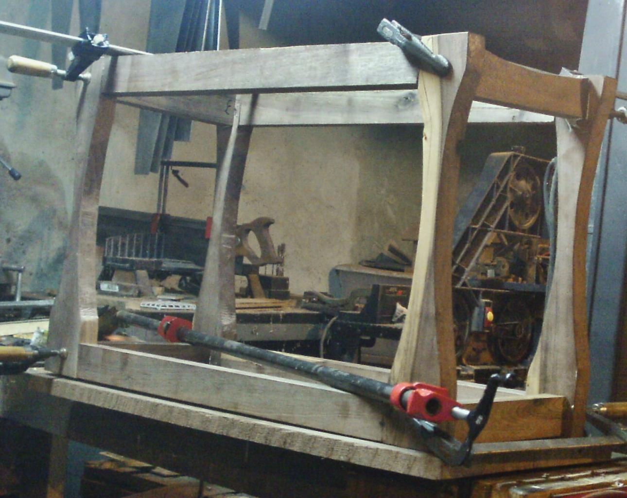

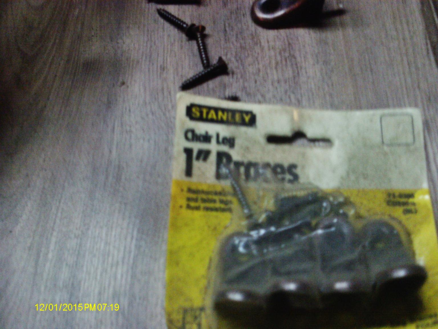

December 2, 201510 yr comment_63712 Well, back is hurting today, got it to relax for awhile, wandered SLOWLY down the steps to the Dungeon Shop. Laid out a few clamps.. And a few other things I might need. Spread some glue around, and worked my way back towards the end of the bench.....A check of the diagonals....hmmm need one more clamp Used this pipe clamp to "pull" things back into square...30-1/2" each way on the diagonals. What we have here is the base sitting on the table's top. Gap down at the far corner will get pulled flat later. Needed a way to add a corner bracket, and not have it stick out like a sore back...er...THUMB. Remembered a bag I picked at a yard sale....had three sets of these in it for fifty cents... Yep, it do say Stanley on the package...and on the parts themselves. Set out a few.. I think these will even match the Walnut? attached this set down at the foot of each leg....later, I can flip the base over and add the next batch. That was about it for shop time tonight, i set the shelf on top of the mess, and wanded back upstairs...to a nice warm heating pad for my back....I did work out a wat to add the bottom shelf..without a lot of hassle. That will be next time, on this Batty Channel... You can also see a couple of the brackets in place..well, one anyway. Maybe by Sunday I MIGHT be ready for a finish...of some sort... Report
