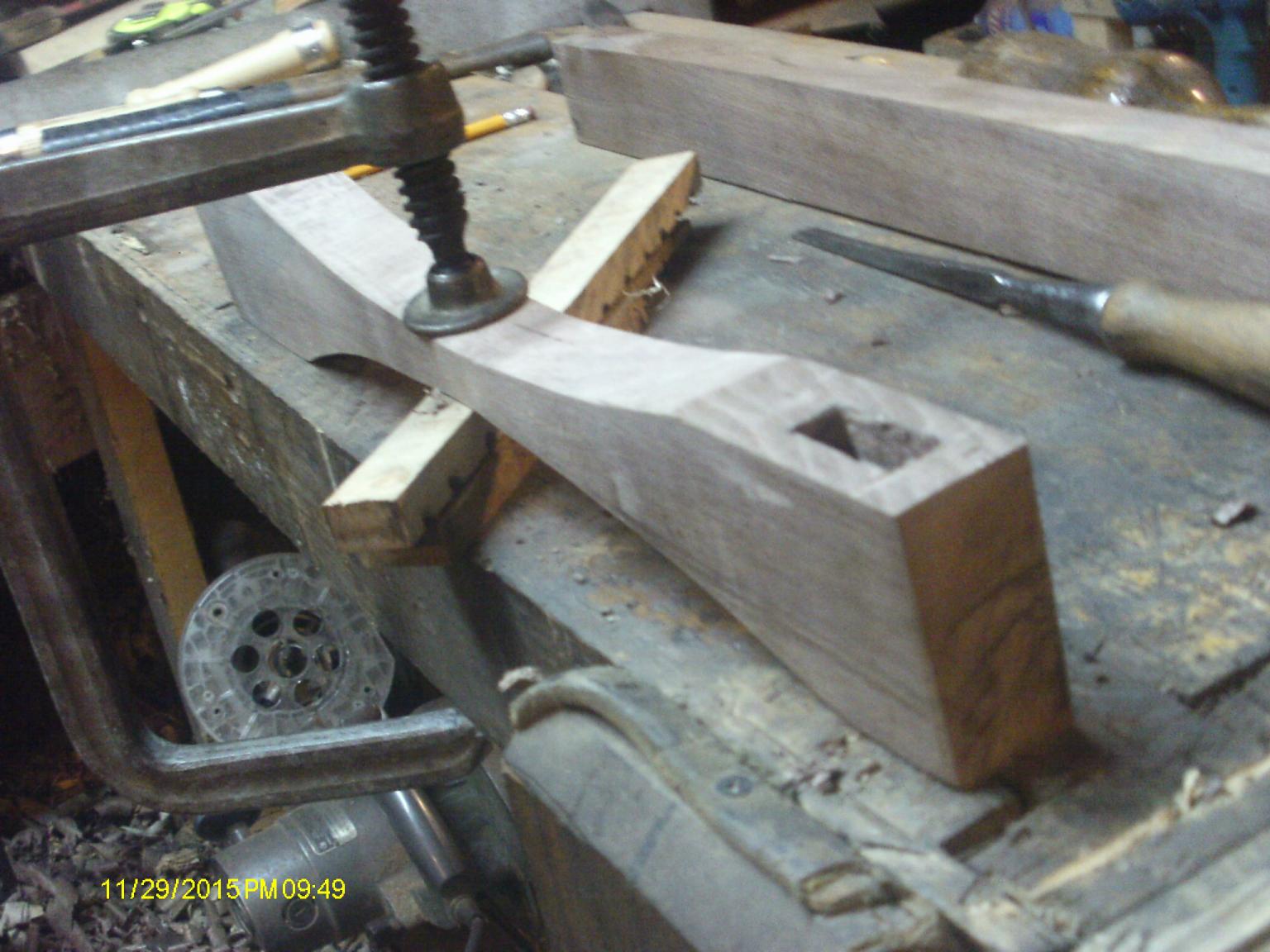

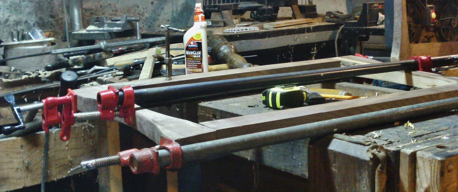

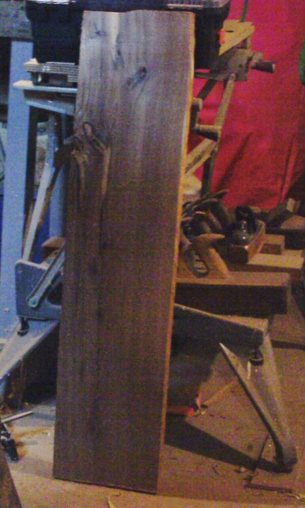

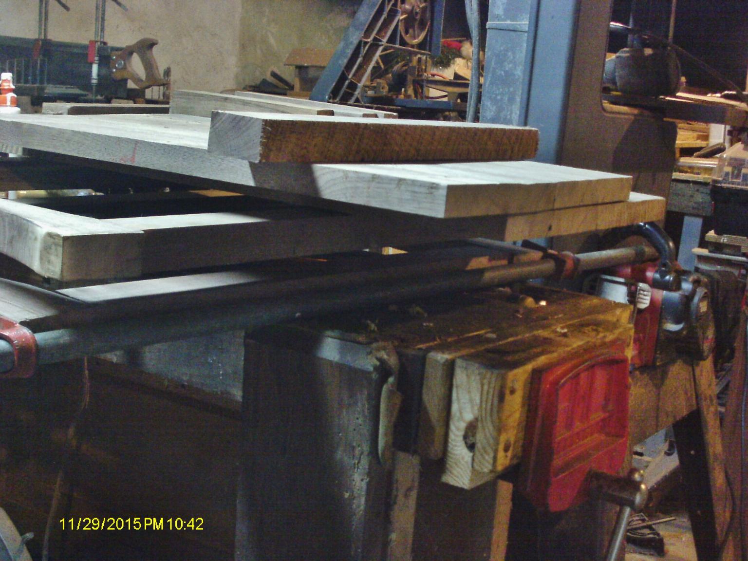

November 30, 201511 yr comment_63666 I tried to at least get the last two legs done today......road trip to take the GrandBRATS home kind of cut into shop time. I did manage to cut a few mortises in the last two legs, about half of them, anyway. This time, I kept the mating rails cloce by, and marked where each went. Also found out the the white sap wood is VERY spongy. One mortise could have been dug out with a fingernail....it also liked to split. Tried a test fit,.... It is the leg on the bottom with the sappy wood. Got out the pipe clamps, again. needed a hammer as well. Pipe clamps wanted to twist back off. Used a c clamp to keep one in place, and a lot of cussing. Finally got three pipe clamps in place. Added a few nails, trying for at least ONE through the tenon. One or two went through the sap wood and into GOOD stuff. A check of the diagonals...off by a 1/16"???? I suppose I could let that slide.....Football was on, decided to call it a night. Stacked most of the parts back on top... That rough looking 1 x3 on top? It will be one of the Breadboard edges, Need to rip a few more out of this old plank.. Might be enough left for that? I'm using that Workmate back there as a till for the wood bodied planes. Still have four more mortises to chop, and then the two halves can have a get together with Elmer? Stay tuned to this batty channel... Report
