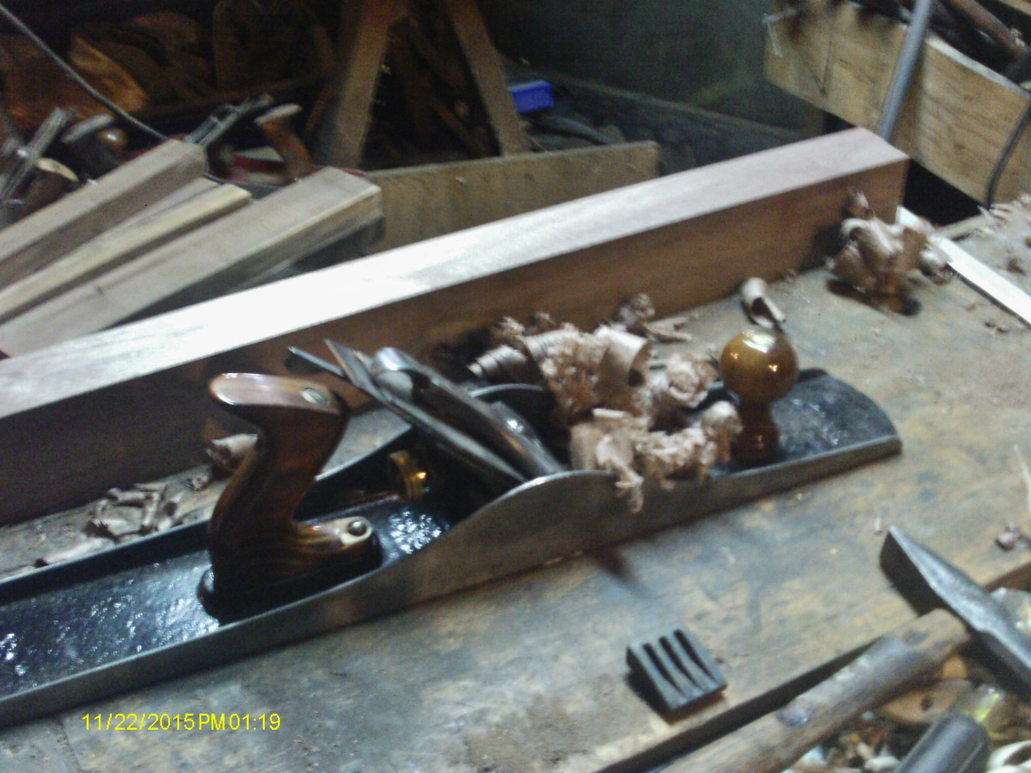

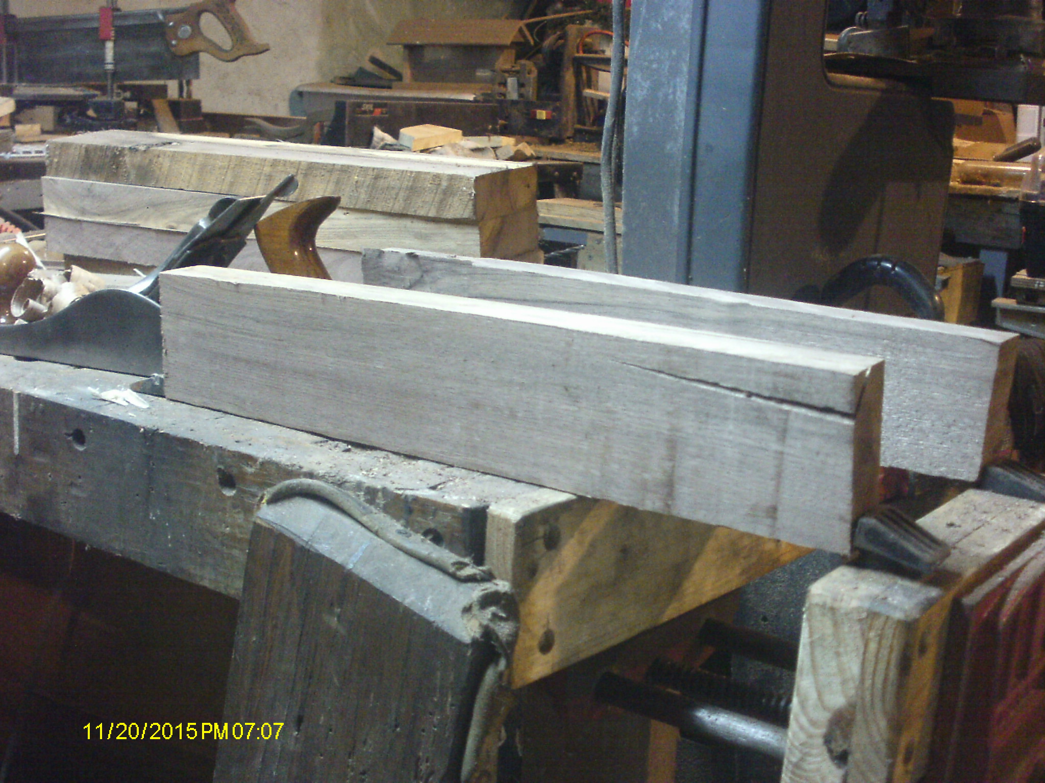

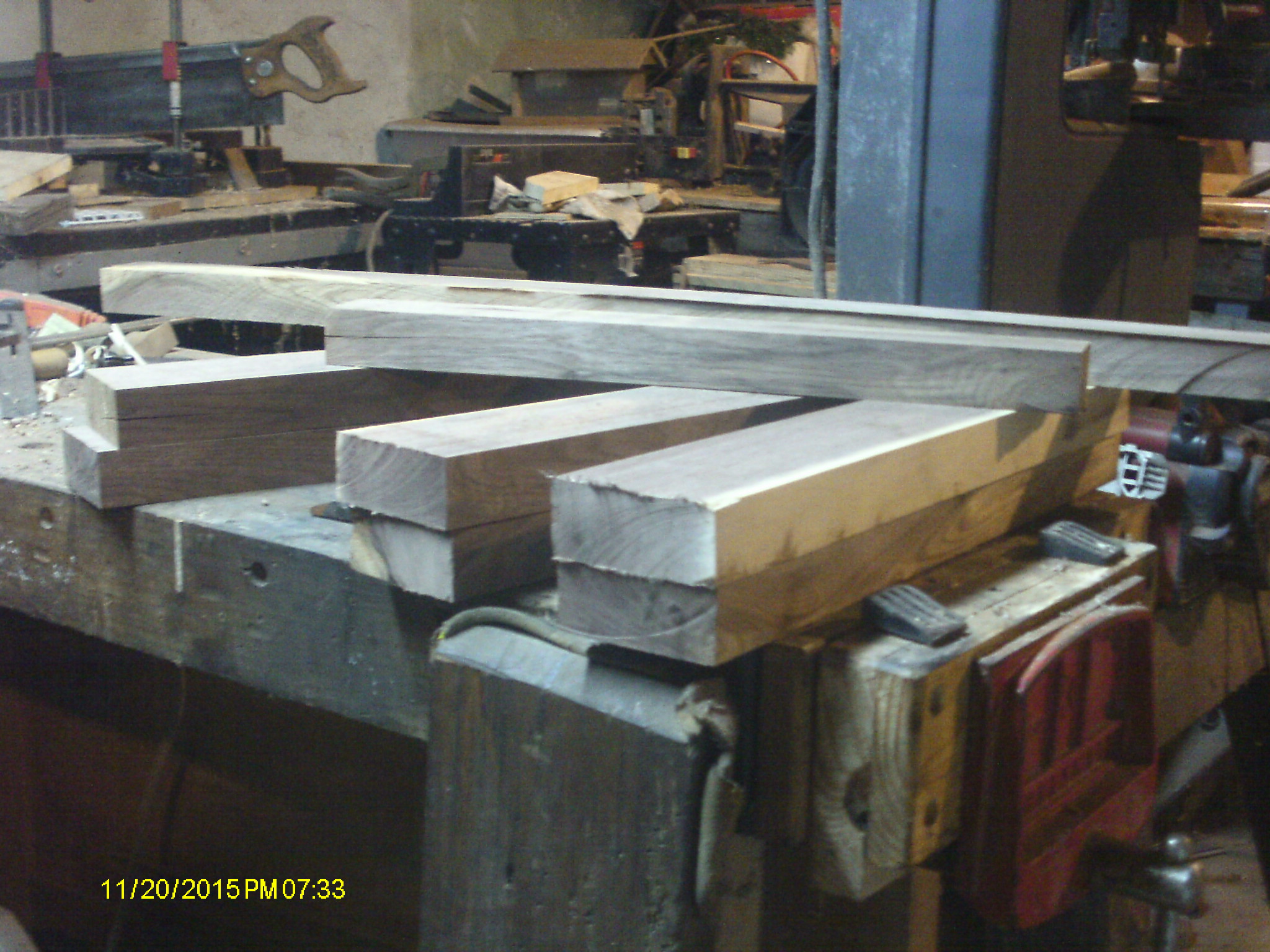

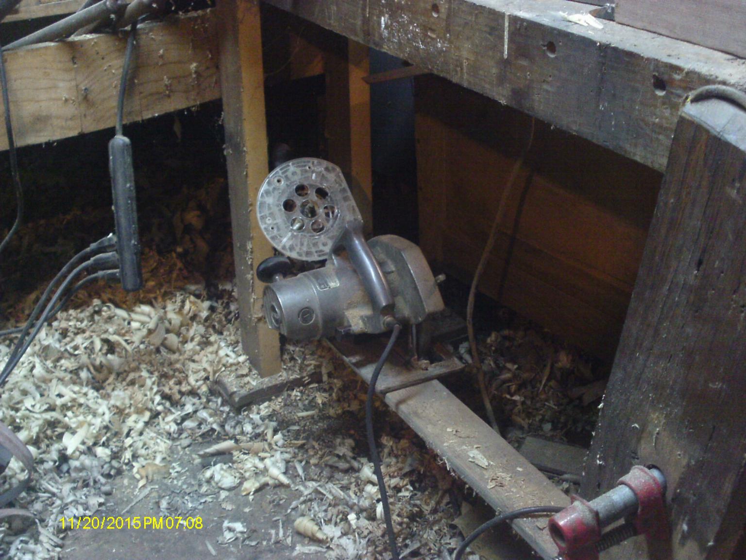

November 21, 201510 yr comment_63459 taking a break from the Burnt Room Rehab......have a few planks of walnut to mill down. Hauled the circular saws in from the trunk of the van, and took the 7-1/4 one down to the shop. Sitting down there out of the way with a router. Ripped a few pieces out of one plank. It will do for starters. Got this brown sawdust everywhere, even my hair! Yeah. Anyway, the plank is 5/4 thick. Needed a few pieces 3" wide, by 18" long. Had enough left over for a 2" wide filler strip, and 2 pieces @ 3" x 17" long. Plus a short filler strip. To get rid of the saw marks, and straighten a couple edges, a Jointer Plane was dragged over to the bench..and locked a couple into the dogs and the vise.. That Stanley No.7c got heavy after a while... I had to switch to a lighter No.5-1/2 to finish things up, shoulders were hurting. Stacked the pieces up, for now.. 8 pieces, all but one have been jointed to remove the saw marks. Four will be corner posts for a small Hope Chest. The skinnier two will be ends for a frame&panel. The long and short 2x2? we'll see where they will go, later. Need to move these off the bench, have another 5/4 thick plank to mill. Then two 4/4 x 8" x 5'4" ones to work over. This will take awhile....at least it will keep me out of the local taverns..stay tuned Report

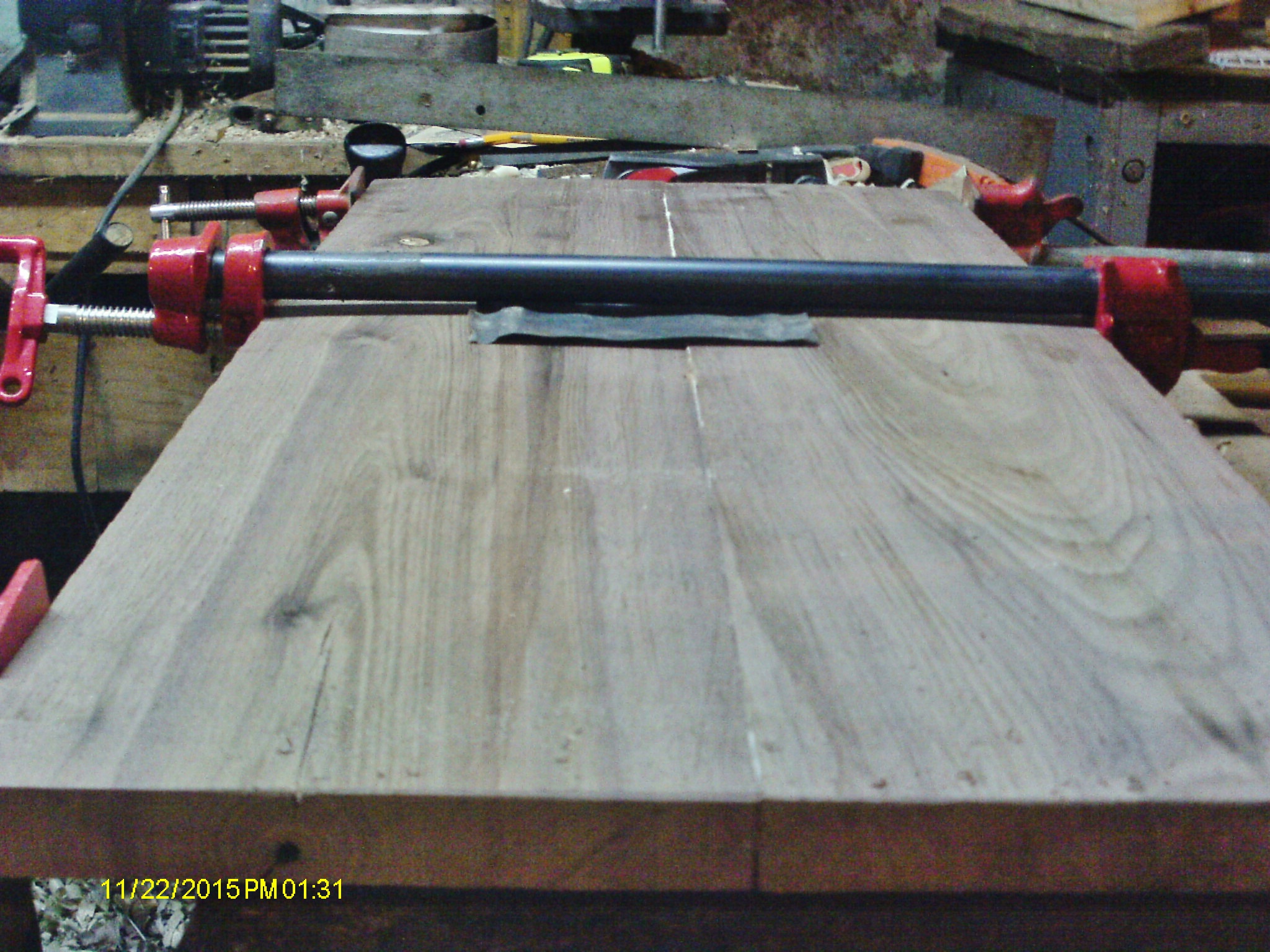

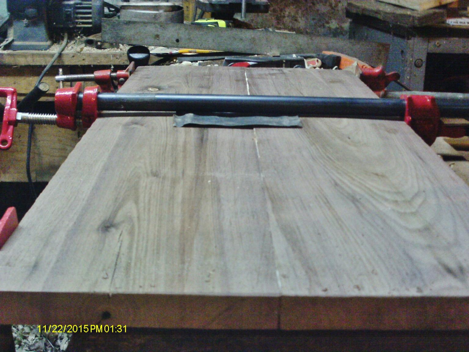

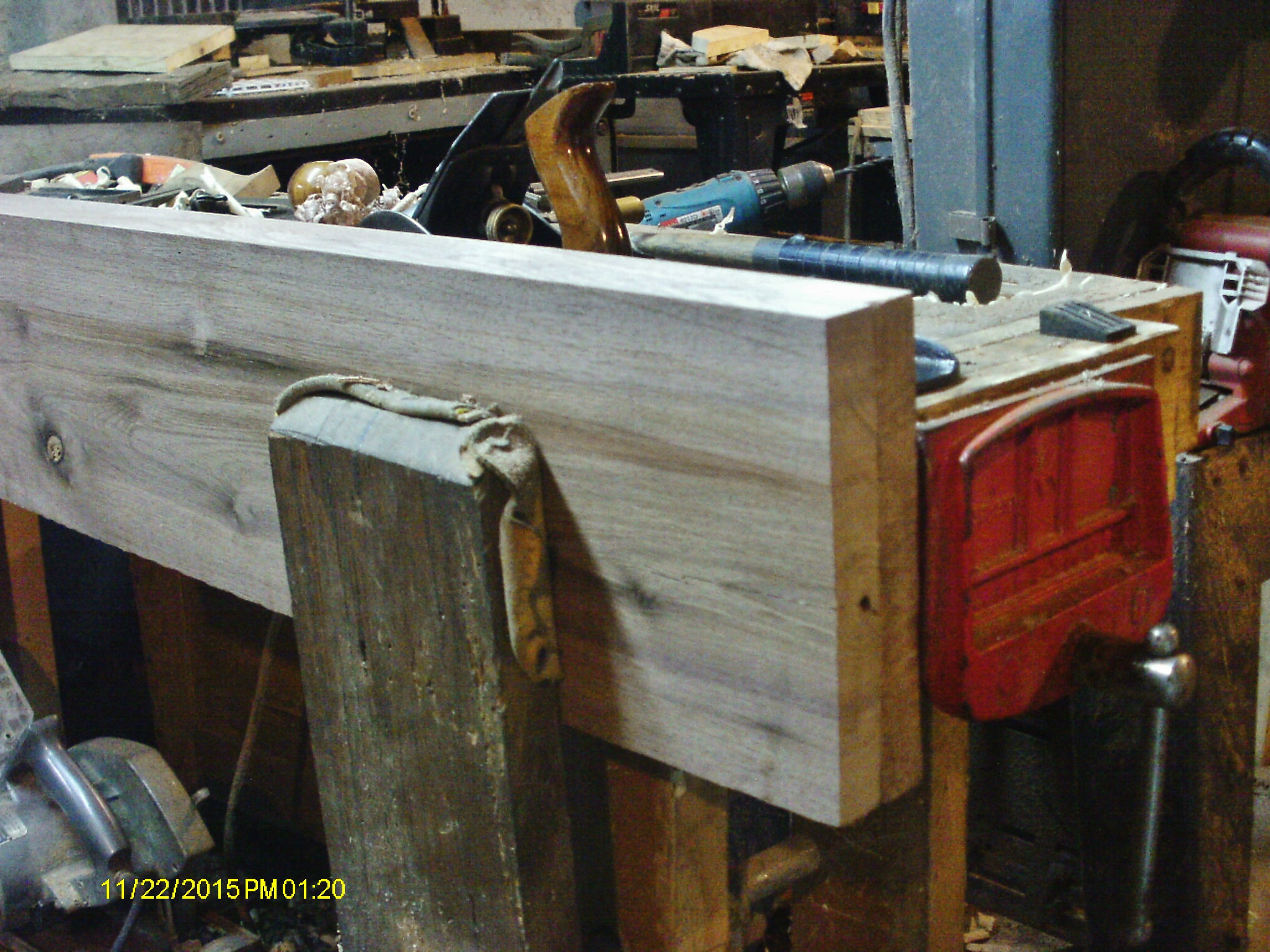

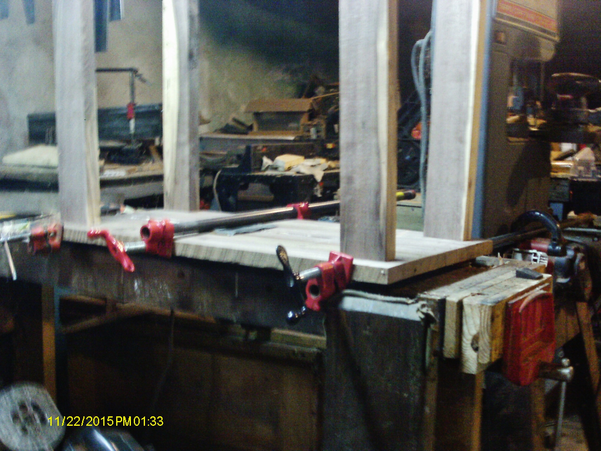

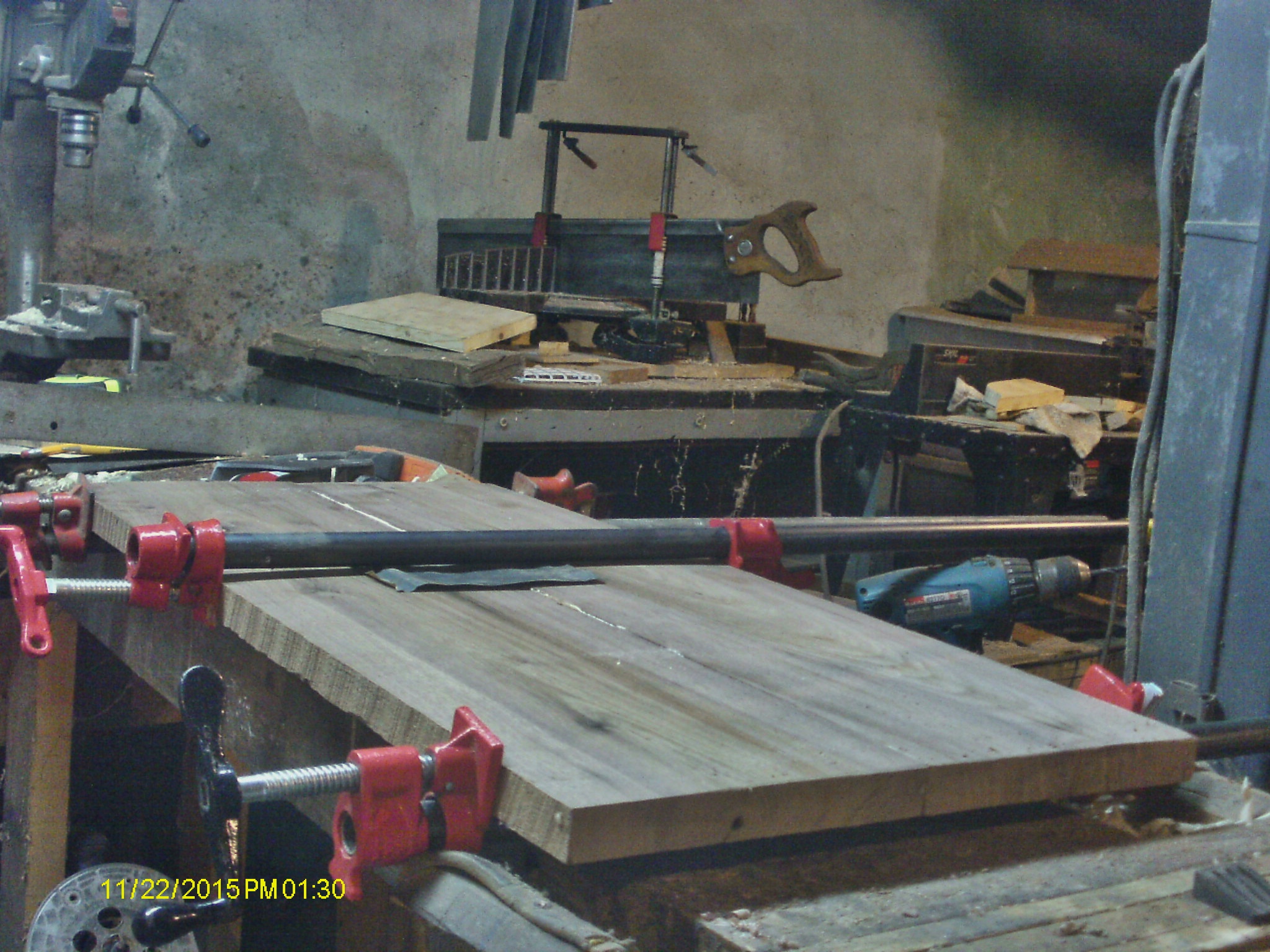

November 23, 201510 yr Author comment_63467 Little bit of work today...slapped more mud on some walls, cut another plank down to a size I can work with. Clamped the two pieces into the leg vise, and worked on a glue ready edge.. Peeking out from behind the stacked boards, is a Jointer plane.. With a few Walnut shavings. Note the shiny edges? Now I can do a glue up.. One over, two under. The sandpaper is ther to prevent any "black marks" from the pipe. Tried to match the grain a bit Not sure yet IF this will be a table top, or the lid for a chest.....lumber supply is a bit skimpy. Laid out some corner posts/legs.. to see what I have to work with. I have two more planks of Walnut to trim to sizes, as soon as I figure out what sizes I need. Single Brain Cell Sketch Up is a bit tricky doing cut lists..... Also have a few planks of Pine.....bottom of the chest? And a thick (8/4!!) plank of oak. Trying to save that one for some handles on the lathe. Will know more as things get done...stay tuned. Report
