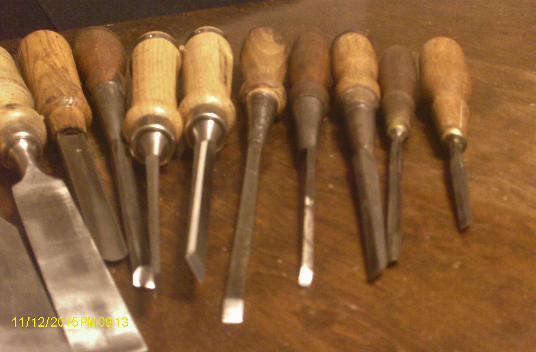

November 11, 201511 yr comment_63265 While trying to take things easy,...yeah..riiight. Figured I could set up a place the right height to sharpen a few chisels up. Got a 1/4" scrap of plywood to set the oil stones on. Dug out the veritas MkI honing guide. Found a bottle of 3in1 air tool oil. A couple chisels needed a trip to the grinder, first. Most were at 25 degrees, but one was @ 30 degrees. Set the oil stones on the plywood, gave them a shot of oil. and went to town on it with a chisel. Even polished the backs flat. After the stones, then a few trips down some 2K paper. Set the group out of the way when done.. That long, skinny one is the 30 degree Firmer chisel. i was going to do the gouge...but, had other things to do... Tonight, got the last of the chisel work done, I hope. So, now I have another "batch to bring upstairs to refresh the edges Bevel chisels and a bunch of mortise chisels, even a few by Butcher. As soon as I figure the angles out for the mortise chisels, I can get busy on them.. Until then, I just kick back and rest the back....maybe. Report

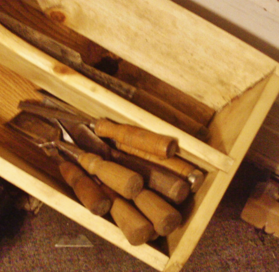

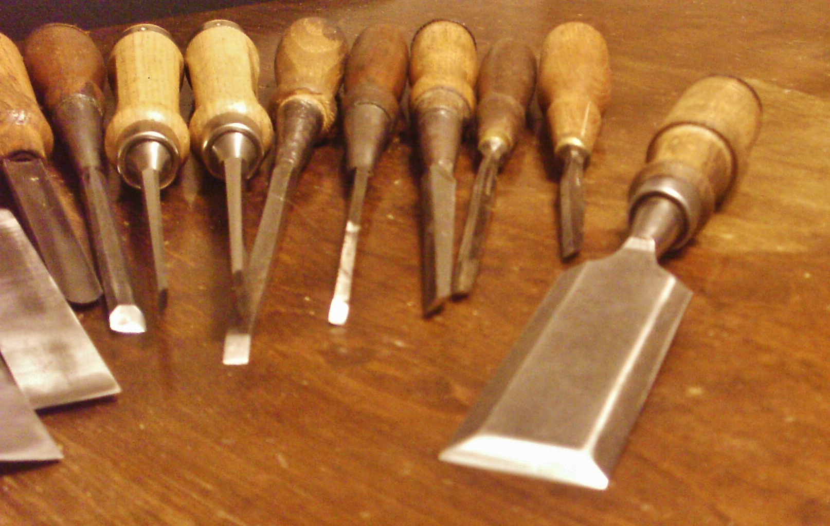

November 13, 201511 yr Author comment_63310 Well, got all of those done, yesterday. Mainly while waiting on BLO to dry. Two are those "Aldis" chisels Sellers loves. the rest are mortise chisels, 1/8" on up. Today, I spent almost as long on ONE chisel.. 1.5" wide. Still trying to read the marking on it. Most of the black ink is missing. They stamped a logo up on the handle, of course, where it could just wear away. have a another "batch" to work over....maybe while I'm waiting on Football games to start? That BIG VanCamp framer chisel may have to just wait it's turn. Then 95% of the wood handled chisels MIGHT be done? May need more sandpaper.... I did find out that a bottle from3in1 made for air powered tools, works very nicely on oil stones. Seems to work better than "regular" 3in1 oil. Report
