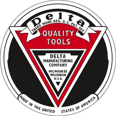

Larry Buskirk Posted September 15, 2015 Report Posted September 15, 2015 (edited) The following images can help in determining the age of your Delta machines by the badge it wears, providing the part with the badge is original to the machine. Delta also exported their machines under the Tauco name, I've seen photos of the 1936 through 1941 style badges with the Tauco name in place of the Delta name. I'll post those photos if I can find them. 1936 1937 1938 1939-1941 1941-1952 1953-1966 1966-1973 Edited August 25, 2023 by Larry Buskirk Cal 1 Quote

Larry Buskirk Posted April 7, 2020 Author Report Posted April 7, 2020 (edited) On 4/5/2020 at 1:41 PM, dgraham1995 said: Hope the Delta badge history is accurate, if so and it appears to be, thank you very much David David, I have since found that the 3 stripe 1939-41 badge was first used on the Catalog No. 768 Delta 10" band saw that was introduced in 1937. So far that is the only machine I've discovered that differs from the above time line. Edited April 7, 2020 by Larry Buskirk Gunny 1 Quote

David Walsh Posted October 7, 2024 Report Posted October 7, 2024 Thought I'd share a set of "Delta badge timeline" designs I put together recently (for purposes of printing them as posters) — ... and here's one of the rustic Quality Tools designs, because why not? Larry Buskirk and Grandpadave52 1 1 Quote
