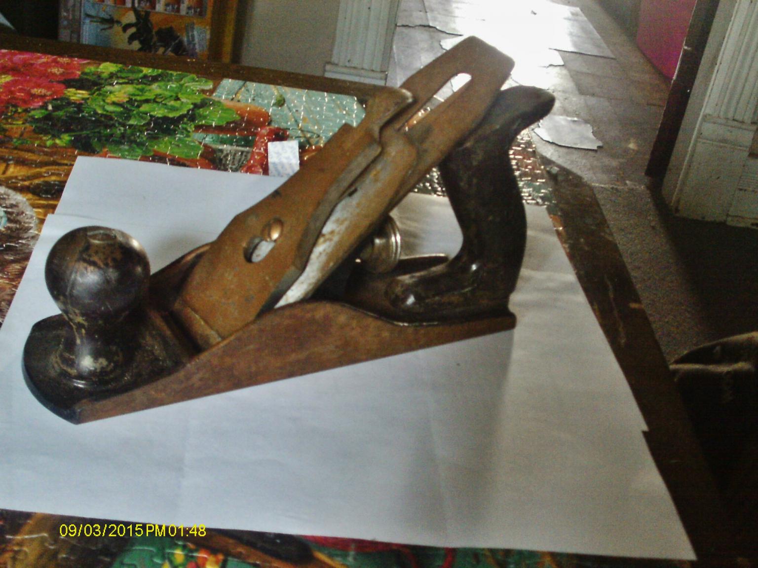

September 4, 201511 yr comment_62295 All the way from Maryland, mind you. Not counting S&H, it was just under a 10spot..Not only was there a bit of rust....someone had given it a Coppertone Finish.. Hmmm...yeah. Them handles were a plastic of some sort. Kind of purple on the inside. Lever cap is a coppertone paint. Sole looked just as...messy Lovely? Welll, now. I suppose I could wander down and see if the rehab center is open today..... Ok: Flattened the sole. iron needed it's back flattened as well. Tuned the chipbreaker. Those handles? Traded them out for some wood ones. The Yorkie Dunlap now has the plastic handles. Iron was reground to 25degrees or so...then hand sharpened through 2.5K grit. After that is, I had straightened the edge. Had the infamous reverse camber. The corners stuck out more than the center. I removed what coppertone paint that I could. What should have been black is now black. lever cap polished up. Bolts cleaned up. face of the frog was sanded flatter. Underside of lever cap WAS a rough casting...not anymore. gave this THING a test run on some wide pine... Not too bad. Note the "new" handles? Frog did have a frog adjust bolt. Wheel is plated steel. A few more looks.. Front porch looking better? Not too bad looking? It did make a nice wispy pile of wide shavings, too... Seems to be a Stanley type 20 No.4 smooth plane. Might be right before the Maroon painted ones showed up. Still has the Stanley lateral lever. Might be a keeper? Report

September 4, 201511 yr comment_62300 You are certainly the fastest at the 12 step rehab I have ever seen with a plane. Man that went from junk to hunk quick. Love to see those curly thin strips. Great rehab Master Steve! Report
