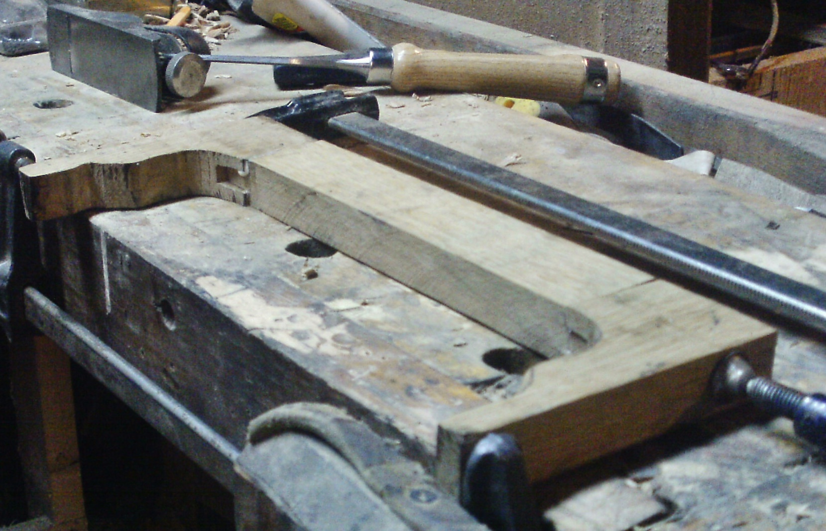

Well, took the narrow end out of the clamps yesterday.....not good.  Upper and lower joints started to pull apart!   Reclamped those two, inside of the panel facing up. Flat on the bench.   Grabbed a handful of 5/8" brads.  Drove three into each, well all but one, joint.   Right through the tongue.   The un-pinned joint?    had to plane the filler strip flush, then I could pin that one too.
Let it set for most of the day....
Took it out again, flipped it over, and worked the outside joints flush, including the filler strip.   Handplanes and a sander.  Laid the narrow end on something out of my way..
narrow_panel.thumb.JPG.cbee8566bf82d3593
Pretty, ain't?  Still a bit of a gap near the top.

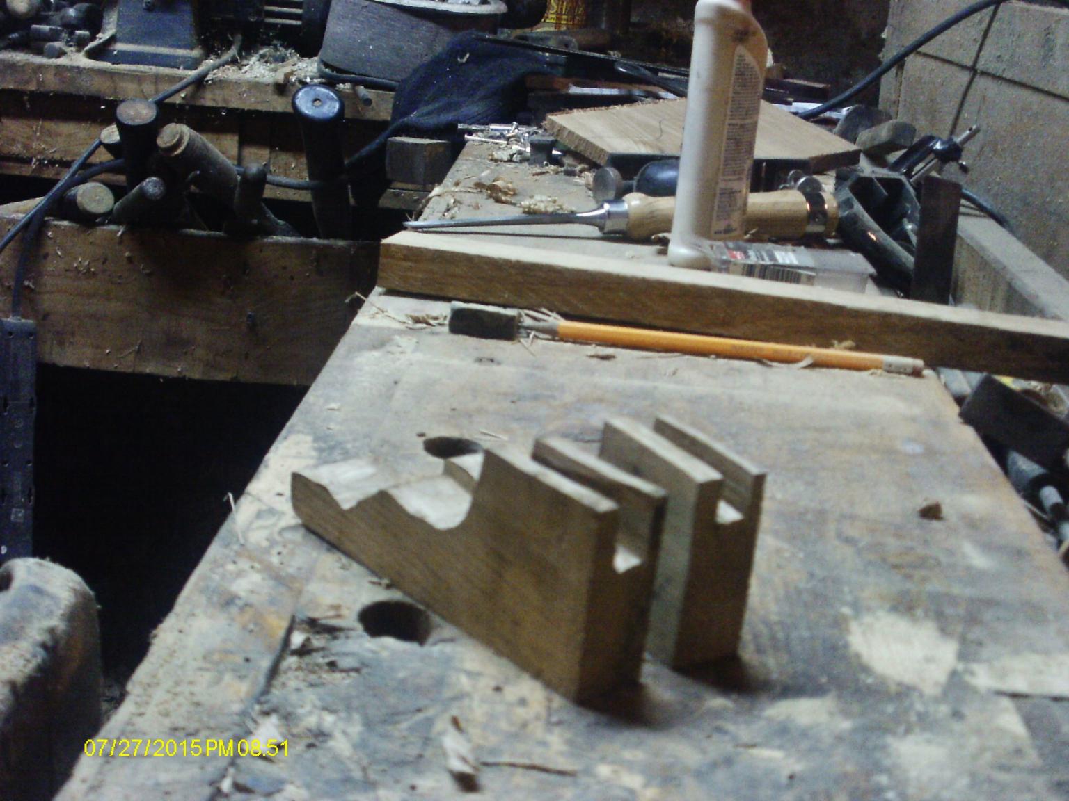

Needed to take a few measurements, and trace a pattern or two.   "Plan" says I need a "False" front.    To make the door "look" like the rest of the box.   Needed to make a couple "feet" pieces, and a strip between them.  Scrollsaw wasn't too happy about cutting 7/8" thick White Oak, Had to sand some of the rougher parts.  Came out like this..
Feet.thumb.JPG.79e83ffceb9085e9295e8d4a0
MEh?   Saw cuts are for a special joint I had in mind.  That oak strip is a 1x2 to go between these two feet thingys.  Cutting a joint was  a matter of eyeball vs a backsaw

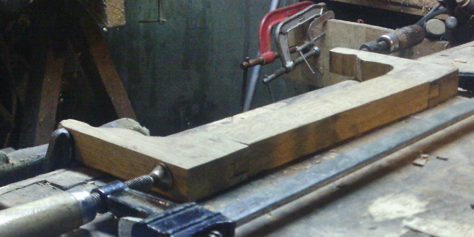

A little more chisel work to fine tune it, and then a glue up.   Single brad into each joint when the joint got closed up with a clamp
clamp-it_Jed.thumb.JPG.98c73b92964f85ac5
But, something wasn't quite right....top was 12-15/16" across...across at the bottom of the feet?  13-3/16"!   Ok, we can fix that..
55b7972212a9f_Clamp-it_Jethro.thumb.JPG.
Added the second clamp.   Dumb end is clamped into the leg vise, didn't want this to slide away.   Had plenty of thread to crank with......ah, top and bottom now match each other.  A few well place taps with a hammer to get things to lie flat on the bench......and called it a night....Stay tuned, might start some real assembly later this week...maybe?
