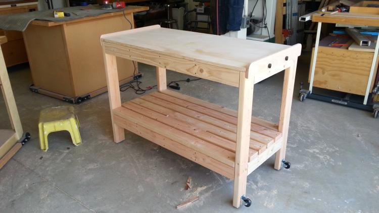

I have been working on a work bench for a friend of mine who is a hat maker. He needed a bench to go outside on his patio for working on felt hats as he "Pounces" them (shaping and smoothing the felt) as it sheds quite a bit and gets all over the place if he does it inside his shop. So he gave me some parameters to work with as the top has to be unfinished wood as any type of finish can contaminate the felt. It also needed to have end pieces so the block will not roll off the table while he rolls it back and forth with the felt on it. It also needs to have wheels so that he can move it around on his patio.
The bench top is 2'x4' and is 34 1/4" high. The framing is 2x4's with the frame assembled using pocket hole joinery as it will hold up better outside. All the screws are exterior deck screws so no worries about rust. The end pieces are Birch that were planed down to 1/2" and are attached using knobs and embedded nuts so that they can be turned so that they are either up above the table or down so that he can work with things that are longer. I will have to add on another cross rail on the end opposite of the wheels as a handle to lift the bench up to roll it. So it is not a very flashy project but it is very sturdy and practical for a specific use. He is short on cash right now as he has other work in process, so I will be holding onto it for a few more weeks before I deliver it to him once he gets paid. If he doesn't come up with the money then I can use it in my shop as I was in need of another assembly table or another flat space to pile up more scrap wood and tools.  :P

Interesting.  I never knew how hats are made.  Years ago, there was a hatter in downtown Detroit that's I took my hats to to be cleaned and re-blocked.  He worked  in his store window and I'd stand there and watch him re-block a hat and that was interesting but I think it would be realliy interesting to watch a hat being made and pounced.  In looking at the caster placement it looks as though the bench sort of has to be upended to use them.  Is that correct?

Yes, the wheels on one end are so that it can be lifted like a wheel barrow as it will only have to be moved occasionally. If I put on locking casters on all 4  wheels there would be some movement as he manipulates the felt. I also considered putting it on a mobile base like I use for the machines in my shop, but being outside there is consideration of rust as well as additional cost for him. So this was the cheapest and easiest way to do it. After I shot the photos I tried moving it around and found that I needed to angle the wheels downward so that they would contact the ground sooner giving a lower angle to move the bench. So I made up some wedges which made it much easier to lift and move. I also added in a cross piece on the opposite side to act as a handle for lifting and moving. It works much better now.
