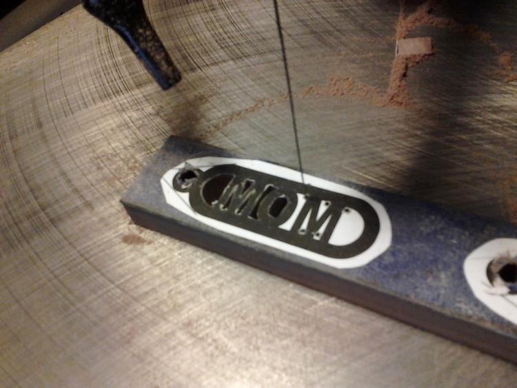

March 8, 201511 yr comment_59205 I'm having trouble with my tired, old eyes seeing some cut lines on patterns. I use a light-magnifier but when I'm cutting patterns like these from Steve Good, I have a lot of problems. The black line patterns with the magnifier pop right out at me but these filled area patterns drive me nuts. I loose sight of the blade in the black. Any suggestions on what I could try? Report

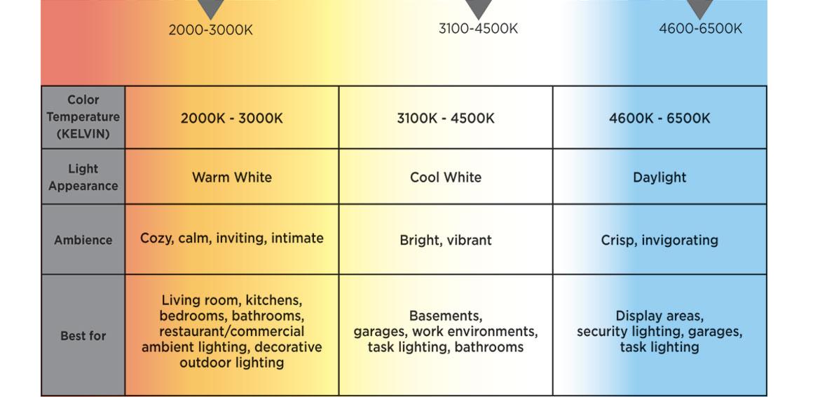

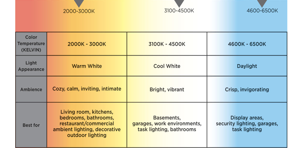

August 24, 201610 yr comment_69314 On 3/8/2015 at 1:16 PM, Harry Brink said: I'm having trouble with my tired, old eyes seeing some cut lines on patterns. I use a light-magnifier but when I'm cutting patterns like these from Steve Good, I have a lot of problems.The black line patterns with the magnifier pop right out at me but these filled area patterns drive me nuts. I loose sight of the blade in the black. Any suggestions on what I could try? print in lower pixel count.. Black won't be so dense... print in grey scale... try different colors of paper.. print in slide format... letters will be white and the area around the letter be black... try changing the color of your light... At the lower end of the scale, from 2000K to 3000K, the light produced is called “warm white” and ranges from orange to yellow-white in appearance. Color temperatures between 3100K and 4500K are referred to as “cool white” or “bright white.” Light bulbs (lamps) within this range will emit a more neutral white light and may even have a slightly blue tint. Above 4500K brings us into the “daylight” color temperature of light. Light bulbs (lamps) with color temperatures of 4500K and above will give off a blue-white light that mimics daylight. Edited August 24, 201610 yr by Stick486 Report

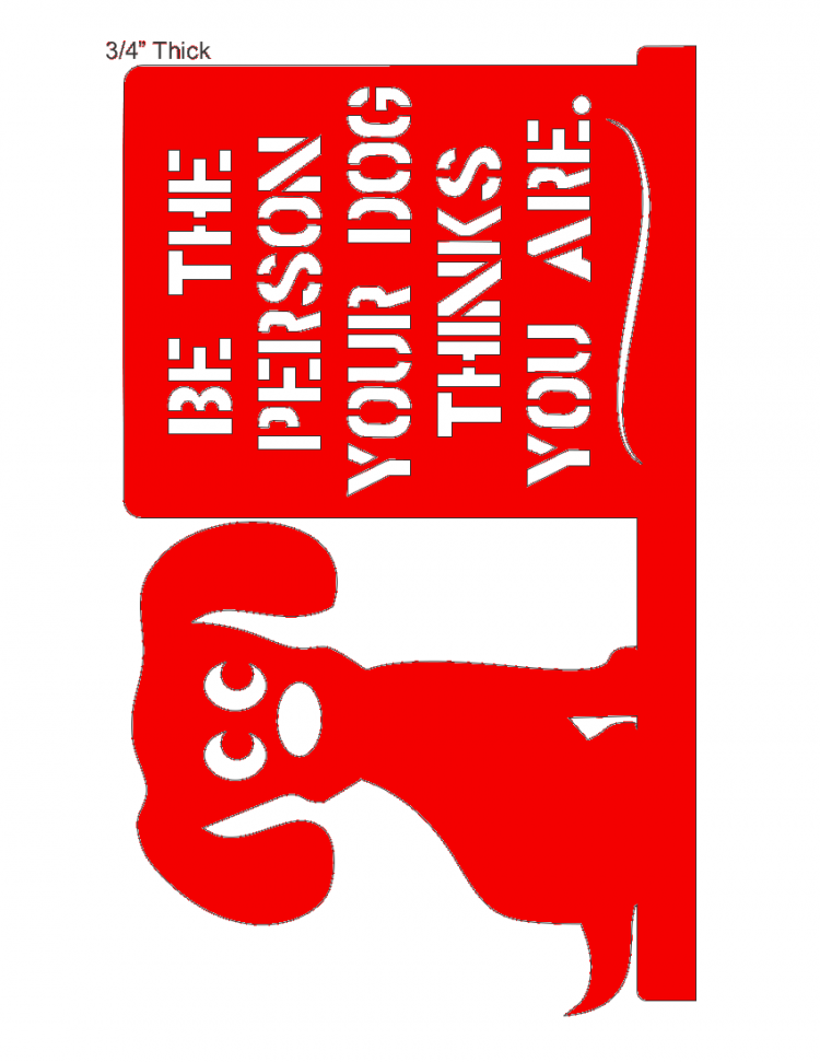

October 16, 201610 yr comment_79261 I believe that Steve Good is now supplying his patterns (at least some of them) using red instead of black. I would check out his website to see which patterns are available, or contact him. He seems to be more then willing to accommodate people with old, tired eyes. If there is a particular pattern that you are interested in, I'm sure he can re-do the color scheme for you. Report
October 16, 201610 yr comment_79265 Try this link. http://scrollsawworkshop.blogspot.com/2016/08/red-line-scroll-saw-patterns.html Report
October 17, 201610 yr Author comment_79463 Thanks for the info! Since most of my patterns are from Steve I'll try this. Report

February 11, 20179 yr comment_97325 Harry I get all my letters and words I cut on the scroll saw off of Word Pad here on Microsoft. If you enlarged your pattern a little would that help. I never realized all the letters are black when I print them out. I have started using the magnifier with the built in light and that really helps on the really small stuff. I try to keep the blade half on the black and half on the white area. I do not use a spiral blade for anything if that might help. What size blade and brand are you using??? Report
February 12, 20179 yr Author comment_97557 Most of my projects I use a #3r or #5r Olson or F/D. I'll use a #7r when I cut out the toys because they're 1 to 1 1/2" thick. The patterns I have had trouble with are the solid black ones. But I'm working on it. It's not too bad since I posted that question. Now if I could get back out to the shop and make some saw dust. Report
