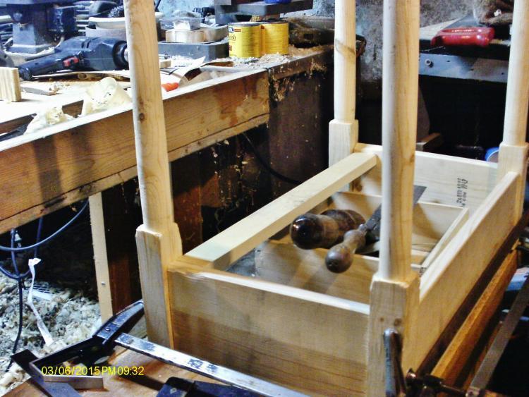

just playing around with some pine....

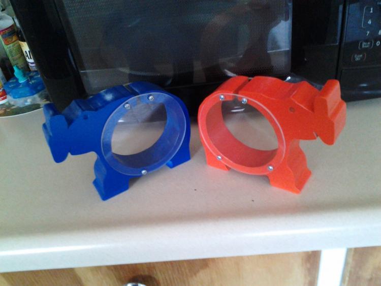

Mike (Dragon1) gave me a plan for a "Rino" piggy bank last week so I had some free time to cut it out. post-3434-0-98174900-1425840452.jpg
