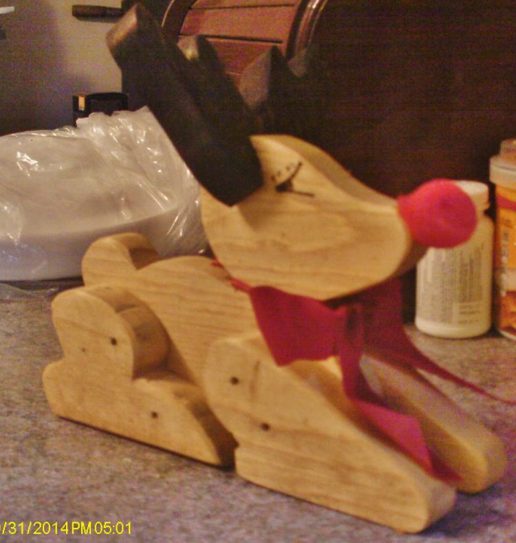

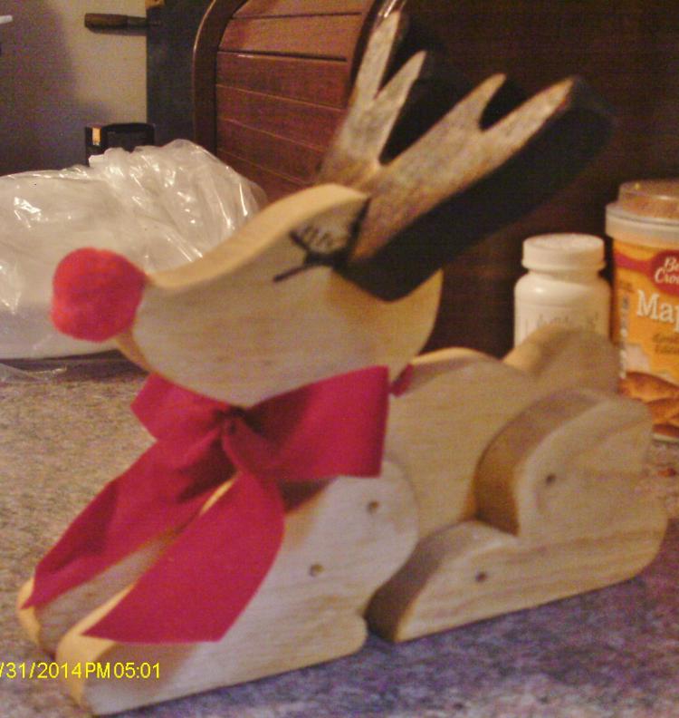

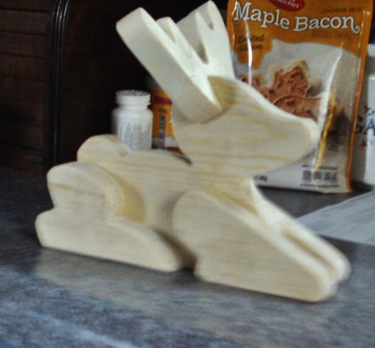

October 31, 201412 yr comment_55907 Time to make a few "Rudolphs". Bandsaw is long gone. I did pick up a scrollsaw last spring ( @ $10) so maybe try it out? Just six pieces of scrap pine. Then just a few nails to hold the "legs" to the body. Maybe a drop of glue as well. Used to run these parts over the router table, to round over the outside edges. Don't have such a thing set up, nowadays. 1" beltsander to smooth the edges, and round them over just a tad. Stain the body a light colour, and the antlers a darker colour. Add a few extras.. And we have Rudolph! Used to be able to get maybe 5 of these out of a 1x6x 8' pine board. Now, I just used scraps of pine. Another look Handsome critter, ain't he? Guess I better dig up them plans I had for a sleigh...... Report
