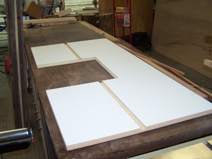

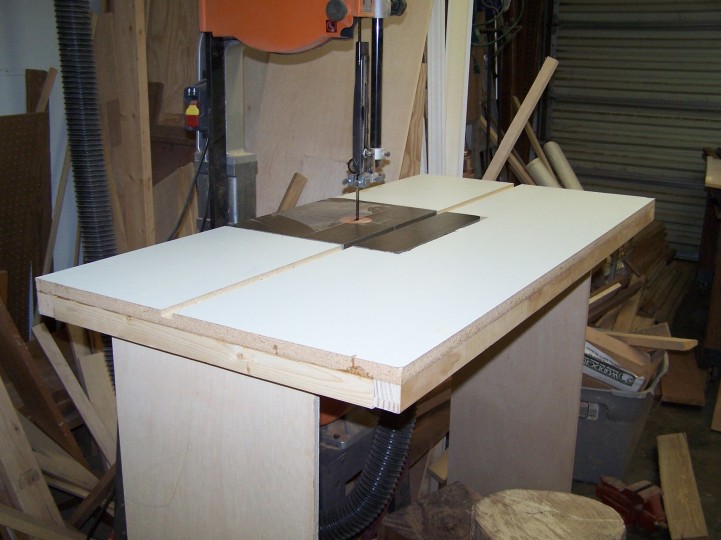

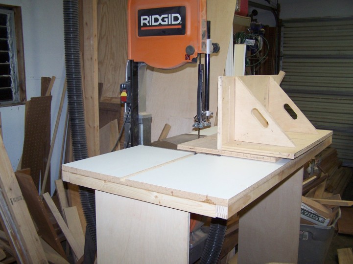

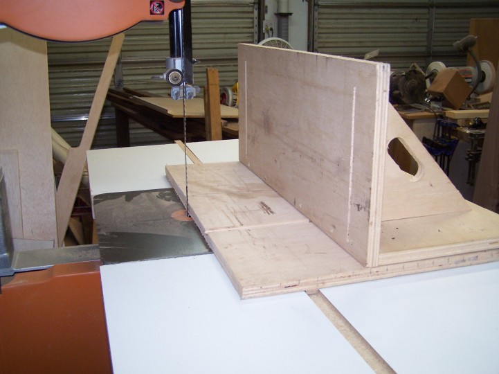

July 9, 201016 yr Popular Post comment_54110 I have been meaning to build a table around my band saw for some time. Tonight was the night. It was hot, but I decided to go into the shop and knock it out. I need to cut up some logs to get the blanks so I can finish the apples that have to be turned. I also got an order last night from the First Friday show for a Chess Board so I need to do some re-sawing. Cut out the table slot and routed the miter slot. Added plywood legs and just clamped it under the table. I made it so I can take it down and store in the corner and not lose a lot of shop floor space. Here with my re-saw jig. Now I have support in the front to start the cut and support in the back so I don't drop it as it goes off the table. Just glad to have this one off my ToDo list. John Report
July 9, 201016 yr Author comment_54118 Josh, my space is real tight. I built it so the legs come off and the whole thing is then flat and can stand in the corner. I didn't attach it to the table just clamped it so it would be steady. It is just a piece of melamine that is 2' x 4' so it give me a couple of feet in front of the blade and the same in the back of the blade. Thanks John Report

July 9, 201016 yr Author comment_54116 At first that was all I was going to do, but when I take some small logs and cut them for turning blanks it is hard to hold them and get the started so I decided to split the difference and give me some support on both sides of the blade. Thanks for the compliment. John Report

February 12, 20179 yr comment_97602 Nice setup. I have the same resaw jig. How did you clamp it on , I do not see that in the pic Report

February 18, 20179 yr Author comment_98545 On 2/12/2017 at 5:03 PM, Gerald said: Nice setup. I have the same resaw jig. How did you clamp it on , I do not see that in the pic It is clamped per under the table. I attached at strip of wood on the bottom to be flush with the bottom of the table. Then I could take a clamp and pull it tight. I hope that makes sense. Report
